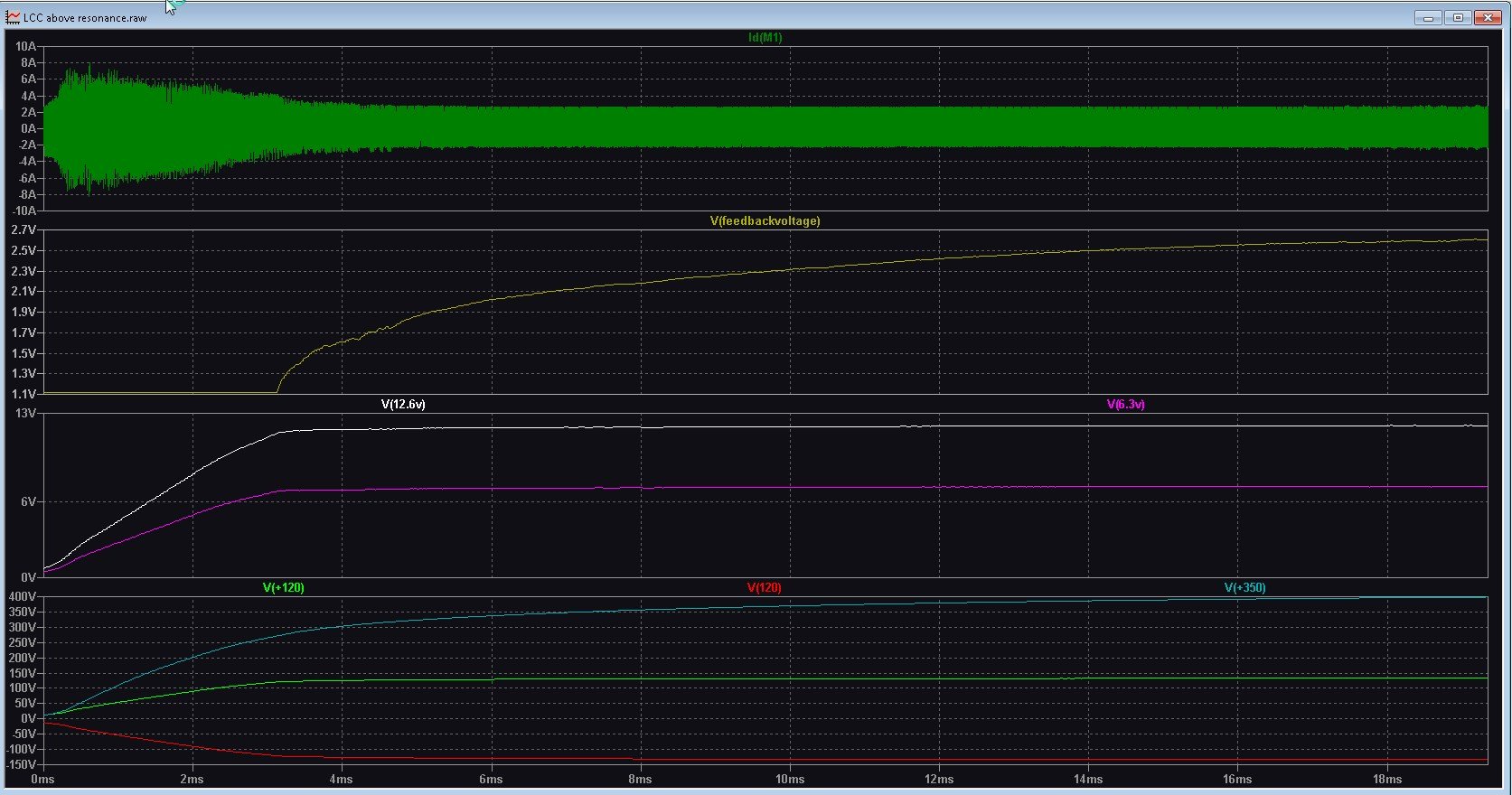

I have also a slight out of topic question.
I have sim a LCC for high voltages and filament voltages for tubes, I have to wind
it, but do not now what windings have to go first, I think the filament fvoltage of 12,6
volts who is regulated have to get closest to primary and then the 120+120v and as last the 350 volts.
somebody now the answer.
thanks.
