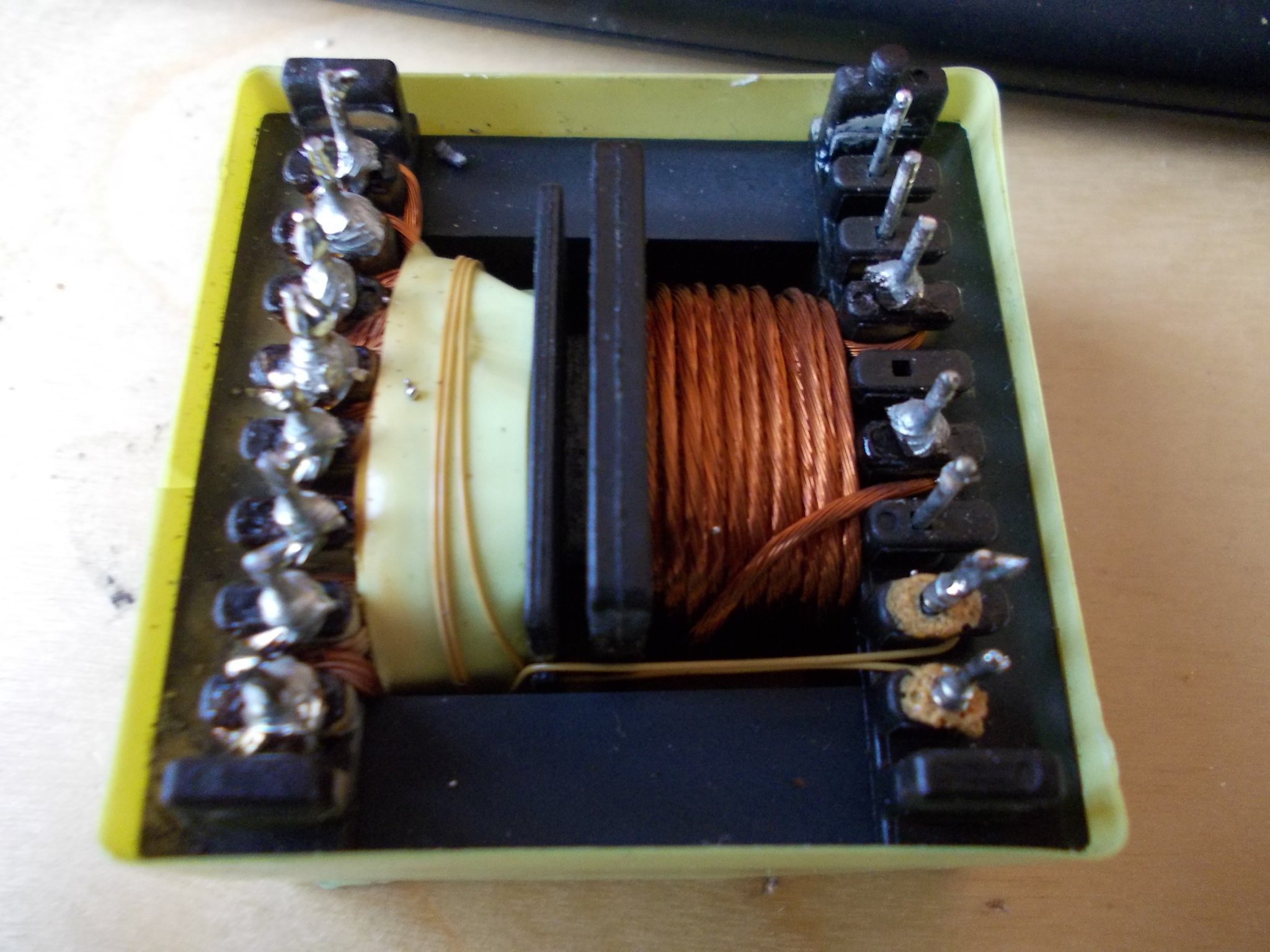

Hi cjk2, I made a smaller trafo, used a EDT 39 core with AL 2600. I used a cable tie to form a two chamber bobbin.
The windings are seperated 4..5mm. The gap I made with 0,2mm foil. 15 winding pri and 2*5 bifilar for sec. gives 160µH inductance and 40µH stray inductance.
To measure the stray inductance I shortened all sec. windings. To measure the main inductance I leave them open, measure allways at the primary.

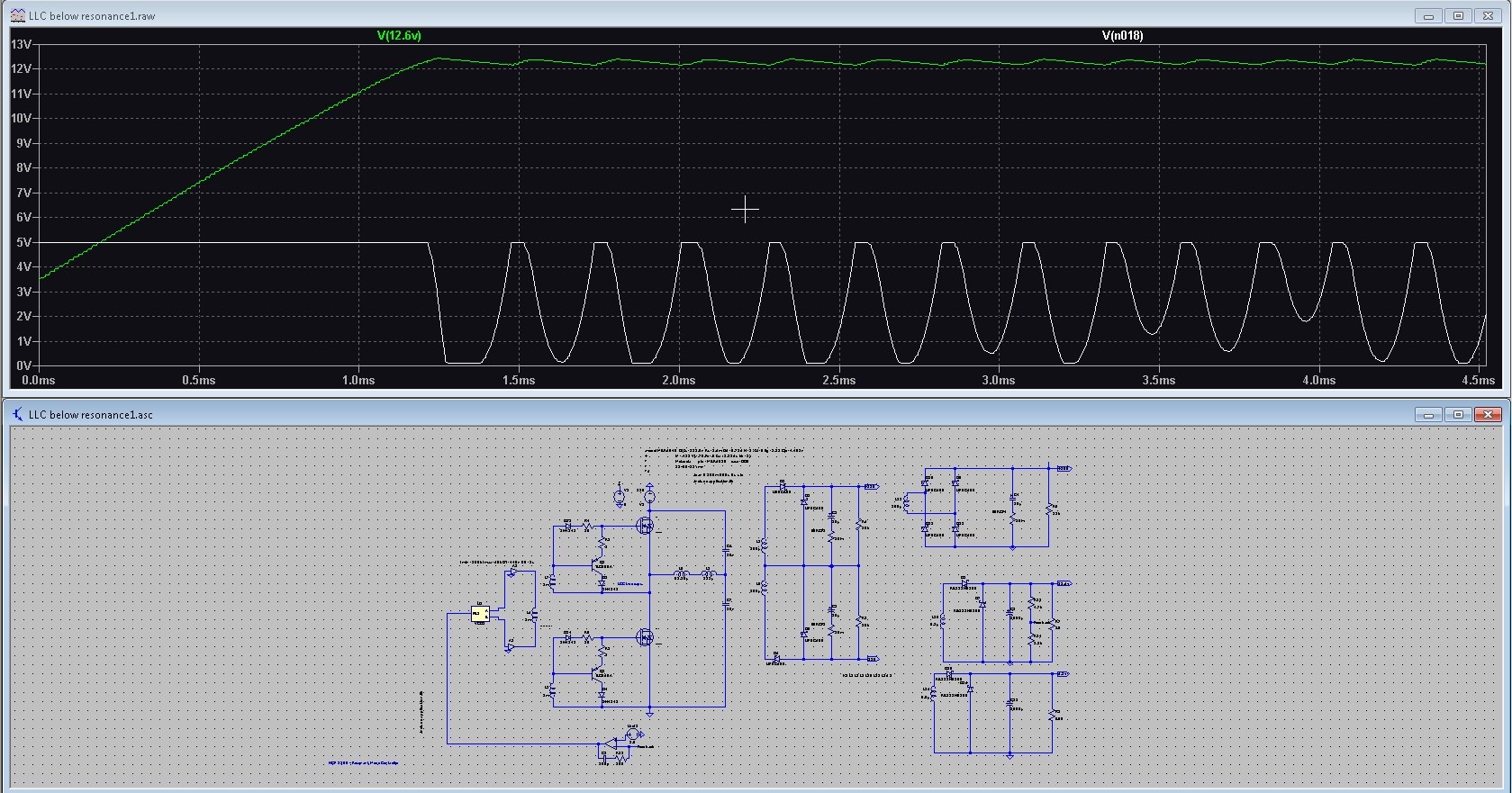

I am busy with a smps for tube supply, it give all voltages but also a 350 volts and 2 x 120 volts for the tubes who drive the mosfets in dc, I had read that for higher voltages a LCC is a better option, but maybe the doubler for the 350 volts also, it will make the LLC better manageble, I need the filament voltages be regulated and are 6,3 volts and 12,6 volts 10 amp max, I have high amps so we can play with much more tubes.Using a separate resonating inductor is a good idea, as then you can ditch the need for using litz wire in the main transformer. You will still need to gap the main transformer to establish the proper value of magnetizing inductance, as the separate choke will only provide the leakage/resonating inductance for the design. I would suggest using a relatively coarse litz wire (36-38 AWG strands) to wind the separate resonating inductor to help reduce losses. I would suggest using a voltage doubler configuration to generate your output, as you then have only a single output winding to deal with and no need to worry about phase-to-phase balance like you would with a FWCT output configuration.
Litz wire is for scin effect, when you calculate the right wire it is easy to do this myself, but I did see the litz wire is quite cheap these days and that is interesting.
Using the Gap in the transformer for tuing is used a lot, but ferrite is quite hard, so the need of a diamond disc?
test sim in pic.
