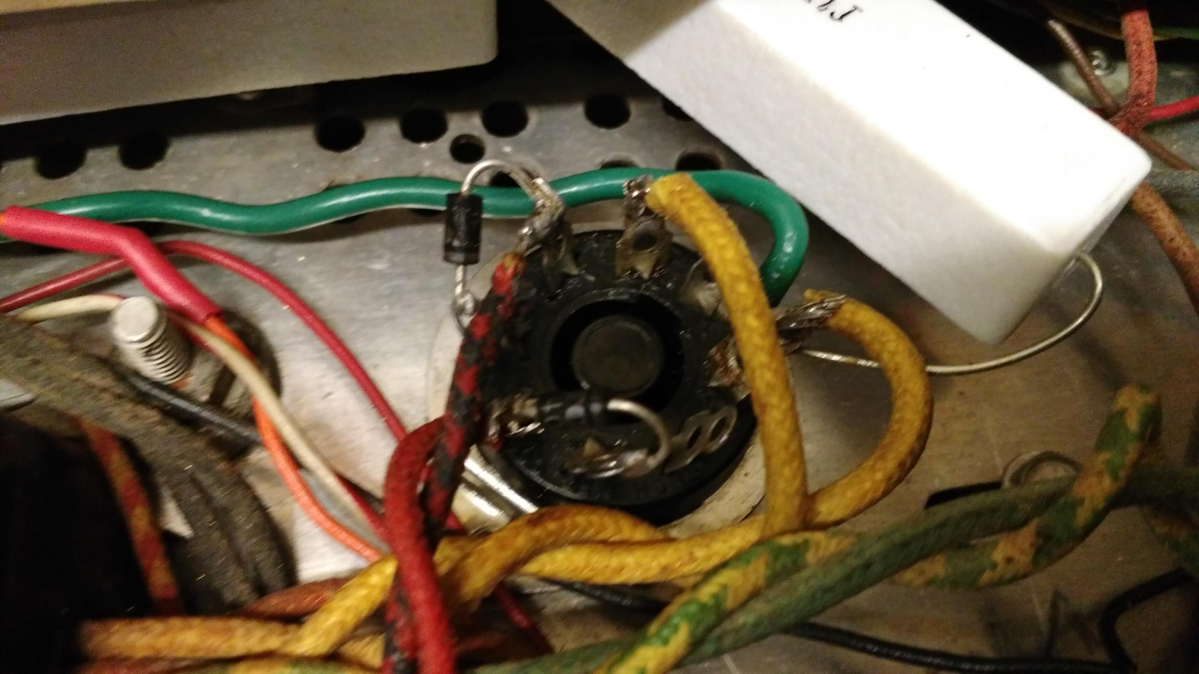

Once again thanks for the insights.
The marginal phone photo shows the notch and yellow wire on 8, the black/red wire and unbanded end are on 7 and the banded end is on 6. Harder to see but the banded end of the other one is on 4.

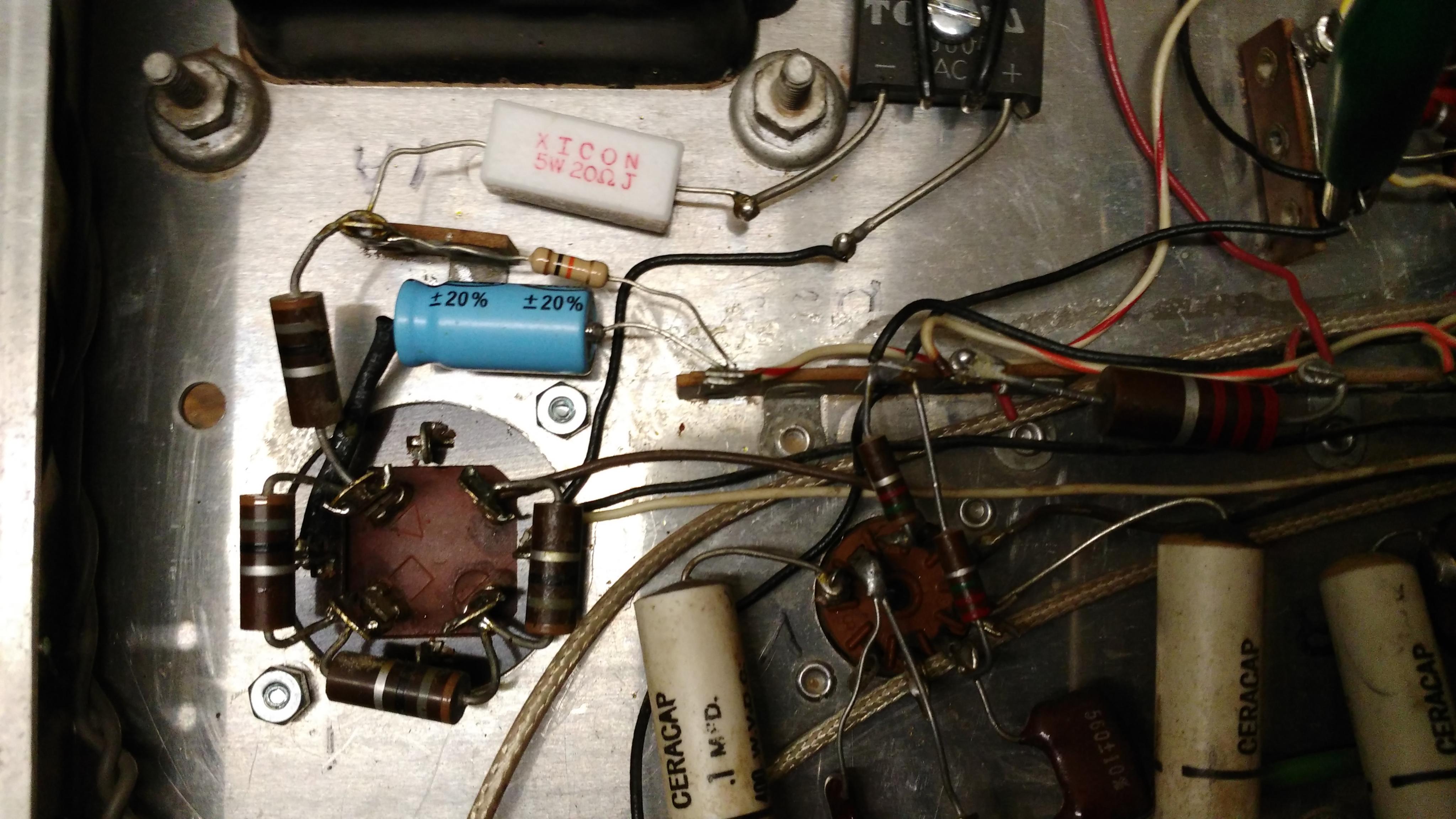

Michael,
the photo shows the rectifier and wire wound resistor. This is how I purchased the amp. (Disregard the Ceracaps, they are part of the tone/balance circuits that have been bypassed.)
I think a varyac is in the cards.
Thanks again

I want you to check the voltage from pin two of each of the 7189 tubes to ground. It should be a minus voltage but tell me what the voltage is..Leave the tubes in because you aren't hurting the tubes. What I think I see from your photo is a 1k resistor which connects to the red/white wire that goes to the 7189 tubes control grid..You probably have to change that to a 5k or 10k because I believe you have way too high a negative voltage and the tubes just will not conduct properly.

.We are talking about bias and not ac signal..An obvious silicon bridge was put in place of the selenium..When you do this,the output voltage increases in the C_ minus supply and you have to many times add a resistor in place that is larger in value to lower the negative bias voltage in order for the output tubes to draw more current..When the negative Dc voltage on the control grid is too high,that suppresses electrons to flow from cathode to plate and the tube basically sits there in an almost idle state. This is why we need to know the voltage on pin 2 of the 7189s.I understand you decrease the negative voltage but putting in a larger value resistor gives you more range to reduce the bias when the bias adjustment doesn't have enough range. This is how you lower it....His B+ is way too high and if the bias pot can't bring it down,we have to lower the neg bias voltage and you do that by putting a different resistor that feeds the output tubes right off the neg bias or C minus supply as it's sometimes called.

Here is a schematic for his amp..Notice there are no actual bias pots but there are two balance pots,one per channel.This amp should run in the neighborhood of about minus 16 volts DC..Being that silicon bridge has a lower drop than a selenium,you have to add a resistor in series with the C- supply in order to get the voltage down in the neighborhood of where it's supposed to be. This is why it is imperative that he knows the voltage reading on pin 2. When I do a Mac 30 or mc60 rebuild,I always have to remove the 3.3k bias supply resistor in the mc30s and replace it with an 8.2k to 10k because when I change the selenium to a silicon diode,the negative bias voltage goes way up and there the B+ the outputs goes from 445vdc to 480vdc and that's why I have to put a larger value resistor in to bring the negative bias down so the 480v comes down to near where it should be.
On his scott,I don't think he will be able to get it from 500v t0 420 but he can get it down to about 430v and that's where I usually get those to.
This schematic says 222 but it's the same as the LK48 because the LK48 is the Kit version is all.

No,what I was talking about was the source resistor in the C minus supply to bring down the C minus voltage feeding the G1 on the 7189s. After looking at the schematic I think we may have to add one which I think the 1k he has in the picture may be used for that..I just wish he would measure that voltage at pin 2 and that would give us an idea where we are at. I don't want to change the grid stoppers..
