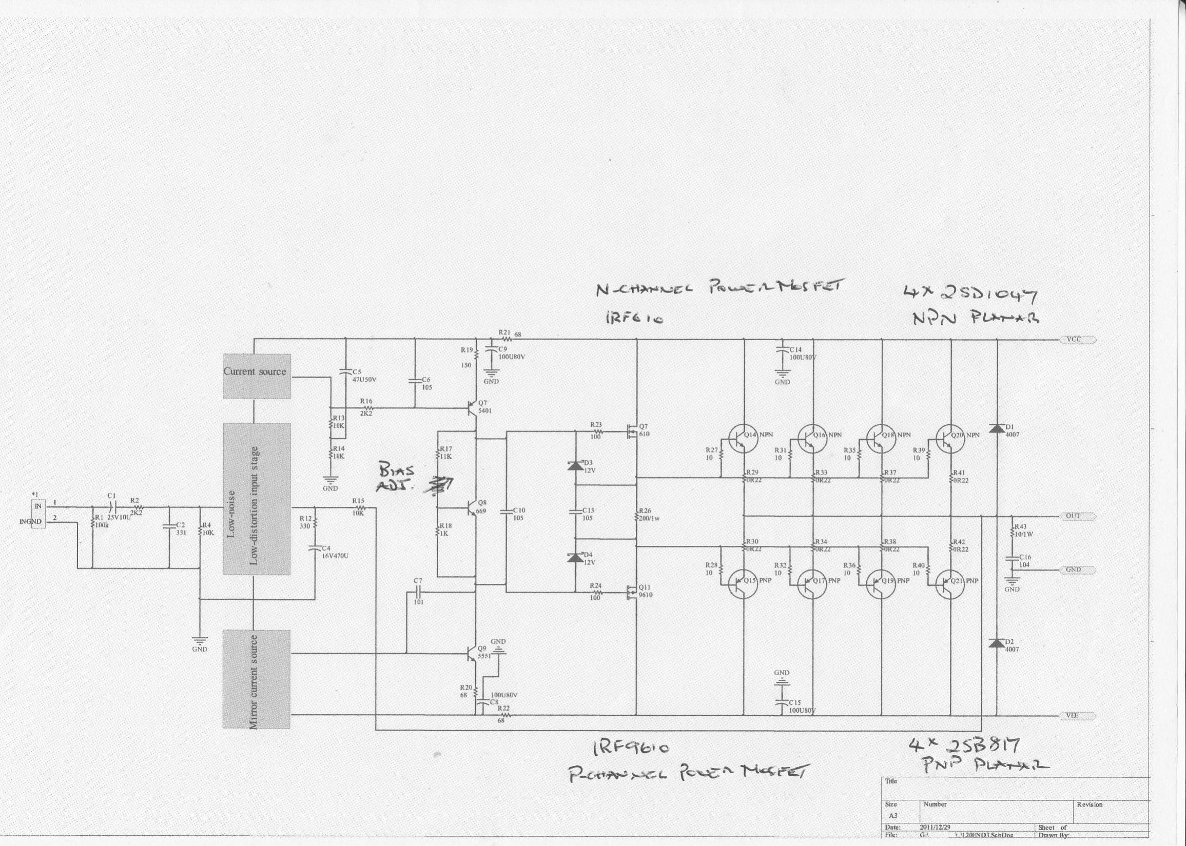

I assembled the kits and hooked them up to a 33v-0-33v beefy power supply for some testing. Both kits seem to work ok, and they sound just fine. I tried a 4Ω/100w sub woofer, and it quickly reached it's xmax. The heatsinks got warm after 2 minutes, but not hot...
Now the problem is, despite the good sound, i can measure no bias current at the outputs. The heatsinks are cold as beer even after an hour of being turned on with no signal at the input. I used 10Ω power resistors at each rail, and i calculated an idle current of about 13-14mA per rail, per amp module. It seems very low😕.
With inputs shorted, the emitter resistors (0.15Ω) all measure dead zero mV (0.0). The voltage across R26(200Ω) is about 850mV. I think thats about half the optimal voltage to even begin conduction at the output transistors.
What baffles me, is that the amp sounds just right with no apparent output bias. Even the top end sounds smooth, no signs of being grainy or harsh at all. Is that normal?
Could it be that the rail voltage is rather low? The optimal voltage per rail, according to the designer, is around 65v. I will test again with the power supply which i intend to use permanently (57v rails). I hope the higher dc voltage will affect the, almost non existing, standing current.
Here is a (not very revealing) schematic i lifted from another thread. I haven't checked for errors, but it seems close enough.

It sounds strange a bit. You should hear the result of the missing bias, especially with low level music.
If You want to set the bias, just replace the 1k resistor in the Vbe multiplier with 2kohm multiturn trimmer. That way is better, and safe comparing to the solution, mentioned on the schematic. Allways start from the maximum resistance, and reduce it carefully!

Thanks Sajti,
that's nice to know. As i understand it, it's safer to put a trimpot in place of the 1k resistor, because if the trimpot, for whatever reason, gets open circuit even briefly, it will not send the bias current through the roof. I'm thinking about a 100k or 50k linear trimmer, parallel to the existing 1k resistor.
But first, i will check the bias with the higher rails (+-57v), and if no current appears, i will then start with the mods. I think about 10mA per pair, ought to be enough.
Hi Filthyone,
Good advice from Sajti - having the trimmer on the emitter side is definitely much safer.
A would run this kind of output stage at 60-70mA of quiescent current per pair. It will run rather warm, but ensure the low crossover distortion throughout the whole audio bandwidth.
Rails voltage is not going to really influence the bias, unless your VAS idle current will noticeably increase with higher rails, which should not be the case in a well-designed front-end.
Valery

Hi Filthyone,
Bob Cordell explains the biasing principles in his "Designing Audio Power Amplifiers" book. Skipping all the theory behind it, the key principle for setting the optimal bias for emitter-follower type of output stage is that the voltage drop across the emitter resistor has to be approximately 26mV for each of the output resistors.
With 0.22R emitter resistors, corresponding quiescent current comes to 118mA per output pair. My practical experience shows that depending on particular design, 60-90 mA per pair is enough for suppressing crossover distortion to acceptable level.
10-15mA per pair would be enough for CFP output stage, but this is not the case in the amplifier we're talking about.

I modified the circuitry by adding a 50k 25turn pot across the 1k BE resistor of the Vbe multiplier (Q8), so i could fine tune the bias current. It works great, and i tried a lot of different values but settled at about 20mA per output pair.
While comparing with the other channel, which had zero output bias, I COULDN'T tell them apart, they sounded exactly the same to me (with soft music as a source). But when i tried with a pure 1kHz sine wave, i thing there was a slight raspiness in the no bias channel, but nothing too obvious. Anyway, seems some bias helps, and the amps sound fantastic, running off 60 Volt rails.
Now the problem is that the bias is very dependent on the heatsink temperature. When i start the amp up (cold heatsinks), the bias current is where it is supposed to be, exactly where i set it, at about 20mA per pair. As the heatsinks slowly warm up (without input signal), the bias settles at around 5mA per pair. If i play some music for a while and the heatsinks get real hot (to the point of no touchy), the bias almost disappears (about 1ma per pair). As the heatsinks slowly return to just warm, the 5mA bias also returns! Go figure....
Is this normal? I have checked everything, all output transistor are firmly attached to the heatsink, and are warming up at the same rate, including the bias control transistor (Q8). Shouldn't the bias be more stable? Am i missing something?
Please, give me some light. Is the bias supposed to be setup when the amp is idling or when it is real hot. Does this behavior indicate a problem with my thermal feedback?

1)Power on the amplifier.
2)Adjust the bias.
3)leave the amplifier for warming without any signal to inp, no load at the output.
3)Adjust the bias again for the same value.
Check the tempereture on the heatsink ! This must be a little warm,not hot.If it is hot a bigger one is needed,or a lower bias.
Now connect the inp and out ,play music,as the temperature raise (heatsink realy hot) bias decreases. This is normal.
