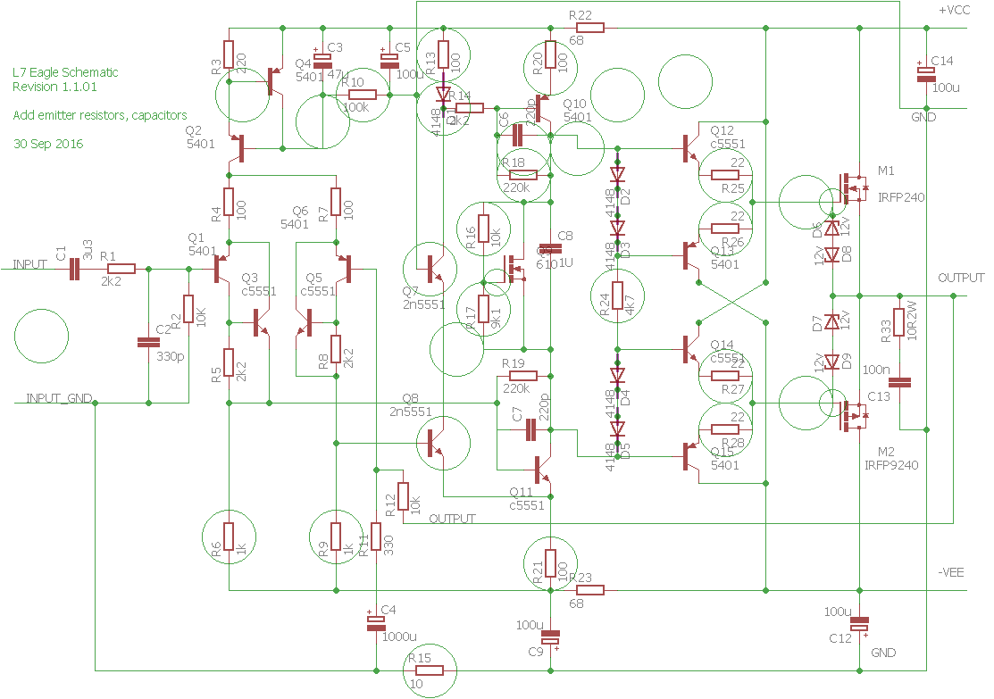

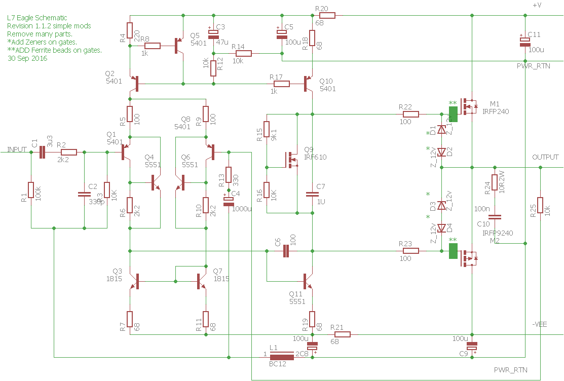

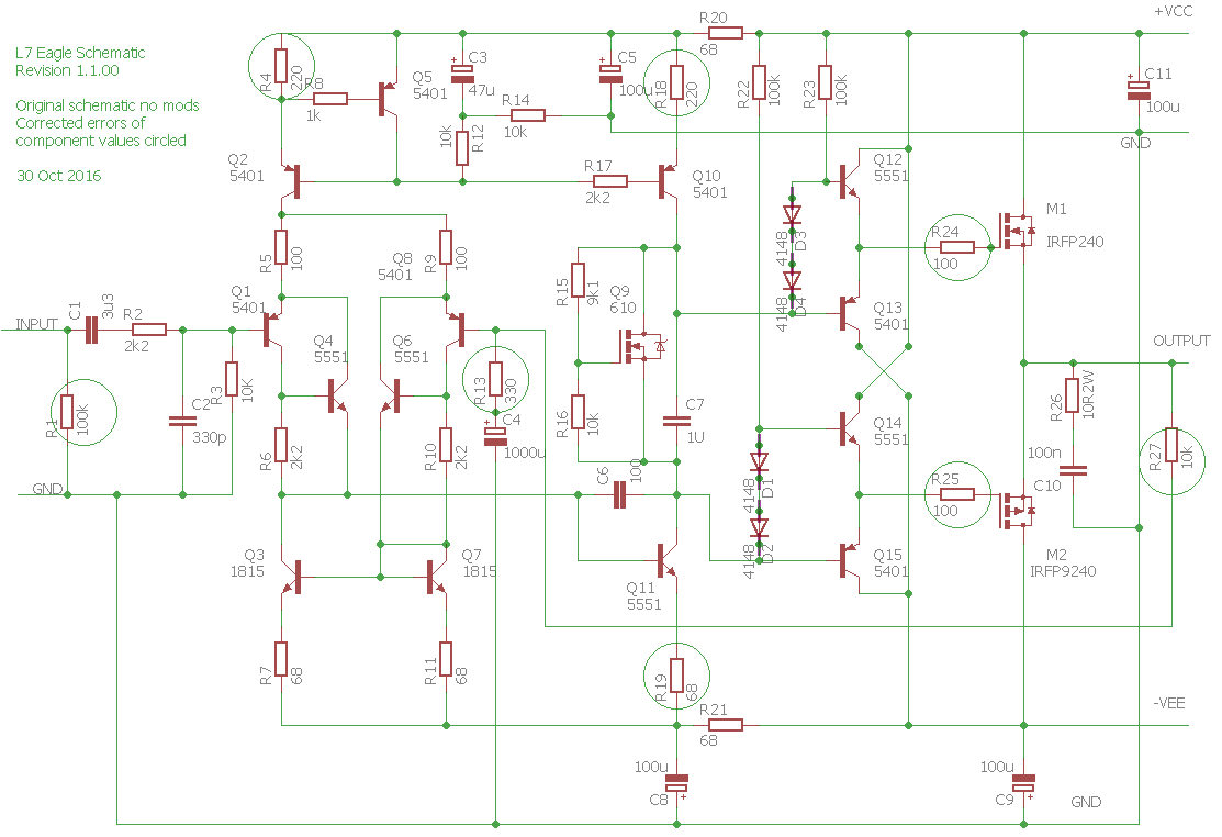

No update. This seems to work OK up to +-40v. At 50 it cooks sometimes. To my knowledge nobody has done a fault analysis. Some parts in the input stage are only rated 50v Vceo, maybe that's a problem, but I don't think so.
I suspect the output buffers fail and cause other damage. As you see, there is no emitter resistor on the output buffers. That means current is limited by internal resistance of the little buffer transistors, which is on the order of 15-20 ohms and the buffer runs off the total supply voltage when the output is pegged negative. That's risky for cross conduction of high current. This buffer is a standard sort of circuit for driving mosfets, but usually runs on 12v floating, not full supply voltage. If that is the problem (which we don't know), you could simply bypass the buffer. Or with modest rework, it could be made to work. IF that is the problem. As I said, nobody analyzed to root cause.
There is also something missing, zener diodes from the mosfet gate to source. The limit for voltage here is +-20v, and prudent designers always put back to back zeners here to limit it to say 12v. If the output wires are shorted, a common accident, then the gates see high voltages and will rupture the gate insulation and often short the devices. So that's another hole.
I will attach schematics, first original, second with the output buffer bypassed, the third patched a little. None have been built or proven, so use them as food for thought but don't assume they are known good.

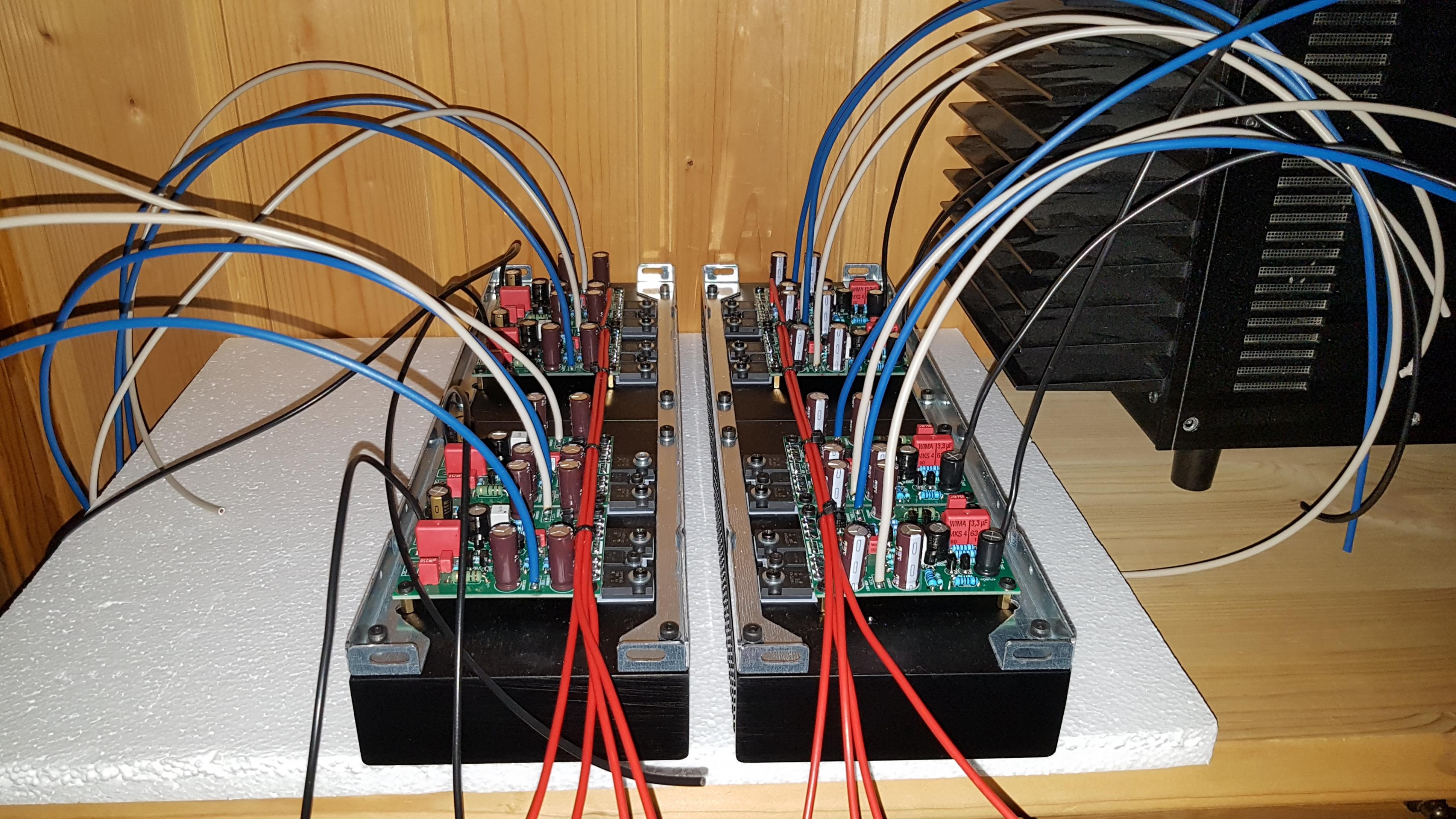

build the L7 for a active 2-ways speakers application.
On power ON, it give a loud bang from the speakers
So, a simple speakers relay protection is a MUST to protect it.

the offset of all 4 amp are about 7 to 10mV DC.
The power to the amp are 36+/- VDC with 40,000uF to 2 amplifiers
I also have a thermistor at each of the transformer.

Besides the speaker protection, which you should install with or without thump,
you probably need a power soft start, with another relay. Something like this:
Class A Power Amplifier Soft Start Delay Temperature Protection Board 220V 30A | eBay
I don't think that thermistor is any help.
Look for threads on soft start in DIYAudio.
