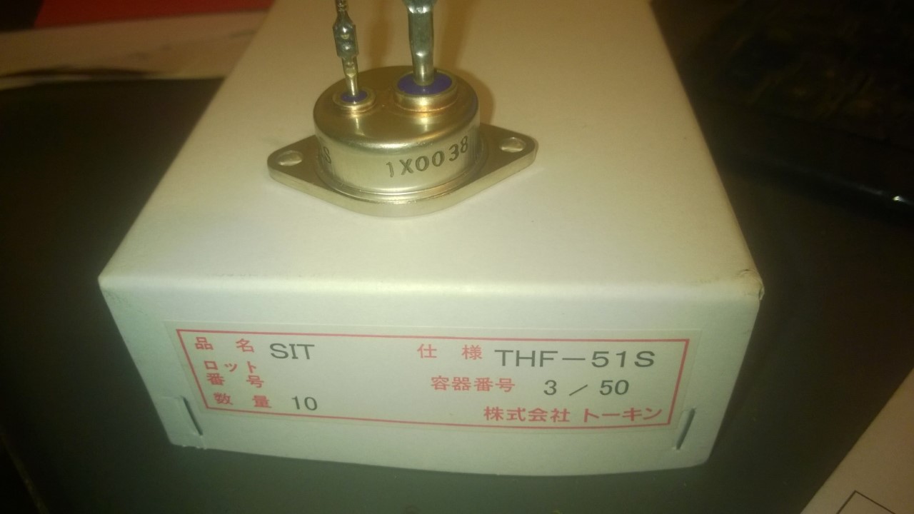

It has been said that some types of 51s have been difficult to measure and/or give odd curve results. (1Y's and 1Z's possibly). What does this mean in practice with regard to applications for them ? Are they still usable and at what potential values ? (I have 6 numbered sequentially from the same trusted seller).
Thanks for the assistance.
