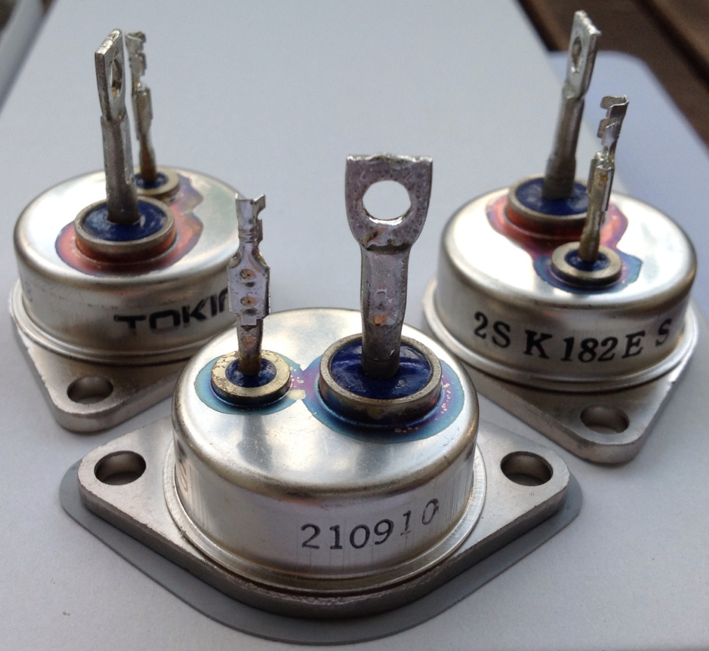

If 1Y and 1Z was strange sit batch what about 210...or similar series
of 2SK182ES have Diyers find after curve tracer tests some good ones ?

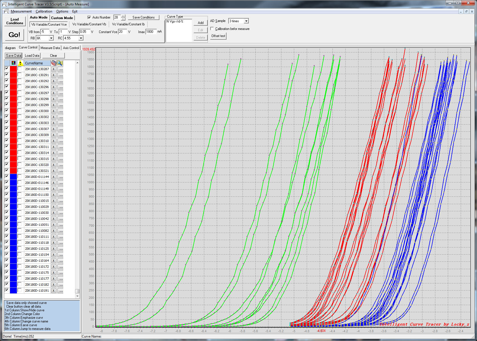

I measured the Vgs vs Id (@Vds 20V) of some 2SK180s. Non-graded curves in green, grade C in red and grade D in blue. It seems there are some relationship between the grade and the Vgs bias level.

You can put the 2SK182ES in the L'Amp circuit, play around with the operating conditions to get the power and distortion profile you desire.
Otherwise, let's see if Michael would show something in the BAF 🙄
Edit:
Sorry I missed the word push-pull, in that case you're on your own - maybe a circlotron, or a F6 type circuit with the 182ES.
