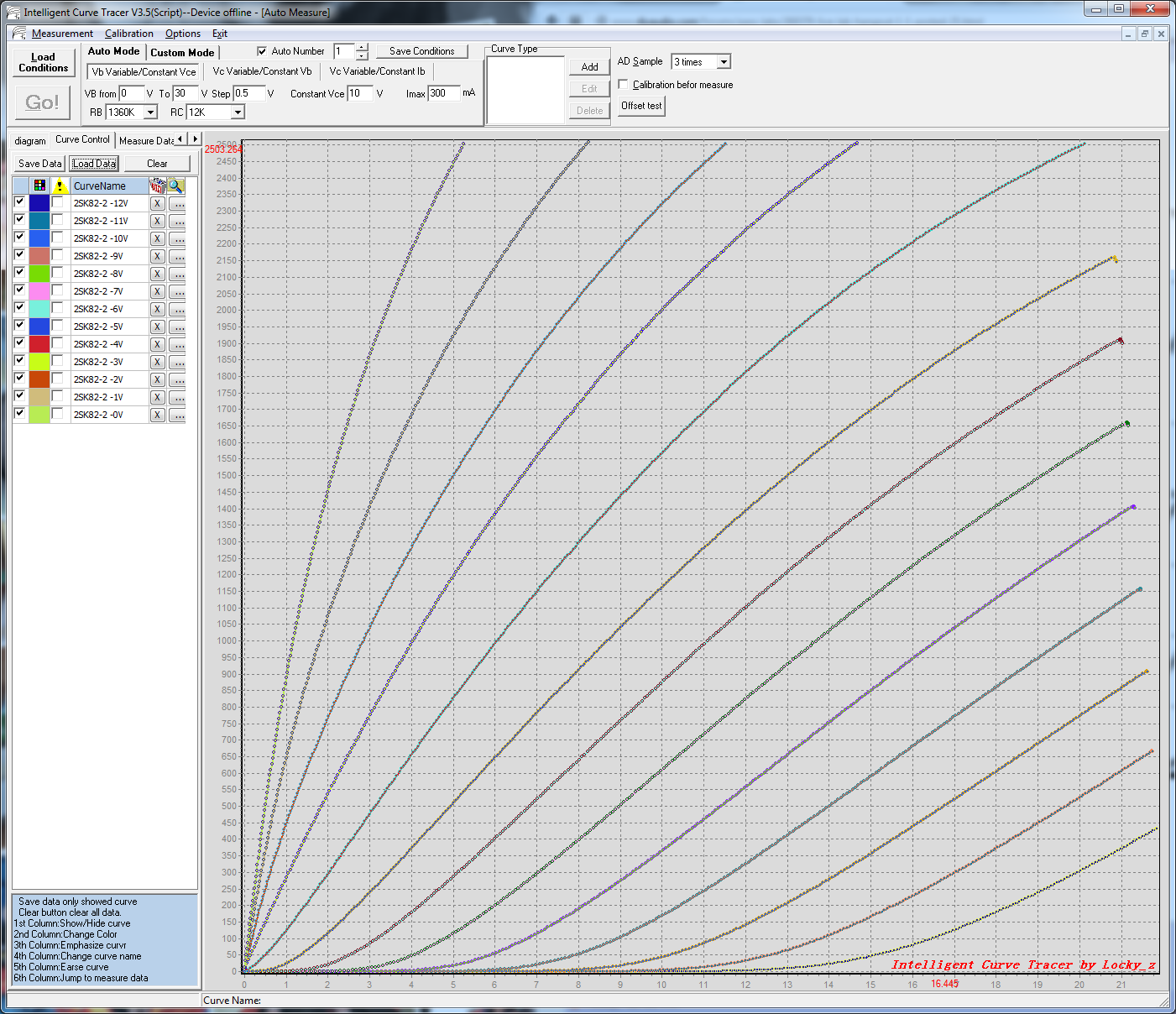

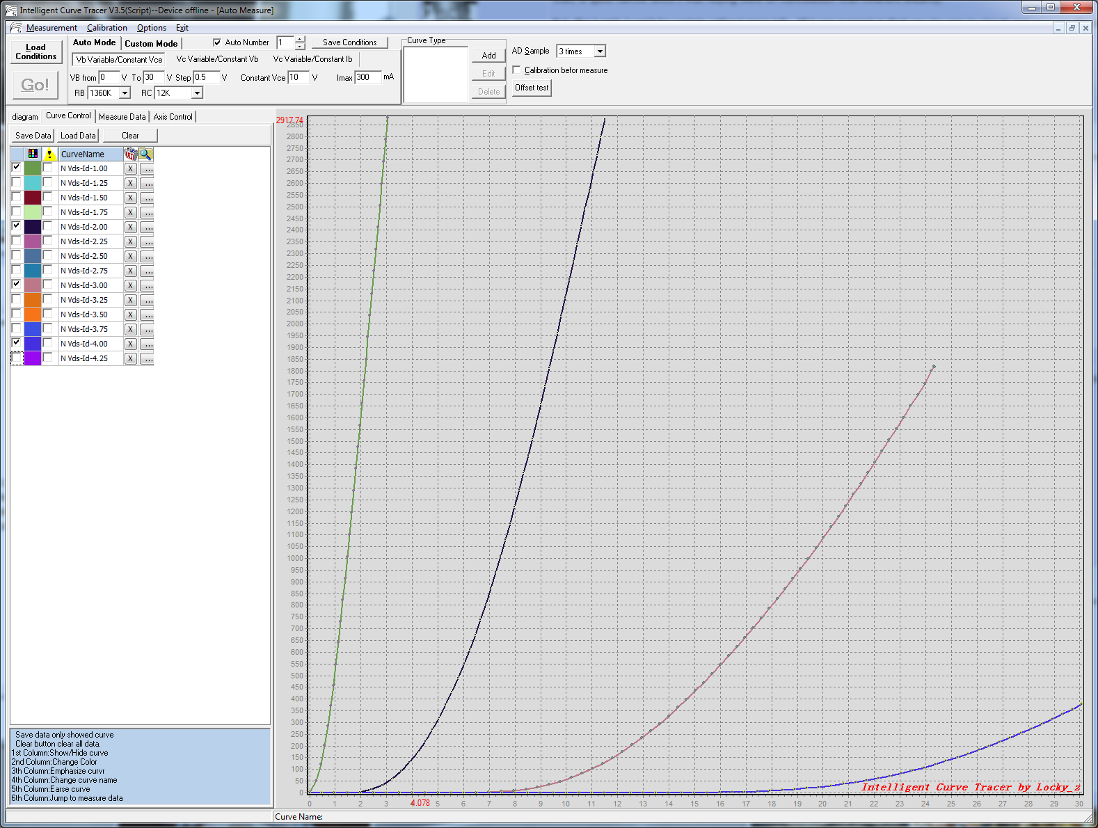

... Cwtim01 sits courves looks much better
and his 2SK182ES one are nice linear but ....
Actually it's hard to say, the 2SK182ES curve I showed was spaced by 0.25V apart. For the same dataset, if I space them by 1V apart (just by remove some curves in betweem), it gives the attached.
Now it looks pretty much like the bad curve Michael has shown ..... 🙁

I am sad to hear the bad news about so many not properly working Tokins.....
Three or four times I nearly ordered some......but I still have to build my SK180 amp, so I hesitated.
I hope that in April I can report about my SK180 build with 45R drain resistance and around
80-80V PSU.
Right now, Paul is the Auric Goldfinger of 2SK182ES's
