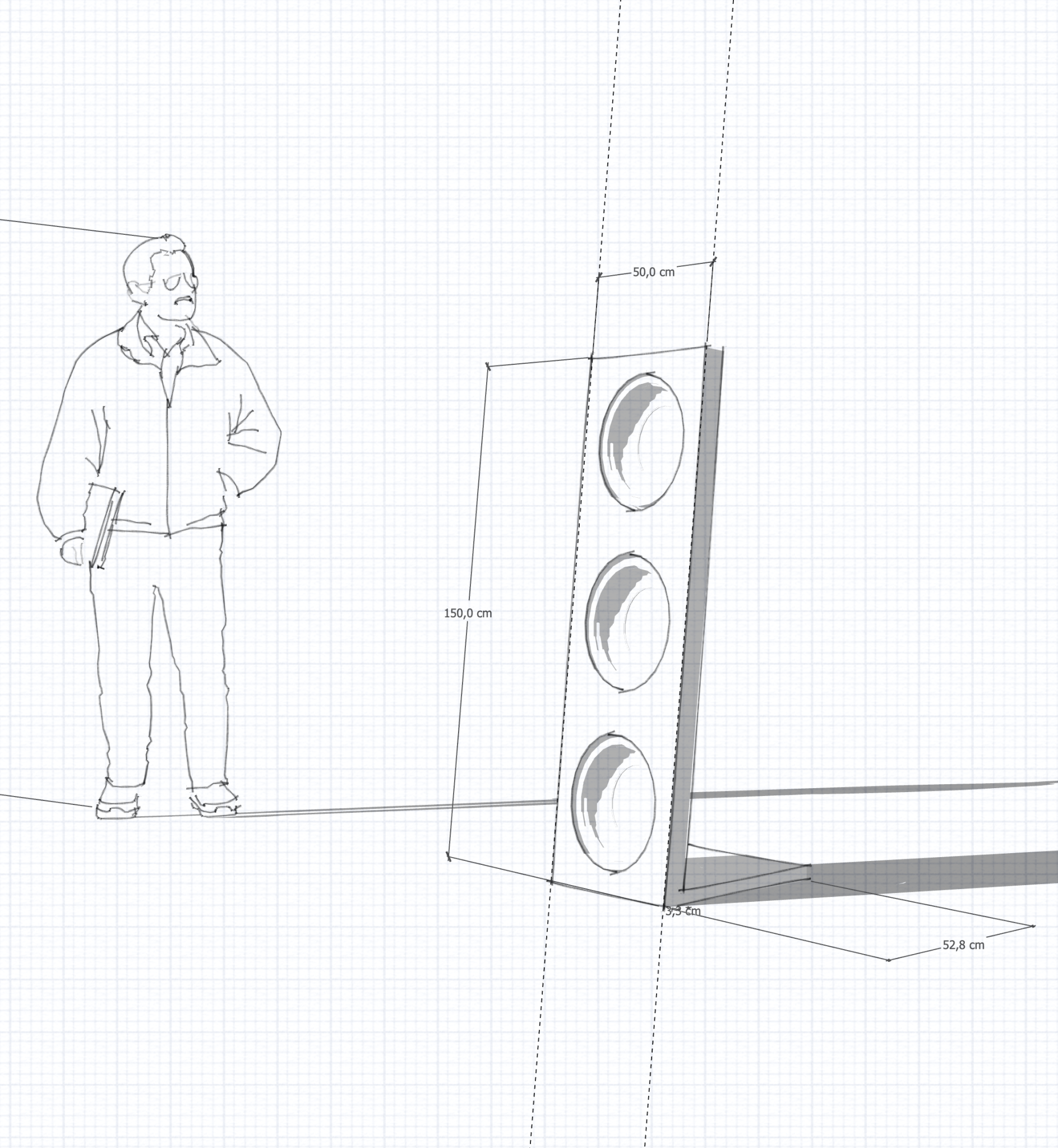

So created first draw off my idea off the BB concrete speaker project...
Some thought I have: please give feedback anyone...
1. I have set the angle on 6 degree because I need it to support the tall heavy baffle by the iron armored into the cast concrete stand.
2. I also would like NOT to put sidepanel on the speaker because off a design perspective...
3. My good friend who have quite advanced diy speaker through time says its a flaw to mount speaker behind the baffle because off a "tunnel effect" - there will maybe be 3 cm "tunnel to the outside off the baffle...

1. 6 degree angle sounds great.
2. You will lose about an octave of bass without the lambda shaped wings. You can still boost the bass in the DSP and push them down to 40Hz, but I'm doubtful you'll get enough output below that. @Balthazarp can speak to that.
3. You should absolutely flush mount the drivers as I have done, I would not rear mount them. It might be OK with the subwoofers, but NOT OK for the coax.

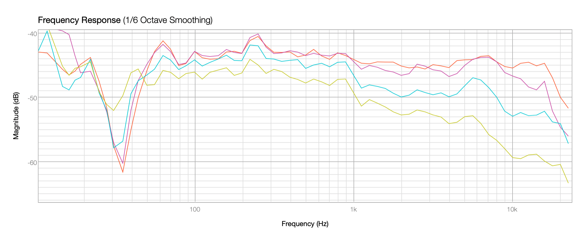

ABOVE: Front side of the cabinet, off axis curves using my experimental (and unorthodox) circuit where the rear tweeters are connected to the bass+mid amp & DSP. The off axis response is a little irregular around 1.5-4KHz.
BELOW: off axis curves of the regular published design:
Off axis behavior in the published design is better behaved.
Side comment: You can see that the 30 degrees off axis curves for the 15CXN88 are very close to the 0 degree curves. This driver has better polar pattern than a 1" dome tweeter above 10KHz AND Constant directivity across its entire band. This is why I like this driver so much.

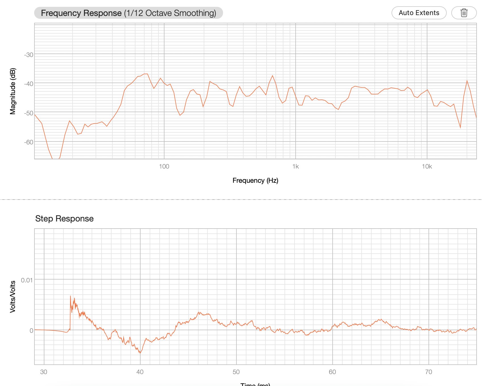

This is the rear frequency response and step response of the Bitches Brews. If you can position the rear horn driver so that the diaphragm is in the same vertical plane as the cone neck of the 15CXN88 (or perhaps an inch or two further from the microphone if you can manage it) then the rear signal will also have great time alignment and step response just like the front signal does. The lower it is mounted on the lambda, the further ahead the horn is timing wise from the midrange and the pulses will start to separate. I hardly think this is critical, but for the sake of perfection....
The above measurement is taken with the microphone about 5 feet off the floor, which is where the signals best align. If I were building these over again I would move the horn a little higher and that would set it back a couple more inches, and the time alignment sweet spot would be a little lower in elevation.
Most speakers don't have nearly as good step response on the front side, let alone on the back side.
I think the reason dipoles sound so natural (full dipole on front and back including tweeters, and not just tweeters on front) is:
1) It's important for room reverberant response to match direct response, and this is definitely not the case for 99% of speakers
2) The dipole null at 90 degrees off axis greatly reduces side reflections and ceiling reflections; so if you get the on axis response right, then:
3) Constant Directivity means that not only does every seat in the house get great imaging, but every seat also gets good measurements and close to flat response across most of the range, especially above 300Hz.
I don't know any other way to design a speaker that solves all these problems at once. I think this is why John Hilgers built the Bitches Brews and his wife thought he was playing his clarinet when he was actually playing a recording.
