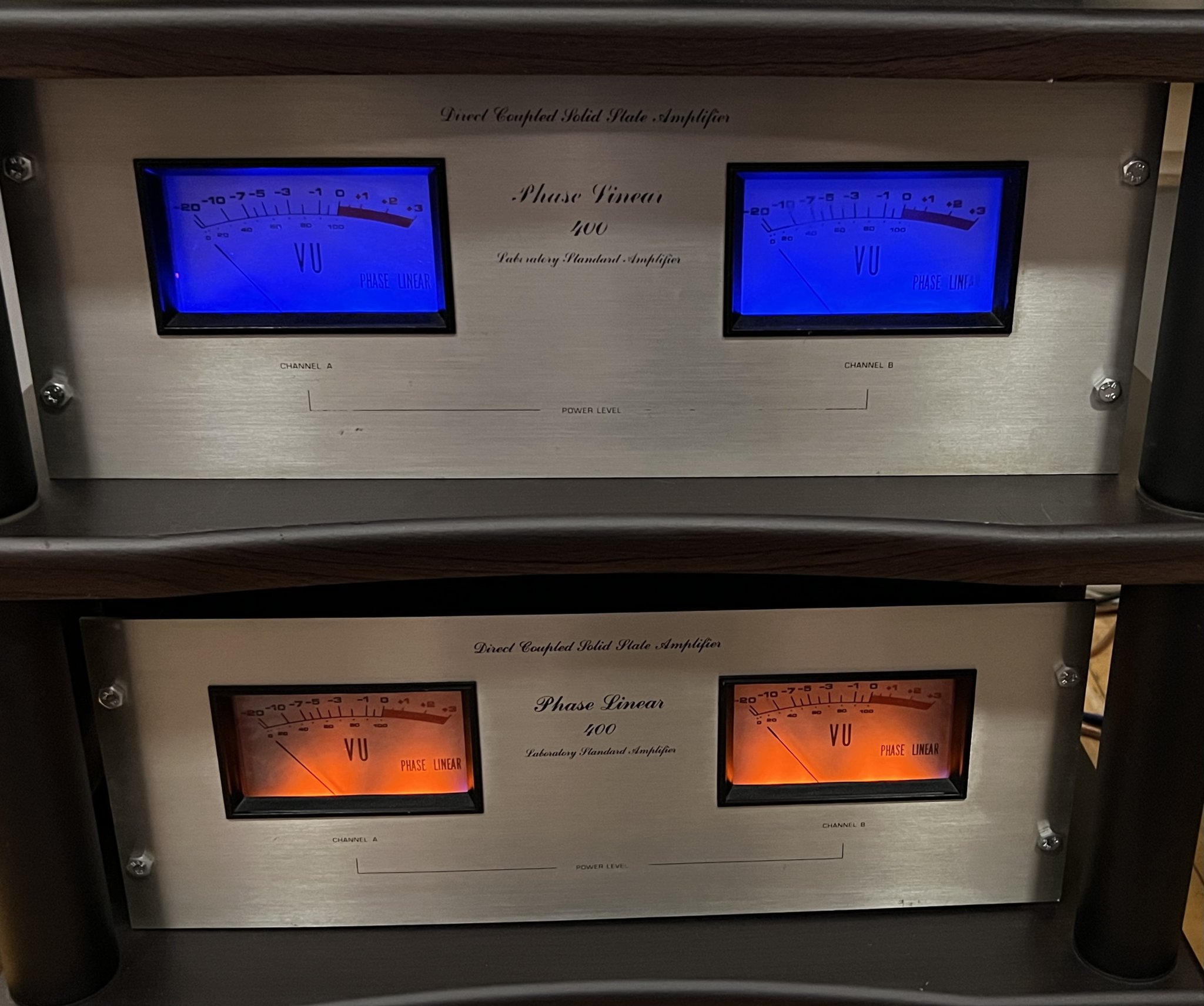

Thanks so much for the prompt response Perry. Your knowledge on this subject is amazing. I have no problem with spending time or money to get the most out of this design. My general philosophy with "things in the signal path" is to use the highest quality parts I can, and wherever possible to eliminate things in the signal path entirely. Since I'm already going to have DSP in the signal path, I might as well try to eliminate the passive components if I can? Why are you saying that adds additional complexity? Again, I know there must be a reason why you say this, but eliminating all these parts seems to simplify things rather than complicate them. Do you say that because now you are adding another amplifier into the mix or because programming the 2 additional channels of DSP is very difficult?
I already have a MiniDSP SHD, which unfortunately only does 4 channel. But for the money I'd save on crossover components I could buy a Flex Eight which I assume would do the job. If I were to try the tri-amp option, I assume I still need the crossover components in the tweeter network because there are still 2 tweeters in the circuit? If I were to use a solid state amp for the woofers, a fairly powerful tube amp for the midrange, and another tube amp for the tweeters would I still need the zobel network?
Sorry for all the questions, but I'm pretty intrigued by the idea of this tri-amp setup. I'd like to take this design as far as it can go.

There are different versions of the minidsp flex. The one that he linked to has two digital stereo outputs. So you will have to connect two dacs to it to get analog out!Niels - I'm not sure why you sent me a link to the MiniDSP flex? That's already the product I was looking at. I think I better be clear about why the MiniDSP has to do the DA conversion, because most MiniDSP units have digital outputs so that you can do the DA conversion on a separate DAC. That's what I was doing with my MiniDSP SHD - doing the DSP with the MiniDSP, but then the DA conversion with my standalone DAC. The reason is that in this setup, I need to have digital outputs for each channel. If I was bi-amping I'd need a digital output for the woofers and midrange and then a separate digital output for the tweeters. If I were to tri-amp then I'd need 3 sets of digital outputs. The miniDSP can't do that as far as I know, but even if it did, I'd also need 2 or 3 separate standalone DAC's then to handle each of the outputs! It gets pretty out of hand.
Oh wow! I missed that! Good find Niels, sorry I didn't look at it more closely. Well that's a pretty cool little product! And actually I can get it on sale today being black friday. I'd still need 2 DAC's, but I can live with that. I think I'm going to give that a try!
If you want the benefits of linear phase filters you need to buy the dirac version. I dont know if you could use the licens for your other dirac products.
Edit: Looks like you can fir filters without dirac!
