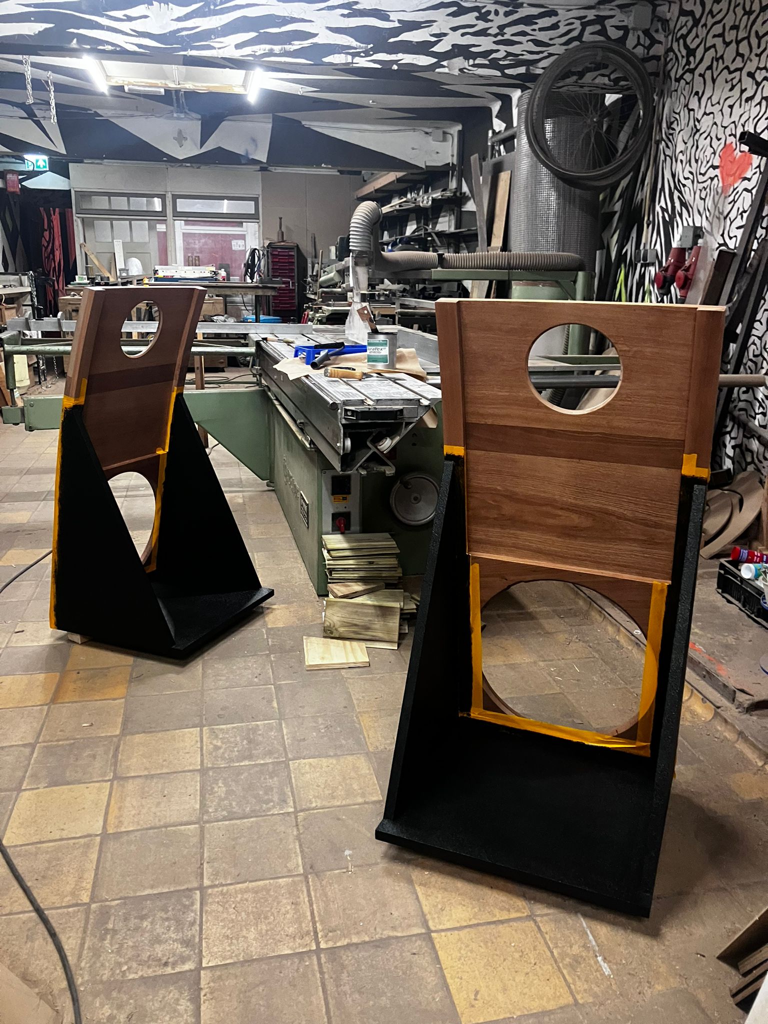

Greetings from Poland!

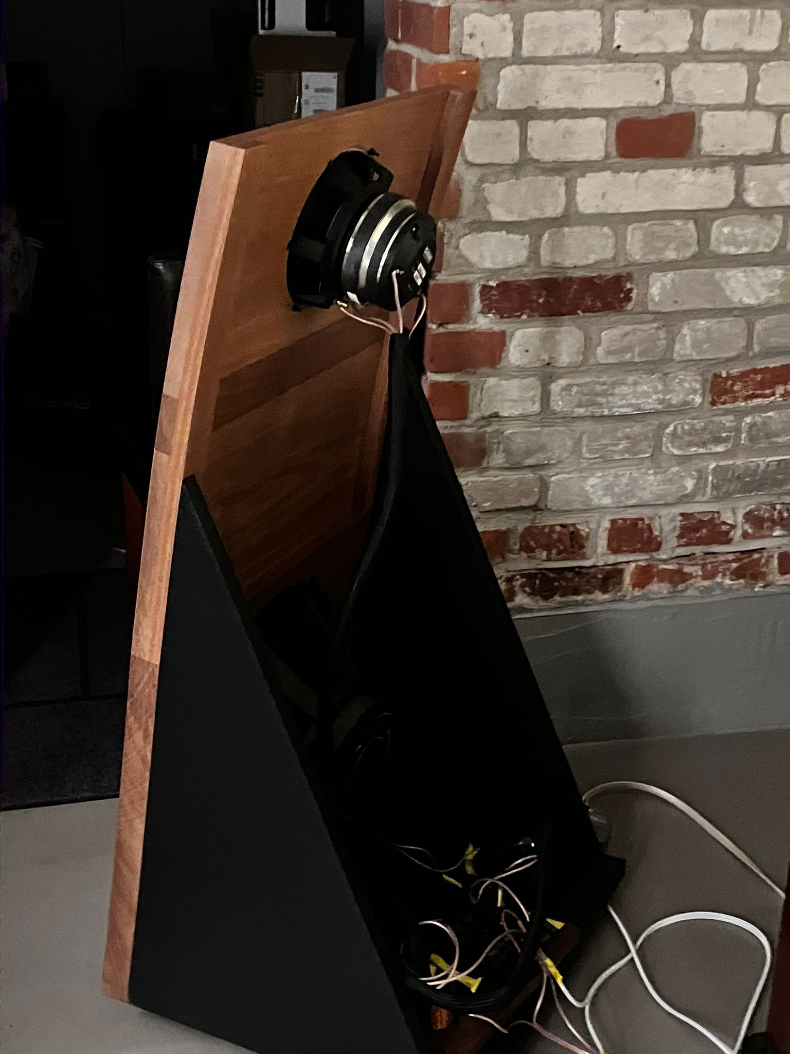

I’m excited to share my rendition @perrymarshall's Live Edge Dipoles (minus the live edge). I am a 20-year-old industrial design student from Poland, currently studying in the Netherlands, and this was my journey with the build 🙂
The audiophile bug bit me thanks to my dad, who has always had a passion for HI-FI audio. Until now, I’d only ever experienced box speakers. About three years ago, the idea of building my own speakers began to take shape. For my 17th birthday, I received a beautiful piece of Sapele wood (a type of exotic African mahogany from the Meliaceae family) and a handful of tools. Naturally, my first naive thought was, "I'm going to build the ultimate best-sounding speaker from what i got." However, I quickly realized it wasn't going to be that simple 😀 For almost two years, that wood 'dried' in my room (which is a politically correct way of saying it blocked the entrance) while I dove into learning about speaker design, some basic acoustics, and physics.

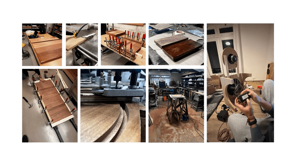

Fast forward to about a year ago, just as I was about to cut the wood for a 100-liter box (the only thing I knew), I discovered some pretty amazing open baffle designs, including Perry Marshall’s Bitches Brews and Live Edge Dipoles. Perry turns out to be not only a terrific speaker designer but also an incredible salesman. So naturally, my design took a 180-degree turn to an open baffle. I decided to trust that it would be something different from what my dad and I had ever heard before. Plus, Perry's design was stunning in its elegance and simplicity and had a convincing track record—likely much better than any freestyle attempt from my inexperience.
Oh boy, am I grateful that I took that route. The speaker turned out to be everything I had hoped for. My main concern was the bass output since I'd never heard open baffle bass before. The fact that 99% of speakers I'd seen were box speakers made me sceptical. My dad loves deep bass, and his previous custom-built speakers delivered impressive low-end performance. But the prototype of my open baffle design alleviated all my worries with a single drum hit @90db.

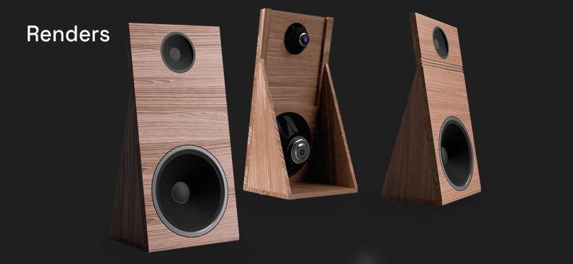

To challenge myself, I redesigned the speaker in CAD and spent half a year building it in the university workshop despite a tight schedule. I had to excuse the big pile of wood as part of my “final bachelor project” exploration, and thankfully, I wasn’t kicked out. Near the finish line, though, I had to find an alternative location to cut out the big 18-inch holes and do the final long hours of sanding.
I have used the aluminium diagram version of the Radian 8'' Coaxials because of well... I'm working with a student budget. I have made a slight modification where the top part of the baffle is bent backwards about 4 degrees + the 5 degrees of the original baffle tilt. But this still resulted in a little too much tilt for the way the room in Poland is set up. So, I have corrected this by adding spikes to the speaker base. Additionally, I have modelled the crossover according to Perry’s design and experimented with my own tweaks to understand how each component influenced the build. However, I stayed true to the original design for the most part.
I brought the bad boys to Poland this summer and I’m fine-tuning the design with IIR and FIR filters to perfectly suit my dad’s man cave, however, the measurements are looking great already, and the wife appreciation factor remained high, even after ditching the live edge. They disappear when moved a bit further into the room than in the picture below, with the wide baffle facing slightly away from the listening position. I knew the sacrifice of having such a 'wall of a baffle' around the coaxial but that was mostly driven by aesthetics.
This project has been a deeply fulfilling endeavour, combining my love for design, craftsmanship, and high-fidelity audio. I’m proud of the final product and excited to continue refining it. My dad has no complaints, and I am inspired to build some more speakers. A huge thanks to @perrymarshall for his generous and professional outline of this open baffle design! Thank you for sharing the knowledge in such an open fashion. All the Best! Jakub

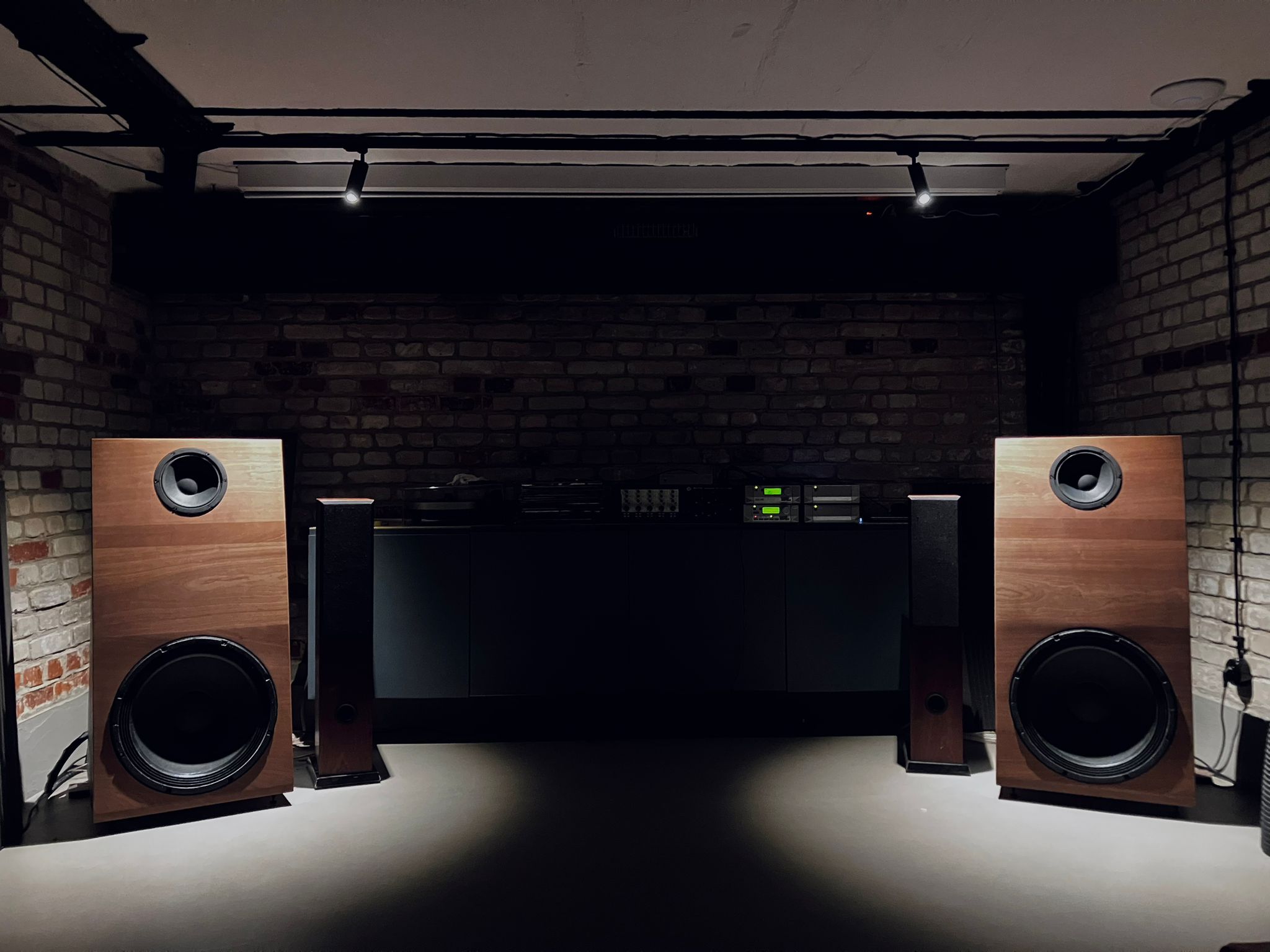

Very nice build! They look great. Have you considered putting some room treatments in that room? It looks like it could benefit tremendously. I'm guessing the sound you're getting isn't really what you were hoping for, and the room is the reason.
Thanks for the kind words! Yes, room treatment is next on my list. I’m aware of how much a well-treated room can impact the sound, and I’ve heard that open baffles can benefit from a bit of a reflective environment so i don't want to go overboard (though I'm not sure how true that statement is).
Currently, the room does have a variety of bookshelves and furniture on the sides and at the back, but I’m thinking about adding a thick curtain to the two-door openings and a rug right in front of the speakers. From then I would probably experiment with a couple of acoustic panels at the first points of reflection. If you have any comments about this setup or specific recommendations for panel placement or types of treatments that worked well for you, I’d love to hear them!
I think the room is arguably more important than the speakers themselves. I just moved from a few states over, just got my listening room set up in an empty room that is actually larger than my previous listening room - but I have no room treatments. It sounds like garbage. I can't even listen to it right now because I know what it should sound like. With all those hard surfaces in that room - it's going to sound like an entirely different setup once you get it treated. It's true that open baffles benefit from some reflection, but you have quite a lot of treating to do before you'd be overdoing it. I put absorptive panels on the first reflection points on the walls and the ceiling. You're also going to need a lot of bass trapping in that room - mostly in the corners. Then you should look at diffusion - some diffusion panels behind the speakers and a few on the walls will make a big difference.
Do some baseline testing beforehand - do some clap testing for echo/decay. Listen to some music and see how good the imaging is - can you pinpoint where instruments are? Do vocals sound centered and real? After you do some testing, try again. You'll be amazed.
Compared to a box speaker which is monopolar at low frequencies, a dipole radiator will output 4.8dB less acoustic power into the room, for the same on-axis spl. Lots of info here: https://www.linkwitzlab.com/AES'98/aes-98.htmYou're also going to need a lot of bass trapping in that room - mostly in the corners.
I think it’s the dramatic lighting accentuating the form of the drivers making them look bigger than they really are. However, the woofers are indeed the Eminence Kappa Pro-18LF-8, and they measure according to spec. I managed to grab them at a pretty good price compared to others on my Excel sheet (Precision Devices PD.1850 and B&C 18TBW100 were some alternatives I was considering).
As for the aesthetics:

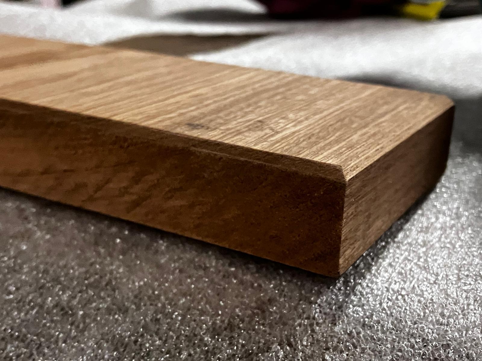

The front baffle is a 4cm thick piece of sapele hardwood coated with a transparent water-based sealer to preserve the natural beauty of wood. It has a 4mm 45-degree chamfer to help mitigate some of the diffraction. The panels are arranged horizontally and joined in a way that allows some harmonious expansion and contraction, with the grain flowing seamlessly from one speaker to the other just because I could. The wings and base are cut from MDF and coated in black textured Duratex, which thins them out quite a bit in a darker room and provides a durable protective seal. I love how the transition turned out between the natural wood and the contrasting black surfaces.

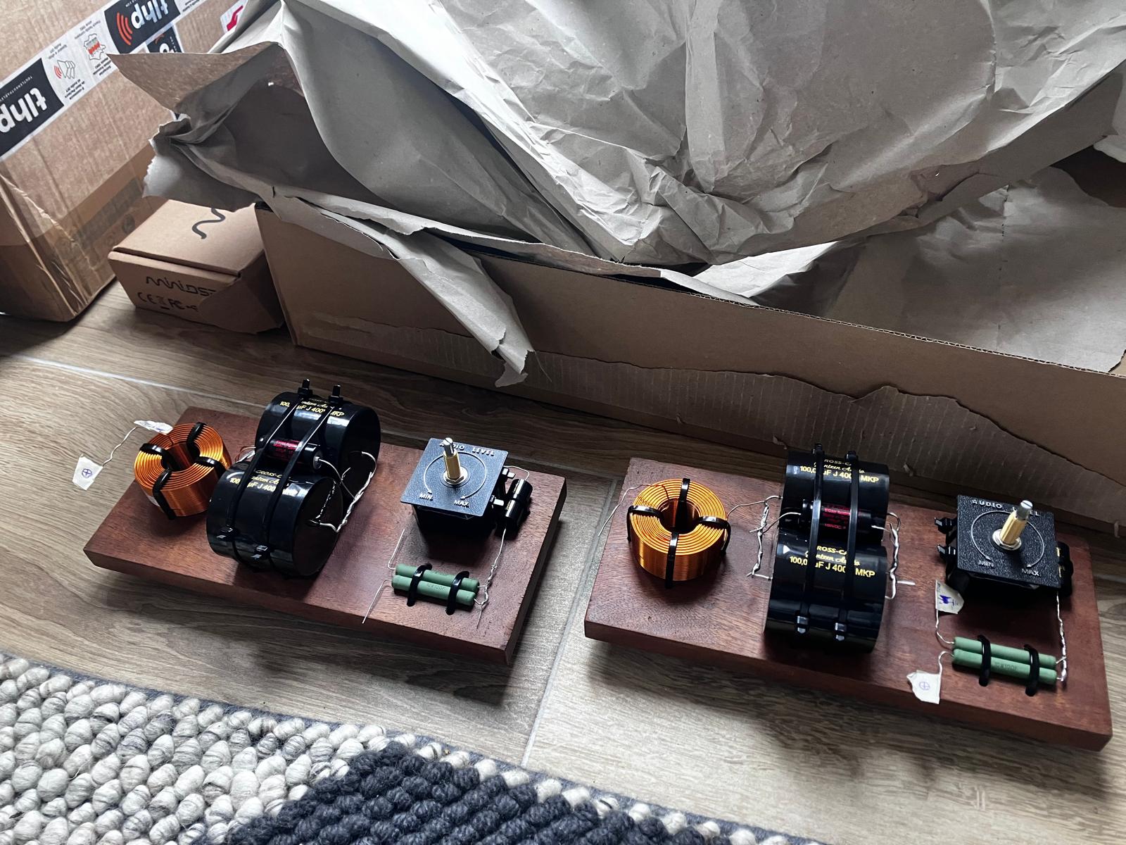

I opted for adding a base, as it serves the dual purpose of housing an external crossover and solidly bracing the U-shape structure. The spikes help to virtually lighten up the speakers by lifting them off the ground, as well as preventing excessive vibrations from going into the floor and back to the baffle.
I tried to be resourceful with the wood and saved up enough for another pair of speakers (no idea what I’m going to build next, but I’m already rubbing my hands together 😛 Additionally, from the scraps, I have assembled a soon-to-be-fancy external crossover. It just needs a makeover and some plexiglass.
But I still need to decide on the final configuration. I’m still not sure whether noise will be a problem, as you pointed out in your write-up. Back in my student house, I had a more affordable multichannel NAD power amp, so I opted for padding the horn down with 10-ohm resistors and pretty much stuck to the old crossover before the upgrade. Now would be the time to determine whether I can ditch some of those resistors and redo the final crossover network accordingly. Sadly, I'm not in Poland for the time being, so I can only test when I'm back. (I used 100+100uf caps instead of 300uf like in the picture).
Now, the setup is a bit more comprehensive. I have a horizontal bi-amp with two Cyrus Power X amps. A MiniDSP 2x4 HD is sitting between them and the Cyrus preamp. It's probably a pseudoscientific and irrational observation, but the MiniDSP looks awfully small and wonky compared to everything else around it—which is probably not a bad thing, but at the same time, it makes me raise an eyebrow.😀 I'm sure DSP has come a long way, but truly, I'm not sure how this little magic box can do so much with the signal without any audible artefacts. Well, the resolution is there, so I'm not complaining, but maybe someone can explain it to me so I can sleep a little better at night?🙂
In the long run, is it better to upgrade to a better DSP unit? Could I notice a difference or go fully active? And @perrymarshall any advice on how I should experiment with the crossover in the meantime?

You shouldn’t need a preamp at all unless you have a turntable.
The mini DSP Flex 8 is quite a bit better than the 2x4HD. it has at least 10dB less noise and better sound. The 2 x 4 HD makes enough noise that with a super high efficiency speaker like the live edge dipole, typical power amp will pass through a noticeable level of noise unless you use an attenuator or resistors like you mentioned.
I think the minimal passive crossover is a very simple attractive option, much simpler than triamping. I suggest you use measurements and IIR DSP to get as far as you can, then add some simple FIR all pass filters to correct the phase. @Carrywaterr
Your project looks great.
