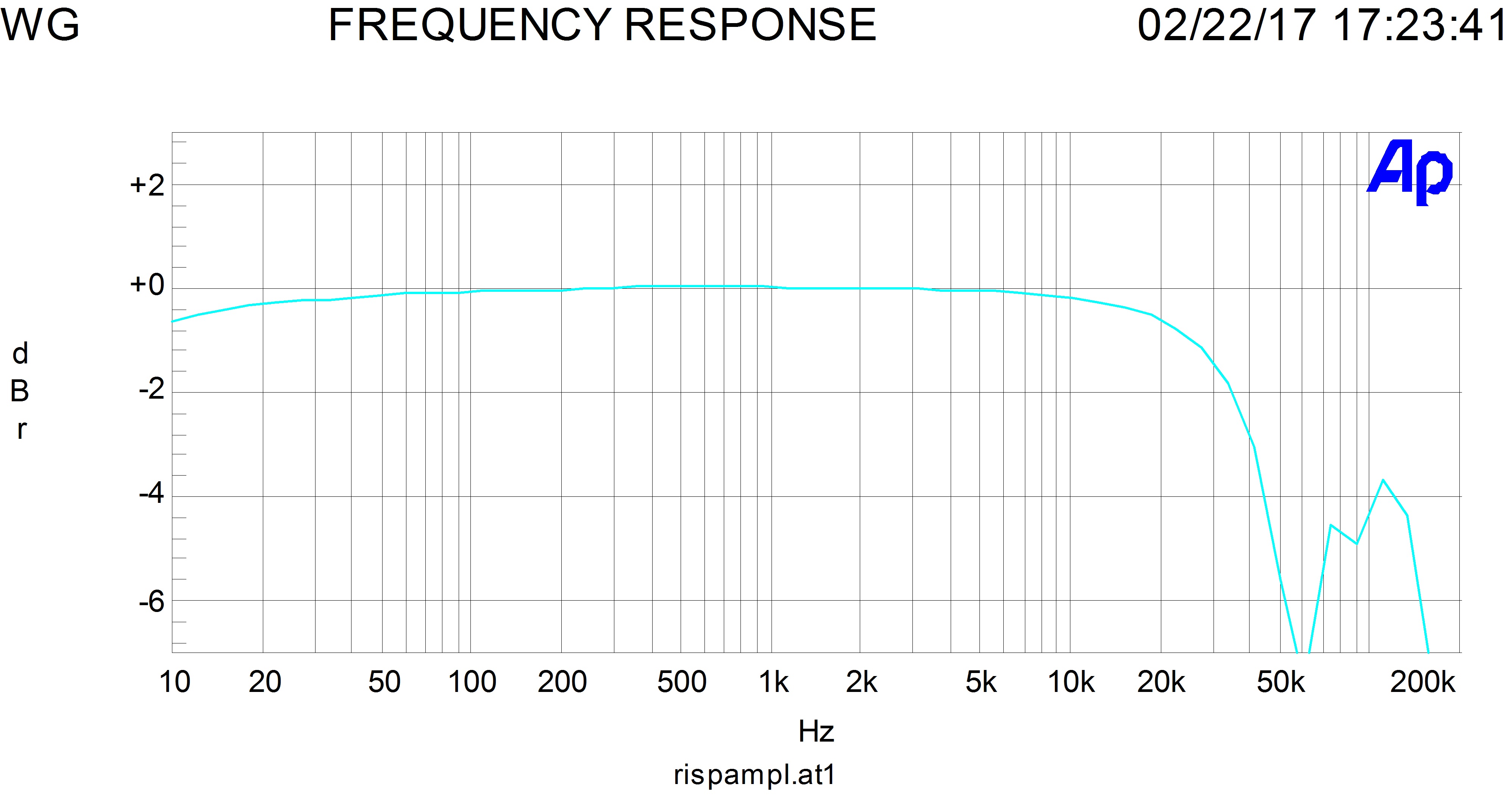

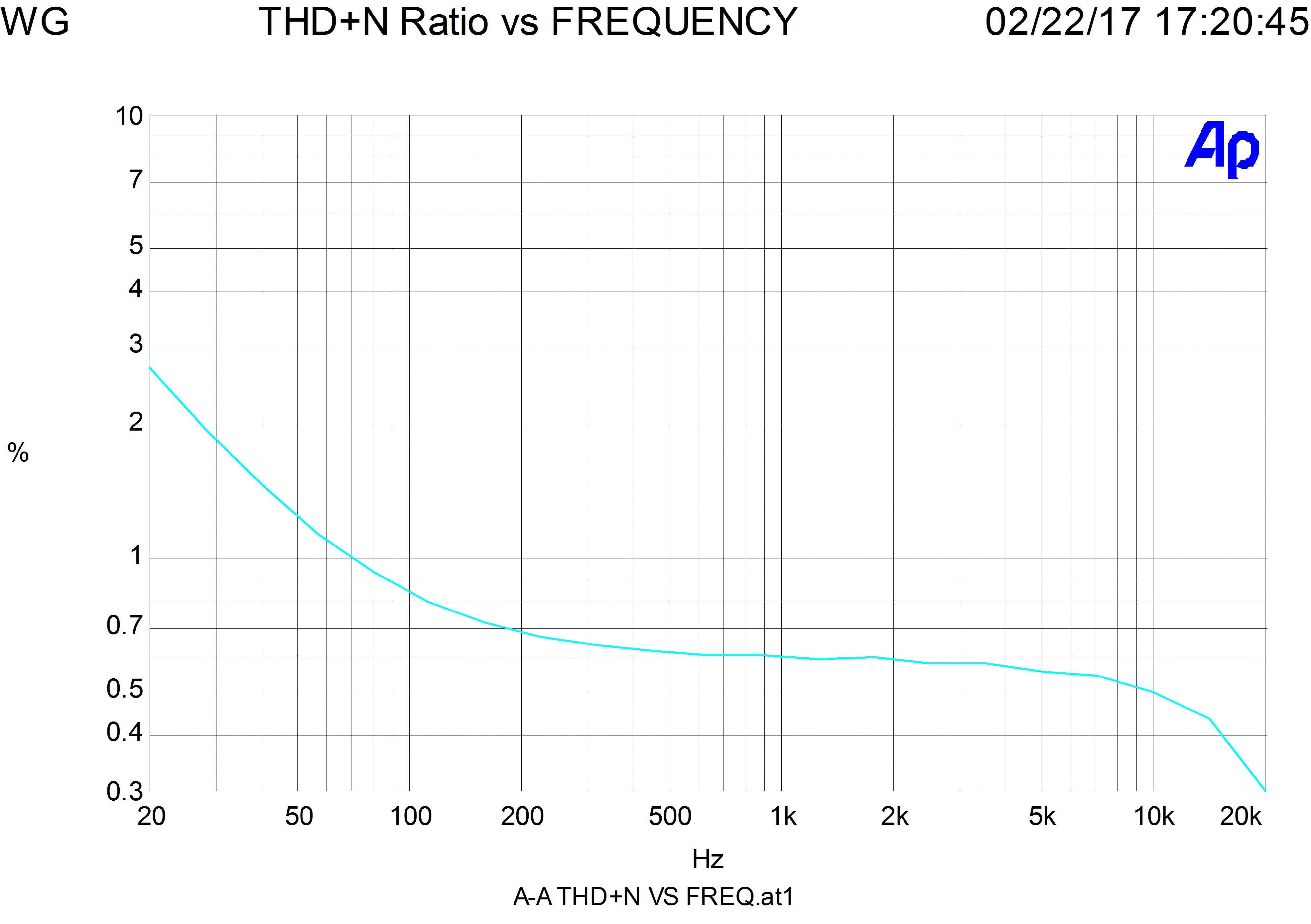

Regarding post 71
I add two diagam about same amp but with normal trafo, the difference with Litz are more evident on freq answer.
The swap within the circuit is exactly one to one, any modification about sensitivity and bias current.
Walter

About Rdc, on normal wire I have about 80 ohm, on Litz about 92 ohm. These values far from your indication; 12 ohm of difference is much more less than 0,1 dB of higher loss I have calculate referred from your value .
Walter
That would be nice when the number of turns for the litz and normal wire transformer would be the same but they are not, so this info is useless.
