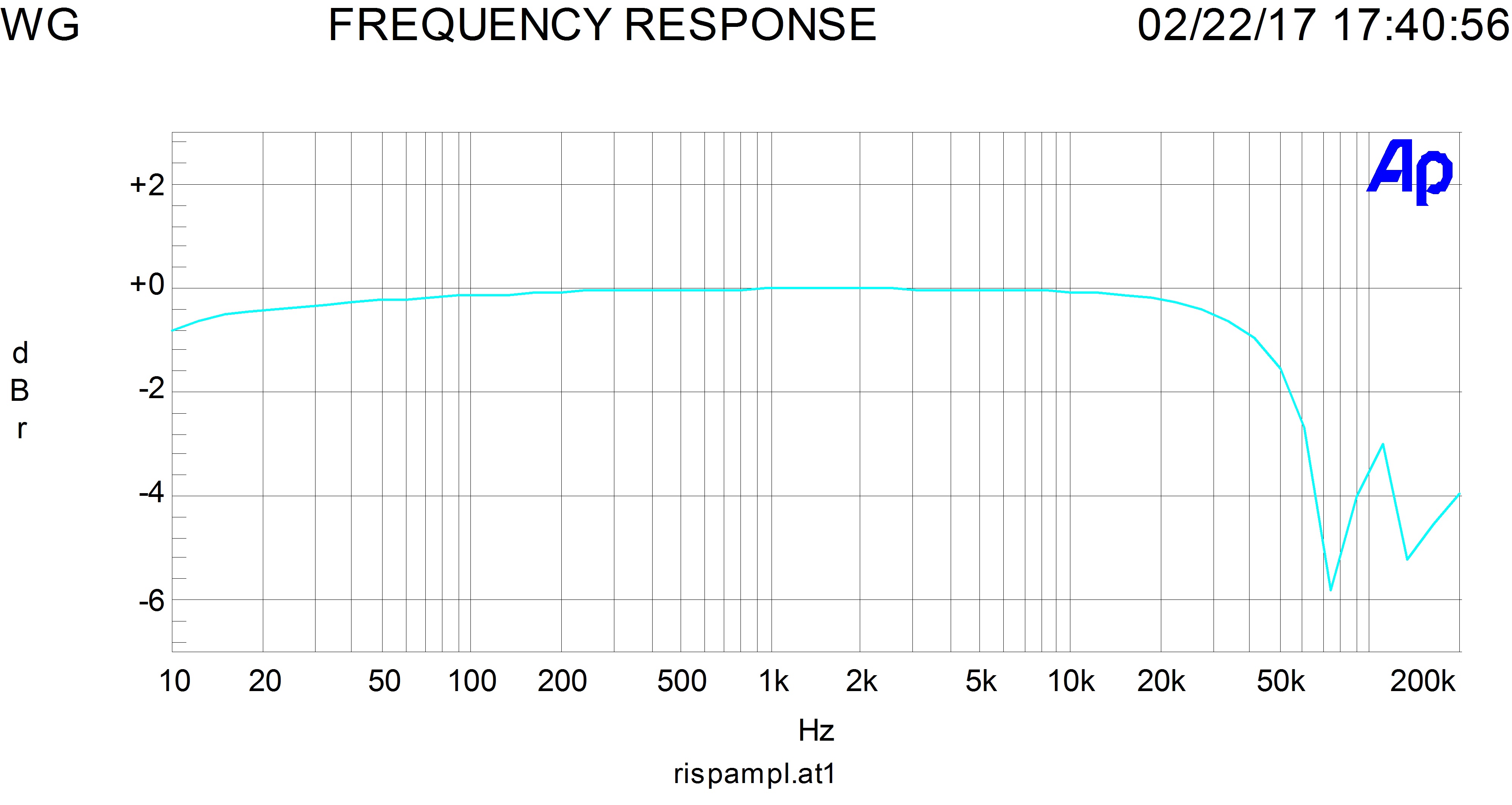

These are some diagram:
1- freq. answer s.e. with KT88 in triode, driven by ECC81, Litz trafo, no FB
good bandwidht, - 2 dB at 50 kHz; at 8 watt same but at low freq. I lost 1 dB at 20 Hz, not so bad.

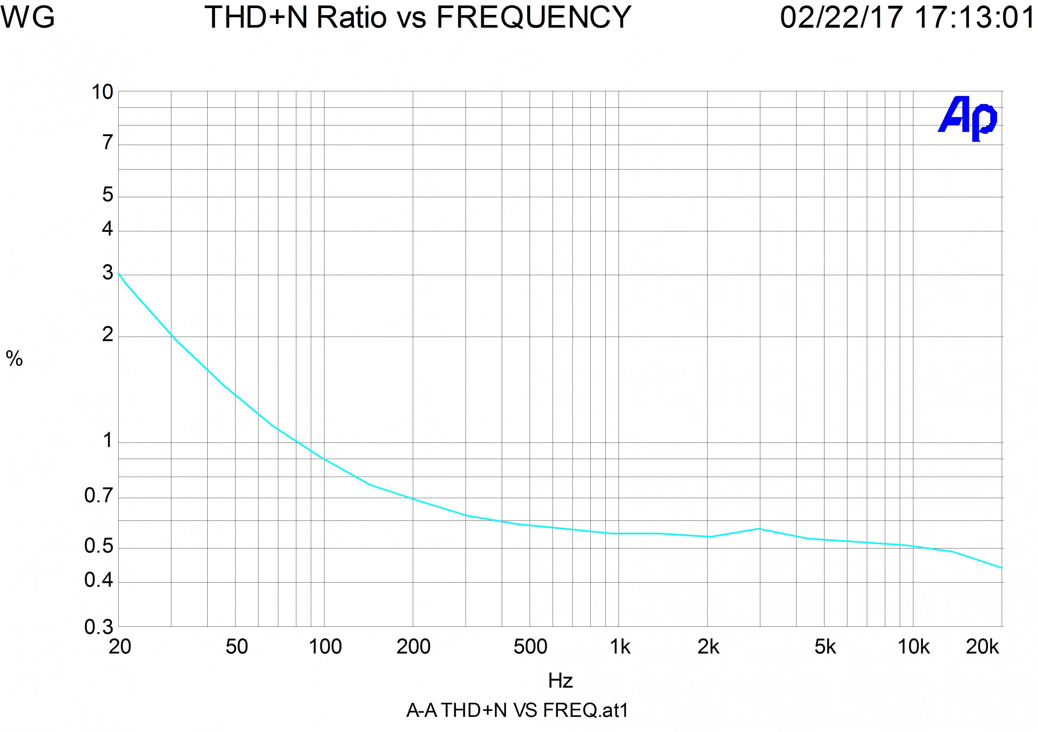

2- thd vs frequency
very good perf but at low frequency I hope to do better
It is a simple project , about 8 watt with 2% at 1khz

Gentlemen,
I read this thread over several days, and am not now going to go through it all again in case I missed some minor detail.
With that proviso, I detected that much of the argument is over practical details vs. theory. Let me then on that presumption immediately ask: Has anybody ever wound several models of the same data? If so you would have realised that even with attention to detail (and layer-winding for better consistency), a normal spread in results can be up to 10%, particularly at h.f. Exact distance between sections etc. is hard to maintain with stiff wire (secondary) and has a direct effect on leakage reactance and interlayer/intersection capacitance. (My experience over several sets of up to 10 transformers, not one or two.)
Also, I detect 'raised temperatures' between members. It doesn't help science and professionalism to be hurt by comments. Suggestions were invited, and human beings are not good measuring and expressive instruments. Yet we get good results by trying to stay objective. (In this respect folks will have to kindly excuse me when I say that in audio hearing tests as arbiter between not too different several components are simply out - it is, comparatively, the worst "measuring instrument" one can get. Just in passing ....)
I accept all that is intended by the gentlemen running these tests and am standing by for completion of the same, but they must in turn understand that basic electronics as proven a multitude of times, cannot simply be wiped aside because a one-off experiment seems to indicate so. (Here I rather frowned at the utterance that RDH is ancient. Please folks ...) If such an indication apprears to be the case (and in my life as a researcher it happened with unnerving regularity! :sad: ) one has to look elsewhere than simply accepting that a basic principle is no longer valid or is not valid in the case under discussion. In this case I am referring to the established fact that Litz-wire has little/no effect on anything at frequencies below say 200 KHz - that naturally, apart from the influence the wire geometry might have.
I will when convenient go back to the nice graphs presented, but let us in the meantime care not to violate experimental protocol too much.
