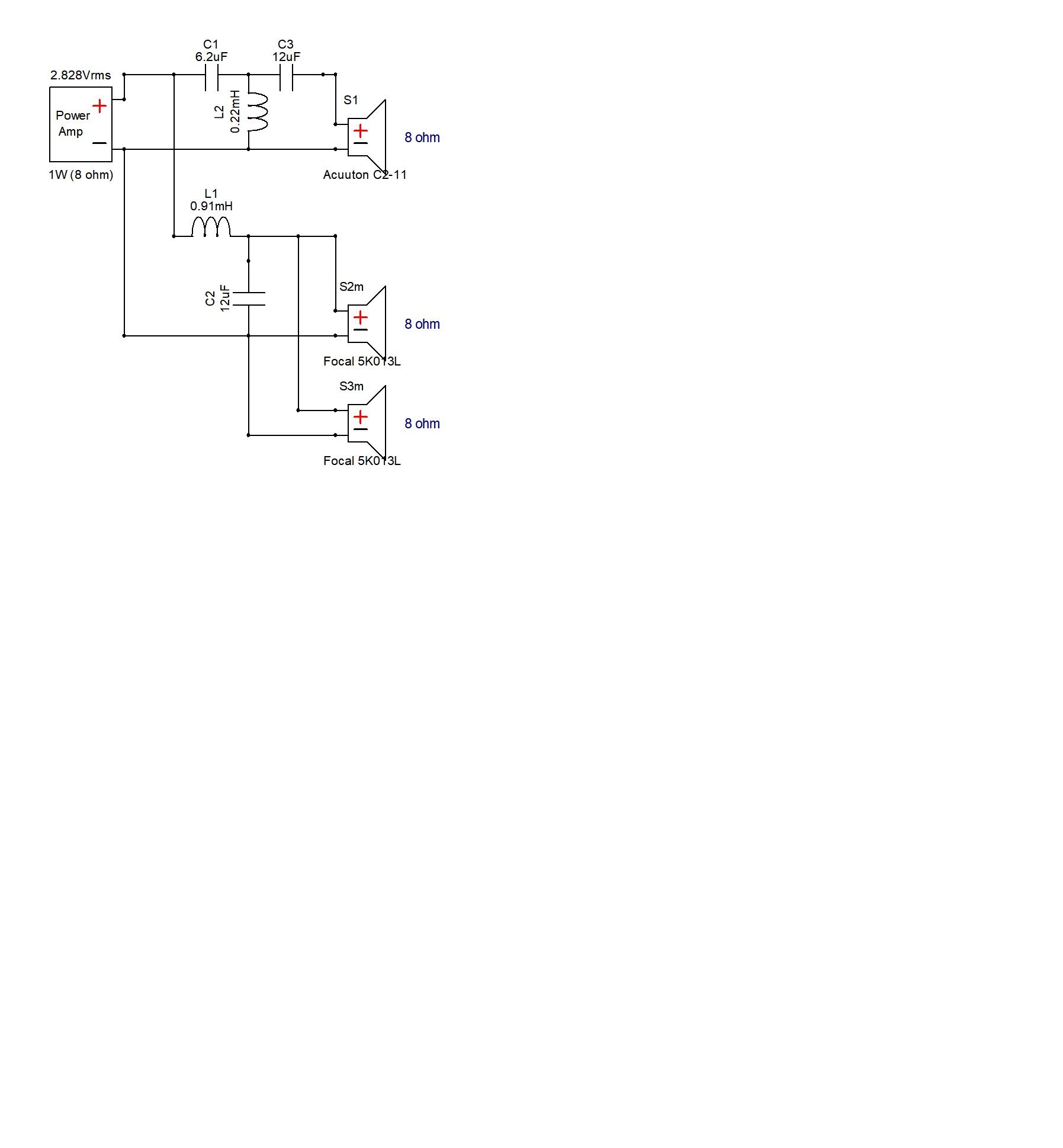

Looking for feedback on if switching Solen 0.91 mH 18G solid core inductors on a pair of paralleled Focal 5K013L mid/woofers (speakers use an Accuton [Ceratech] C22-11 Tweeter) to respective 0.91 mH 16G {16G to achieve same DCR as solid core coils of 0.45 ohm} Solen Heptalitz coils would make any sonic difference in the midrange clarity? I had switched from standard Solen fast caps for the tweeters to Clarity CSA series and was a very nice upgrade in sound for tweeter! Speakers are in MTM -D'Appolito layout by the way. I understand Litz coils might only make a difference for very high frequency but might be a waste of time (and money) compared to standard solid core inductors for mid/woofer only used up to @2.5kHz. FYI using transmission line subwoofers on these these satellite speakers crossed over at 80 Hz.
Should I spend the $50 to get the Solen Heptalitz coils in replacement for standard solid core types as a final upgrade touch for the speakers...or not...?
Crossover diagram and snapshot of speakers attached for reference:
Thanks in advance for any feedback,
Gordon
Curious, where did you get the crossover schematic? Looks like something I designed i the 1990's, no seriously!

The crossover schematic is for the noted (two) Focal 5K013L mid/bass + Accuton (Ceratech) C2-11 tweeter MTM setup. The original concept of this Aria 5 speaker design was from Joseph D'Appolito yet instead of the original Focal T90K tweeter, the Accuton (much better) is implemented. I understand at the time (1994) that the crossover was checked by a speaker designer from Paradigm. I recently have tweaked the crossover design [that you see in the schematic I have shown as the final version] with use of Jeff Bagby's (RIP dear Jeff) PCD v8.0 and XSIM v1.2 after creating the ZMA/FRD files form original Focal/Accuton data sheets. Yes a dated design from the 1990's but the enclosure for these drivers is also something special and microdynamics of the design/implementation rivals electrostatics I auditioned back in '90's! I still enjoy these speakers immensely after 27 years!! They are used with 2 (stereo) transmission line subwoofer cabinets that contain 12" Focal woofers/each. 20Hz no problem!!!
Wow this is all ancient history now. The the best of my Knowledge the original Aris 5 with the Accuton tweeter was created by Swan Speakers in the early 90's. Swan was Joe D'Appolito and Jim Bock. I went to visit their room at CES in something like 92?? cant remember. Jim offered the built crossovers for $750 which was a lot when I was a kid. The problem is that they were designed completely wrong and did not function correctly. I redesigned them and made several of the Systems for several people, the values were super close to what you posted, anyway that was a terrific little speaker and fun to build, glad to see that you are still using them, Im just getting back into building after a 20 year break, just got LEAP and LMS running which was no easy task! Enjoy.
gdillon,
Attached is the original X-over I was originally prescribed and used for 27 years until now when I tweaked it including retrofitting Clarity CSA caps (very nice!) for 3rd order tweeter section. As you will see only minor changes to overall X-over now. The Focal Poly/Kevlar sandwich 5K013L's are so responsive and lighting fast! The Accuton tweet is absolutely wonderful as well - they were less than 1/2 the cost in 1994 compared to Accuton's updated versions today which will require you to let go of a $ G-note CAD for a pair these days. I understand the original x-over was cross checked by Peter Schuck of Paradigm back then. Wow, the good old days when I was 1/2 my current age!!
