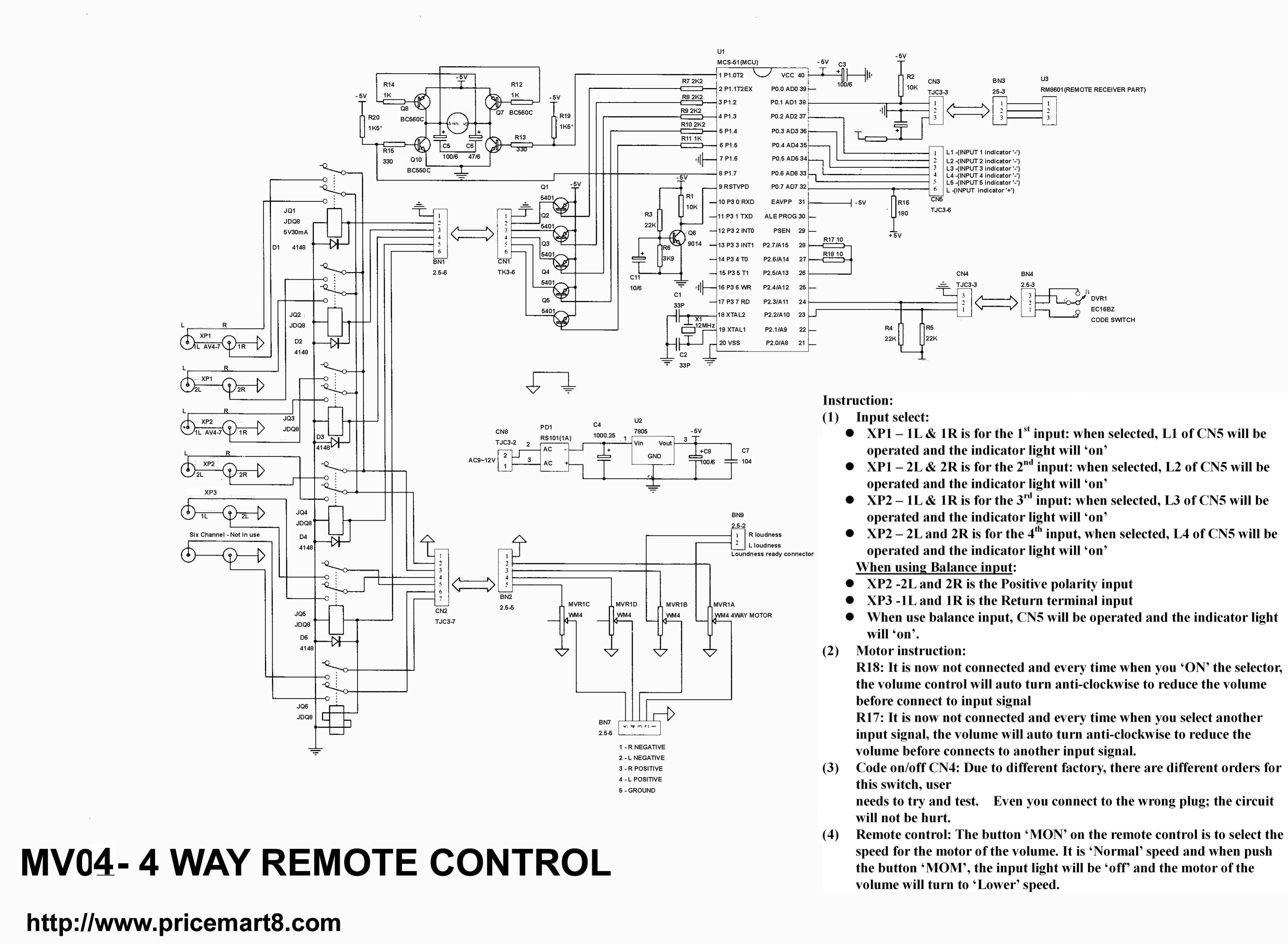

Since there has been some recent activity, and I'm still stuck with one resistor smoking when connecting the power, I'll give my question one more shot:
When I was plugging the power in, the R21 resister started smoking. Since I am a noob and don't read schematics very well, can anyone for starters help me and tell me that resistors function. I would be for ever grateful. The schematic attached.
R21 links the signal ground to chassis earth. It would seem you have a large difference in potential betwen the two. Possibly a higher power resistor would work, but as I don't know why you have such a difference, that could be dangerous.
