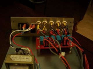

I was wondering how is the best way to add a power switch and a LED power on light to my box containing this?

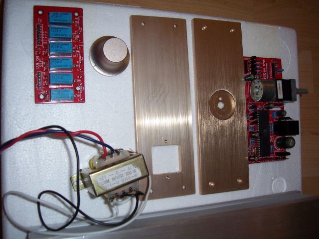

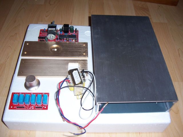

Finally Finished

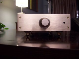

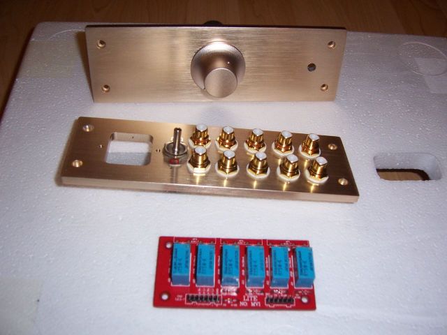

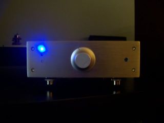

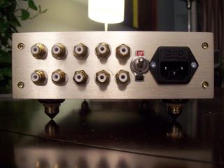

Finally finished my remote control build. Got the case off e-bay and purched the rest of the parts locally.
I decided to go with 3 inputs and 2 outputs since I like to bi-amp my speakers. It was lots of fun and it sounds great. My goal was to use the unit between my preamp and my power amp, but it sounds so good, I might just end up using it as a passive preamp instead.
Attaching some pictures

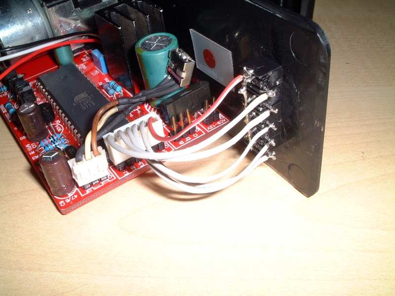

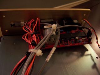

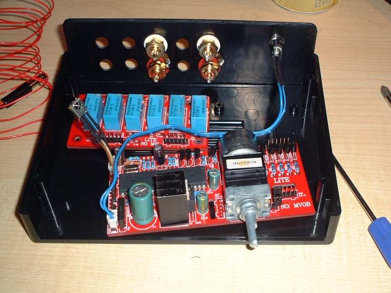

jagrifen said:Does anyone know how to connect the IR module to the pcb?
hope these two pics help

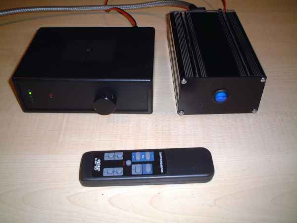

Re: Finally
Top job Nappyhead love the case. How much was the case and where can i get one from ?.
Nappyhead said:In Action
Case
Got the case on this site on ebay, but hey are currently out of stock. I was hoping to order another one to do a t-amp.

Thanx for the pix of the connections for leds and IR receiver. You guys are great!
