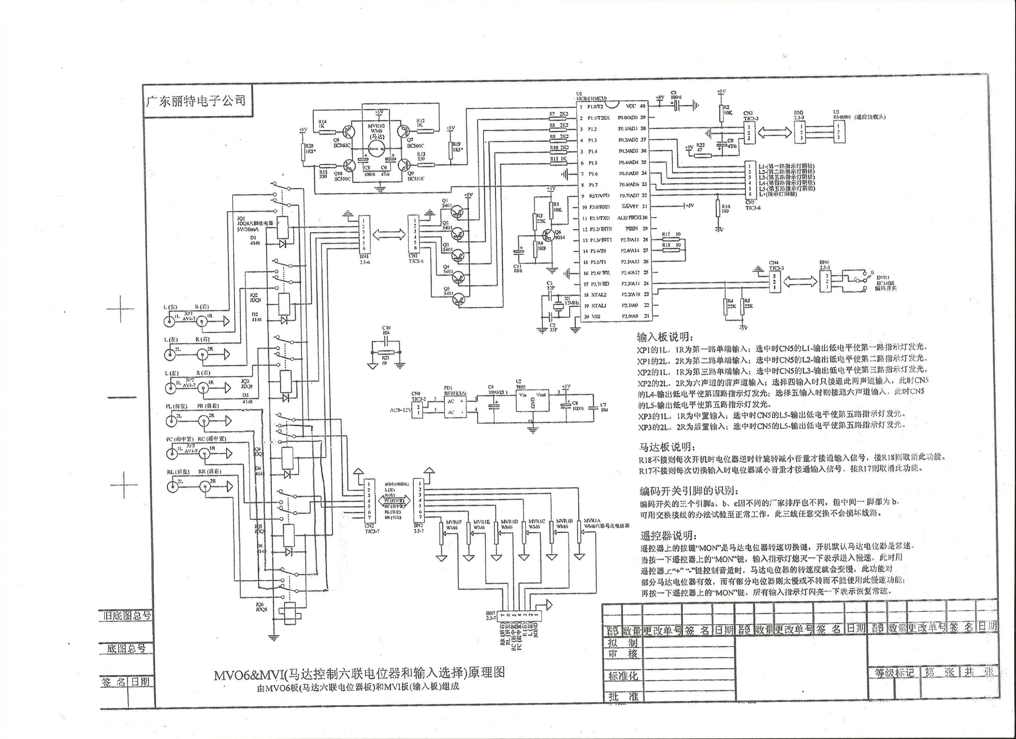

Any schematic (even a draft)?
Thanks!
Of your modification!Do you mean a schematic of the whole kit, or of my modification?

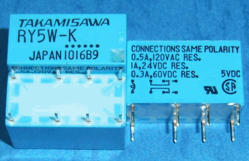

Here's a pic of the relay. You can see which pins are normally closed. Use those on relay 6 for the output from relay 4.

I should have said normally closed; the unconnected pins.Anyway, here's a scan of the modified schematic. Cut the PCB to the sockets to channel 4, and run the signal through relay 6. When relay 4 closes, the signal runs through relay 6 to the normally open pins, completing the circuit to outputs 4. When relay 6 turns on it breaks the link to 4.

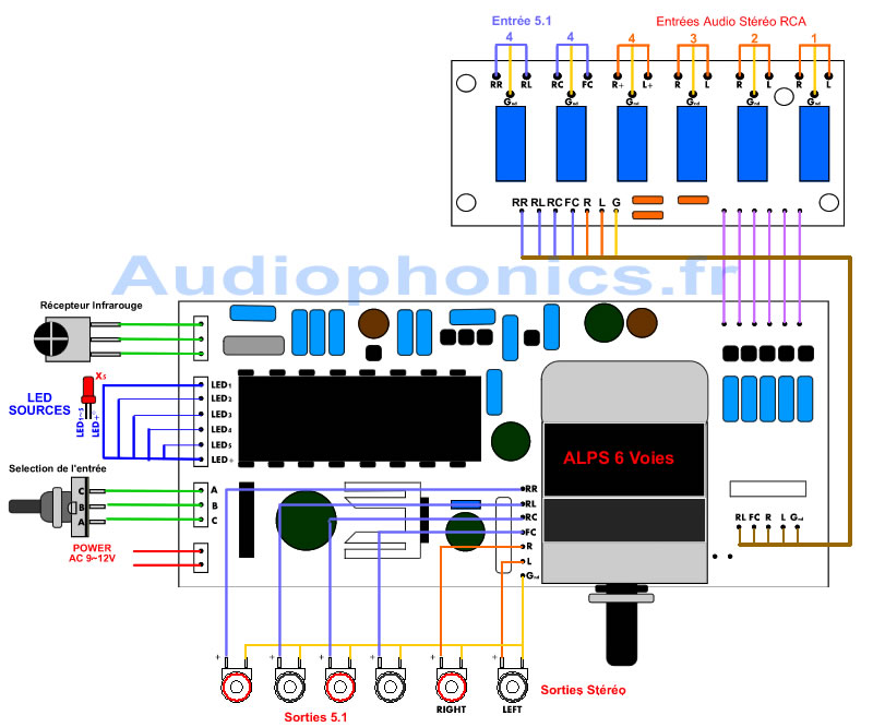

Explained on this?
Not really. That shows how everything is connected, but doesn't tell you how to turn off relay 4 when 5 is on. I am using the kit to control an LDR attenuator, so only use one channel of each relay, and don't want several relays switching together. There is no audio signal running through the volume control and relays, just the control voltage for the LEDs in the LDRs.Explained on this?![]()

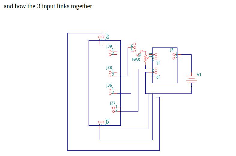

View attachment 515207 This shows 3 inputs; I have 5.
I am planning to use it for multiple sources (tape/pickup/FM-radio/e.t.c) but my draft build shows only 4 sources (as you confirmed).
On my above sketch, how do you connect them?
Can't do it using your sketch. You have to follow my modified schematic, cutting traces and linking relays. Then use inputs 1-5.
Oh, and link L to FC, and R to RC on the relay board. And use outputs RIGHT and LEFT on the main board. I think!
