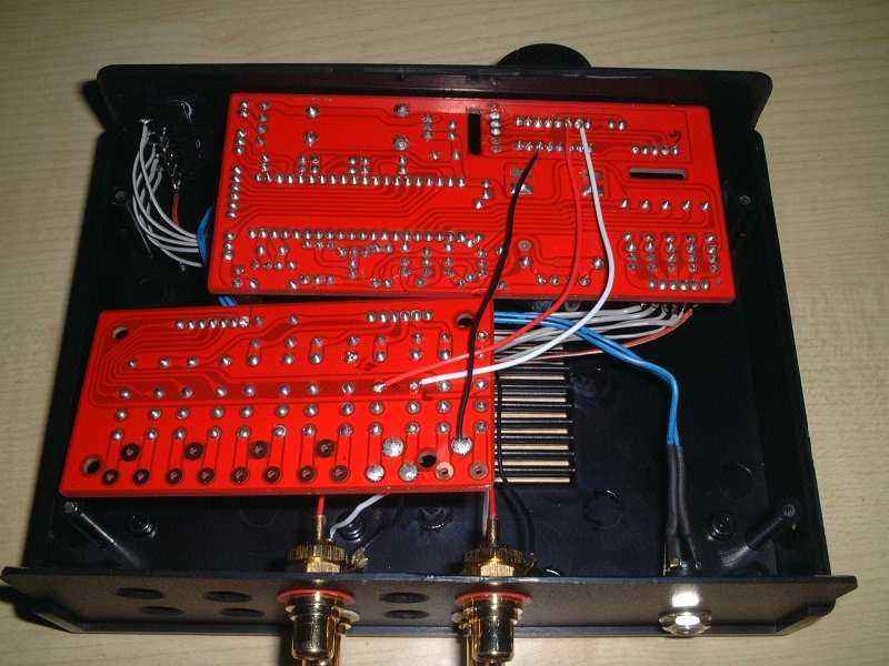

Here are a lot of pictures of how i put all together. The reason why it’s only got one set of inputs and outputs connectors on it . That’s all the connectors sockets that i had in stock at the time .
I have the same kit and have been waiting to hook it up. You made it easier for me. One question, what are the connections between the two boards on the bottom for?

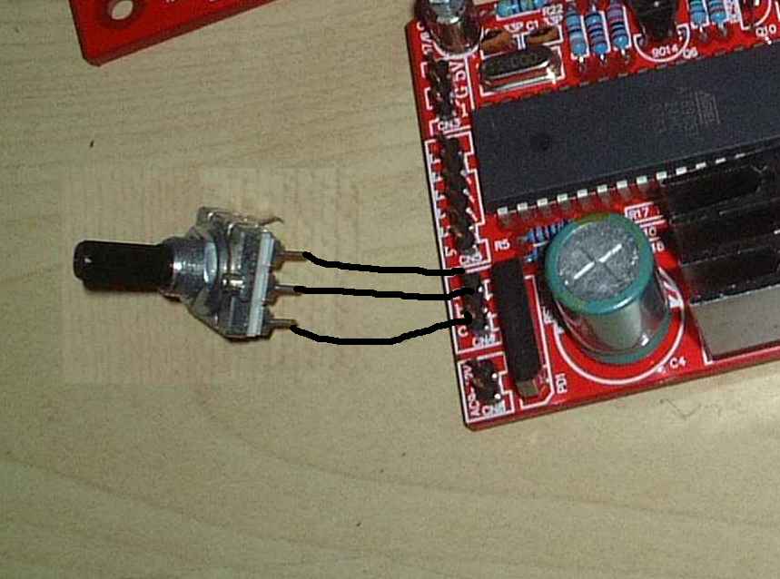

Thanx a lot, this was very helpful. 🙂 I think I will also like to have pushbuttons for input selection on the front of my amp to be able to operate it even without a remote. Do you know if that will be possible?
What are the red, white and black leads soldered between the boards on the underside?

The wires are the output on the vol pot strait to the output on the relay board why use copper tracks when you can have silver plated copper wire. And there is less connections

NO way that i think of because it uses a rotary encoder for selecting
