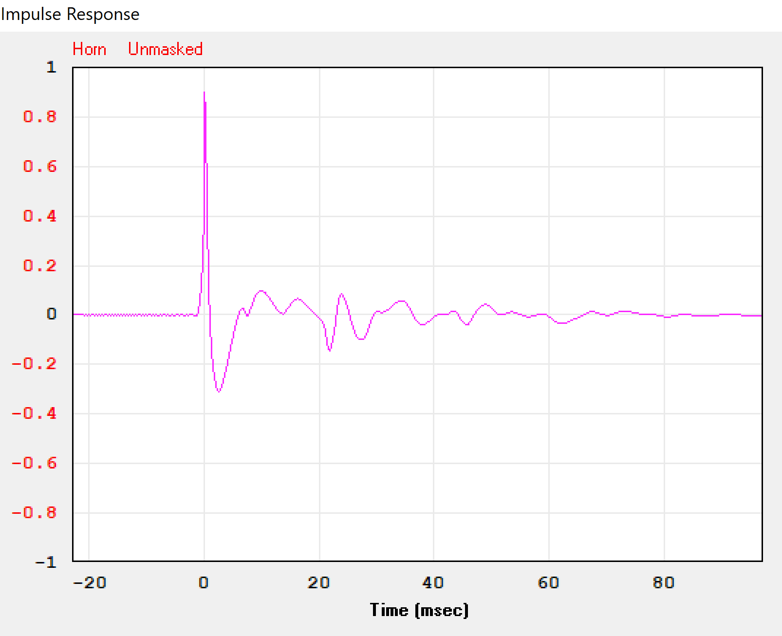

Step response of some of these big folded horns shows 'ringing' continuing for over a quarter of a second after the signal has ceased.

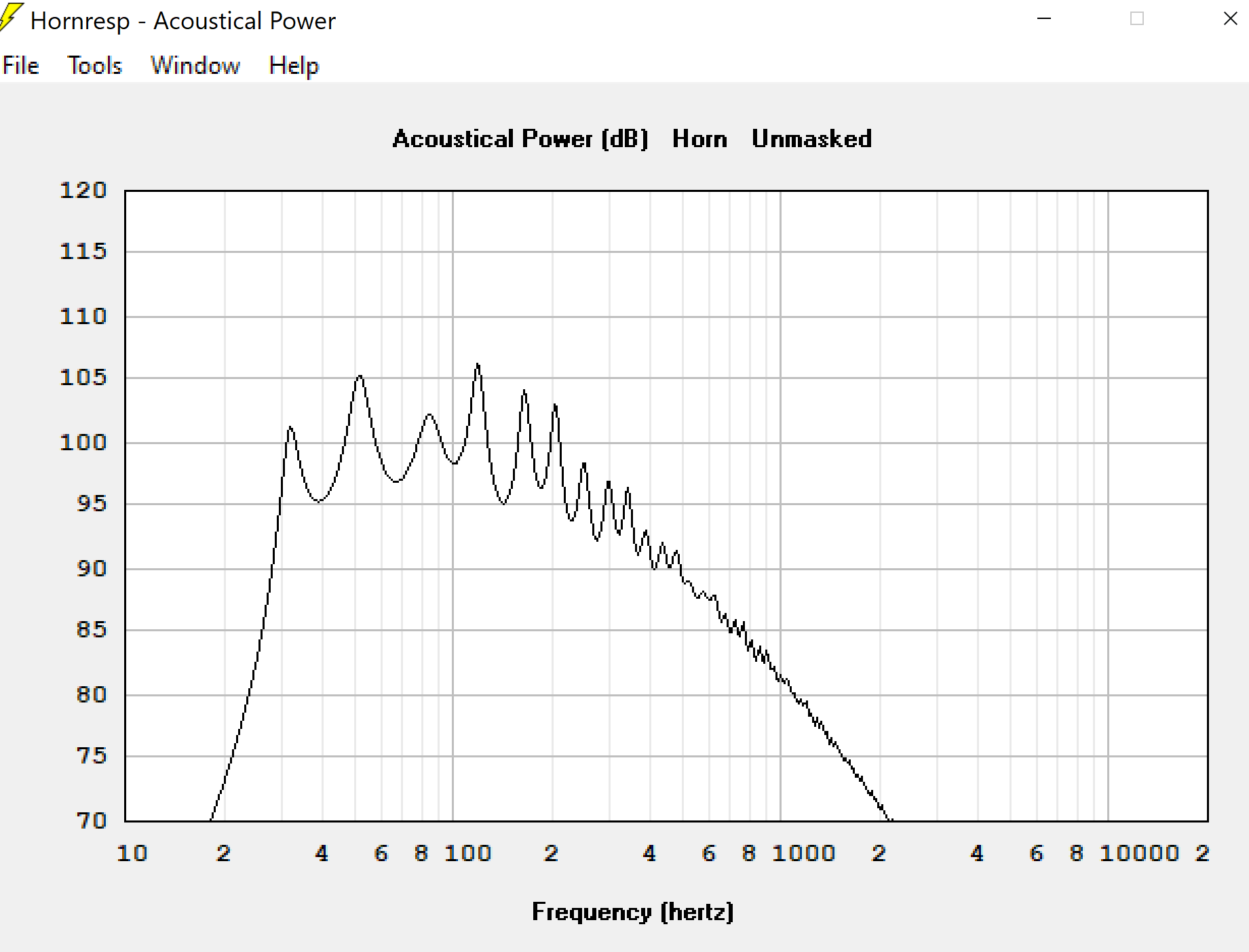

This is the Hornresp modelling of your horn:
Thanks guys for the insights. I have no doubt you're correct that the poor impulse response is a factor. Is OP planning an entirely straight horn?

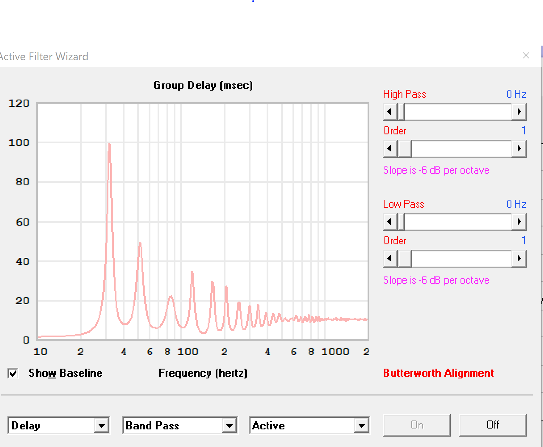

Seems like I would have checked the group delay when I simmed but apparently not. It's been so long I can't remember.
Sheesh! That's going back to the days when 480p was the video 'hot ticket'! I was doing part time high end HT, trade show Sony FP HT systems and one of their EEs designed them and IIRC the channels, etc., were Owens Corning, but didn't find it in a quick search plus apparently has now been obsoleted with its latest 700 series bass traps, so best I can do is suggest researching diaphragmatic, limp mass, resonators.GM, can you provide a link to details of this construction? thanks
I've been thinking about this. When I asked GM why I had so many squiggles in my response, this is what he said:
Because there's an impedance mismatch at every [poor] termination back to the throat, modulating the driver plus the straight section of pipe adds extra set of harmonic reflections.

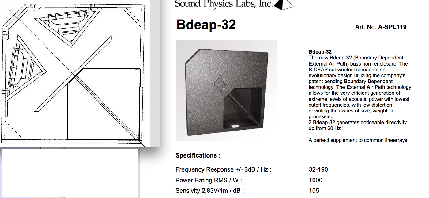

If you were to use room walls for the final expansion as in Klipcshorn or Tom Danley's "Bdeap 32" designs, resonances < 150 Hz shouldn't add any problem that won't be in the room.
Scaling up the 45" x 45" x 22.5" "Bdeap" from 32Hz to 20Hz would be relatively easy, as would it's construction.
