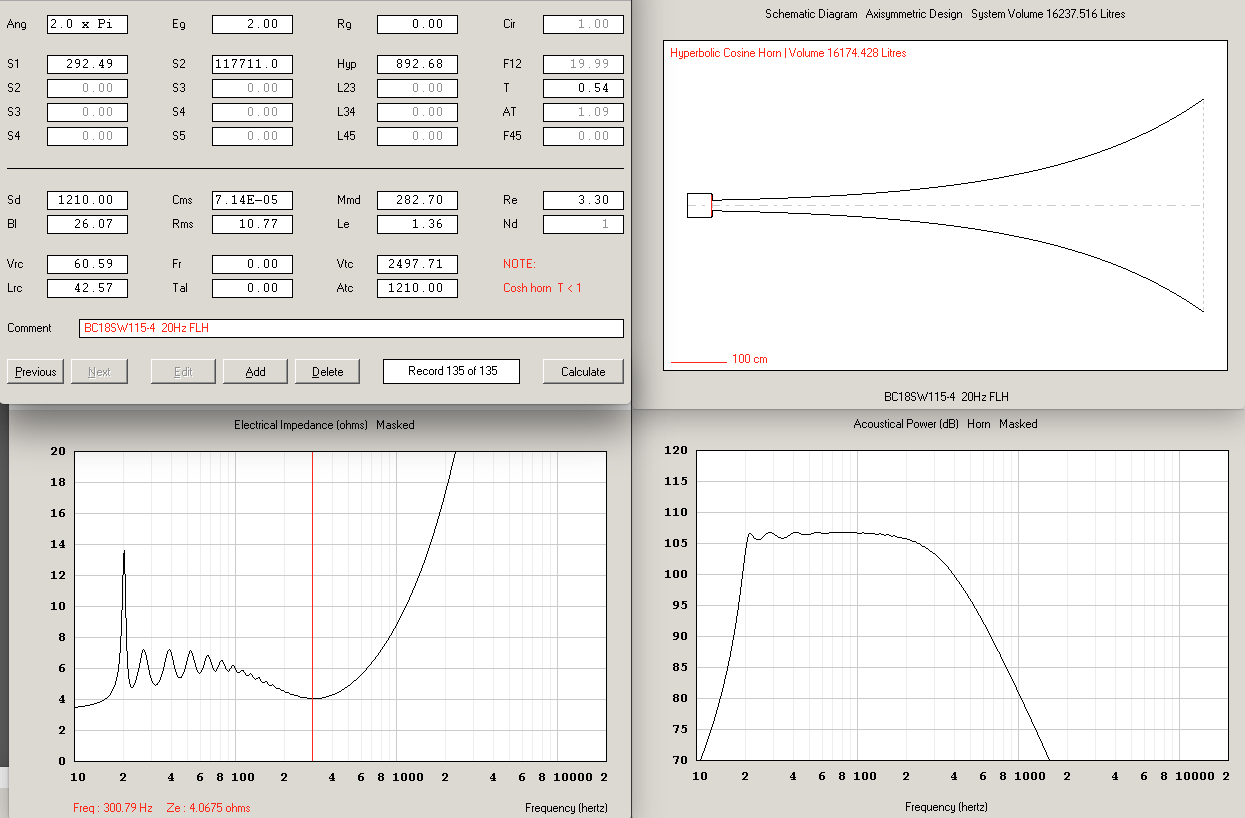

For the rest I managed to miss your earlier post and for now just going to attach the high QT modded specs driver HR sim I did to confirm as much as I could, so of course it doesn't account for the damped terminus/mouth/wall and how much BW at each end might get rolled off, i.e. may need to be a [much] wider BW where you're 'chasing your tail' trying to get at least a -25 dB outdoors.

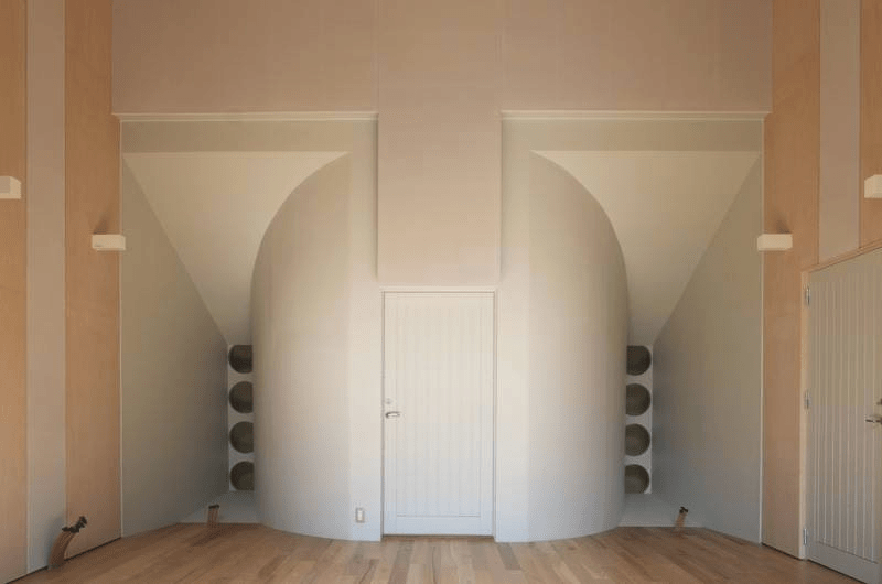

Awesome, thanks for pulling these out. The first one, the royal device, is the closest to what I'm envisioning, because they did a lot of modifications to the room to make it act like a continuation of the horn and channel the bass to the listening position. Best I can remember they achieved 110db at one watt at the listening position.All three are extreme but not radical compared to the room being in the horn.

I can't make heads or tails of that right now, I would need to look at hornresp to make sense of it; I currently don't have the ability to run it on my mac. Gonna buy a cheap windows laptop soon to run it.Google is your friend. 😉

logicaly what you want is your room to be a planar wave tube as this has uniform SPL. The neareast thing to this is a double bass array or single bass array. So you should build a simple recangular room and just cover the front wall with subs (they can also be spaced upto a quarter wavelength) and the rear with the absorber.

Dusty,I can't make heads or tails of that right now, I would need to look at hornresp to make sense of it; I currently don't have the ability to run it on my mac. Gonna buy a cheap windows laptop soon to run it.
Using the freeware "Wine" can create a virtual windows machine, allowing you to run Hornresp on mac.
David McBean has been busy adding features to Hornresp since you last used it.
You can now model multiple entry horns, which combine multiple pass bands on a single horn. MEH solve lots of problems that are unavoidable when using separate multi-way horn systems like you are dreaming of.
Here is what you are contemplating as far as a flat response 20-200 Hz straight horn:
Coming in at over 30 feet long, folding it would eliminate at least 50% of the materials needed, and acoustically filter harmonic distortion when driven at high SPL, which could crumble adobe...

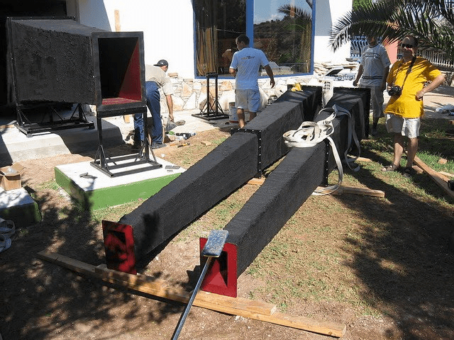

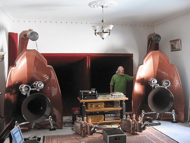

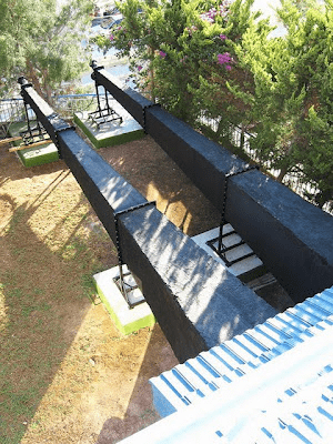

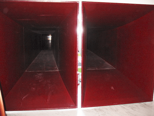

.... 3rd one looks like the all horn system in Cyprus.

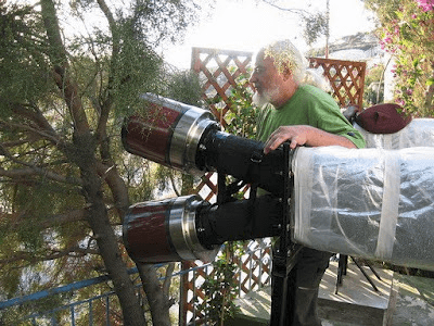

Dan the audiophile guru built those 15m long bass horns to finish his six way horn system when he was in Cyprus. This project clearly put him into legendary status. The info is all over the net and makes for interesting reading about the human condition, dreams and the pursuit of excellence.
"He had a 6-way custom hornspeaker system with two very long straight bass horns. On stilts, those protruded deeply into his garden, pipes tightly wrapped in moisture seals and terminated in dual woofers each at the far end. In the room, their rectangular horn mouths were large enough to walk in for a bit. Some light pipes all the way to their ends made for moody ambiance at night. Both side walls of his room were entirely covered in LPs floor to ceiling. He had a vast selection of truly rare NOS tubes. Further rooms sported assorted Avantgarde Acoustic hornspeaker systems. His wine cellar contained an enviable selection of exotic valve amps from Kondo, Supratek, Yamamoto, Wavelength, Wyetech Labs and many more" 6moons
He used four drivers:
Hanging in the garden
Installation needed concrete footings and a construction team:
Bass horn mouths coupled for deeper bass extension
