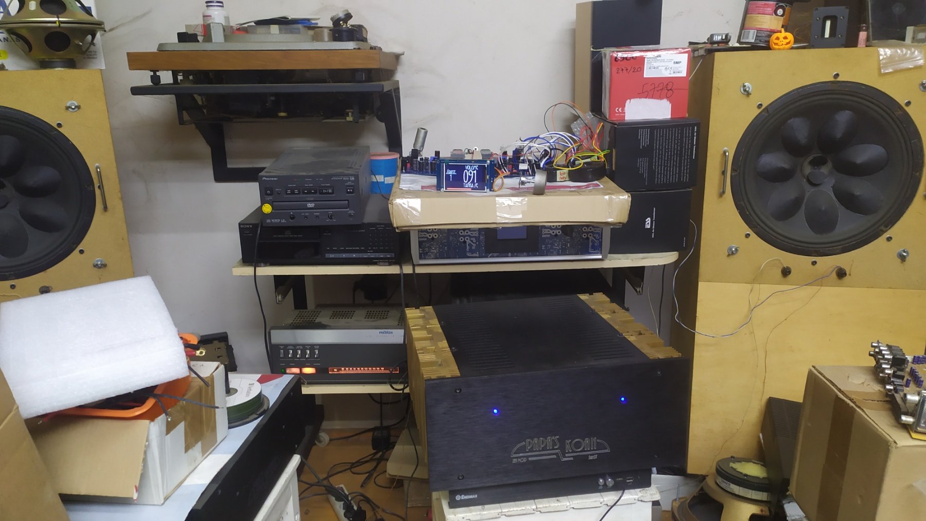

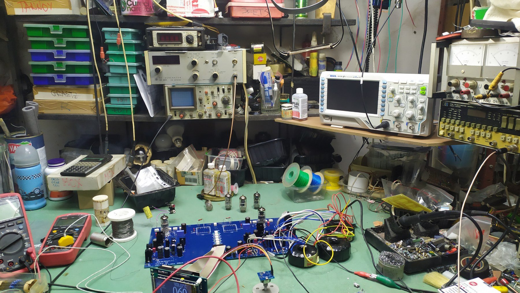

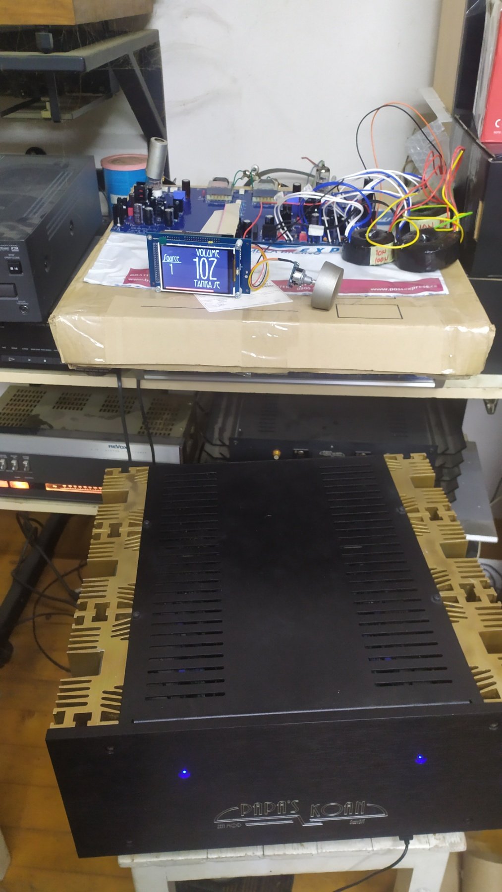

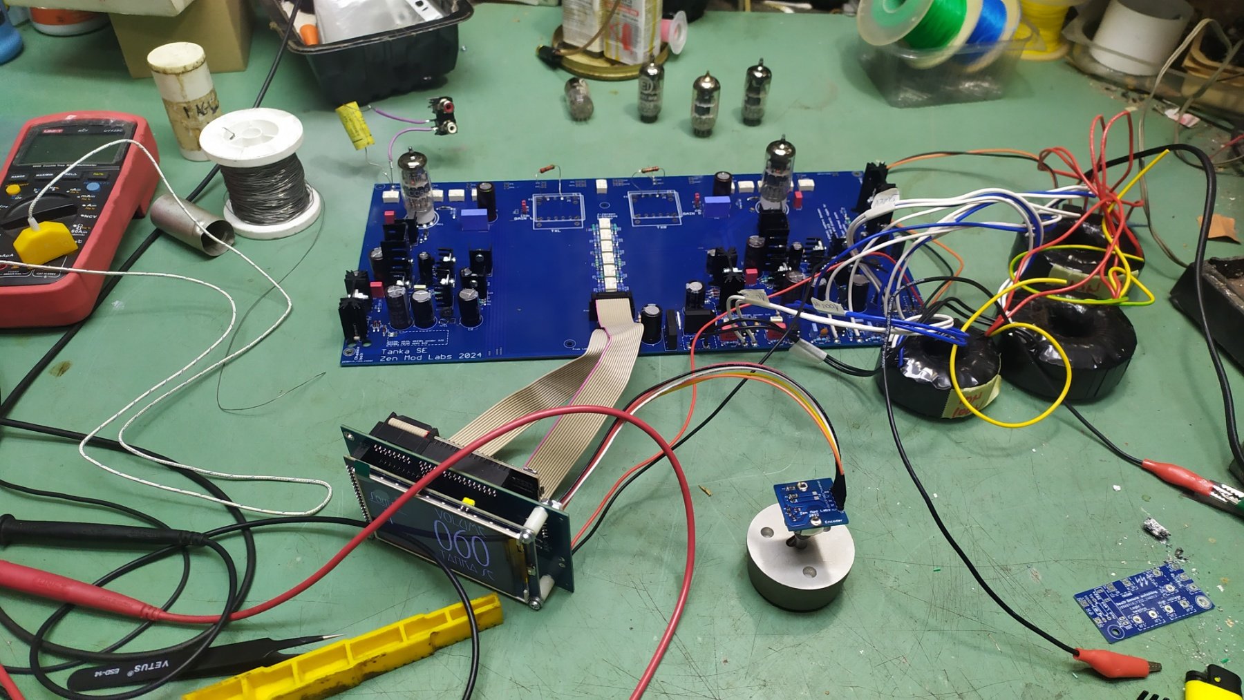

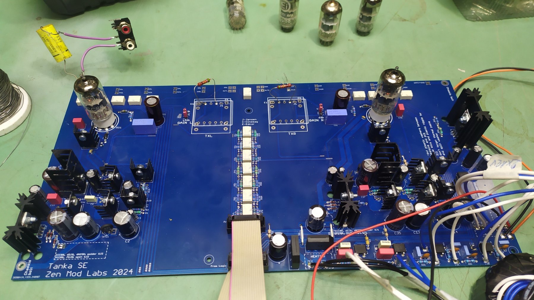

working on Tanka SE right now

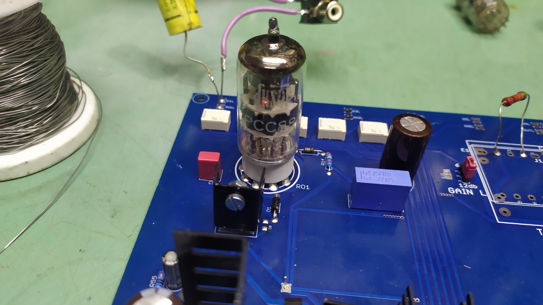

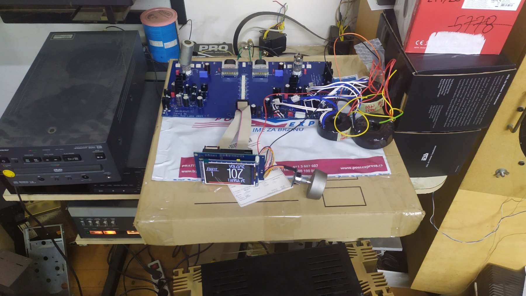

motherboard functionality confirmed, had some troubleshooooooooooting - oscillations, but in the end - ZM Omnigremlin is to blame - put old tubes in to check basic (static) parameters and forgot to put new ones with signal applied
so, few caps (pico) not needed, few caps (rails decoupling) soldered back :rofl: and everything is peachy
just to find big enough particle board to put it on, then on top of my Iron Pumpkin Industrial, to actually hear it
