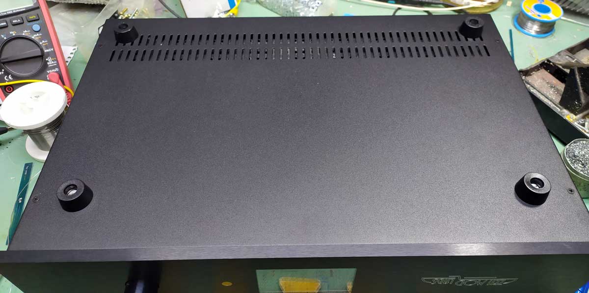

That looks pretty neat - half way between Iron Pre and Iron Pumpkin?
sort of

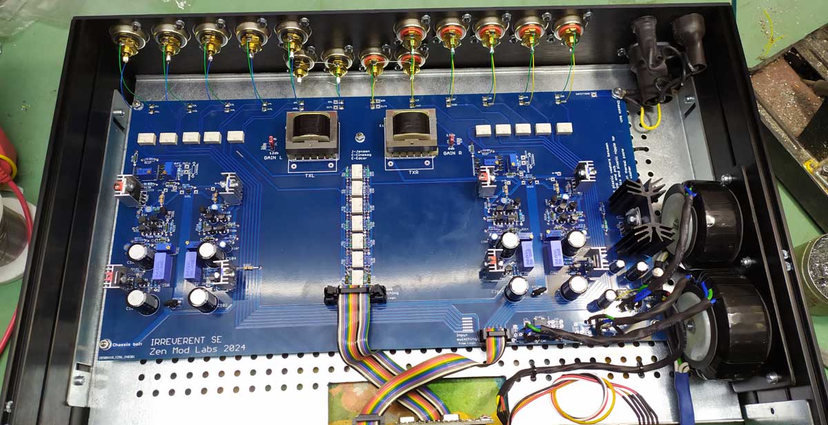

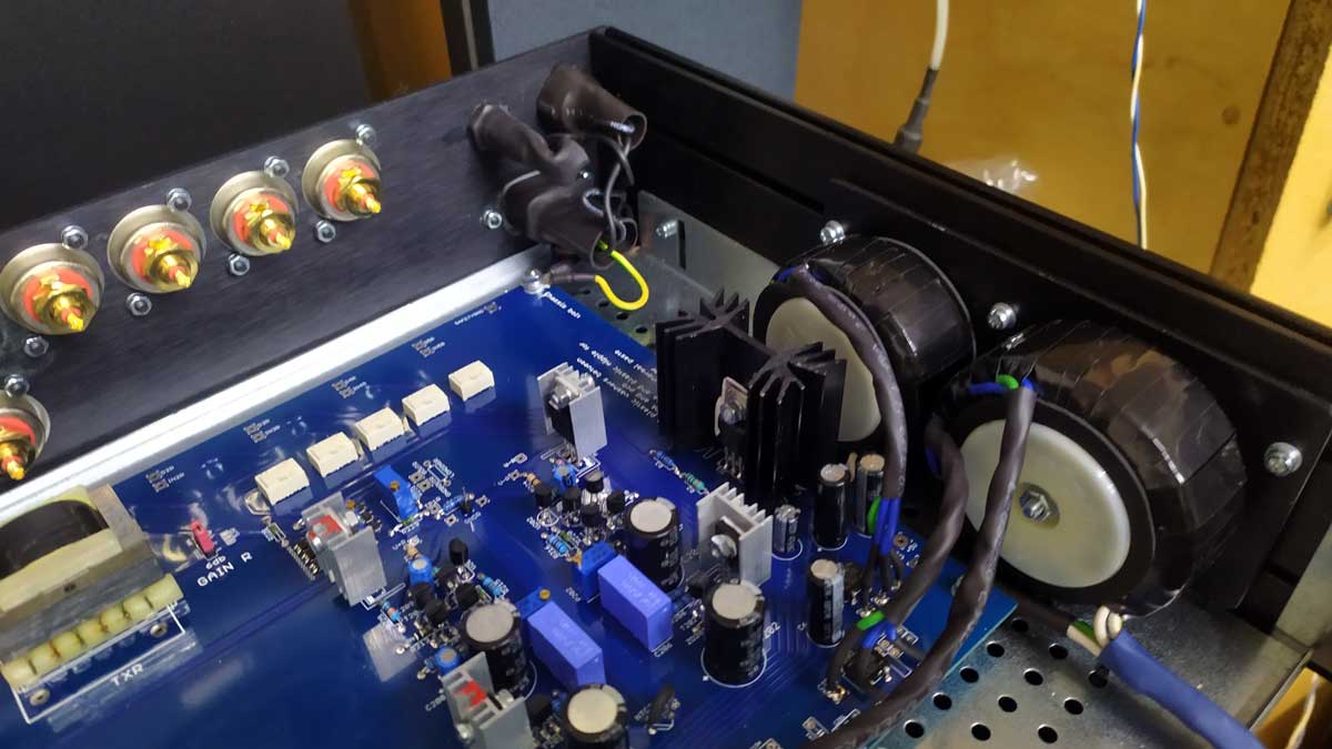

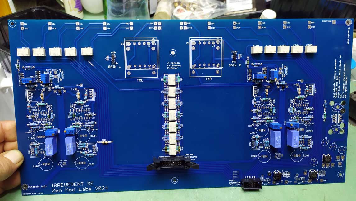

pretty much - completely unnecessary fancy Iron Pre SE

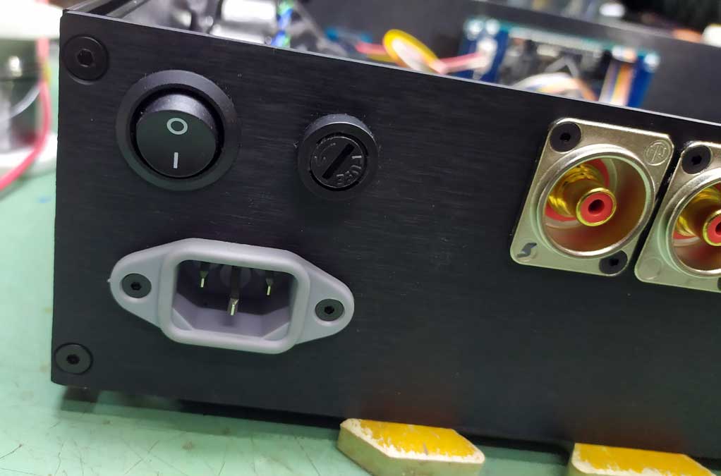

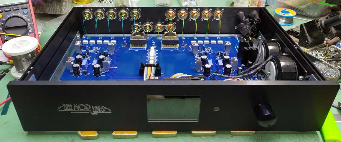

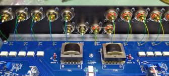

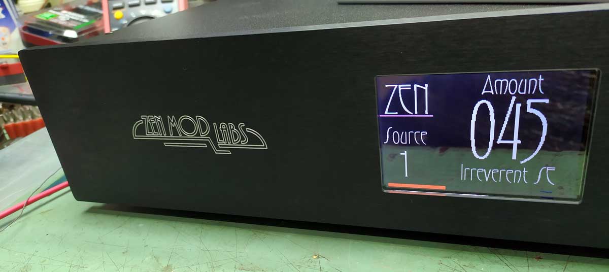

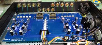

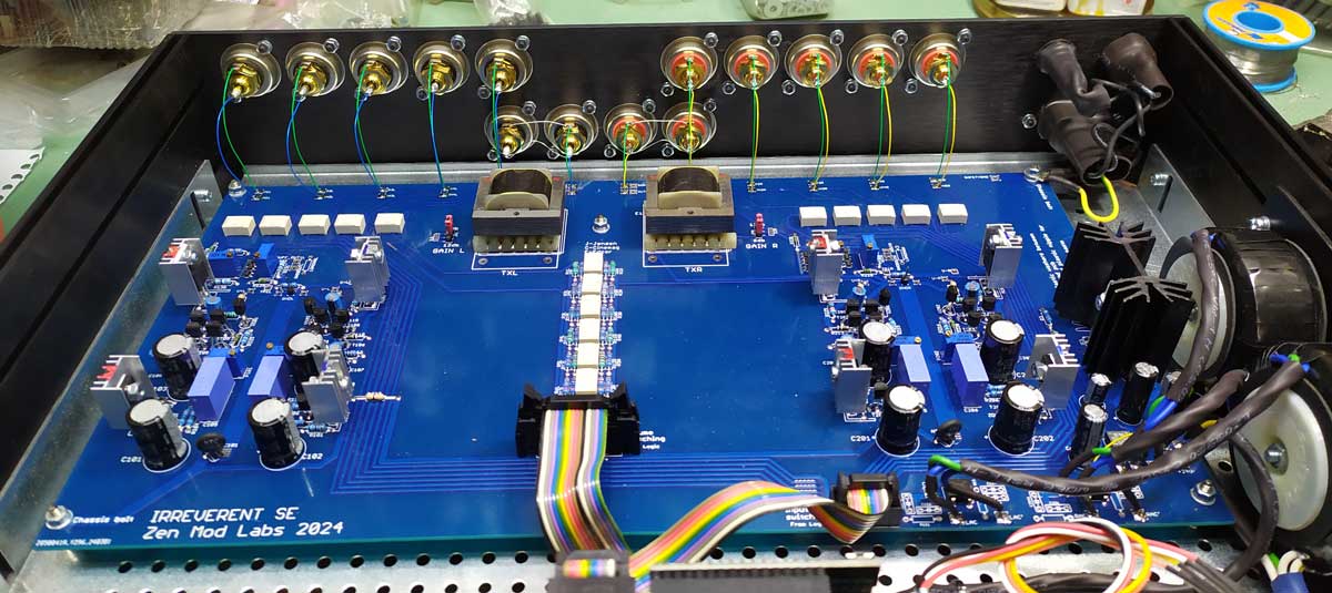

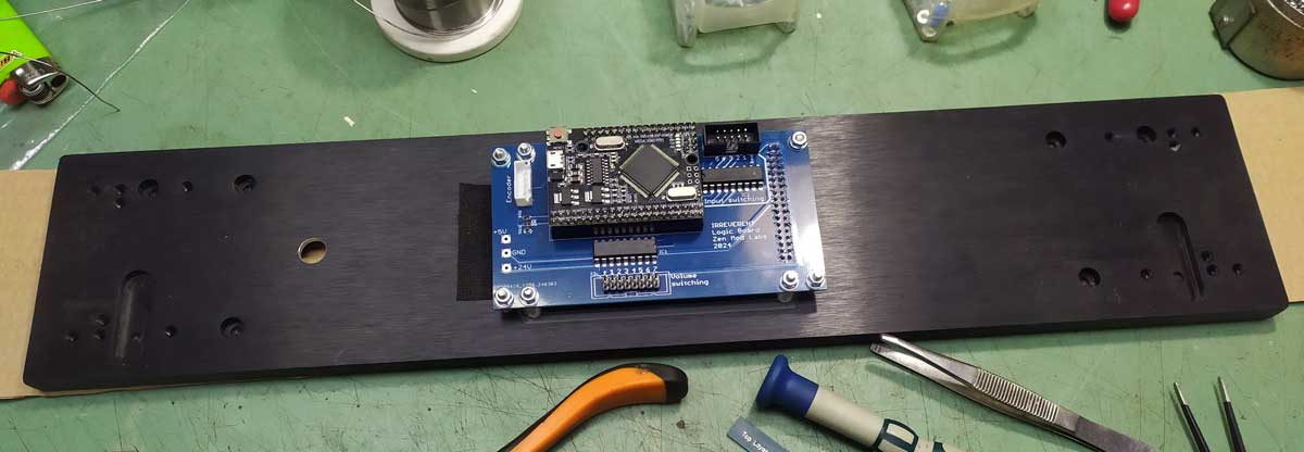

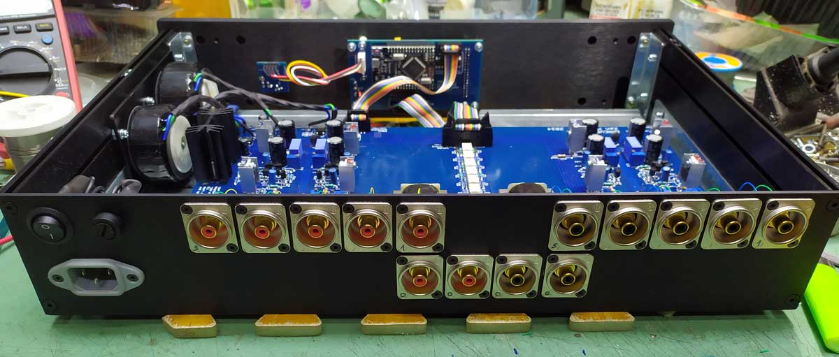

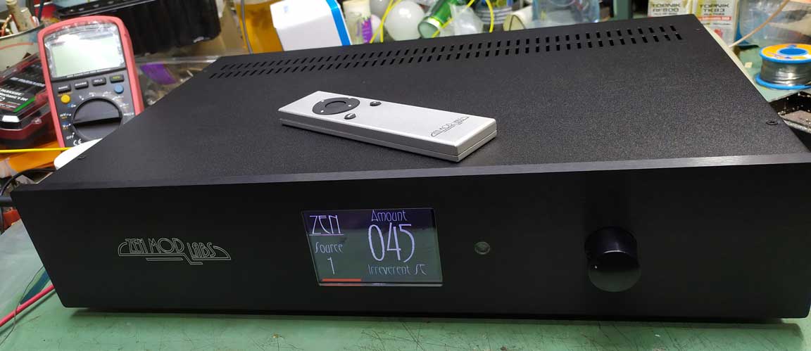

fully dual mono, resistor matrix volume attenuator (2^7, so 128 steps) const. Rin 24K, 5 inputs, encoder rotation for volume and encoder push for input selector, remote (having previous but also mute/unmute), all cobbled in Modu Slimline 2U/280 case
will do Bal one, too
plan to make them as fullfull kits - so even last needed itsybitsie going to pcb, including files for CNC but enclosed finished Perspex screen for TFT, custom made mains Donuts, assembled logic module+TFT and remote .......... but sans signal xformers - no sense importing them to my neck of wood then exporting them again
anyhow- no glitching with Store Iron Pre - two Irreverents will be both unnecessary fancy and unnecessary expensive, so not diminishing Store sales, chosen by clever ppl, having nothing against moving da but to change volume
aha - how it sounds ............ ?
it simply delivers ........ and you don't want to go to work, just proceed with listening
but - fact without surprise - not as good as Iron Pumpkin ....... that one simply delivers ...... and you don't even care that you're not going to work

I love the custom message on the opening screen. They'll love it.
Now set to my background noise for "click" in Windoze.
