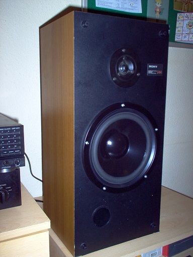

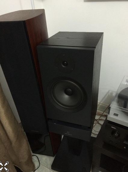

The (stock) Nexus' sound always has been poor.Please can i have your opinion on the said speaker the sound is not that good to my ears.
Definitely a waste of money. You'll need a better designed crossover instead.Do you guys think if i recap the crossover will be beneficial or i'm only going to waste my money.
Increased component quality cannot substitute a proper crossover layout. 😉

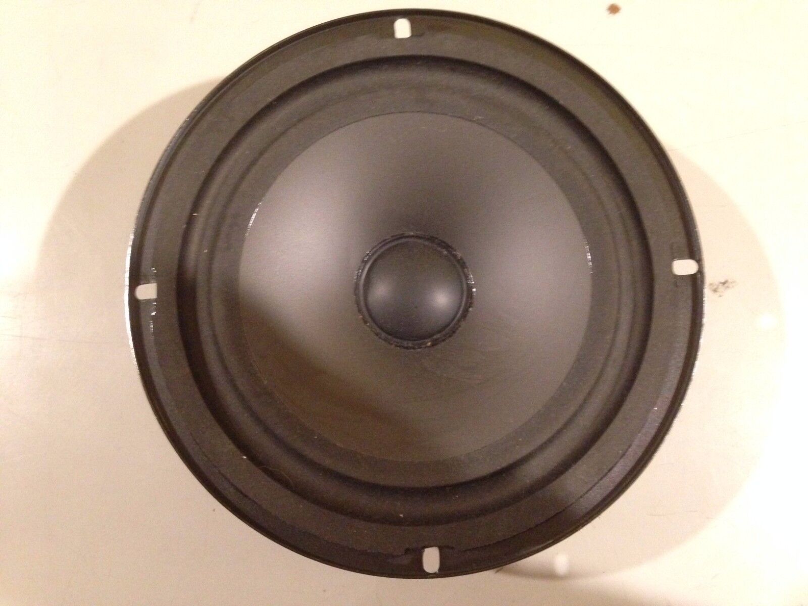

I was wondering whether there is anything I can do to re-house them into a better cabinet...

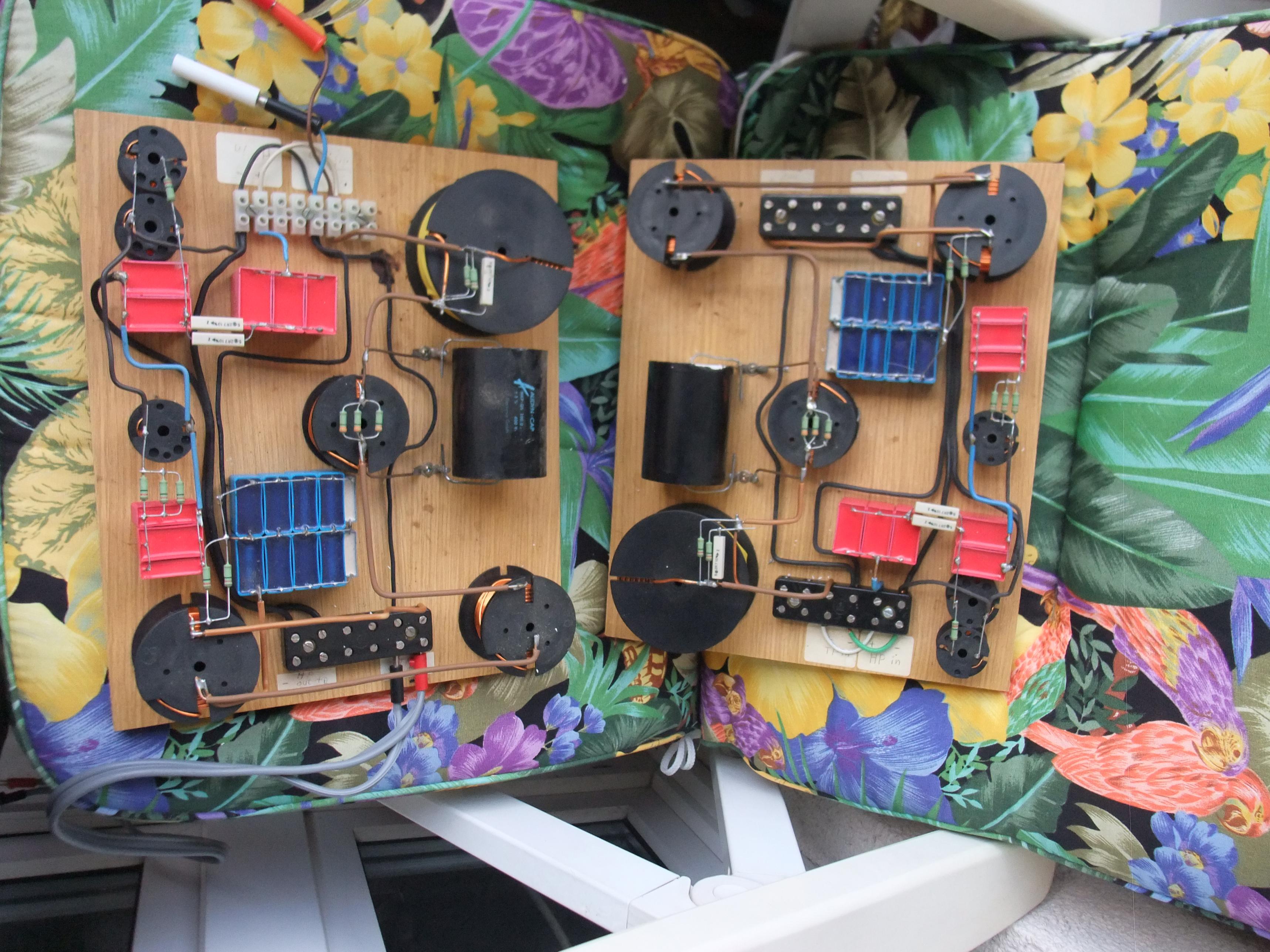

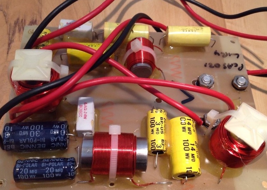

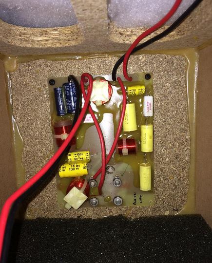

So I'm either going to have to track down a schematic or pull mine apart and document it?
And the Zobel goes in addition to the crossover?

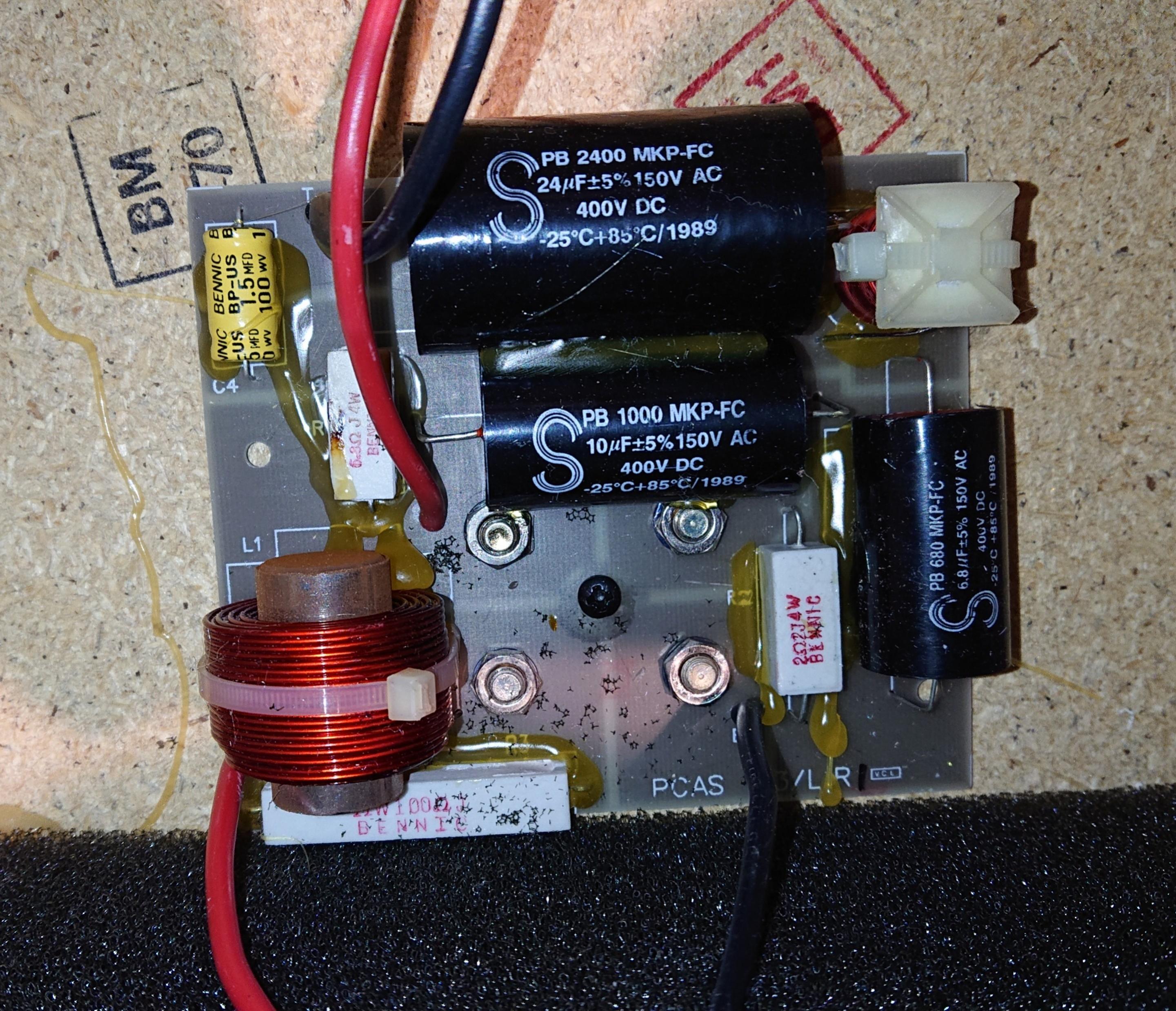

The tweeter crossover may have a zobel already. Maybe 1.5uF and 6 ohms.

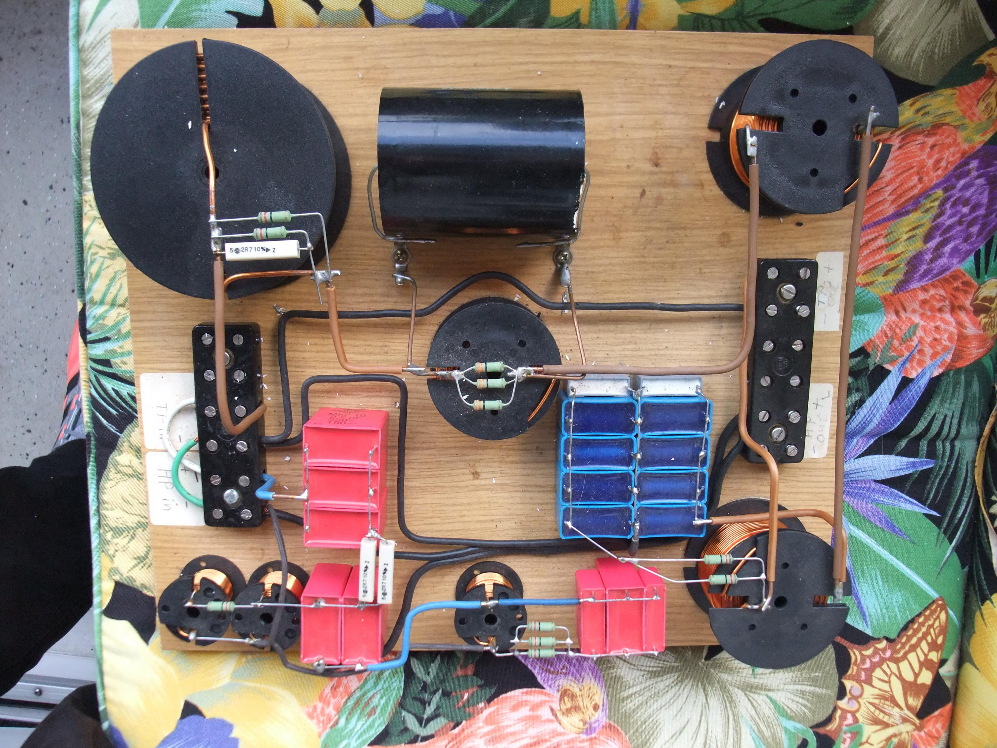

The circuit is very hard work to decipher. Looks like 4th order on both sections. That's a positive polarity on both drivers solution usually. But I'd want to sim it.
Bass will go roughly coil, cap, coil, cap with a resistor thrown in with one of the caps.
Tweeter will go cap, coil, cap, coil then a zobel by the look of it. That's quite easy to attenuate, you just put a resistor at the input.
If you look at the back of the PCB, you can see the wiring and polarity on the speaker biwireable input. I usually flip it 180 degrees in paint to relate it to the view from the other side.
The left hand side in the vertical layout up from the input plugs is the bass section. Bigger values. Resistor and capacitor values are easy enough, without an inductance multimeter we'll just have to guess coil values.
I think you did well to decipher that one, Junie! Looks like the positive input is actually the earth plane on the PCB.
It still doesn't make sense on tweeter Zobel placement, but you end up with a sixth order acoustic bass and 4th order acoustic tweeter for sure. Which is a complete mess on phase. It just misbehaves above crossover point because the bass rolls off too much.
This is potentially a lovely speaker. The crossover guy just didn't really get the right idea at the start. No wonder he spent 6 months fiddling with it. The filter should have been strangled at birth.
LR4 is one good way to do this sort of thing. 24dB/octave acoustic filters. It's usually a positive polarity solution, but with an 8" bass the time alignment is about half a wavelength (5cm) off at 3kHz, so you wire negative polarity.
Big basses have big mechanical rolloff to start with so you only need 2nd order electrical on them. I came up with a nice circuit. Phase alignment to die for. Detailed sound. Won't be overly bassy, as it goes. That's my taste, and you could change that.

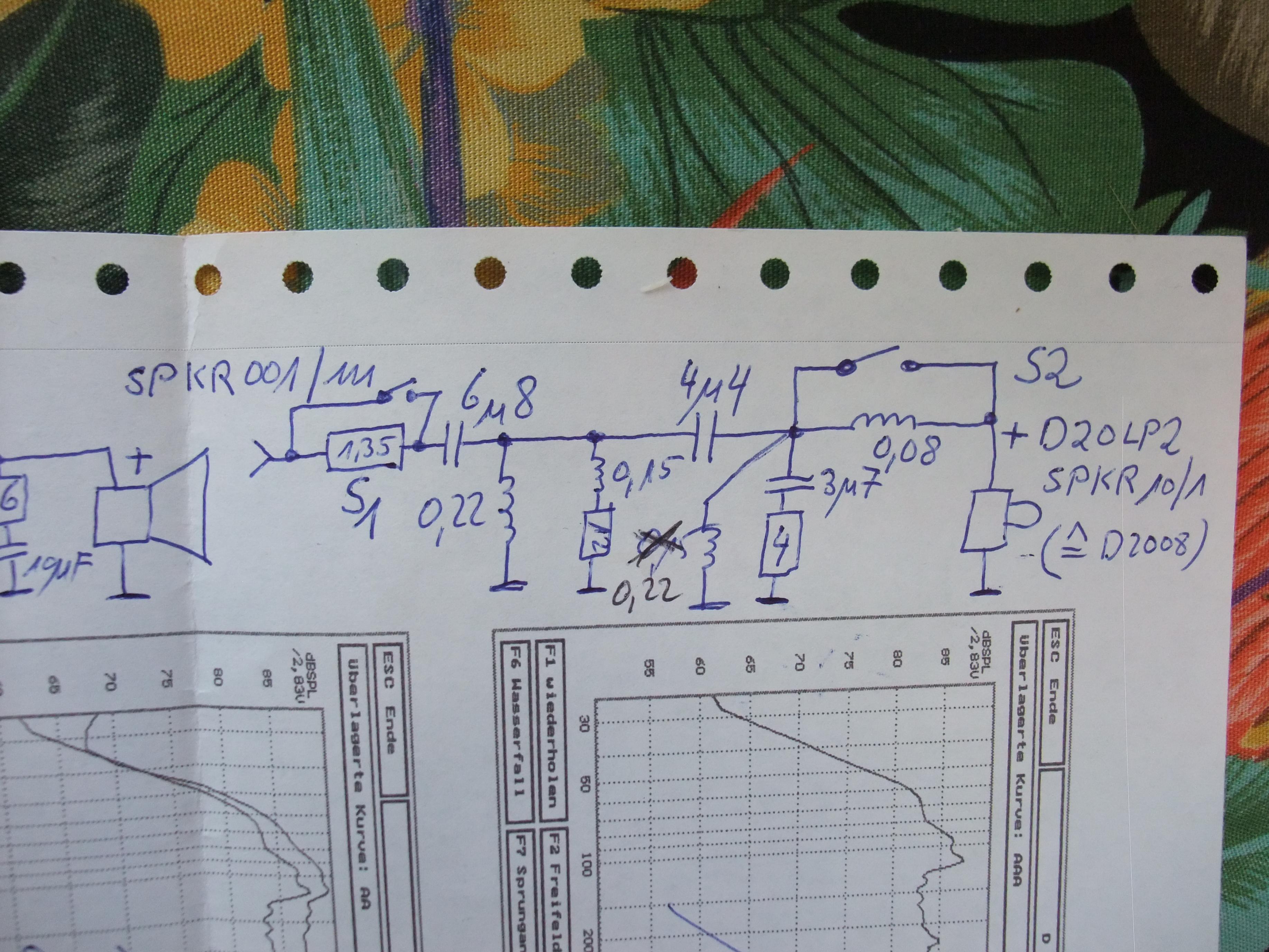

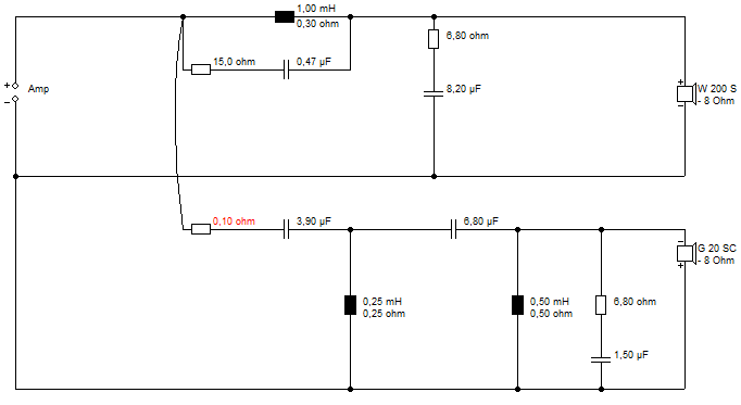

Please check the schematic.
That thread petered out a bit. You need a multimeter with an inductance scale to know what is going on. And unscramble the circuit details.
But your version can't be far from this standard sort of design:
Then you run it on a simulator to see what might adjust to taste.

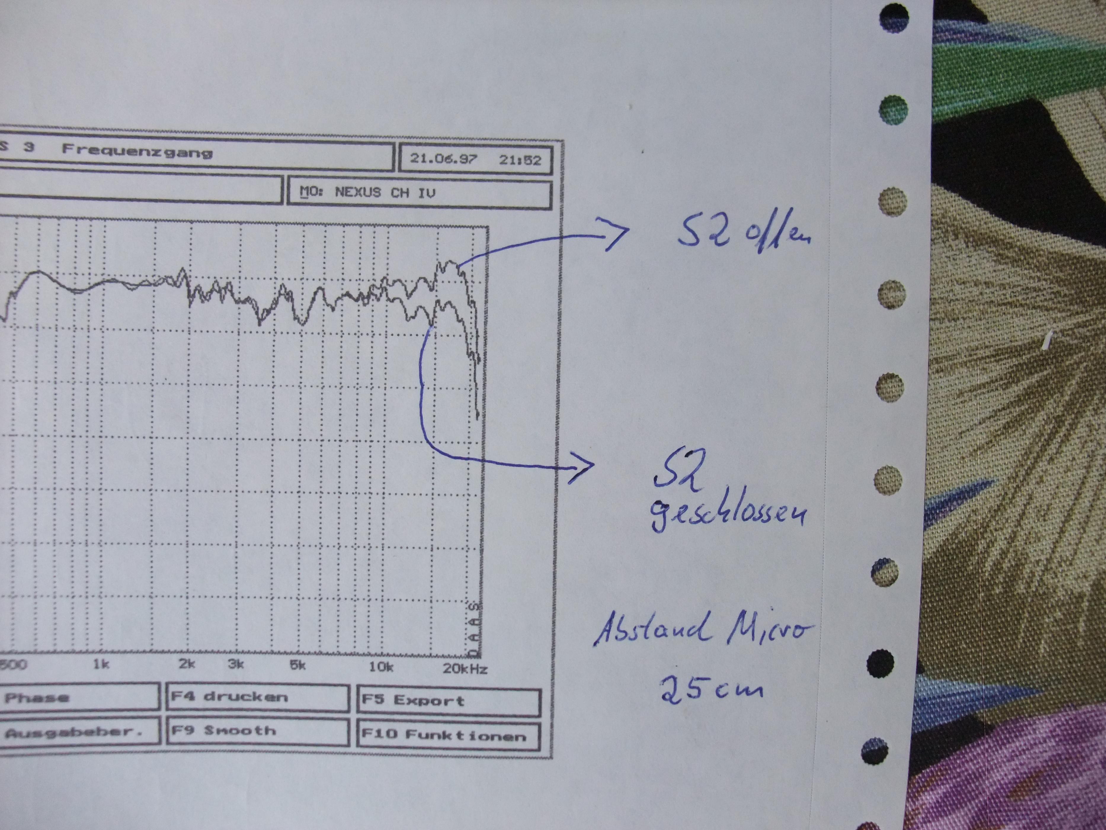

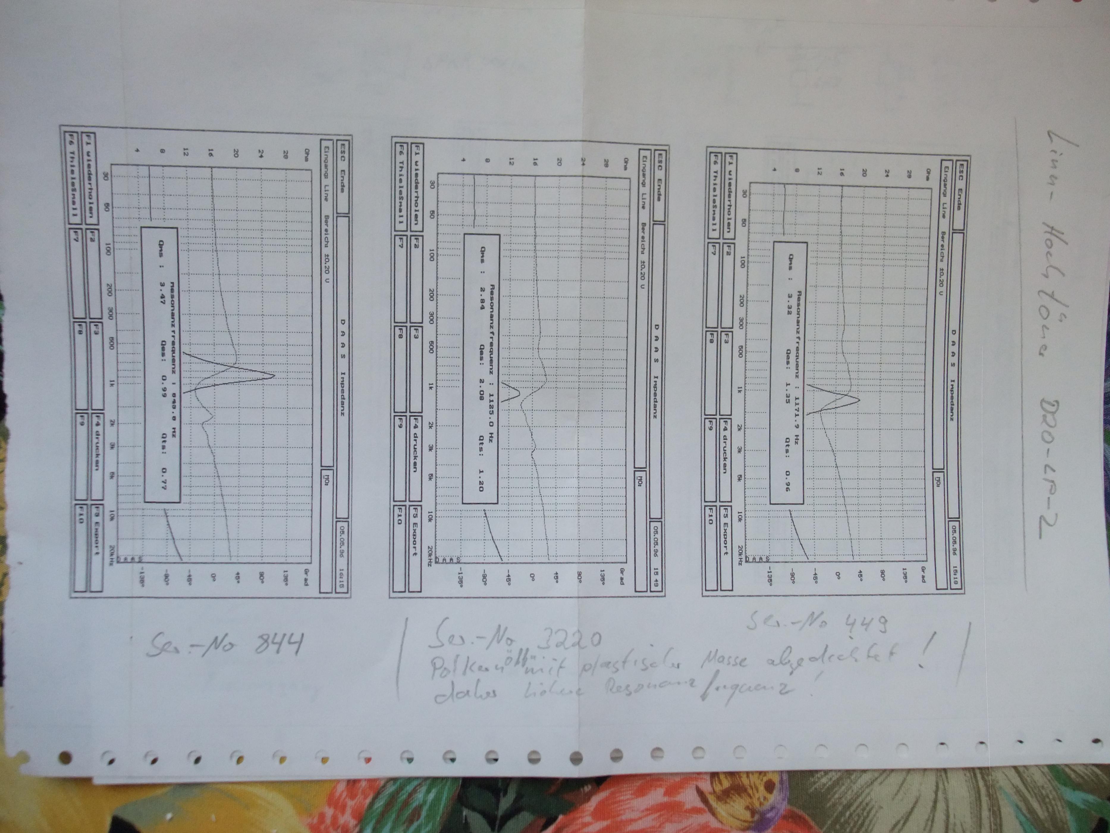

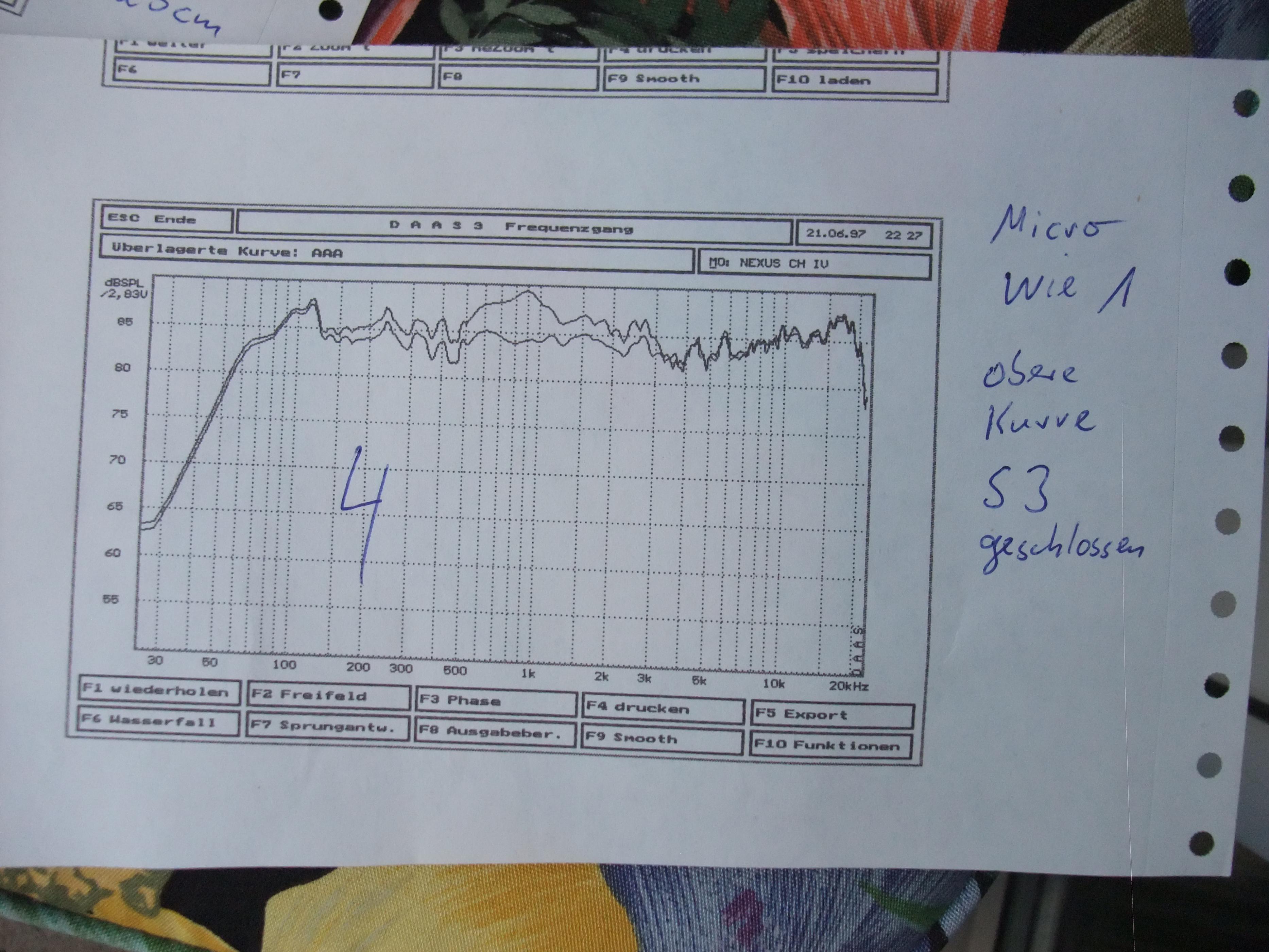

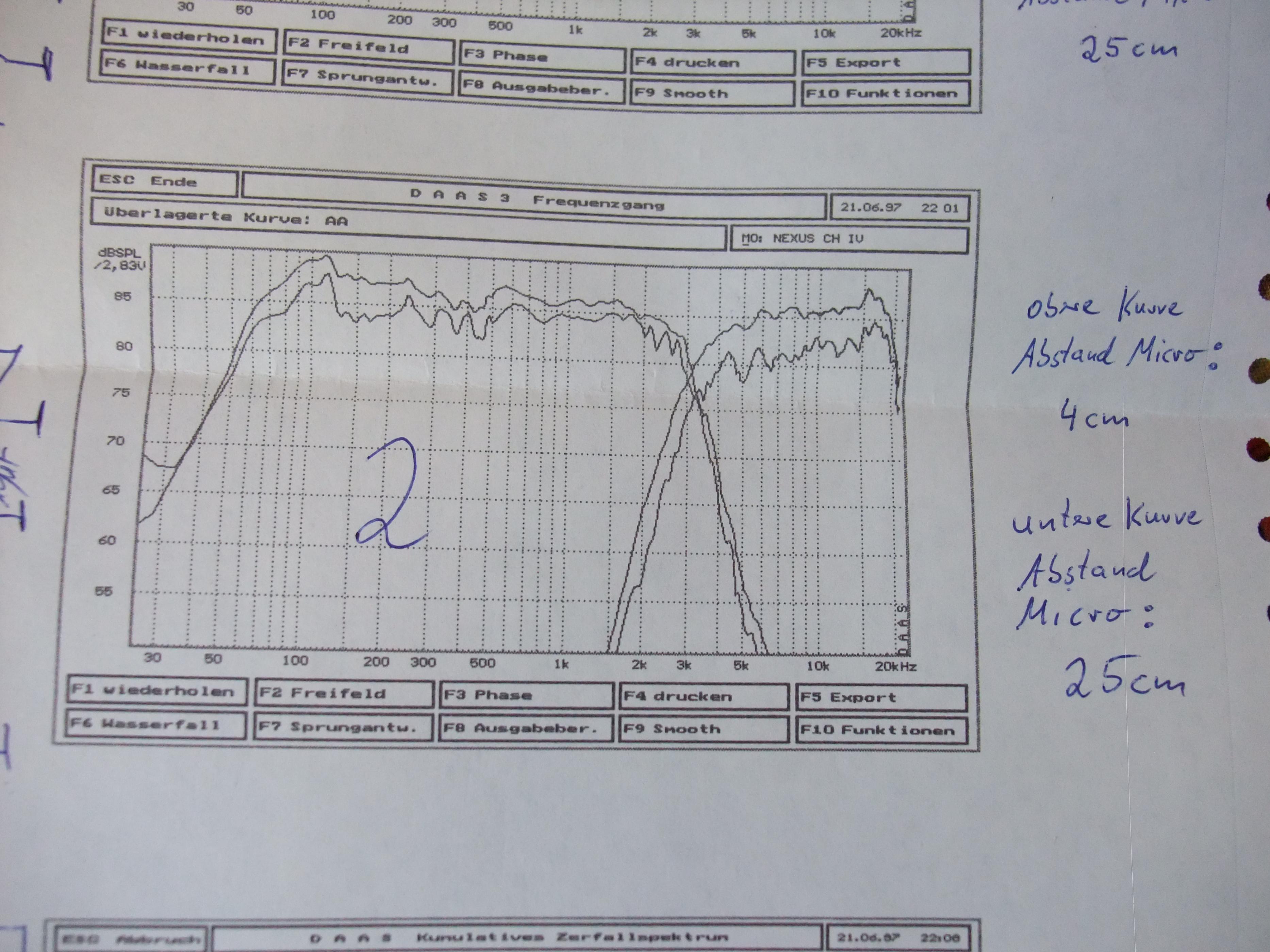

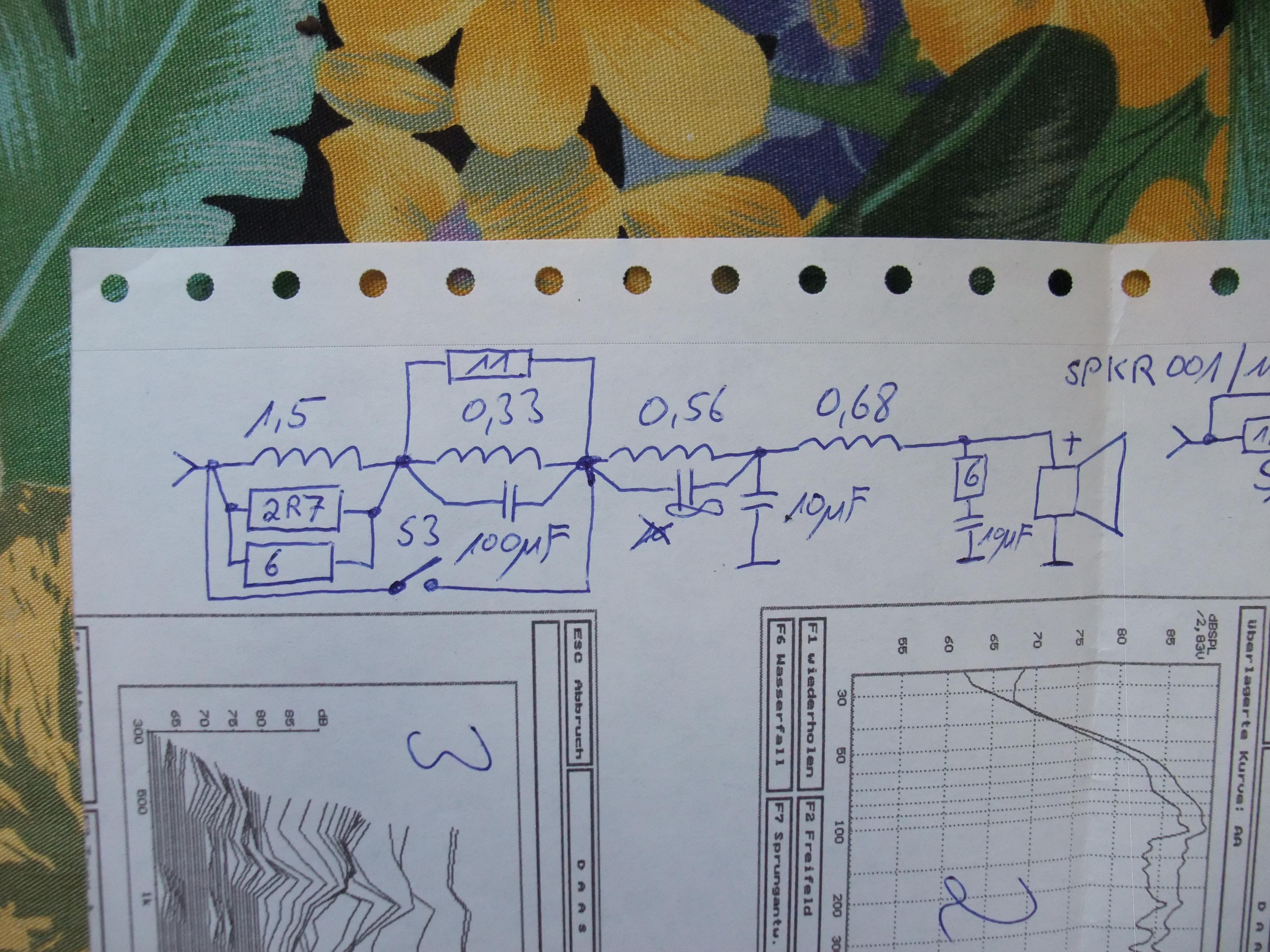

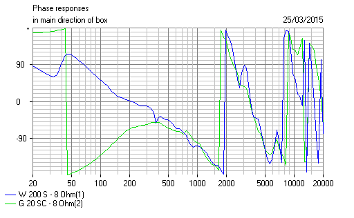

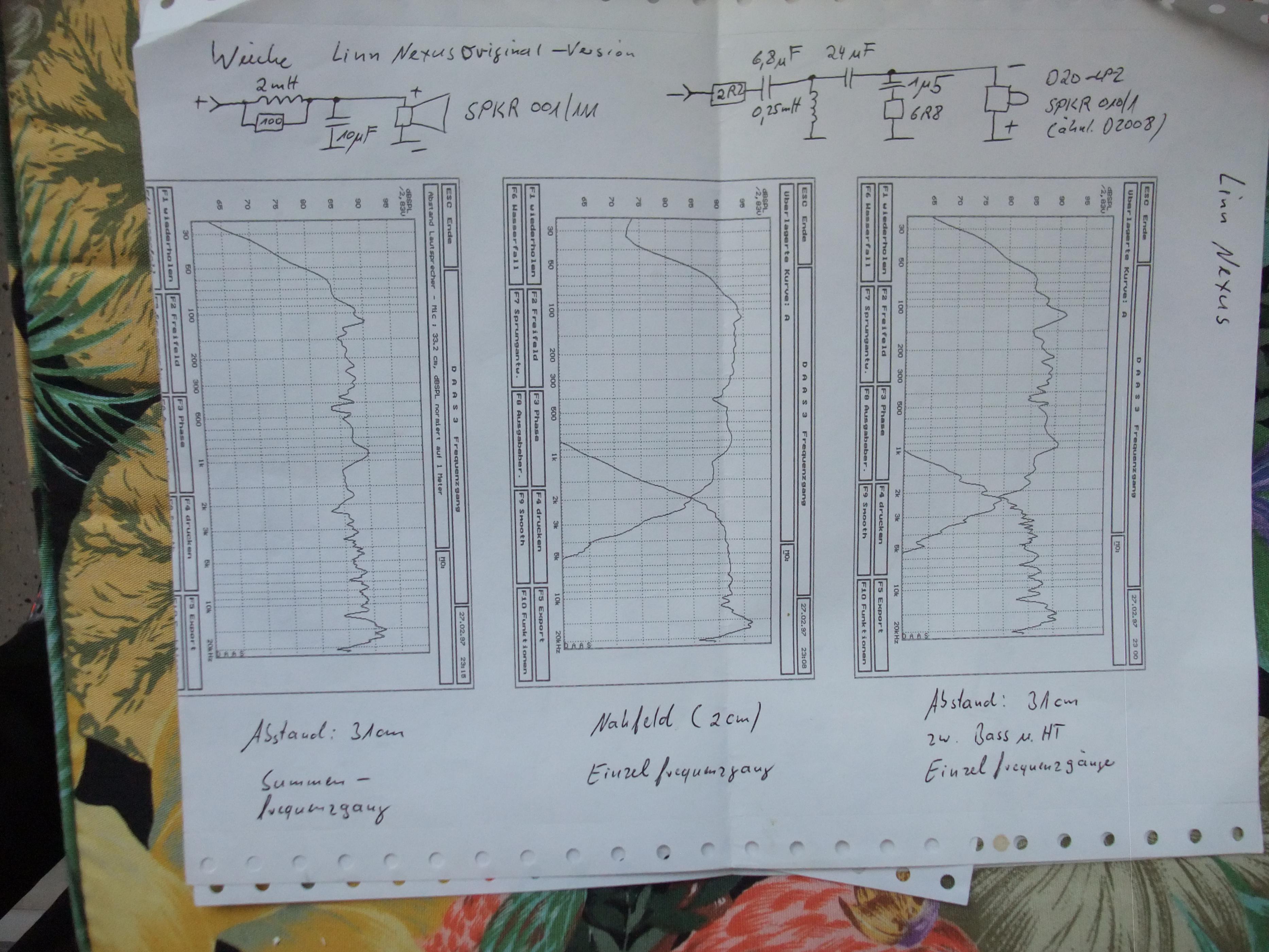

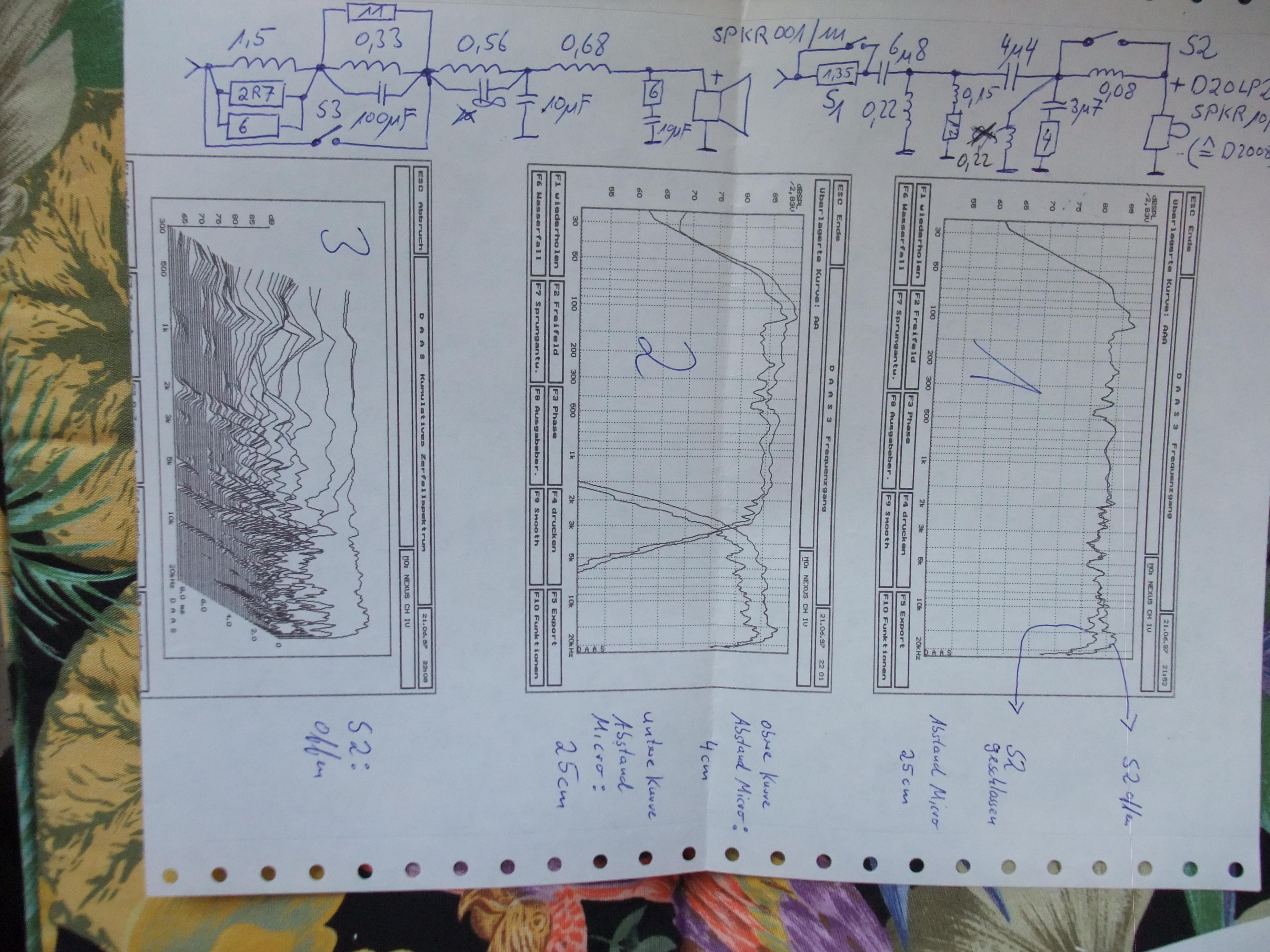

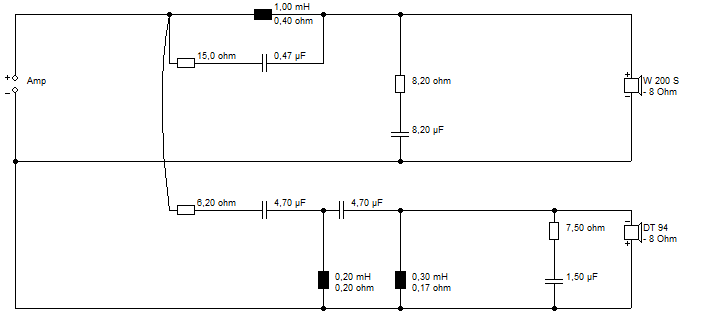

Many years ago I create an own outdoor crossover network version for several user's. In the attachment the schematic and measurement results from those days so as my own prototype for demonstration and compare to Linn's genuine version.

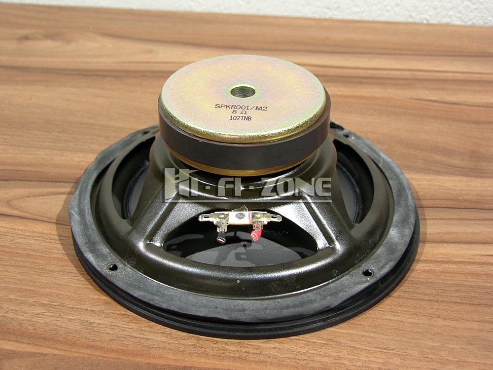

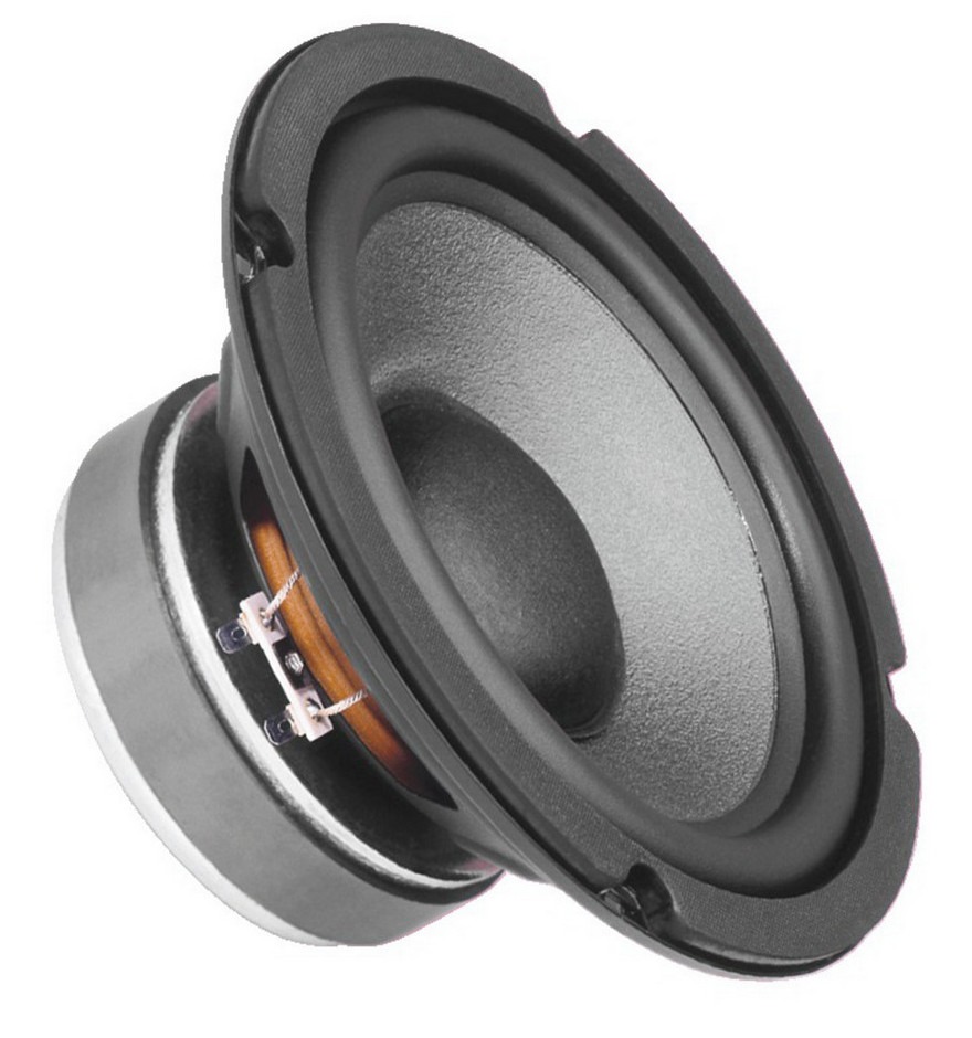

Replacements drivers :
Hiquphon OWI (OW1) dome tweeter features
MONACOR: SPH-200TC
Good history information:
Legend Acoustics - The Legend Story
MONACOR: SPH-200TC

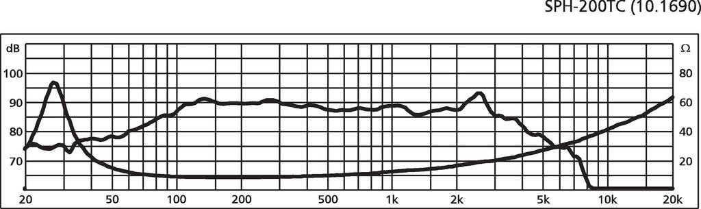

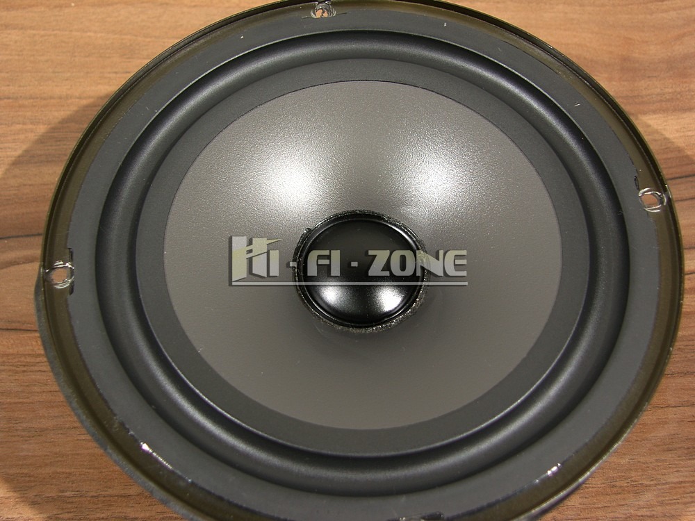

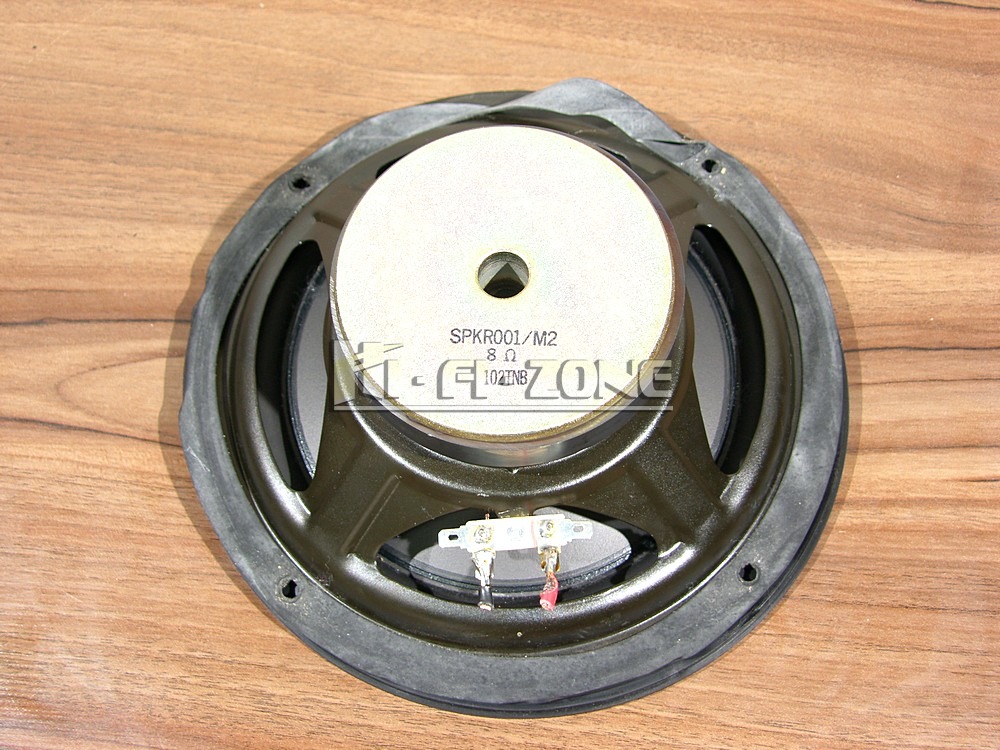

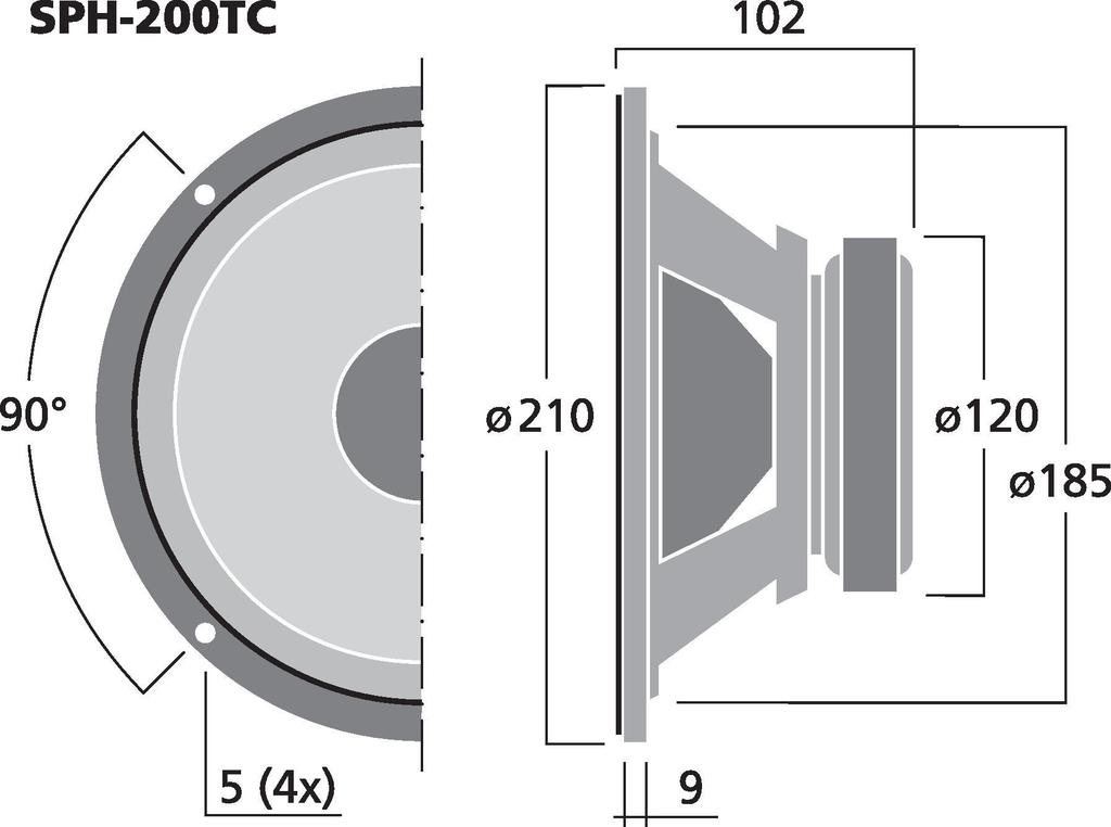

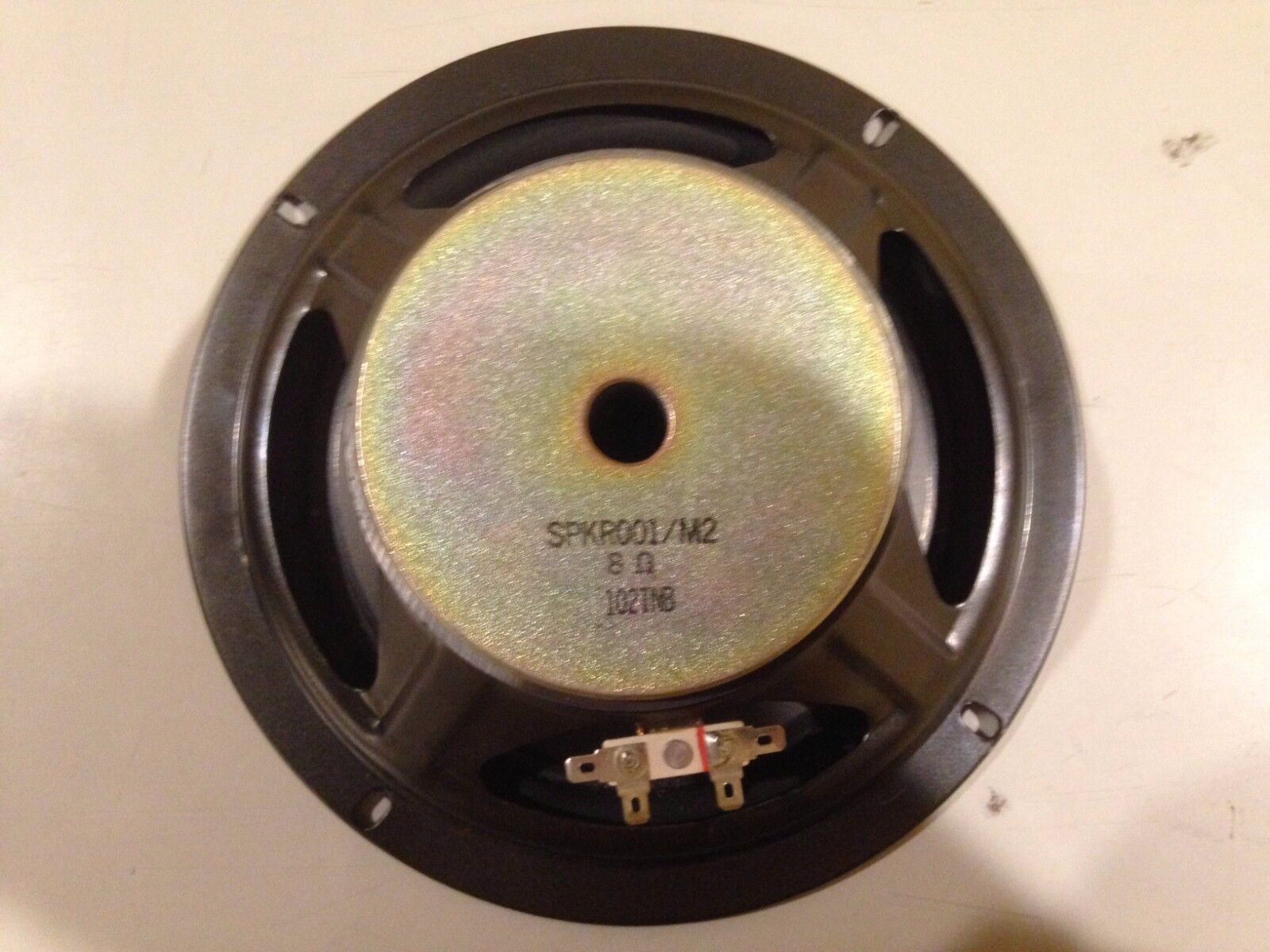

MONACOR's SPH-200TC is a good replacement for Tonegen's SPKR01, because sound is very close to those from Tonegen
