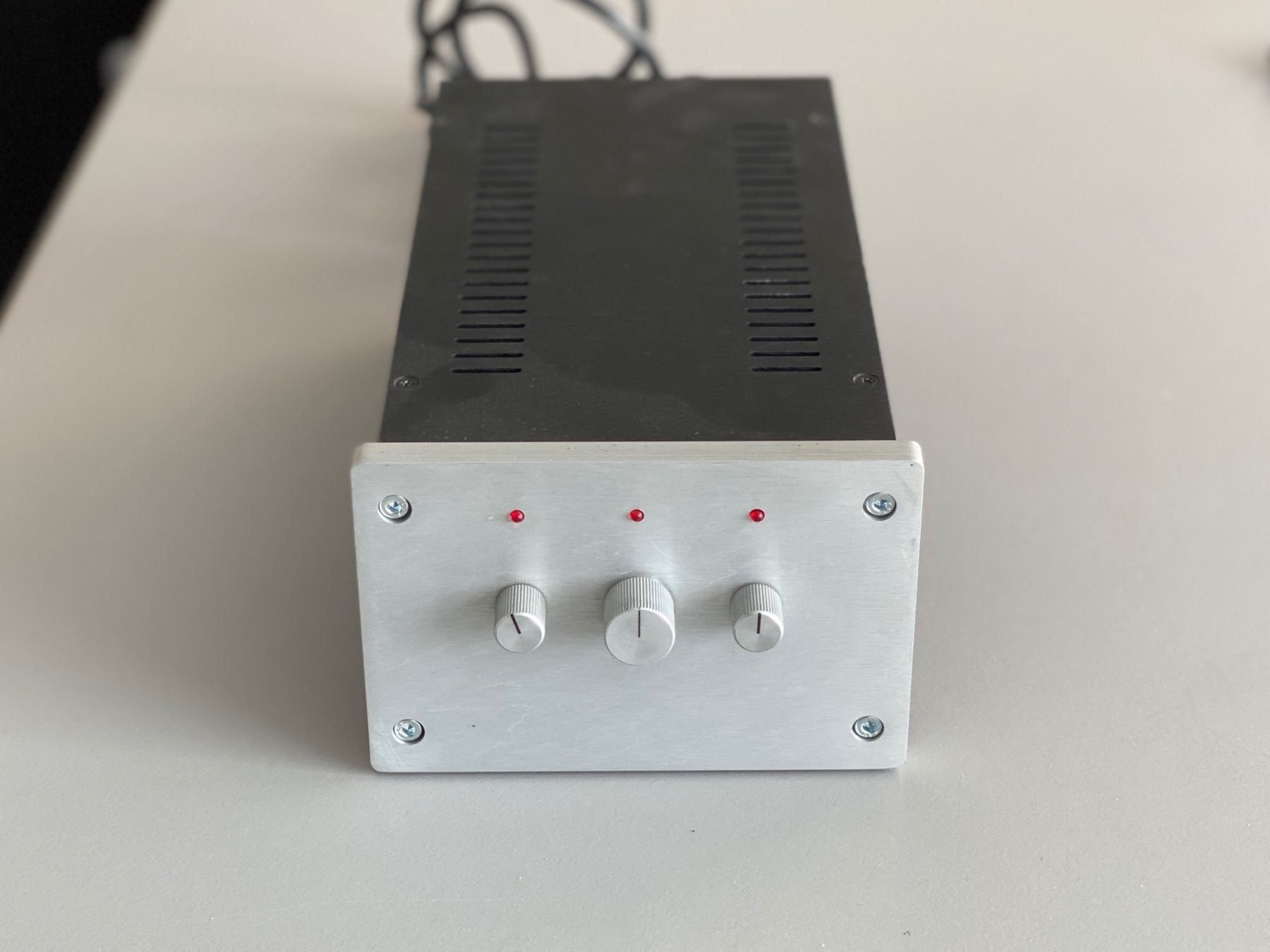

According an information from a PM the schematic is here:I am looking for a schematic of the motor control unit from follow URLs:
Dr. Fuss Motornetzteil - Frank-Landmesser.de
Sehr geehrter Besucher
I need it for troubleshooting at a diy clone of this model.
BTW - in this case there is a second thread:
Optimally driving a (VPI) synchronous turntable motor - diyAudio
https://www.diyaudio.com/forums/ana...it-description-sine-wave-osc.html#post5995157

Wich model?
last posting (#9) under
shows images from the inside of genuine device.

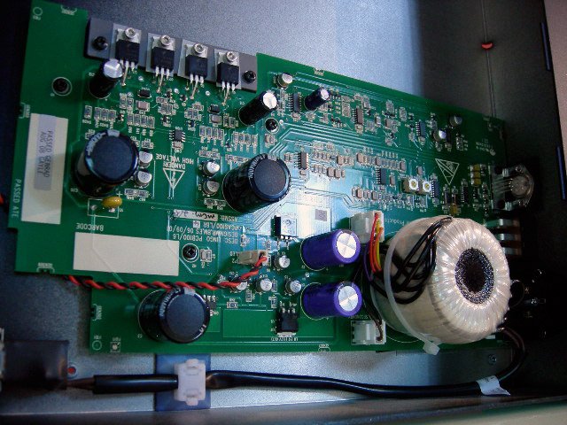

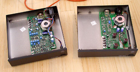

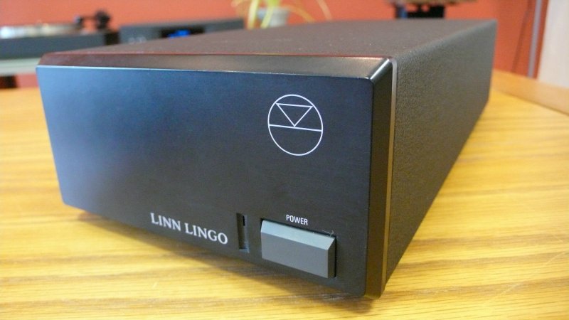

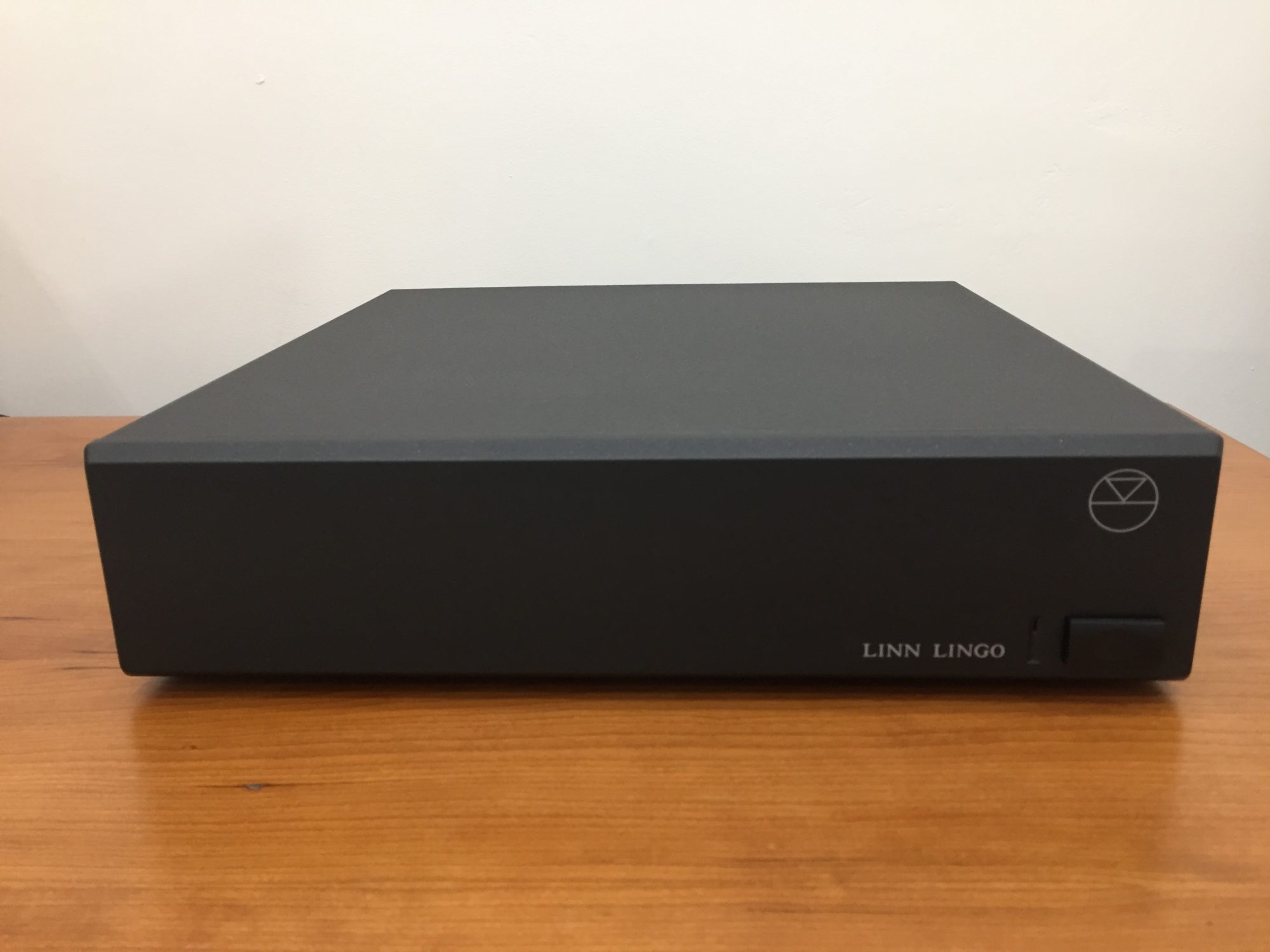

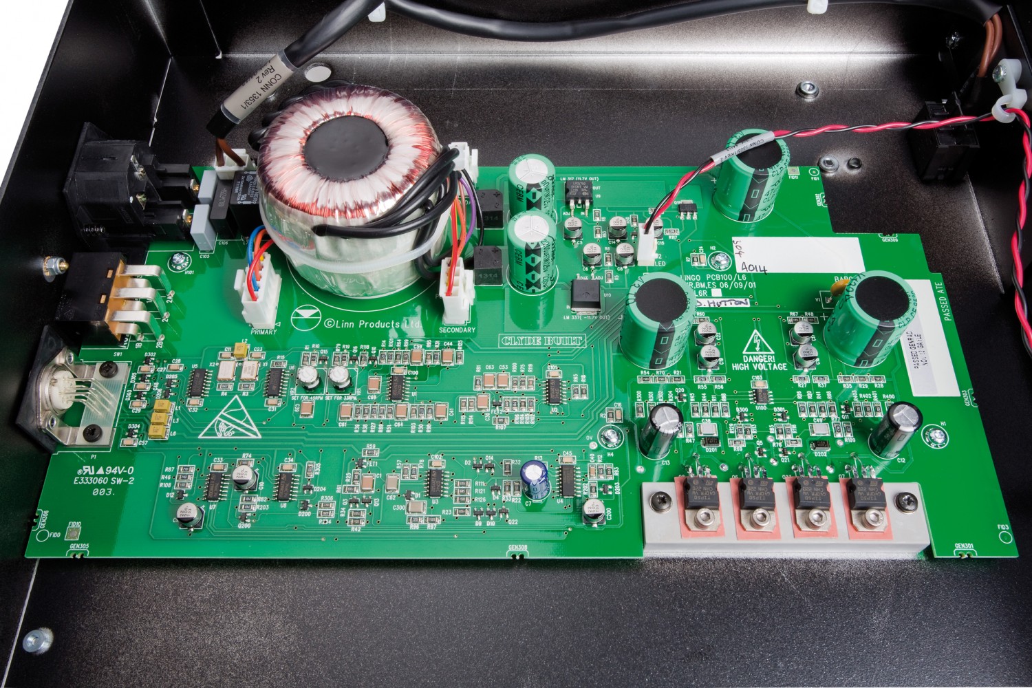

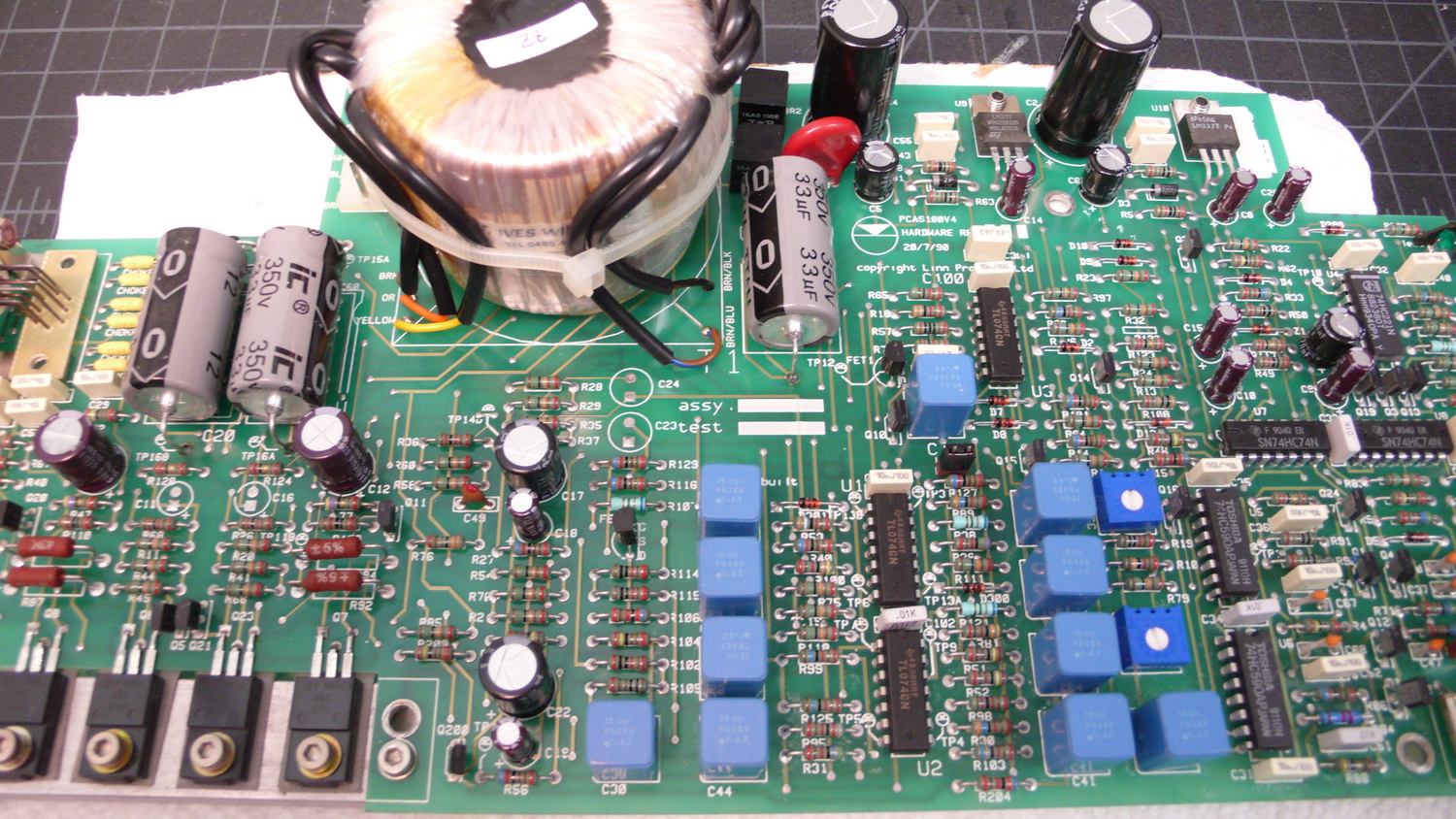

There are three Lingo envelope versions from Linn, but only two PCB-Versions - go to the attached images.
Who can tell me the motor voltages from the Lingo version II and III ?
The motor voltages from the first version are 90VAC while the first seconds and 50VAC while normal operating.
If the values of voltages while normal operating lower, sound is definitely better.
In this case, to improve the sound, one could simply reduce the voltage for the motor on the first version by reducing the gain of U3, PIN 8-9-10 (the Linn AXIS motor, which have probably the same parameter, runs with only 20VAC).

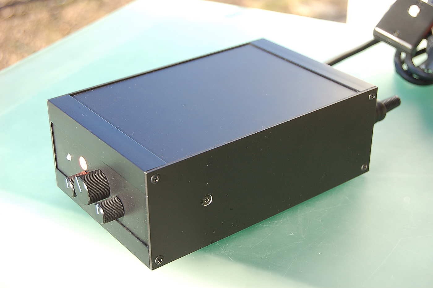

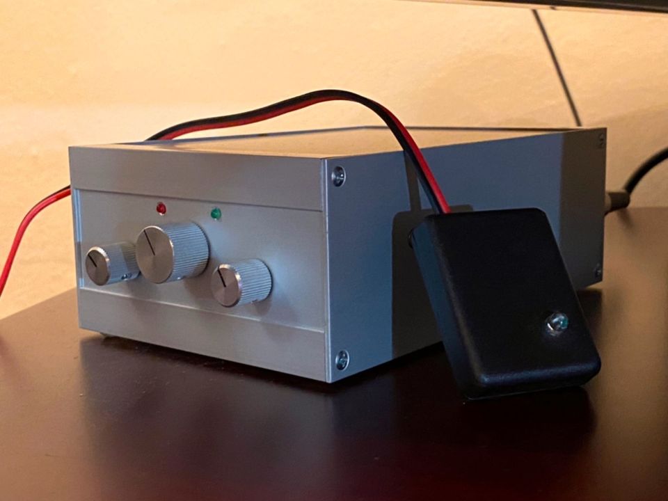

comparison by a listening test between Linn's LINGO, homebrew clone of Dr. Fuß and AXIS power supply - go to post 12 under
https://www.diyaudio.com/forums/ana...-description-sine-wave-osc-2.html#post6475049

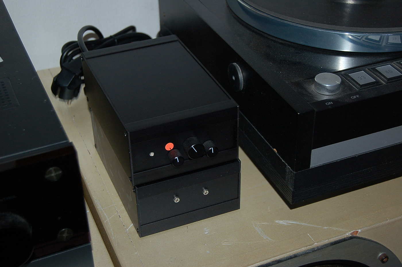

new Dr. Fuß motor control or only new outline of enclosure ?
Thanks for an advice.

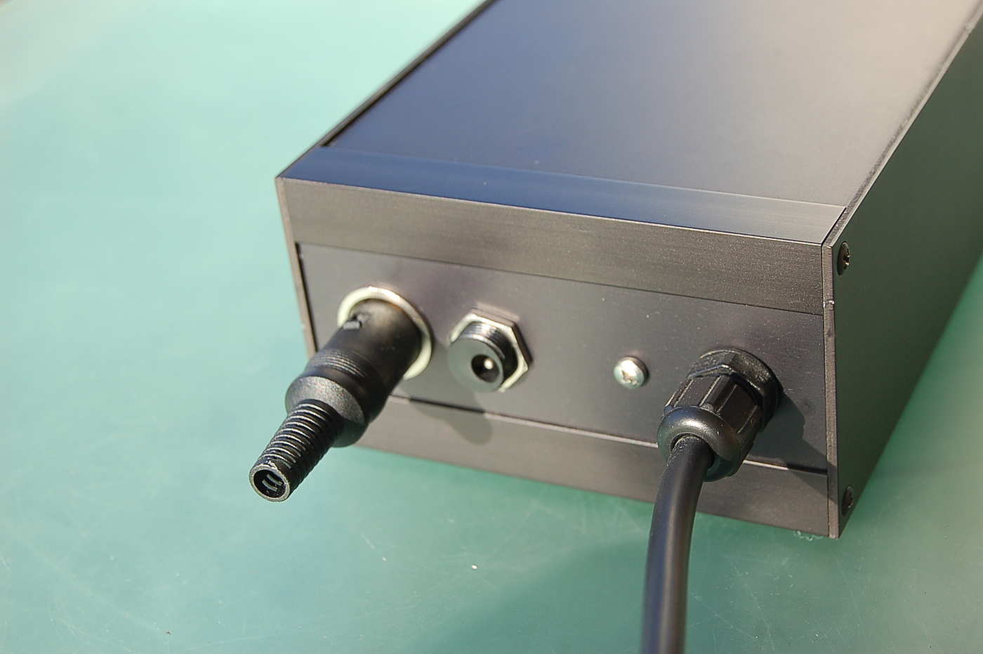

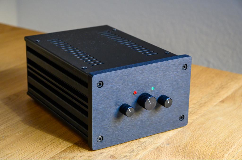

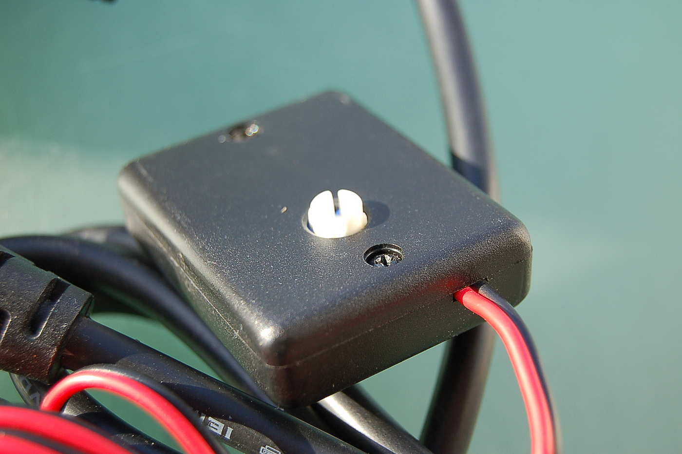

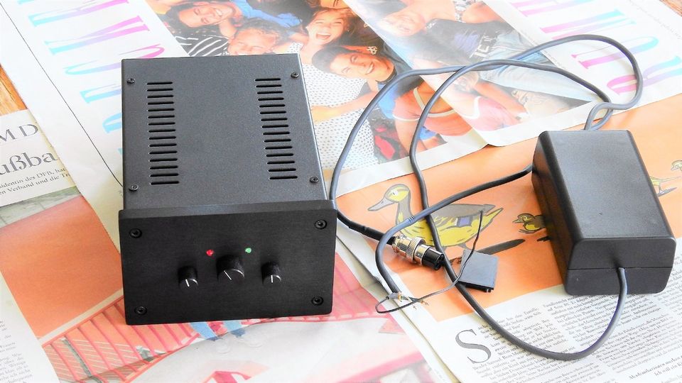

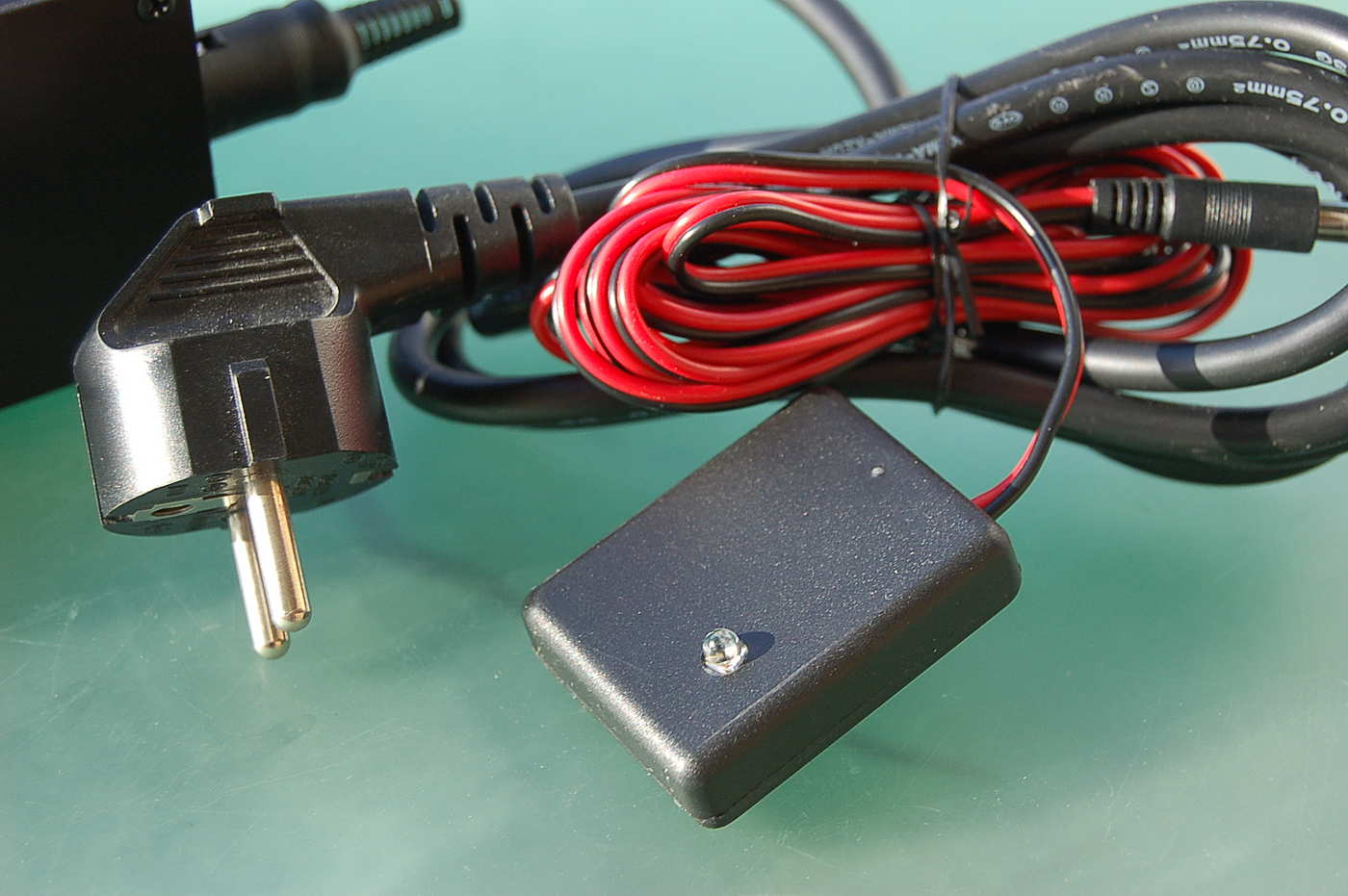

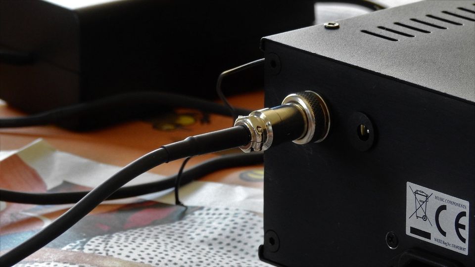

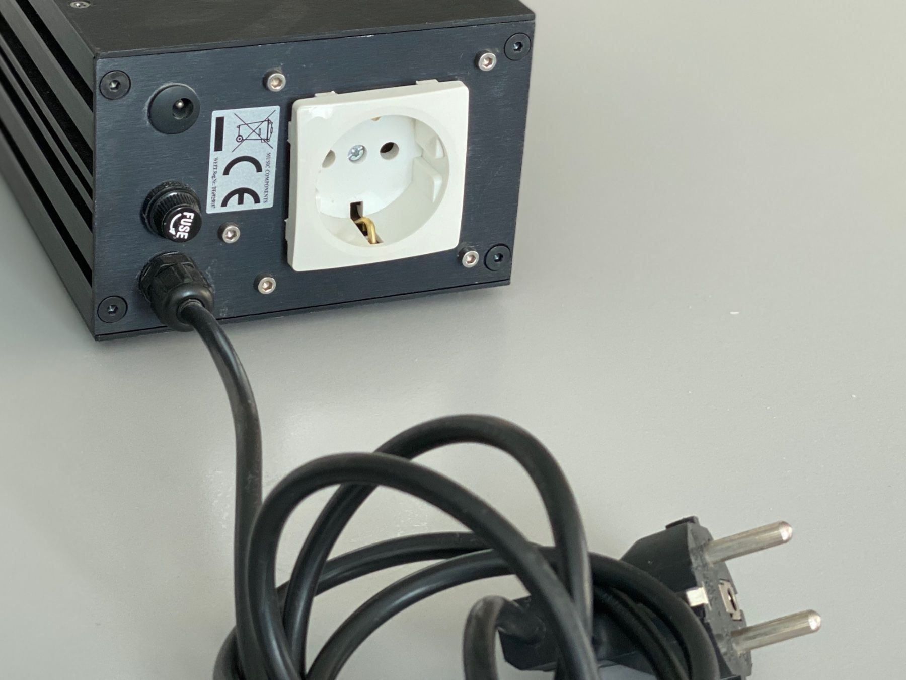

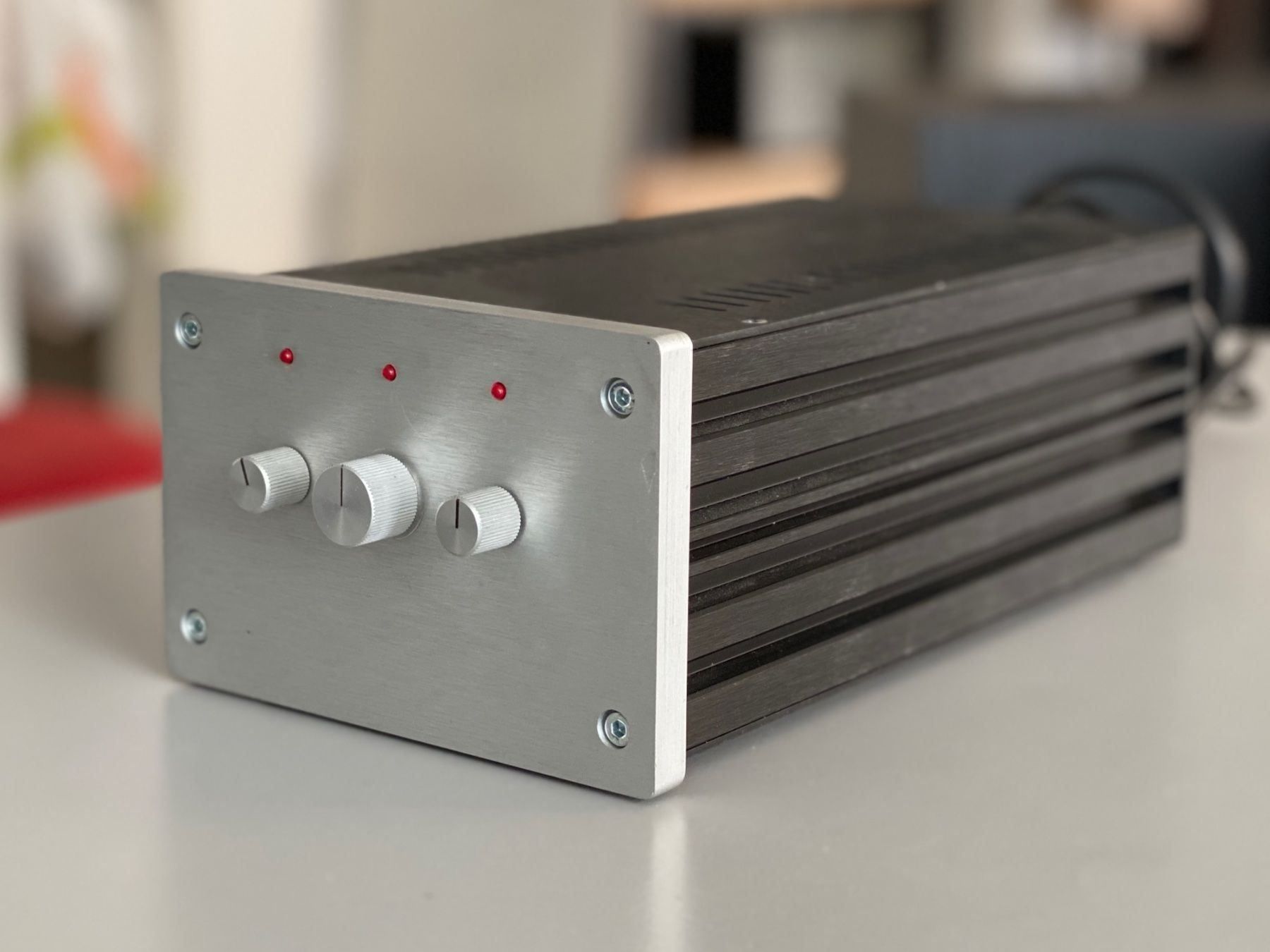

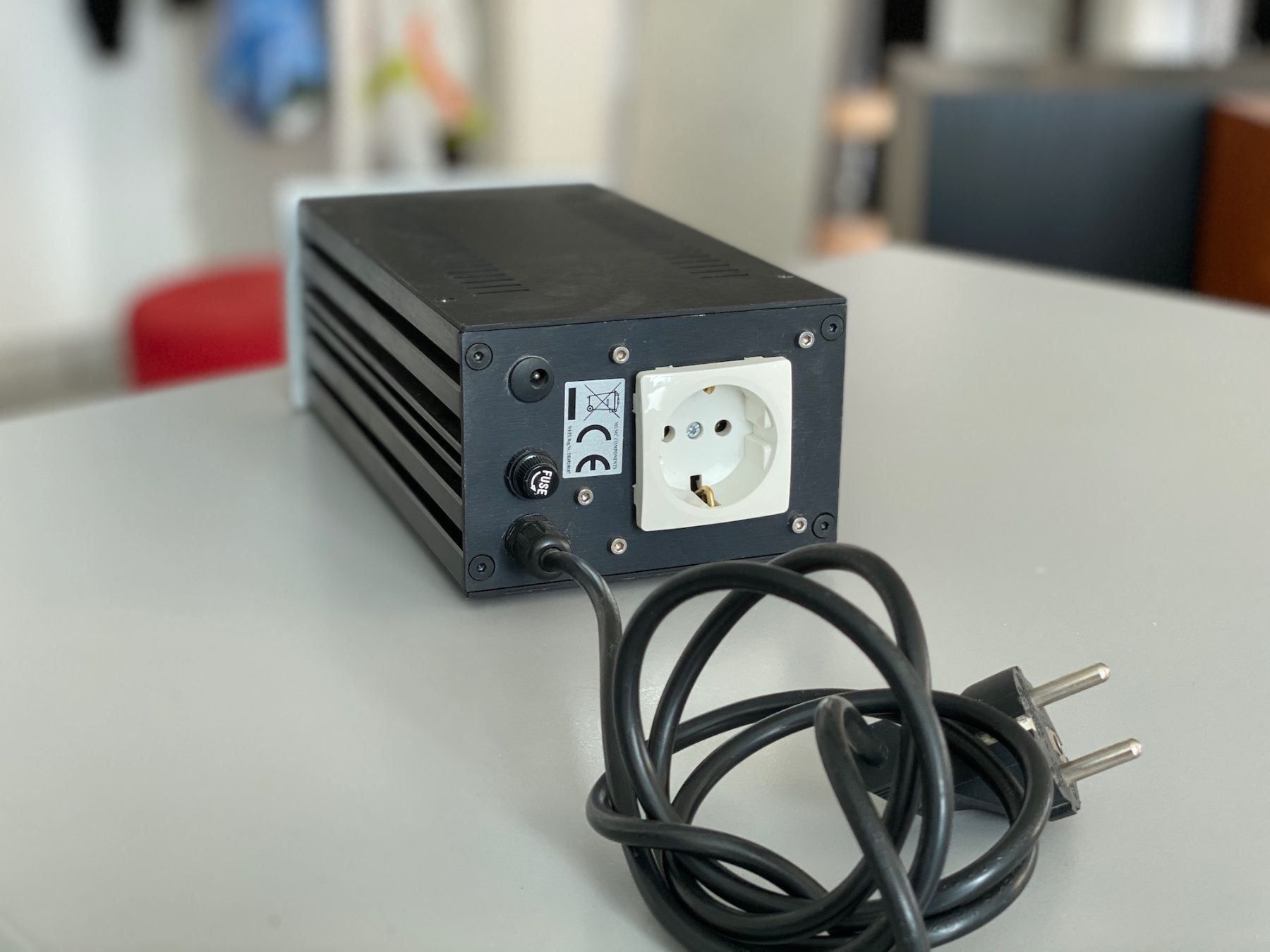

This is the version that I know:
csm_Music_Components_Dr._Fuss_Netzteil_Thorens__6__836a97ef55.jpg68.7 KB · Views: 85
csm_Music_Components_Dr._Fuss_Netzteil_Thorens__5__2eec183076.jpg73.3 KB · Views: 74
csm_Music_Components_Dr._Fuss_Netzteil_Thorens__4__078ef060ca.jpg92 KB · Views: 85
csm_Music_Components_Dr._Fuss_Netzteil_Thorens__13__56d6888264.jpg73.2 KB · Views: 82
csm_Music_Components_Dr._Fuss_Netzteil_Thorens__12__aeb0ef90f6.jpg58.8 KB · Views: 84
csm_Music_Components_Dr._Fuss_Netzteil_Thorens__11__d63772325c.jpg63.5 KB · Views: 83
csm_Music_Components_Dr._Fuss_Netzteil_Thorens__9__83e4c674d2.jpg61.5 KB · Views: 93
csm_Music_Components_Dr._Fuss_Netzteil_Thorens__8__0a93f1df27.jpg50.6 KB · Views: 86
csm_Music_Components_Dr._Fuss_Netzteil_Thorens__7__362d599a8b.jpg49.4 KB · Views: 76
csm_Music_Components_Dr._Fuss_Netzteil_Thorens__3__67cc658575.jpg67.2 KB · Views: 83
