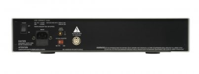

Linn Lingo vs. Dr. Fuß or Square-Wave vs. Sine Wave Oscillator for Motor Control

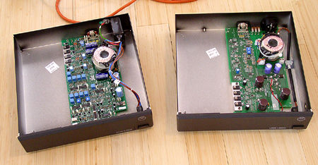

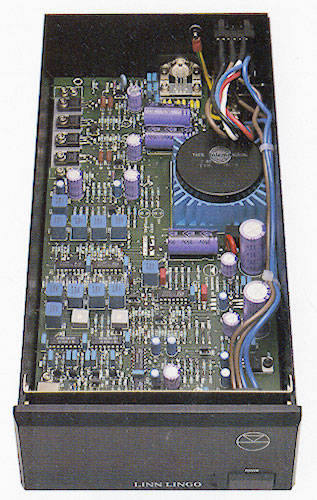

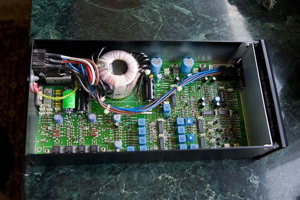

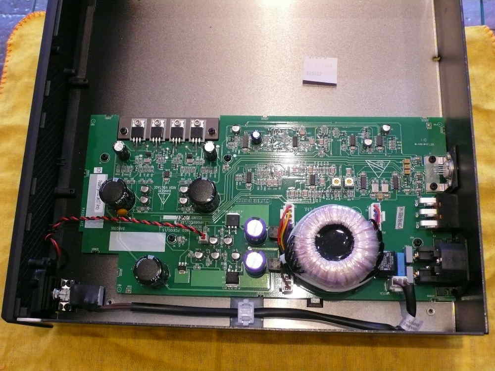

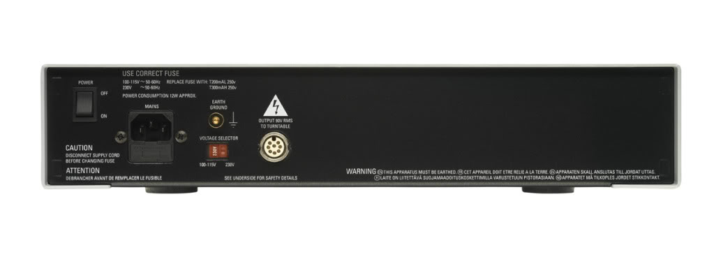

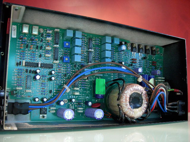

LINGO vs. LINGO-II and LINGO-III - where are the differences ??
At starting this thread I look only to the first version of Linn's LINGO.
There are at whole three versions of this synchronus motor control device (MK-II and MK-III resp. Lingo-2 and Lingo-3).
Who knows the exactly differences compared with the first version?
This URLs don't provide the wished informations:
Lingo vs Lingo II
Naim Audio Forums: Lingo I --> Lingo II ?
http://small.linncdn.com/product-catalogue/documents/Linn_Lingo_Owners_Manual-DE.pdf
Who know more?
Thank you for advices.
