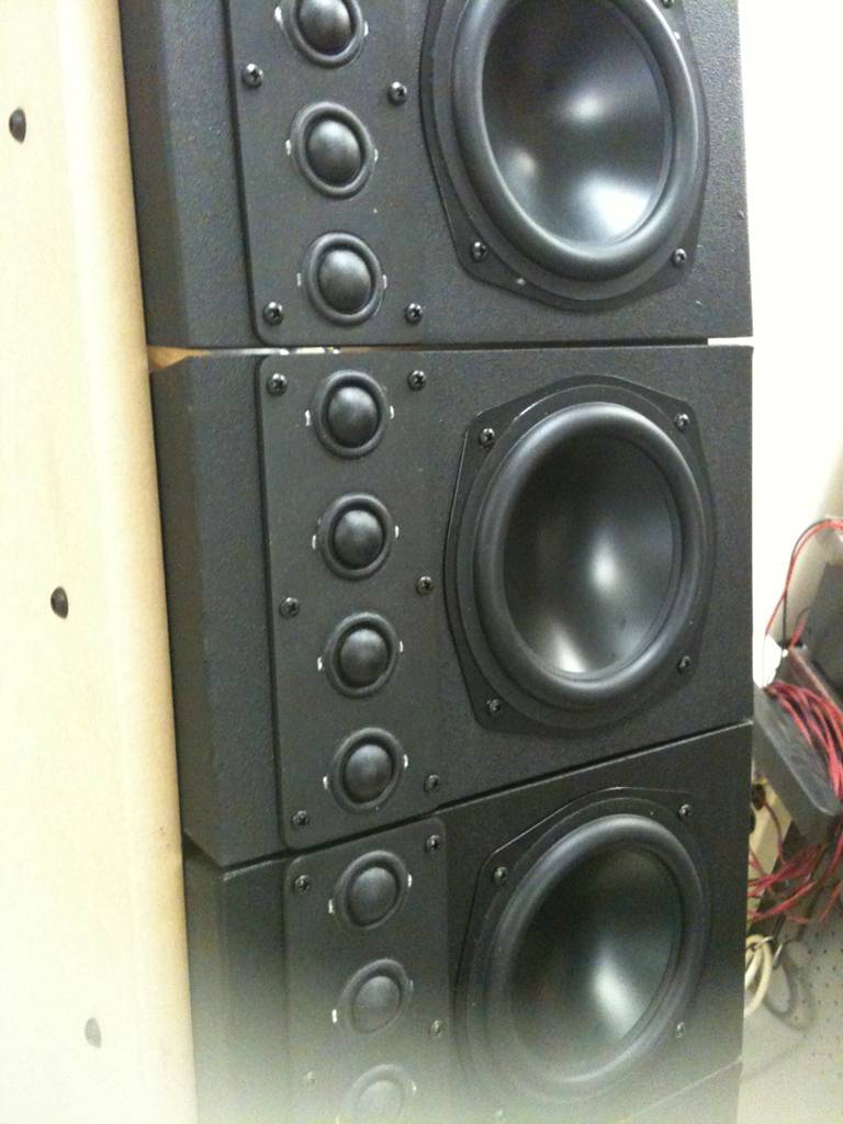

It will not use the same tweeters. The tweeters in CBT36 have a sensitivity of 75 dB. The ones in the XL version have a sensitivity of 91 dB.Since the XL has the same tweeters and the MaxSPL limit is due to the tweeters, I don't think that it will have more MaxSPL.

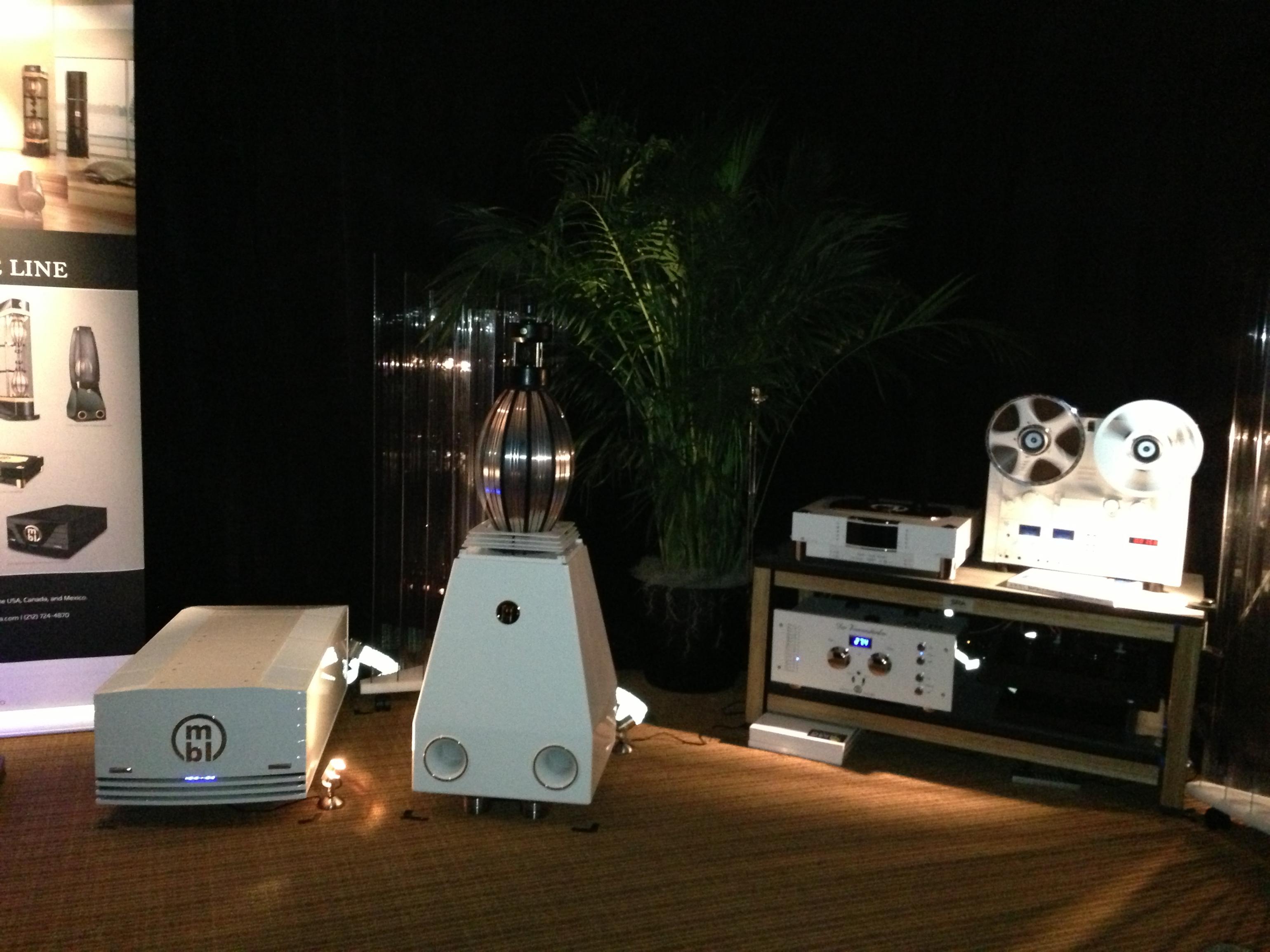

Have you noticed when the MBL get good rapports from shows? It's when they are set up in large audiotoriums or halls with great distances to surfaces.
But MBL are after all better then Boose. The polar of Boose speakers is laughable. MBL measures pretty flat at one height.
The prices however for MBL is ludicrous. It's plain funny to watch their power amps that look like coffins.
