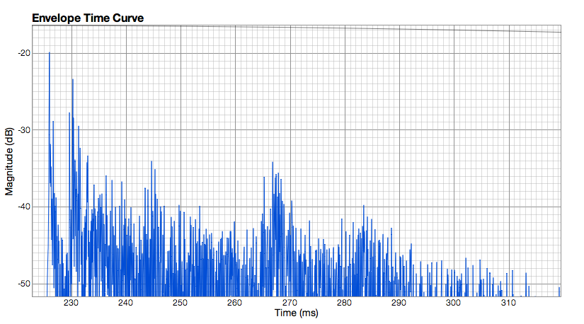

The only time I get a sensation of depth is when reflections from other locations than the speaker are present.
I've tried all sorts of speakers with very different directivity. High directivity speakers in low reflection environments always create a very narrow, pin-point stage without any depth. The higher the directivity, the closer the sound stage. The closest image came from a 8" full range driver. It was floating in front of the speaker plane, with phantom sources only an arm's length away.
Certain reflection patterns add a sense of real depth.
It all started by placing a second pair of speakers at ±60° fed by the stereo signal. It added spaciousness and depth.
Then I tried pointing speakers to the side wall and it had the same effect. I could create that sensation with nearly all types of speakers. Even the 8" full range speaker will perform like this if the speakers are toed-out.
This is how I listen today, Geddes Nathans toed-out. This creates a huge stage with depth while localization is still very good.
Interesting observation - when the contra-lateral reflection is absorbed, a huge amount of depth is gone. This somewhat baffled my because the level of this reflection is way down.

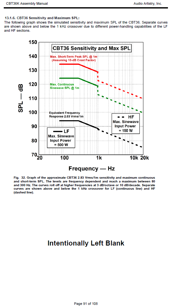

Here's a chart that shows the sensitivity and SPL of CBT36. It get's lower in the treble. I believe this is sufficient for most homes. I don't experience any straining as Pano mentioned.
The new CBT36XL will obvioulsy be able to play much louder.

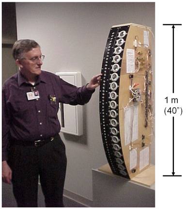

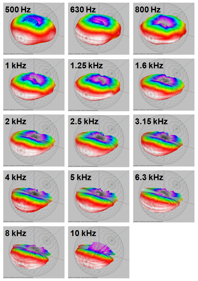

Also attached polar of a smaller prototype as well as a figure that shows the horizontal dispersion. Seems like some missed that earlier. I cannot speak for the Monte Kay's laying CBT center and his mesasurements, but this is what Don Keele has measured.
I hope Don will soon be able to publish polars of the CBT36 and CBT36XL which will have controlled directivity lower in frequency then the prototype.
How did you achieve this without also absorbing the ipsilateral reflection from the principal speaker ? Don't they originate from almost the same location on the wall.
They are about 80cm apart.
Since the XL has the same tweeters and the MaxSPL limit is due to the tweeters, I don't think that it will have more MaxSPL.
