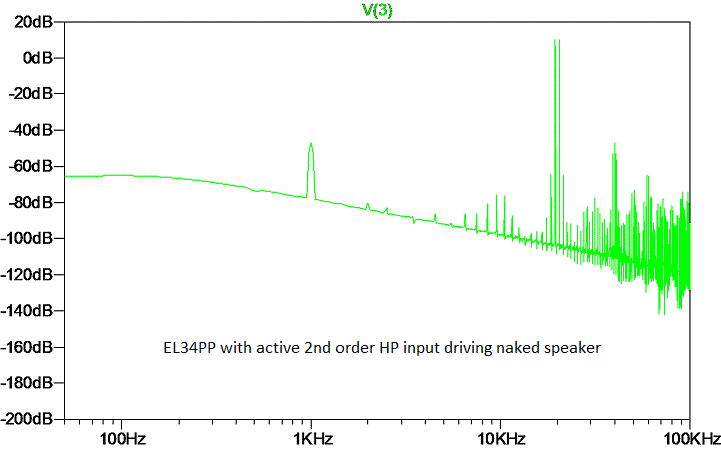

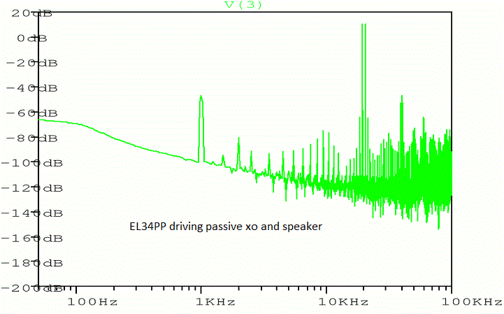

You can't take it in isolation like that. See the IMD sims below. When you step back and include the amplifier, actively filtering before the amp can have its advantages, especially at lower frequencies. Yes, you could use a PLLXO, but it gets pretty limiting for anything but 1st order.
analog:
