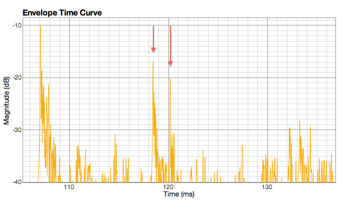

I was doing some experiments with increased speaker toe-in. At 56° I get a pretty spacious presentation. The ETC shows two strong contralateral reflections after about 11ms and 13ms:

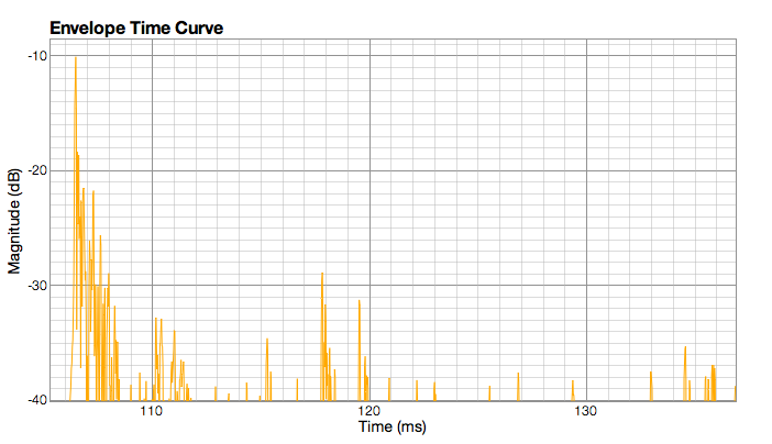

When putting thick porous absorption next to the speaker, the reflections are gone:
Now the image is more detailed and localization is improved but all spaciousness and depth is gone.
In earlier tests I didn't get the spacious image with a 45° toe-in. My assumption was that a contralateral reflection couldn't contribute to spaciousness. It probably simply had to pass a certain level to become a contributor to perceived spaciousness.
Speculating on what's going on, in case when you have delayed large reflection where the ear can distinguish, then the room presents artificial spaciousness. This may also be why people prefer this. If this reflection damps out quickly, then you will have less effects of reduced detail and focus.

Your measurement results indicate, that even when using Gedde's Nathans, you are still getting lateral reflection at -7dB level. Only after placing additional absorbers, you managed to knock the reflections down to -20dB region.
Is this the correct interpretations of your post?
Yes, but the two reflections you see are from the other side of the room. They are caused by the extreme toe-in of 56°. The speakers are firing at the first reflection point of the far wall.
One reflection is directly from the side wall, the other is a ceiling to wall reflection.
