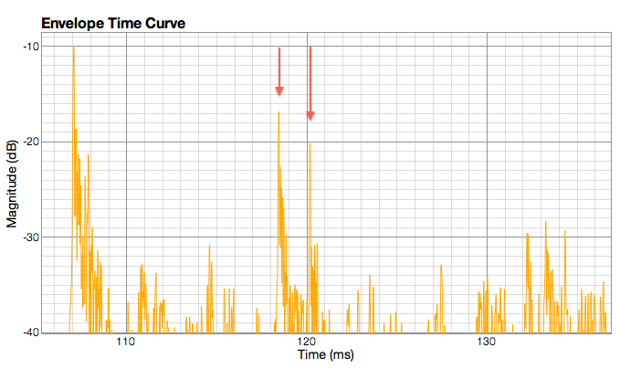

I was doing some experiments with increased speaker toe-in. At 56° I get a pretty spacious presentation. The ETC shows two strong contralateral reflections after about 11ms and 13ms:
attachment.php

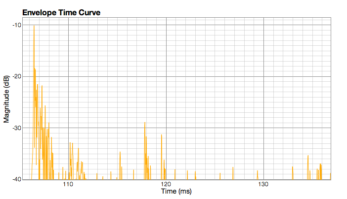

When putting thick porous absorption next to the speaker, the reflections are gone:
attachment.php
Now the image is more detailed and localization is improved but all spaciousness and depth is gone.
In earlier tests I didn't get the spacious image with a 45° toe-in. My assumption was that a contralateral reflection couldn't contribute to spaciousness. It probably simply had to pass a certain level to become a contributor to perceived spaciousness.

Markus,
The spaciousness that is "gone" is the spaciousness of your listening room as a sound effect. This is not a spacious image rendered in source recording.
Without absorber in place the reflections at 11ms and 13ms are only -7dB and -10dB relative to direct sound; with absorber these are reduced to -19dB and -21dB. Switching between the two absorption conditions A/B in short interval would be easy to perceive reflection effect as being On/Off.
Even with reflection reduced to -20dB of direct sound, masking of recorded reverberant effects that are -20dB to virtual source and 12ms later happens.
Then there is matter of spectral content of reflected sound. From description of toe in and directivity of speaker in use, the sound projected toward contralateral wall has greater high frequency content than the sound projected directly toward listener. This could serve to enhance the perception of room as a spaciousness effect.

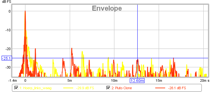

For comparison here is ETC of my Pluto Clone in overlay with ETC from IR posted by Rudolf:
In above plot for Pluto shows floor and ceiling reflections at 4ms, 5ms. Out beyond this in time reflections remain more than 25dB below direct sound for both Pluto in my room, and for Rudolf's result.
My listening room is living room with carpeted floor, acoustic ceiling tiled on plaster. Walls roughly divide up between glass, brick, and wood. Even with lively walls room does not add reflection effect demonstrated with your speakers. Imaging detail is super. Relatively weak reverberant sounds in recordings come through consistently, building up in perception, supporting space about virtual sources in phantom image.
When I revise speaker alignment substantially, first perceptions are often that sound is 'wrong'. Sometimes, over course of listening for several minutes 'wrongness' subsides and listening becomes relaxed. When alignment is dialed in, relaxed acceptance of perception is immediate, this is when speakers and room vanish.

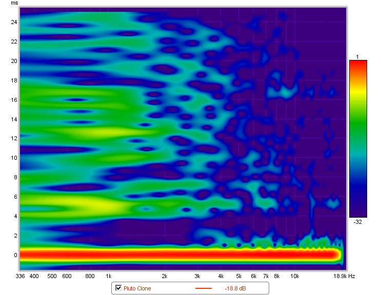

Here is spectrogram of Pluto:
Windowing is 3ms. Spectrogram reveals very omni behavior <3kHz, and that energy >3kHz is more rapidly absorbed and diffused.
It is really difficult to refute association of data with descriptive perceptions. For a working environment, I prefer a room that will allow for detection of system deficiencies. For enjoyment, if I can feel the emotion (or lack of) in the performance for all sorts of music, then it is fine.
