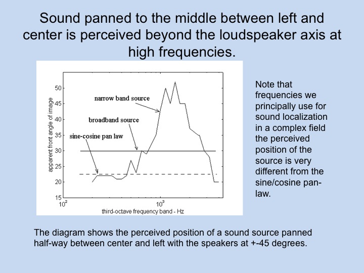

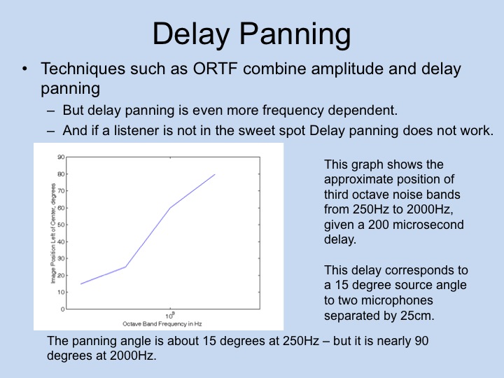

As Pano's experiment clearly showed, the brain doesn't necessarily latch on to the "fastest" signal. It does get confused when slower components don't follow its initial formulation.
The problem is 2-speaker stereo itself. The room can make matters worse, much worse.
See the Benjamin/Brown graphs I had posted.
Griesing shows the same:
attachment.php
attachment.php
(Griesinger, "Pitch, Timbre, Source Separation")

I am asking "What frequency range provides the fastest and most accurate determination of sound localization."
Which is faster and most accurate - a crossbow bolt, or bullet? Both can kill you if they hit you in the head. To ignore one, just because the other is faster, is a risk some may not be willing to take.
What is the practical need to know that which frequency range is more quickly localized? To design a "Home Theater in a Box" system?
The received knowledge in audio is that bass is omnidirectional, so it doesn't matter where the low frequency parts of the spectrum come from, as long as they exist. While that may be a good cheat for size, price, WAF, etc., it isn't high fidelity. I'm so tired of hearing and reading what is clearly wrong, that I've done tests to prove (at least to myself) just how wrong it is.
When this research showed up in the thread that location is dominant >700Hz, it was extrapolated into the idea that <700Hz is not important to localization, therefore we can safely ignore it. I, and others, remained skeptical about how well this would apply to a loudspeaker system. I did some simple experiments to verify this.
Yes, the upper mid-range of frequencies get our attention, for whatever reason. Yes, if we have to cheat with our systems, that's the range to favor. But ignoring the directivity of the lower registers is no way to achieve high fidelity.
My intent is simple. To debunk the audio myth that bass is omnidirectional and can't be localized, therefore we can put it anywhere and not worry. Raising the disregard for directivity to 700Hz is just plain silly. You may dodge the bullet, but that arrow sticking out of the back of your head is going to hurt.

That is an easy experiment which I just did, the 'Sound panned to the middle between left and right... etc.' I suppose everybody will have a tone generator in his PC as well, plus some speakers hooked up, so it only takes 5 minutes.
When I sweep through the frequencies panned 1/2 left, the location of the tone remains exactly at the same spot.
I am interested to hear if others share this experience. What to make of it?

Play single sines with pauses in between. Is localization still rock solid?
Did you also try narrow band noise?
Markus, I sweep manually and there is an automatic pause when the generator locks onto the next frequency, so that came free with the setup. Of course it is important to keep your head in the same position.
I have to do a lot of fiddling to generate narrow band noise, and I don't see how that could influence the outcome, so for the moment I hope someone else is set up for this and will share his experience.

No way each harmonic is glued to its fundamental frequency since all speaker systems exhibit phase shifts. Experiments, even with excessive phase shifts, have not demonstrated any detrimental effect on localization.
I'm not sure that I understand you here. Are you saying that the phase relation between a fundamental and it's harmonics is not stable over time?
But what I really don't understand is how my advice on phase panning can be seen as counterproductive, because Pano's .wav files demonstrate I was right on the money there.
With this sort of listening experiments everybody can be right on his money. Which is in no way critizising Panos work. I always learn a lot from listening to (or measuring from) his files. 🙂
But didn't you say that "5ms time delay is so long, that the signal from that side gets strongly masked. It becomes almost completely inaudible to me, unless I make an effort to hear it" in post #2585?
I would put it this way: If something is coming 5 ms late to my ears and doesn't even fully resemble my original signal, my brain would think of it as an independant new sound.
