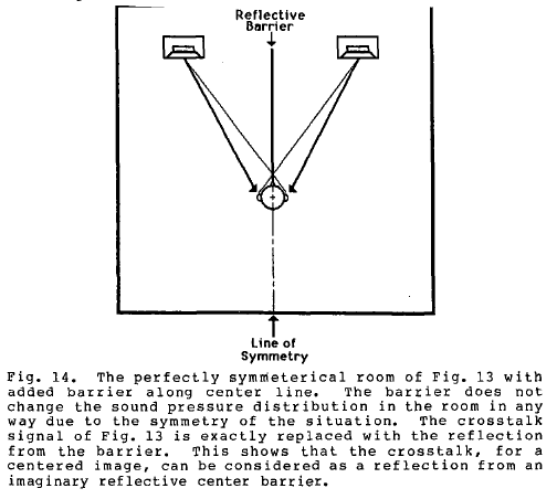

Now back to the crosstalk between ears listening to stereo. The ear closest to the speaker will receive the signal first, which will inhibit perception from the other ear. It's like the Haas effect, but in this case the time delay comes from one ear to the other, and not a reflection.
This would sugest that putting a barrier in front of a listener would have no effect at all ("crosstalk is filtered out") but that is not the case.
If what you say would be true, summing localization based on time (phase) differences couldn't work but if I listen to a sound over headphones, delaying one channel will move the sound accordingly. This proves that there's no inhibition process.
Natural sounds create 2 (delayed) signals at our ears, 2-speaker stereo creates 4. The barrier removes the 2 wrong ones.
Maybe I just mis-read your post?
Have you tried the barrier technique?
