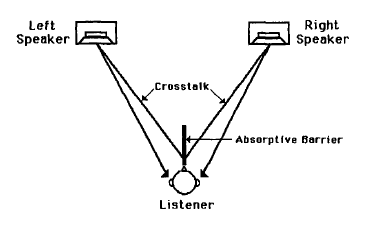

Put a door in front of you and there you have it. Play "Empire Brass in Japan". Amazing depth.
attachment.php
I had similar perception with speakers directly at the side walls with an opening angle of about 90°. It's probably as simple as attenuating the confusing cues from interaural crosstalk.
P.S. Picture is from an Bock/Keele AES preprint.
Better off blocking cues from speaker reaching both ears, when cues radiating from speaker toward each ear are different, do to lack of speaker coherence. With highly coherent speakers, the door is not needed.

I did and it always sounded very distorted (spatially and spectrally).
Glad to know I am not the only one with that conclusion 😉.
I tried it within the Car audio environment and although it worked somewhat to enhance width I could not get over the side effects it produced.
Conventional stereo got me very close to that same effect after careful time alignment and EQ.

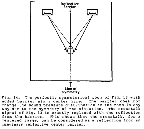

It is quite sarcastic that the same interaural cross talk for which Blumlein set the stereophonic theory on is also the biggest impediment of stereo triangle 🙄
"[...] crosstalk can be thought of as a
high-level early reflection coming from the direction of the
opposite speaker (or from the direction of a true reflection
from an imaginary reflective center barrier). The timing of
this "reflection", however, is unfortunately based on the
path length of the opposite speaker to the listener's ear
and on what is received from the opposite channel. From an
imaging standpoint, this crosstalk "reflection" comes from
the worst possible direction--that of the opposite channel.
Furthermore, this "reflection" is not coherent with the
speaker on the same side as the ear but is coherent with the
opposite channel's signal
. All of these factors contribute
to the very detrimental effect crosstalk has on imaging in a
normal spaced-speaker stereo listening setup."
Bock/Keele, AES preprint 2420
Either I don't understand this or its wrong. The diffraction signal to the opposite ear is coherent. At least as far as I know the deffinition of coherence. Delays in and of themselves do not cause a signal to become incoherent. The issue is that the signal to the other ear interfers with the direct signal and it does this outside of the hearing system and so the hearing system is incapable of removing its effect. This is the same rational as the need to lower early reflections of the signal to say the right ear from the right ears direct signal. Our hearing has a better chance of removing a reflection from the far wall to the other ear because these two signals are less correlated. I think Keele should have used the word "correlated" rather than "coherent".

Yes,
I can't wait to have a barrier in my room to divide it and be in my face..... Oh and only one person at a time can listen to this effect. And no reflections off that surface are being created that are then added to the room reflections? Let's get serious, this is fine if you want to do some type of perceptive testing but not a realistic listening environment. Even if it worked I wouldn't do it....
You might as well go with stereo Blumlein microphones instead of single mono microphone techniques......
