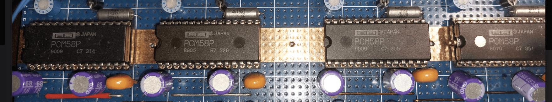

We've done a couple of informal comparisons of perfboard AD1862 vs PCM58 via 'Dark LED', I wouldn't go as far as to call them 'listening tests'. The outcome of those so far favoured PCM58 but we haven't given up on AD1862. I have changed the caps used on the AD1862 board from lytics to tantalums (which are what the DS recommends) and it needs more 'break in' time I reckon.
If price is taken into account then PCM58 offers better bang for the buck based on informal listening. We'll keep going back to AD1862 to verify but until it exceeds PCM58 in SQ (given the price differential) then I'm not planning to develop a board using it. Is that clearer?

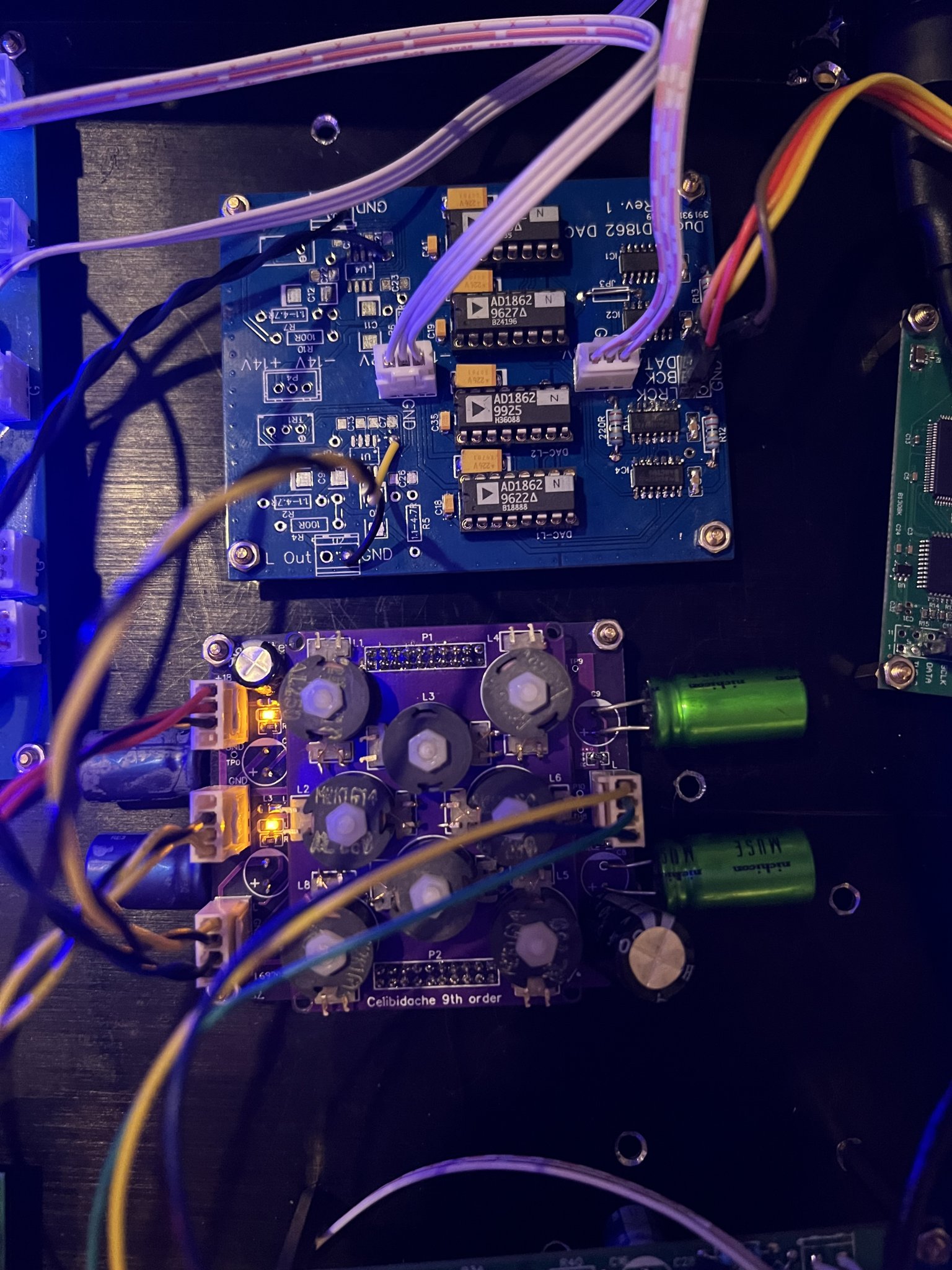

Quick pic of quad AD1862 driving the Dark LED IV/filter:
I also ran the Dark LED with a dual AD1862.
Both sounded fantastic and was for sure an upgrade over the previous IV I was using based on AD797 with a 4th order Sallen-Key filter. Can I tell a difference between dual and quad AD1862, I'm not sure. The game changer was upgradinging the IV solution.

System used:
Headphones: Macbook Air -> Amanero USB to I2S -> Miro inspired quad AD1862 DAC -> Dark LED IV/filter -> Baxandall low noise volume control (6 OPA per channel) -> Whammy HP Amp -> Hifiman Edition XS
Speaker: Macbook Air -> Amanero USB to I2S -> Miro inspired quad AD1862 DAC -> Dark LED IV/filter -> Baxandall low noise volume control (6 OPA per channel) -> Whammy HP Amp -> Aleph J -> Klipsch RP 600m series I

DAC's PS is Miro's PS1 for 5V and 12V
Dark LED's PS is VRDN based at +/-18V, I did my own board layout.
VC and Whammy's PS are shared and also VRDN based at +/-18V but this is a totally different supply than the Dark LED supply.
All are of course linear supplies and each leg has a dedicated R-Core transformer.
I will need to do something different in the future as the case doesn't have enough room for all this kit...

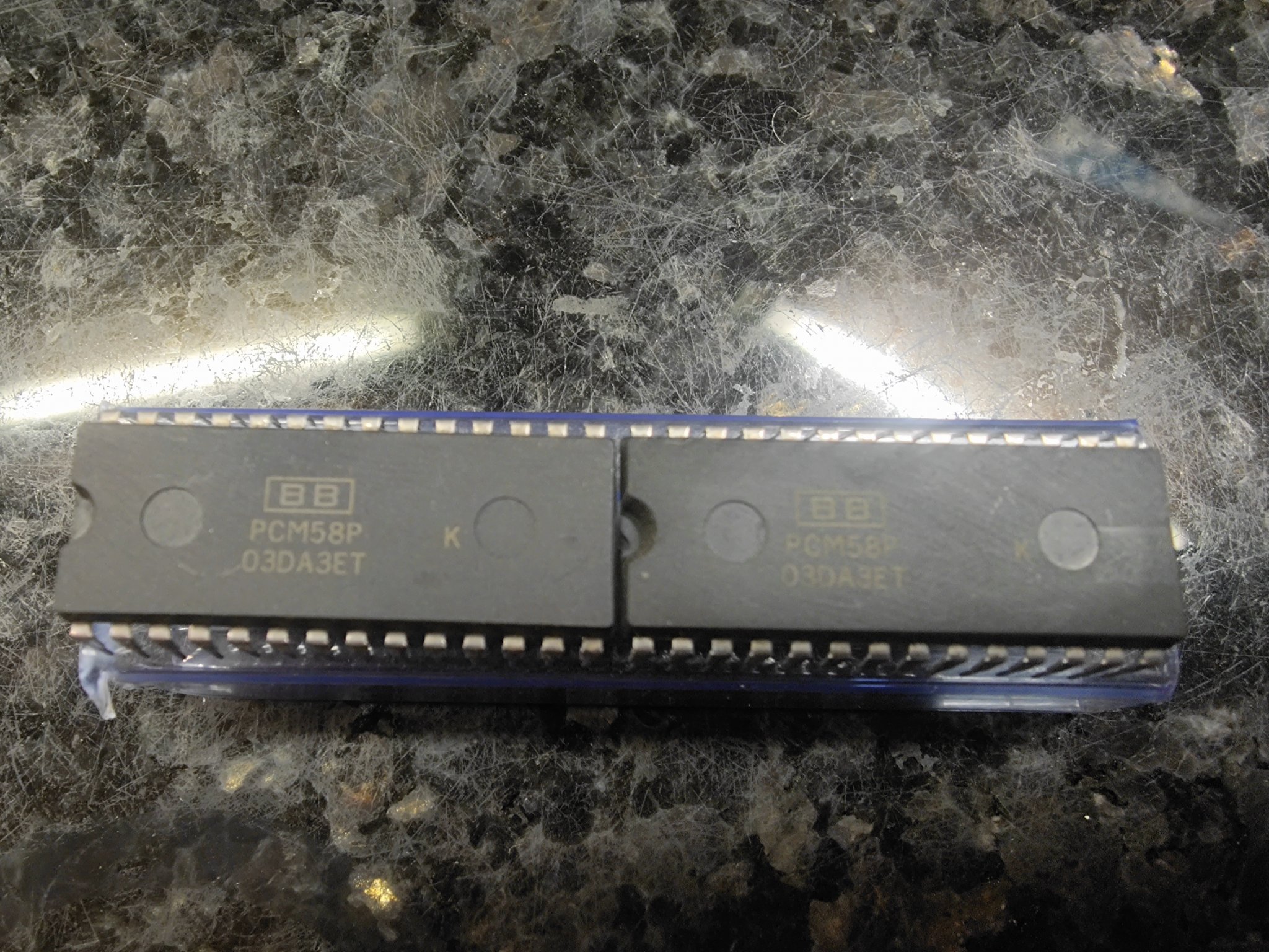

I've basically got 3 types of PCM58 from China that I have in hand:
1) silver print on typical IC surface - most likely 100% original
2) black-topped with white print on it, original date code
3) black-topped and laser marked, with original date code, obviously pulled as pins had markings on it and visible oxidation on pins near the case
...4) black topped, laser marking, and date code of laser marking (most likely, same as I saw with some TDA154x's) - only saw pictures
All until 3) of them were working, didn't yet compare them in performance
Edit: picture of the first batch I've received from china in 2019
