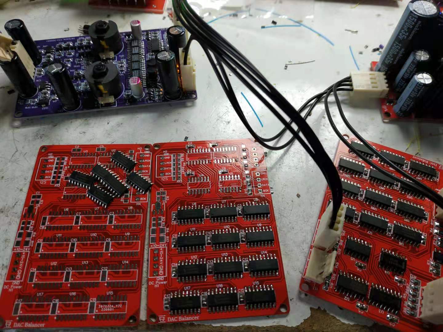

First revision of the I2S splitter boards being populated (using a dozen 74HC595s). Next, I need to give them a test at higher sample rates, see how they fare.
At first they worked only at 44.1k and 96k. Setting the output sample rate to 192k produced a pile of crackles and pops. Turned out that running the logic at 5V introduced an asymmetrical clock because my BCK source is powered at 3.3V. Reducing the logic supply voltage solved this, now it works fine at 192k. I haven't the means to test it any faster but I feel 4X OS is good enough.

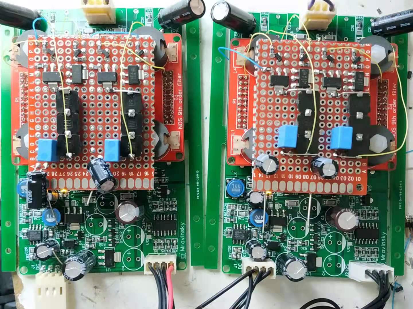

The I2S splitter has facilitated a long-awaited development of Celibidache - the balanced version, which I've given the name 'Mravinsky' to. I had PCBs made for this a couple of months ago but those still used the opamp (LT1028) output stage. I decided I wanted to try for an opamp-less analog stage for balanced Celibidache so I have hacked one together based on one I designed earlier for Abbado. Its using a Sziklai pair (PNP-NPN) rather than the darlington pair I used on Dorati and has a passive low-pass filter to generate the NOS droop correction. The other significant change here is I'm over-currenting the DAC chips by around 50% by tweaking up their pin7s. The end result is a dual-mono setup equivalent to having 60 stereo DAC chips.
What's still to be figured out is - will all that extra stuff on the red protoboard fit on the main PCB?
Hi Richard,
Is the balanced version a noticeable improvement? Will the I2S splitter be compatible with all DACs, including Dorati?
Hi Vunce,
I just tried to persuade wifey it was a step-up but as I haven't got the original Celibidache available for a direct comparison, she's not convinced so far. My instincts say it is but that's relying on my memory.
The I2S splitter is universal, any DAC can be used with it. Dorati is especially suited to it with its passive I/V.
