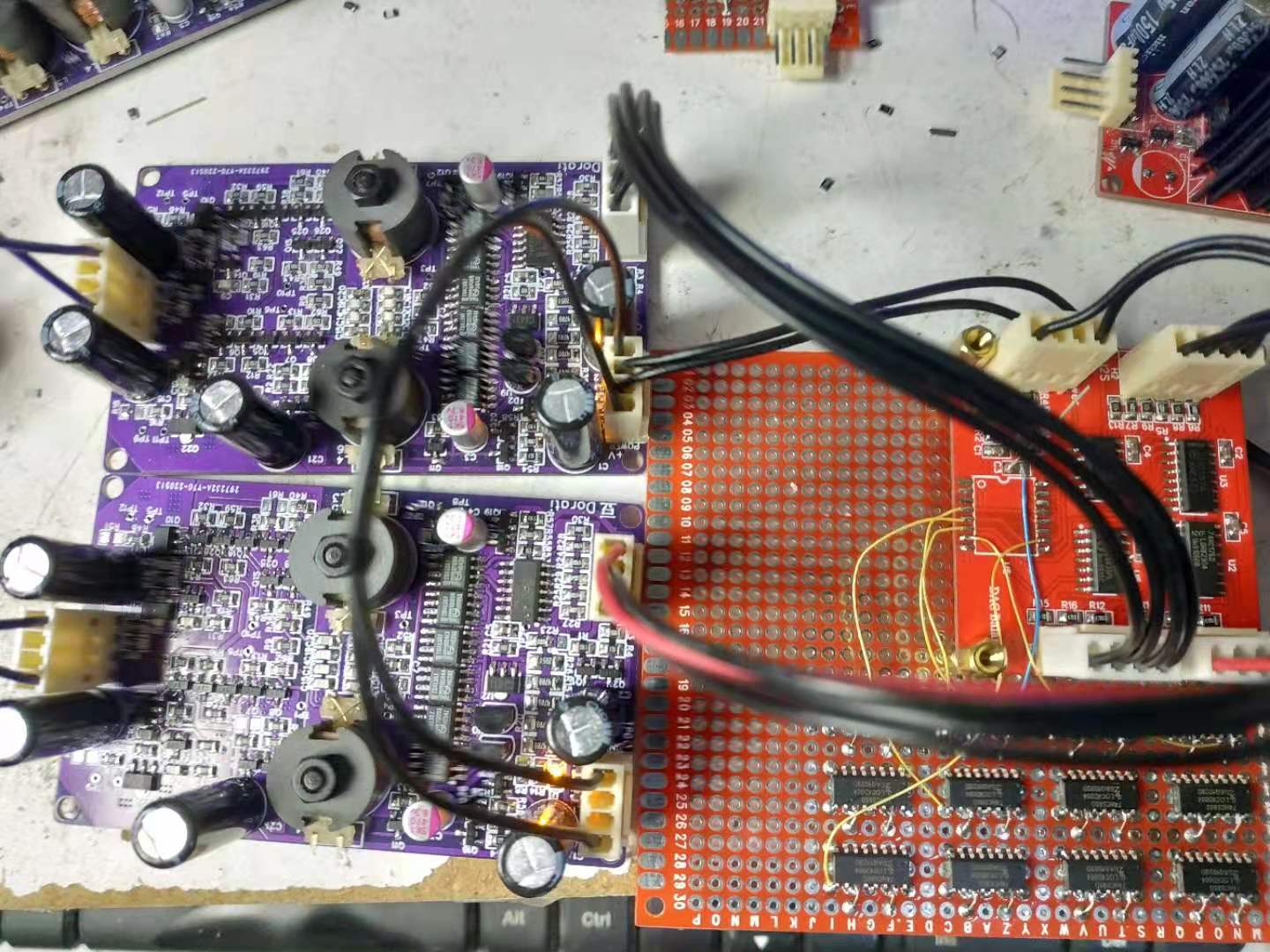

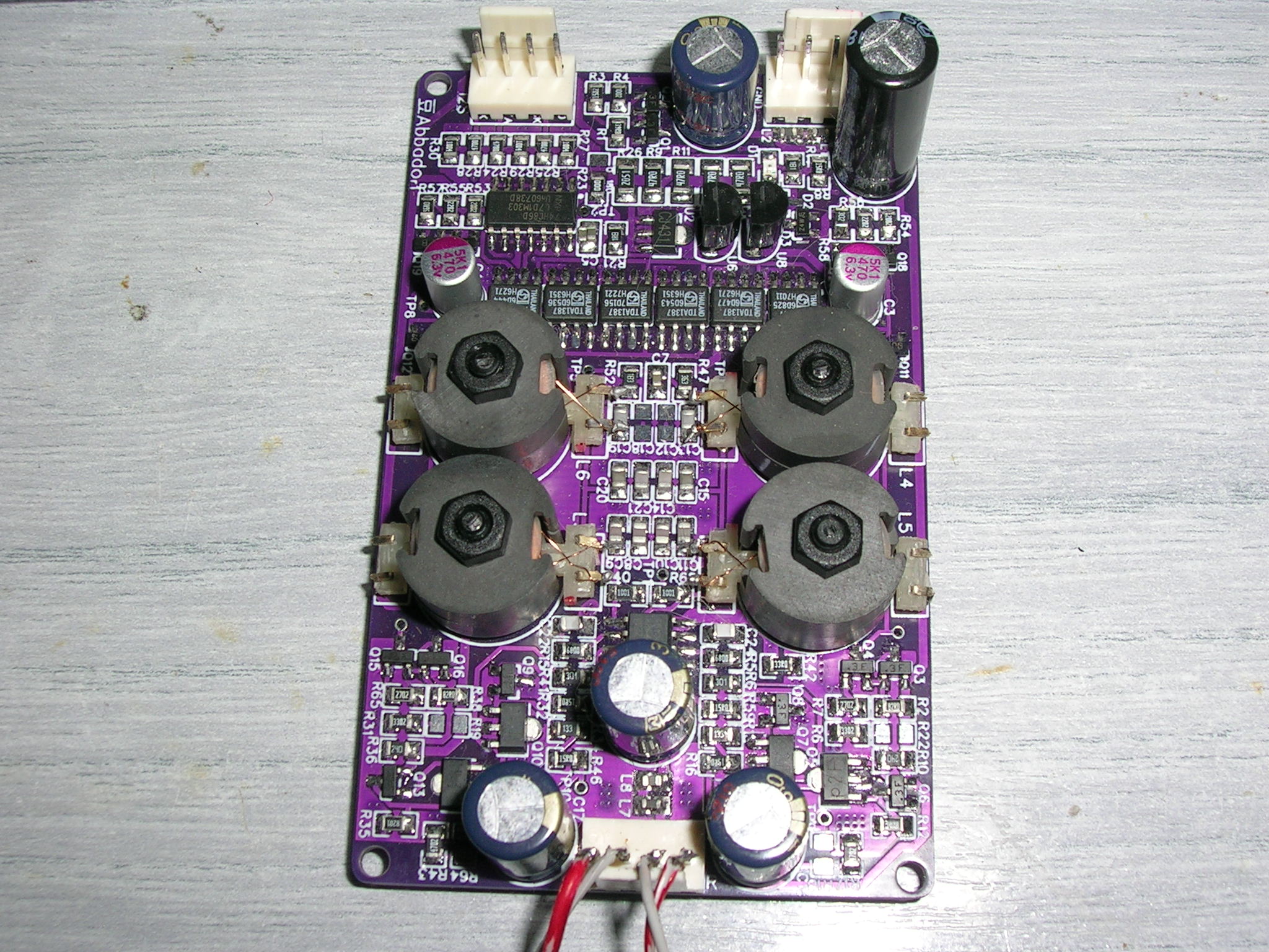

The PCBs for the balancer came back yesterday and it didn't take too long to populate the 5 logic chips. But the output was crackly, and I tracked this down to U5 not working correctly. So I switched it out and this made things worse, no sound at all. I've reluctantly come to the conclusion that my batch of HEF4517s is suspect. I decided to replace that chip with 12 74HC595s on the re-spin which will increase the size of the PCB by 100%. The upside is - it'll work at higher sample rates than NOS since the HC shift-regs are much, much faster than the 4000-series CMOS device. Already listening to Jennifer Warnes through the prototype feeding a pair of Doratis:

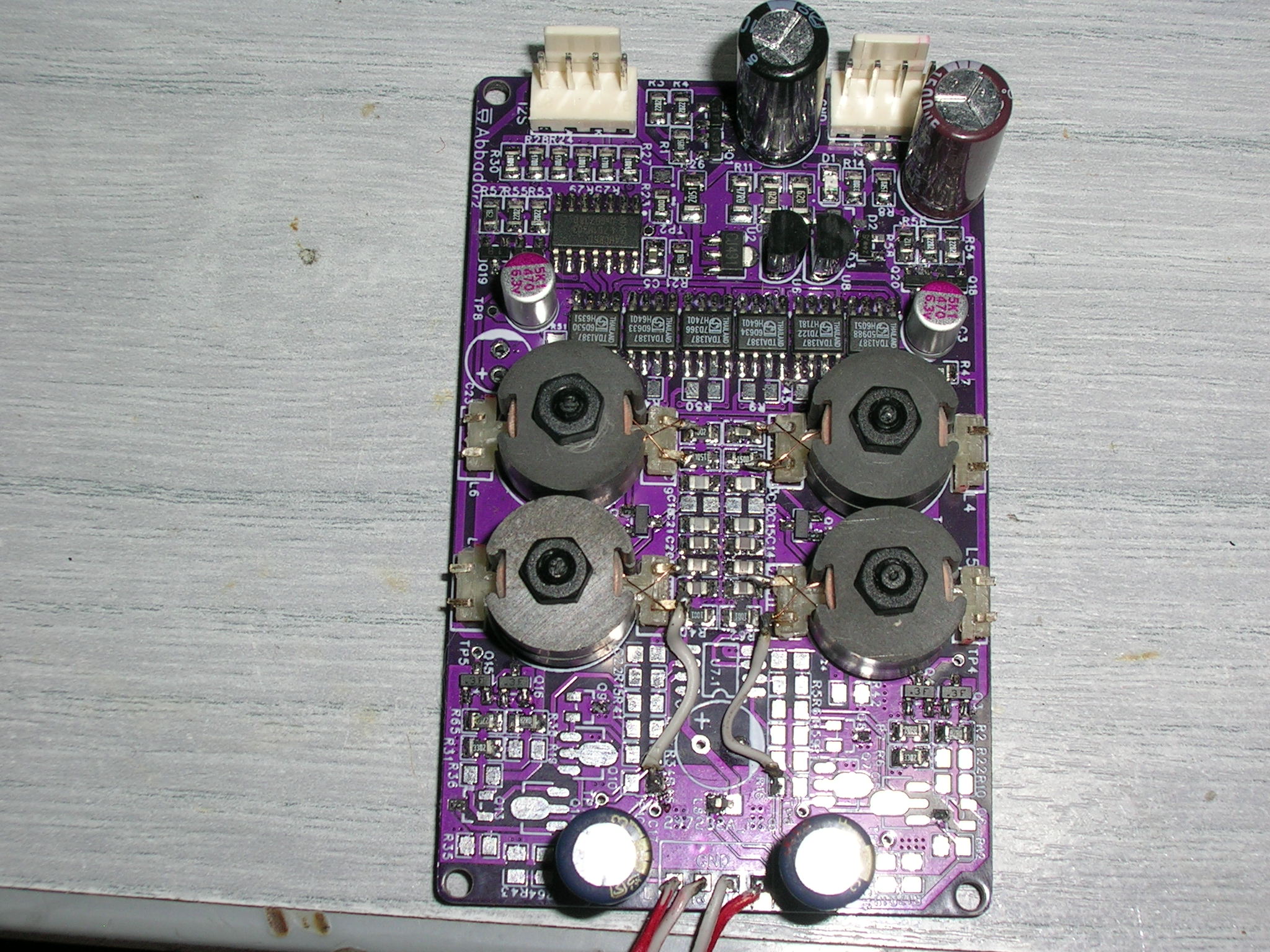

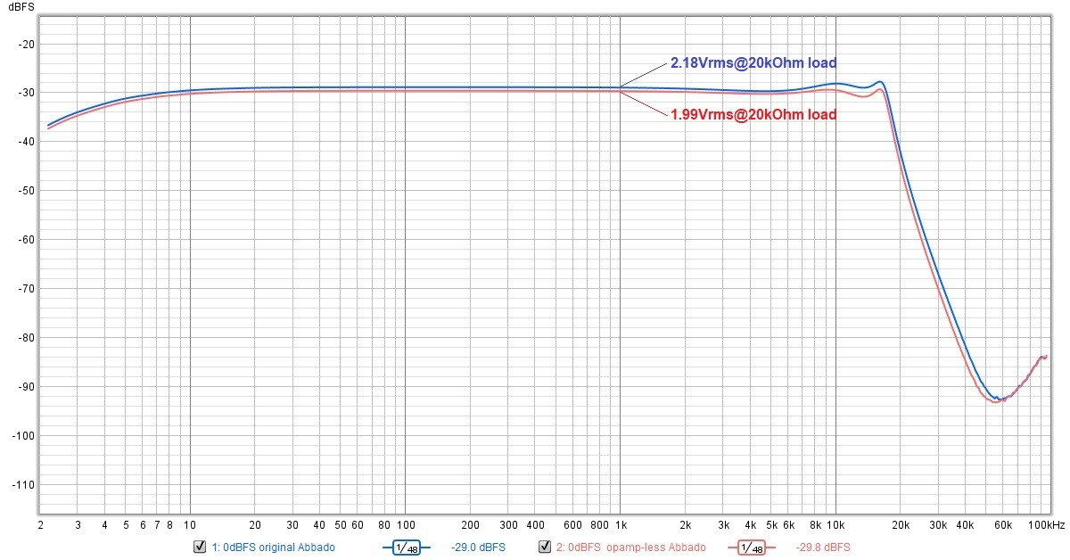

A few days ago I received two boards from Abraxalito.
One original Abbado with OPA2209 opamp and one opamp-less Abbado.
They both require 12Vdc. The onboard PSU section is the same on both.
Their audio out is about the same. Original outputs 2.18Vrms, opamp-less outputs 1.99Vrms (0dBFS 1kHz input, with 20kOhm load at the output)

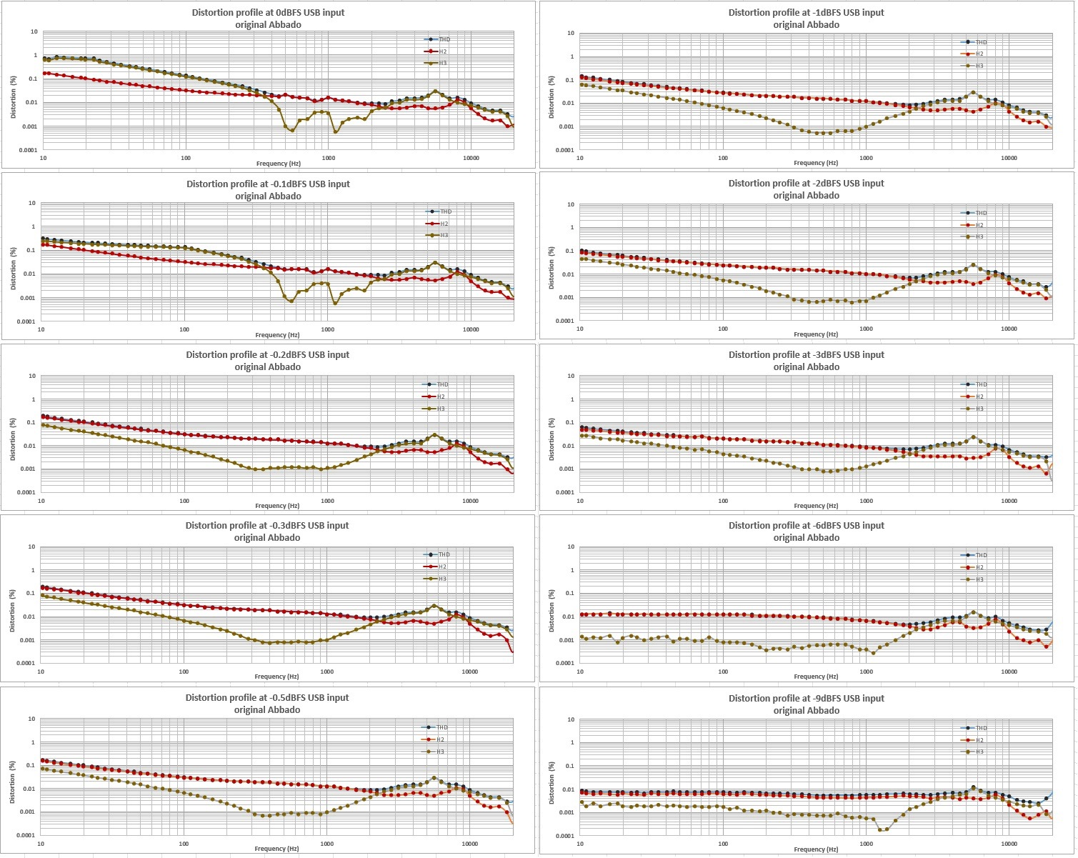

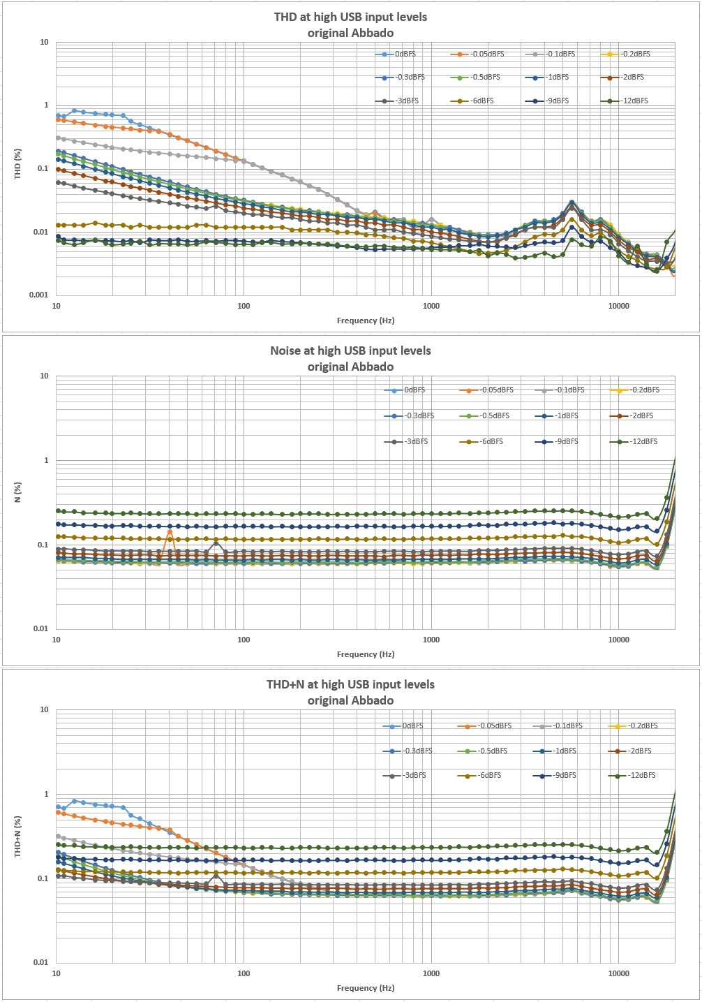

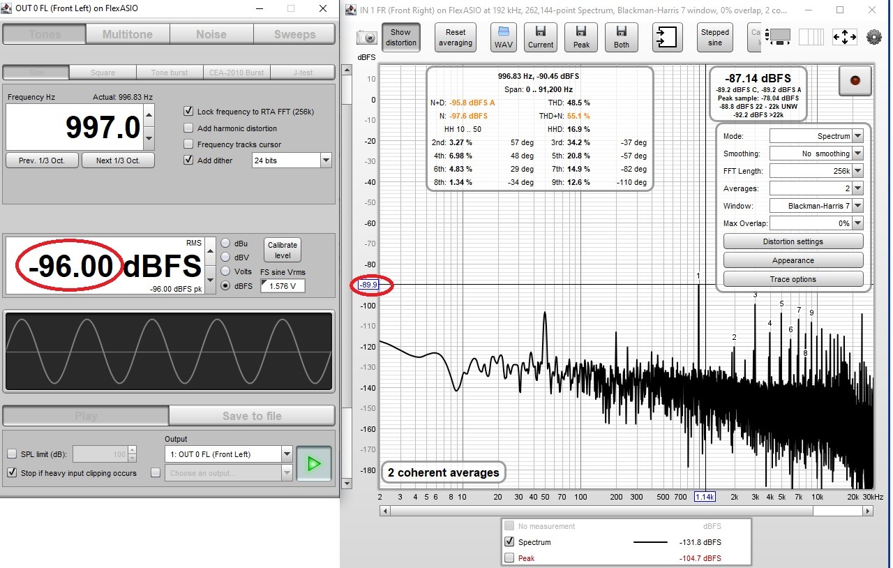

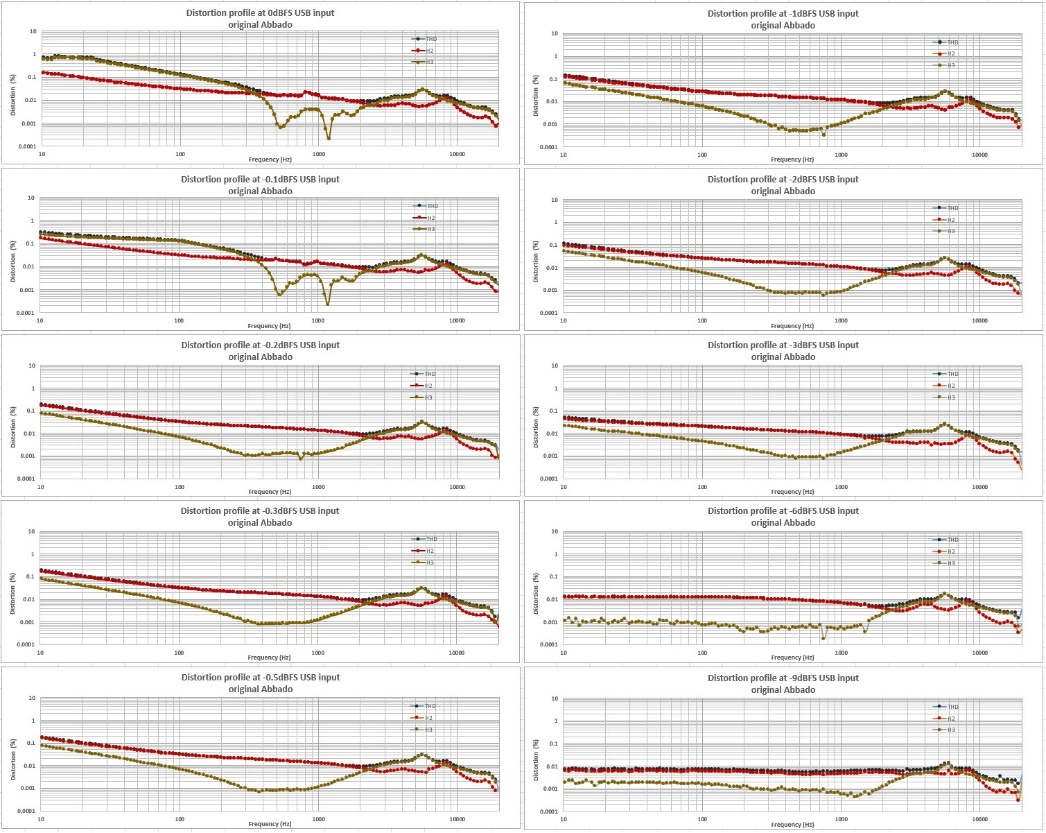

I did some basic distortion profile measurements (step freq with REW)

Glad the DACs arrived safely George.

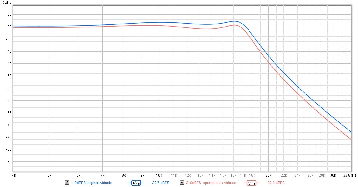

Interesting plots of the frequency response - you'll note that the 'original Abbado' has NOS droop correction in the opamp stage which results in a rising response (by about 2dB) at the higher frequencies.

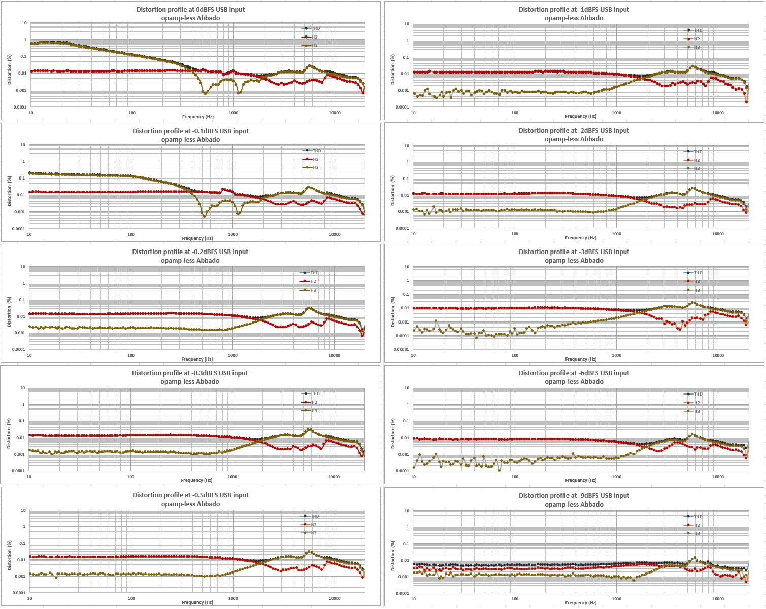

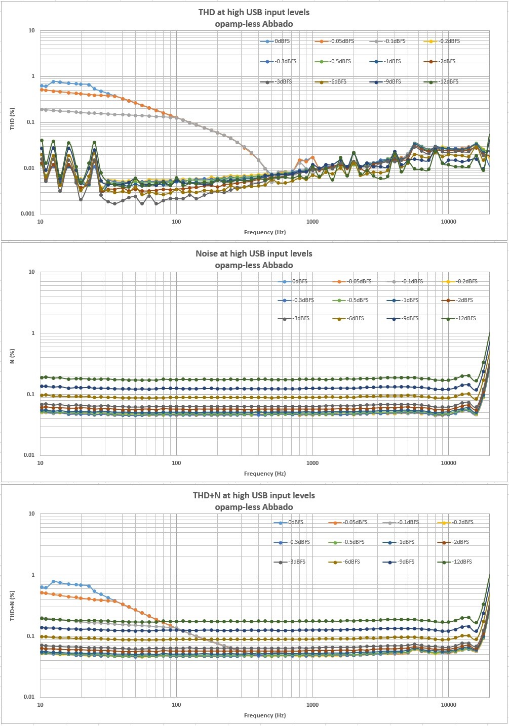

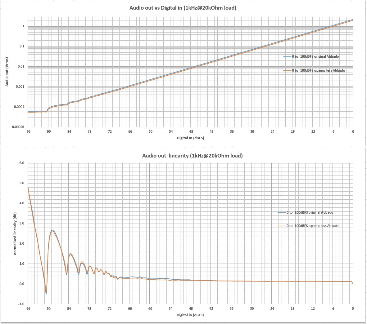

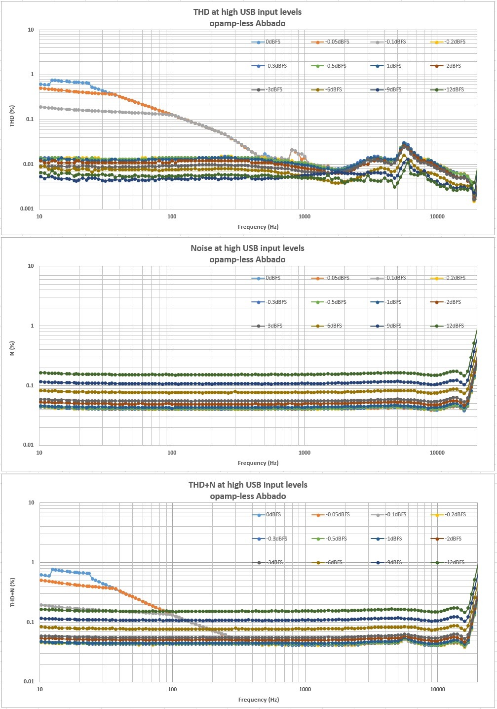

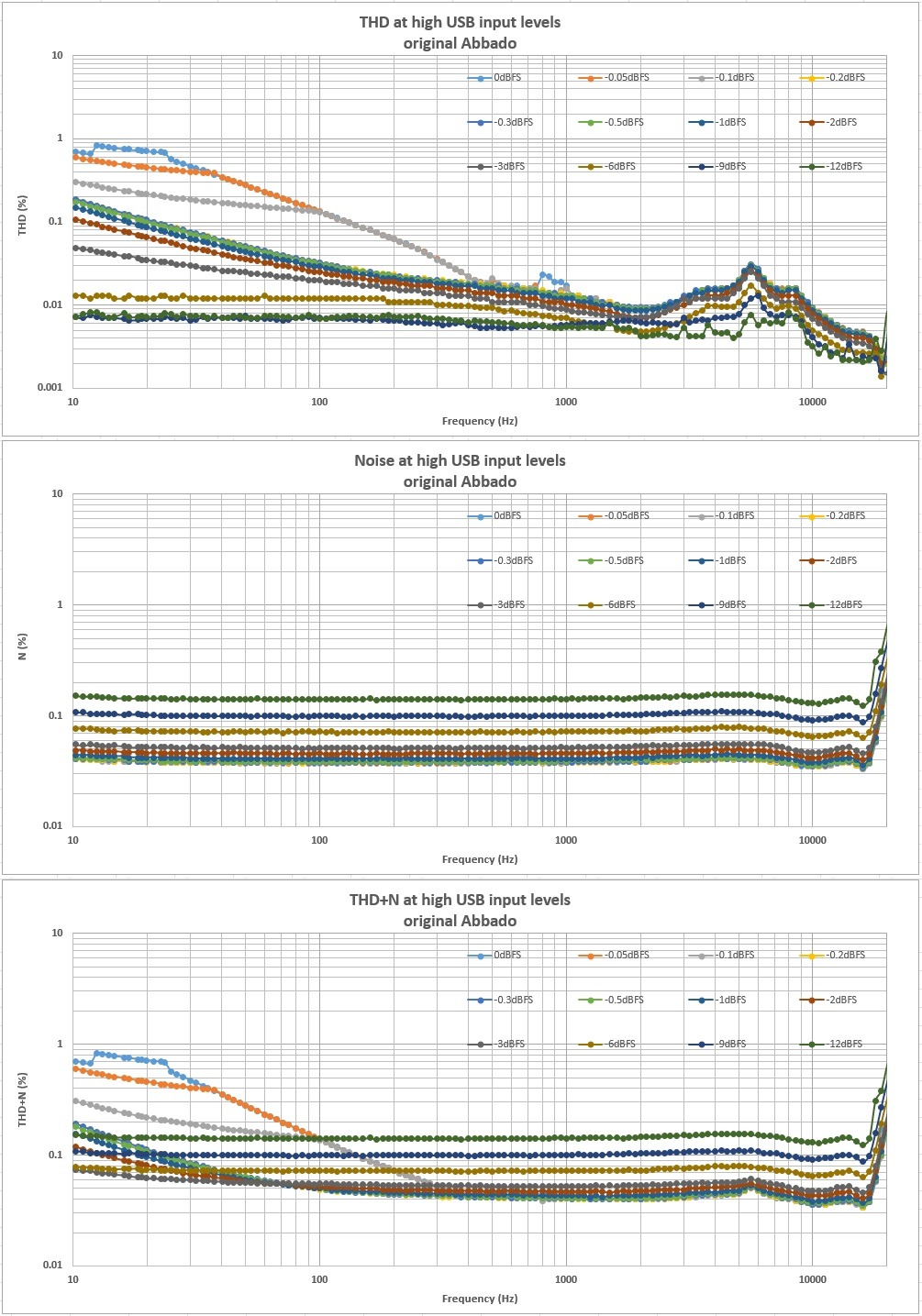

I decided to do again the distortion profile tests shown two posts above. There was something wrong there (peaks at subharmonics of 50Hz).
Now it is easier to see the better behaviour of the opamp-less Abbado at levels below -0.1dBFS at the low to mid frequencies.

Thanks George...
From experience I would say it is sadly difficult to say how these figures affect the sound of the unit, which is IMHO at the end the ilportant thing.
I am not sure how to interpret all those figures, other than for the original unit: "there are indeed a lot of distorsions at or very near peak level in the sub 100Hz region"
Having said that, I am not sure there is a lot of music recorded at 0dBFs to -0.1dBFS levels. Plus when looking at the usefull harmonic structure of the distorsions, one sees at these values potentialy harmless H3 (gives often boost to beats) mainly and then H2. Apart from that finding, I would say distorsions are anyway low / lower than many things when listening to music in real life, quite at the units noise level, so probably secondary to listener preference hence asking how does this little music box (it isn't a pure HIFI modern DAC in the sense of today's vanishing THD +N units) sounds.
Oh, and the original unit seems to have a tuning where in this critical area listed above, H2 has been made dominant around the voice principal tone, our ears are for sure very sensitive in this 0.4 to 2kHz region, so these THD (again at very peak levels) are also probably not making ears bleed. Intersting to see that at other / quiter levels, the H2 is dominant across the audio range up to the treble where it is quite on a par with H3 and anyway, as said, THD + N probably secondary to listening preferences.
Of course it is early in the morning and I could be very wrong with my reading and all this LOL!

Moving on the op-amp less version... and carrying on with my possibly completely silly interpretation of all this, so please fell free to correct me!
One can see the main finding between the critical 0dBFS and -0.1dBFS range, but here one could say that the range has been made more begnin being only half, say really critical down to -0.05dBFs . Not sure there is a lot of music recorded at this dangerously high level, perhaps at mastering, who knows?
In comparison with the normal version, this op-amp less unit has less distorsions at high levels in the bass region, and is quite comparable otherwise. The harmonic profile is similar, but the op-amp less version shines with lower values and a better / more constant relationship between H2 and H3 across the range... possibly at the cost of slightly higher H3 in the treble.
As long as it sounds right, no harm IMHO, perhaps the op-amp less version sounds more consistant across awider range and more pleasing to the ears, with a possible small downside in the treble were sounds could be more perceing... but since when could one foretell the sound of a unit based on these measurements anyway GLOL?
Good to have these though, as I can't see any show stopper or terrible cheating... Ok, I admit, I am not an ASR fan when it comes to sound and measurements.
Care to elaborate your findings, anyone? Just to see if my morning's feeling is about right... could be intersting to compare these values with Celibidace or more uprange models from our DAC wizard...
Have a nice day and thanks again for sharing George

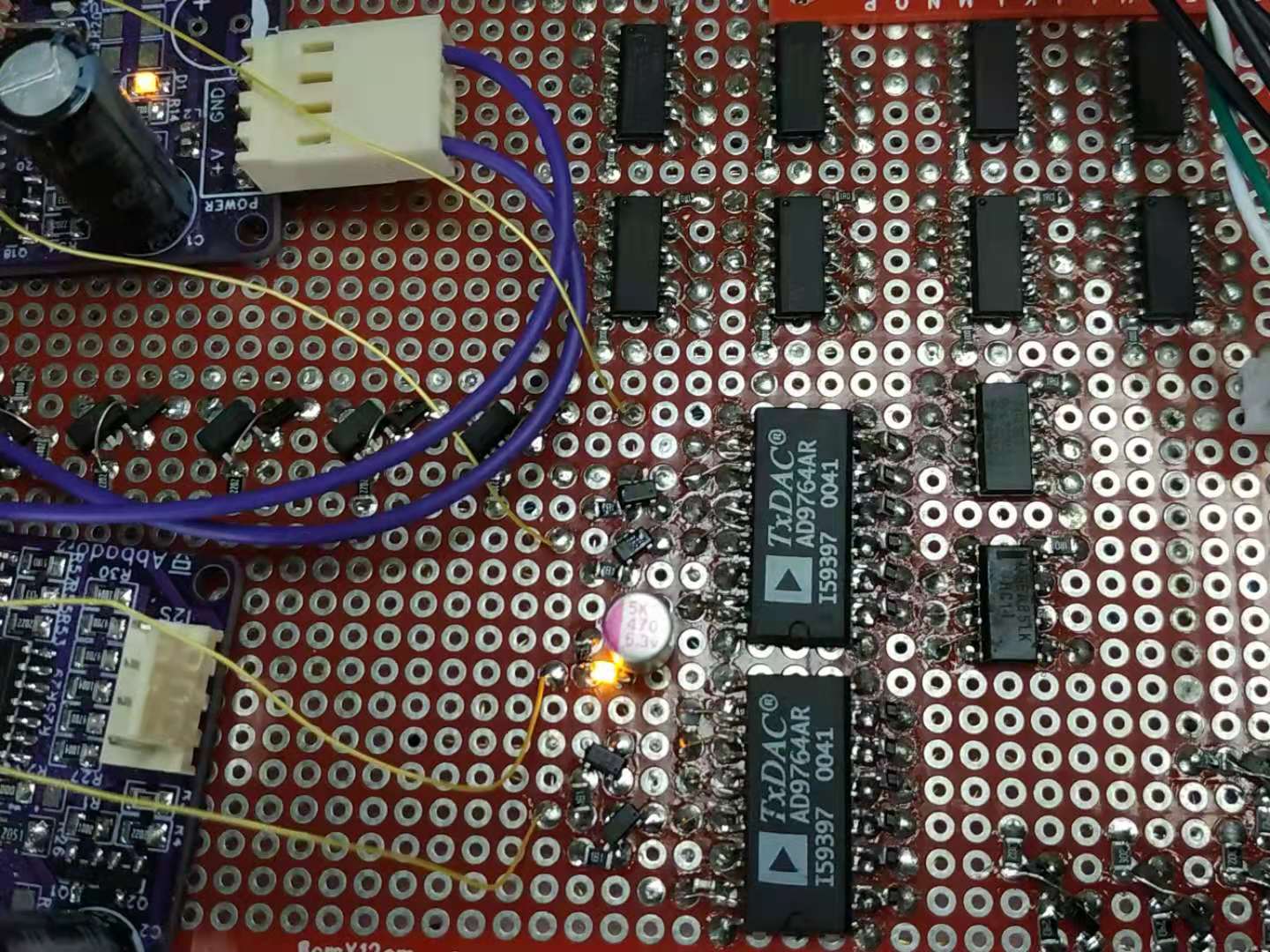

I've been wondering if its high time to dump the TDA1387 on future DAC development work. I'm not enamoured with any of the other traditional audio DAC chips as I'm hankering after much more current to make the I/V stage easier to get low enough noise.
Communications DAC chips have lots of current available (typically up to 20mA) just they're not normally available in 16bits. So I wanted to listen to what's lost with fewer bits - here's my first prototype with AD9764 which is a 14bit chip, parallel input. I'm using the filters and I/V stage from Abbado here. Initial listening seems to indicate the AD9764 is lower noise in the midrange and HF at least than with Abbado (6 * TDA1387), jury's out on LF noise. Next step is to introduce some oversampling and try to get the 14bits of these chips to do the work of a 16bit chip. Recall that ESS DAC chips only use a 6bit DAC to achieve their ultra-low noise and THD, in conjunction with oversampling.

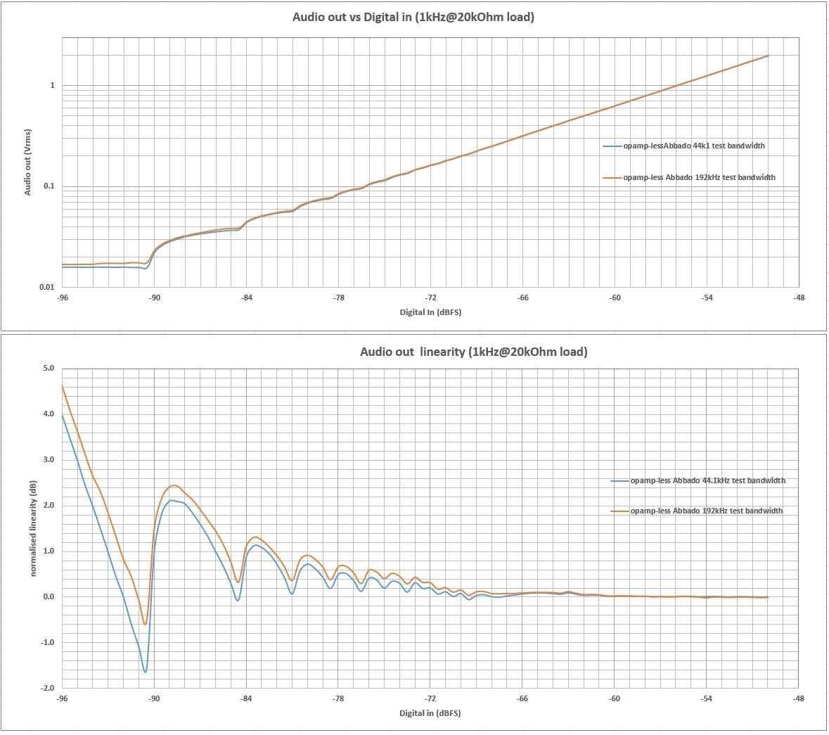

I repeated the test at 44.1KHz-24bit (see 2nd attachment and compare results).

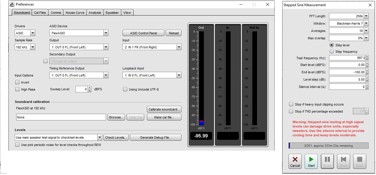

As distortion profile testing requires 192kHz bandwidt, I do all the testings at 192kHz/24dB for not to change settings at three different windows (and mix things up when I forget to change one).
The x16 averaging in these linearity tests is essential for noise-immunized results but makes each test run a multi hour process.

You can use the generator in single test freq in conjunction with the FFT panel.
Start the generator from very low level and place the cursor over the peak of the fundamental.
On the dBFS scale the amplitude of the fundamental will be shown in blue.
Write down the gen level and that shown on the FFT dBFS scale.
Increase the generator level in small increments and write down the pairs of dBFS readings (the two red circles at the attachment).
Where the incremental change of the generator’s level does not match the incremental change of the FFT reading, there is a non-linear region.
You can then document this by running the step level procedure over a limited frequency range for to save time. 🙂
Non linearity ripples can be shown even with lower averaging.

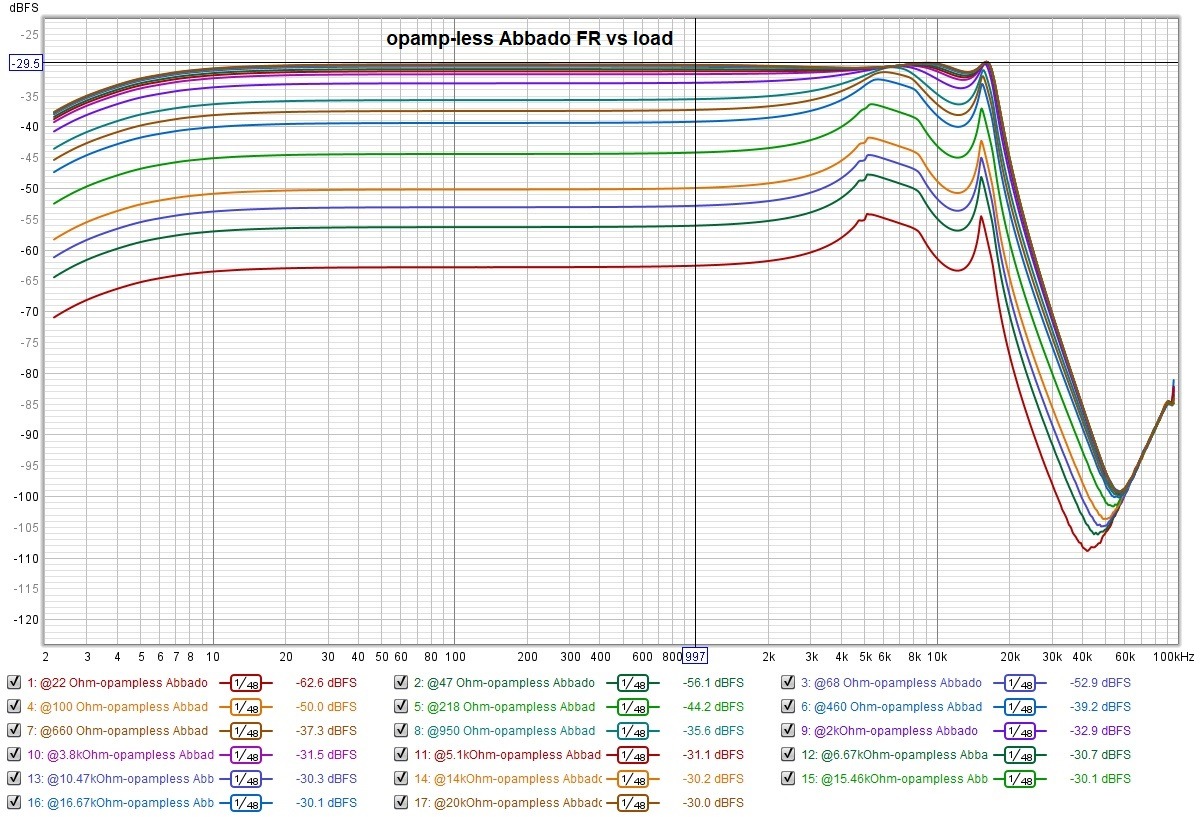

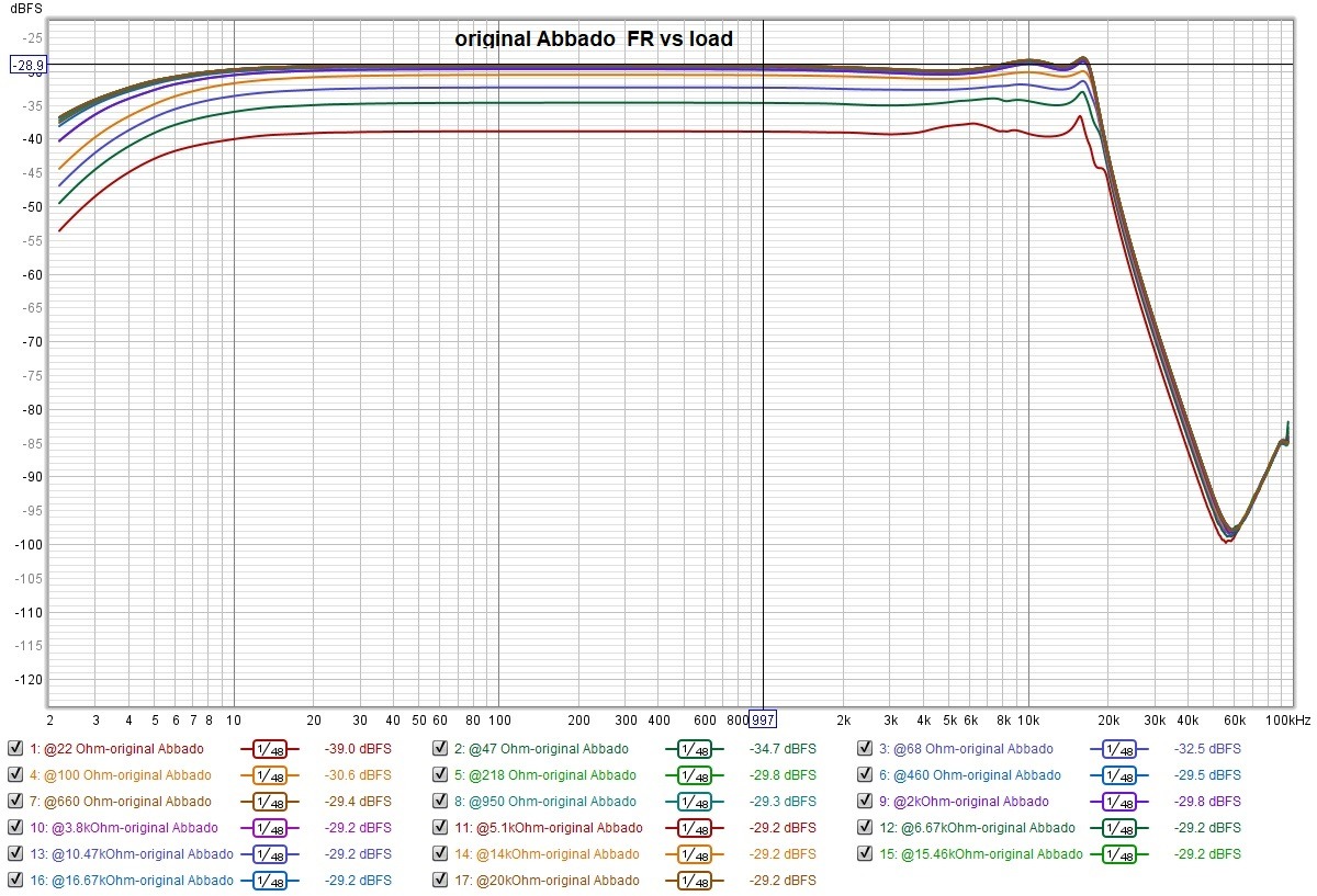

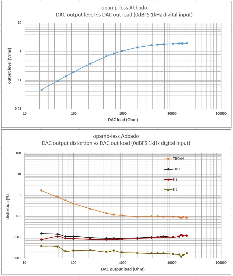

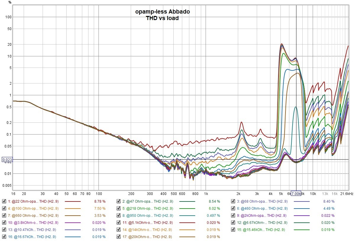

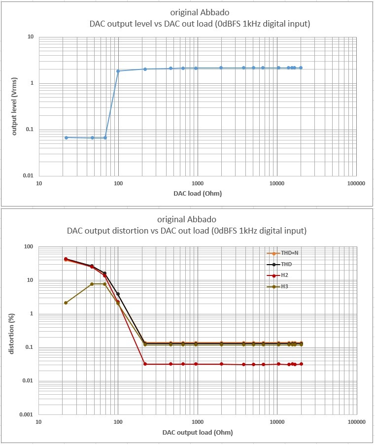

Continuing the testing on the original and on the opamp-less Abbado, I looked into their behavior with different loads at their output. As usual I was testing at 1kHz.
The original Abbado showed the typical behavior. Below some 200 Ohm load, output level drops sharply and distortion rises to the sky. (attachment 1)
The opamp-less Abbado’s behavior was rather untypical. Gradual output drop with heavier loading but distortion remained very low, only the THD+N increasing slightly. (attachment 2). That seemed suspiciously too good.

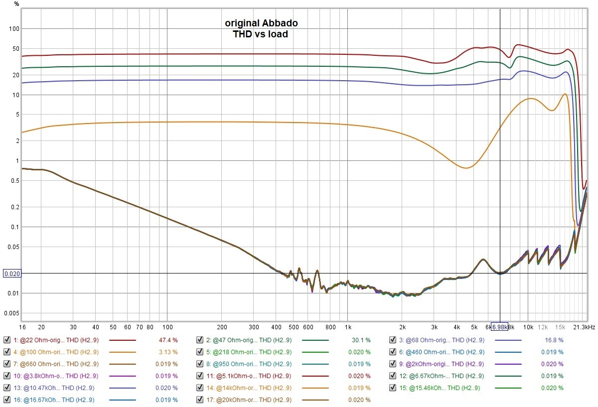

I decided to run some fast distortion sweeps (not quite accurate but good enough to show trends).
Well, the original Abbado shows the THD increase across the freq spectrum for load below 200 Ohm (attachment 3).
The opamp-less Abbado shows THD increasing sharply only btn 4KHZ and 10kHz for loads below 1kOhm (attachment 4)
That said, an overall good behavior from the opamp-less Abbado. 🙂
George
George

George - the opamp-less Abbado I sent you has a 1kohm resistor for I/V and that's the output impedance when you send the voltage across that resistor directly out to your test equipment. The 1kohm output impedance is not designed to drive any external equipment - and if you load it with any significant resistance the frequency response of the CLCLC filter gets messed up. But seeing as its being driven with a current source distortion isn't going to change much with loading. You might be seeing the effect of the FR being bent out of shape implicitly in your attachment #4. I note attachment #6 shows this explicitly - with lower and lower impedances the Q goes sky-high at the corner frequency.
I'd just like to point out here that 'opamp-less' shouldn't be interpreted in the same manner as in 'Dorati is an opamp-less version of Kubelik' because in Dorati there's a buffer and an EQ stage implemented in discrete form. In this opamp-less Abbado there is neither of these stages because its intended only as a research platform, not a finalized DAC design.

Hi Abraxalito.
You are right. I had asked you this bufferless opampless Abbado for running experiments.
It's output impedance can be infered from Attachment 2 on my previous post (-6dB drop at 1kOhm load).
That said, the current source works very well for any reasonable DAC line load (not for driving headphones).
Headphones too will be driven with your buffered Dorati in an optimum way
Keep up the good work.
George
That is indeed what I looked at to figure out what kind of output stage you were measuring there George. Once I saw the 6dB drop at 1k load I instantly understood the answer - 'none'.😎
I've built a current source drive DAC for headphones in earlier times - I don't think I talked about it here but there's a picture on my Hackaday page : https://hackaday.io/project/176711-current-source-drive-for-headphones
I guess you are in the "less is more" pool with both feet (but with a reasoning of an EE) 🙂
