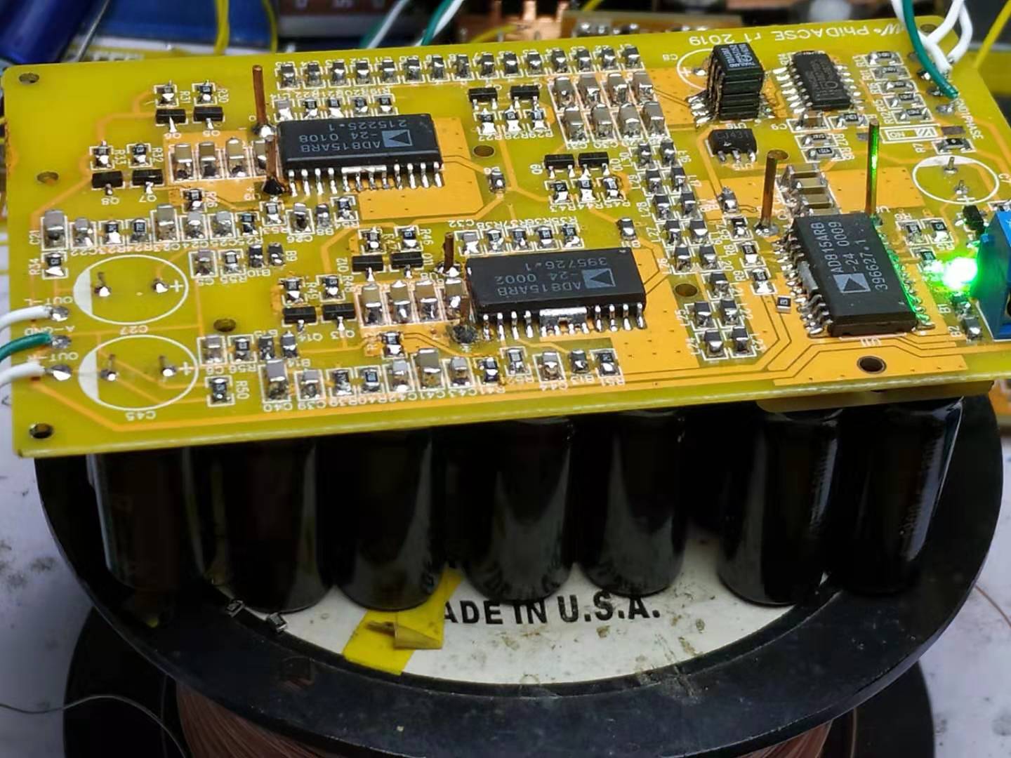

Added 3 extra DAC chips to an old PhiDAC SE I had lying around - same kind of improvement in ambience (or bloom or air). Fairly simple mod for anyone who has one (@obscurus maybe?).
Even though PhiDAC (original) isn't designed for driving headphones it does a great job into my HD6XX which are 300ohm and fairly efficient. No need for any more volume than 2VRMS. Mind you I am itching to get a balanced cable set so I can try them with a balanced pair of SE buffs :)

Here's the first pass schematic for PhiDAC Quad (or QuadRat DAC whatever). The part that's not really fixed in stone is the CLC filter as the prototypes I built were using SLF7045 inductors selected in value rather than TDK MLFs (too much soldering on the latter!). If that change is responsible for part of the improvement in SQ then the MLFs will have to go....
Any update on whether the inductors are contributing to the SQ?
It seems that the MLF inductors are contributing to higher frequency distortion at high signal levels. I compared distortion between SLF7045s and the original MLFs and found the SLFs contributed less. Not sure whether this is audible yet.
Another thing I have played with is the biassing current source - its better to move that to connect directly to the TDA1387s output rather than downstream on the output of the CLC filter. That way reduces the DC current through the MLFs which I reckon was making an audible degradation, especially to the LF ambience.
So then there's a trade-off here - the MLFs I chose after using SLFs on the original lingDAC because when they're used in series the tolerance of the overall inductance gets better (on average). If we go back to the 20% tolerance SLF7045s then either I need to measure and pre-select inductors for kits (making them more expensive) or DIYers will need an inductance meter and adjust other filter components (mainly NP0 caps) accordingly. Just putting a randomly chosen inductor into the CLC could result in fairly wonky FR.
A third alternative would be to try to source some better tolerance inductors. I'll see what's on offer from Mouser. In the meantime, feedback as to what potential builders of PhiDAC Quad would prefer would be good :)
By 'bigger' do you mean larger package or higher value? None larger than 0805 and higher values have even lower current ratings. But on my Mouser search I did come across some quite nice looking TDK wound inductors in 1210 package (3X larger area than 0805). So if and when Taobao comes back to life again I'll get some ordered. They are more expensive but the upside is I won't need quite as many. 47uH looks to be the sweet spot in terms of best Q. Oh and another upside of these will be the current rating goes up by a significant factor, meaning you can stack even more chips without worry of distortion if you're so inclined.
