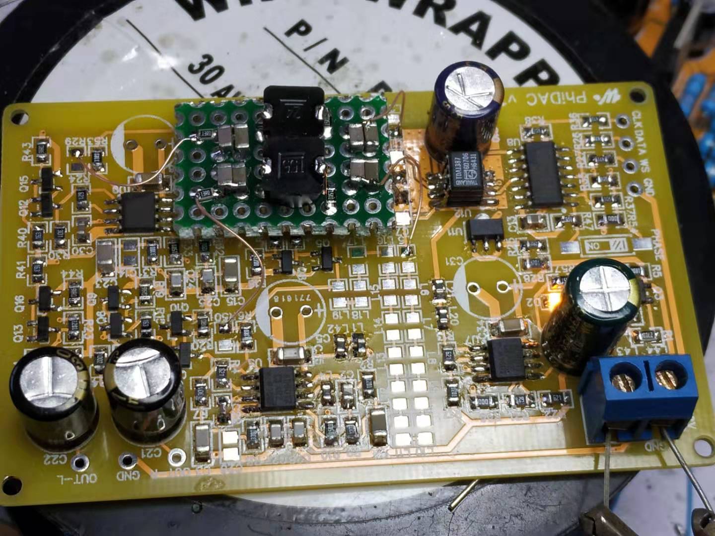

Its Chinese New Year's Day here so I decided to get into the holiday swing by forgetting about GrossDAC and having a play with PhiDAC again, inspired by @sajunky's questions back in the autumn regarding adding more DAC chips. Turns out I was a little bit pessimistic about how hard it is - increasing the chips to 4 (rather than 8 as mentioned by @sajunky) isn't too hard at all. Only one capacitor (per channel) needs to be changed - that's C2/C12. 4 chips doesn't exceed the current rating of the MLF inductors so they stay as they are, various resistor values do need tweaking.
Initial listening seems to show that the low frequency ambience gets better with more chips. So this lends support to the idea that paralleling could be why GrossDAC has the best ambience retrieval of any DAC I've played with. But its early days yet, don't read too much into this very preliminary conclusion.

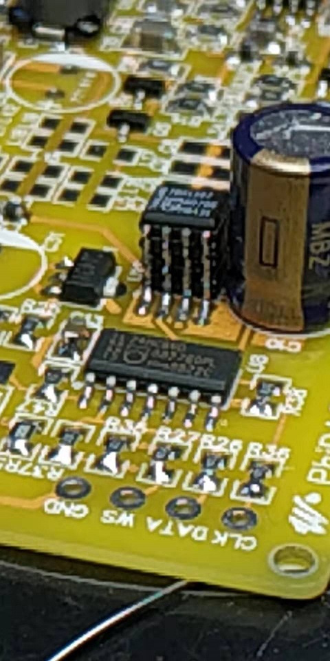

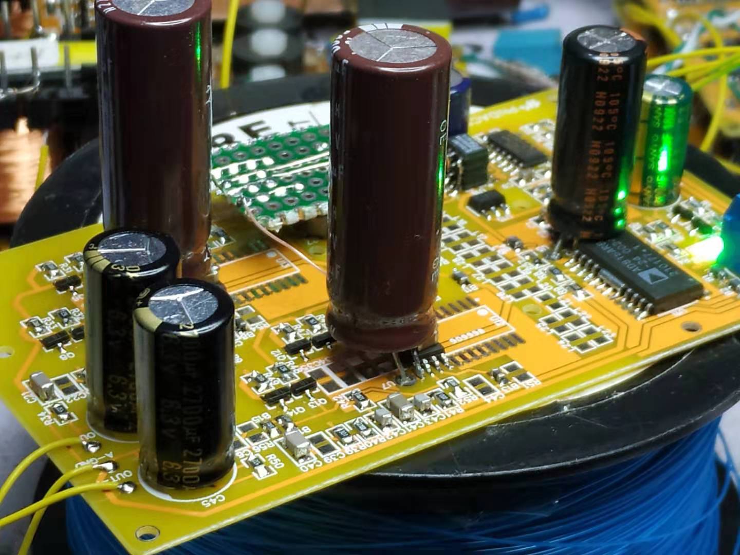

In my test-bed DAC I've placed the filter components on a daughter board for ease of fiddling with them. DAC chips are stacked in the traditional way by bending the leads of the upper chips inwards then bridging between them with solder. Its very easy to miss an open circuit with this method, be sure to check continuity with a multimeter.

A practical tip: When stacking chips vertically I put a thin quality wire along from the top to the bottom, especially for Vcc, GND. Otherwise these series of joints may not work properly.

Have done that on various builds - becomes virtually mandatory when stacks of more than 4 chips are built. But I figured with 4 I would go for just solder.

That is quite a jump from 820pf to 200uf! I suppose I will just solder the 200uf on top of the existing cap. Does not seem to make much sense removing it. Does anyone know a reputable ebay seller for TDA1387?
