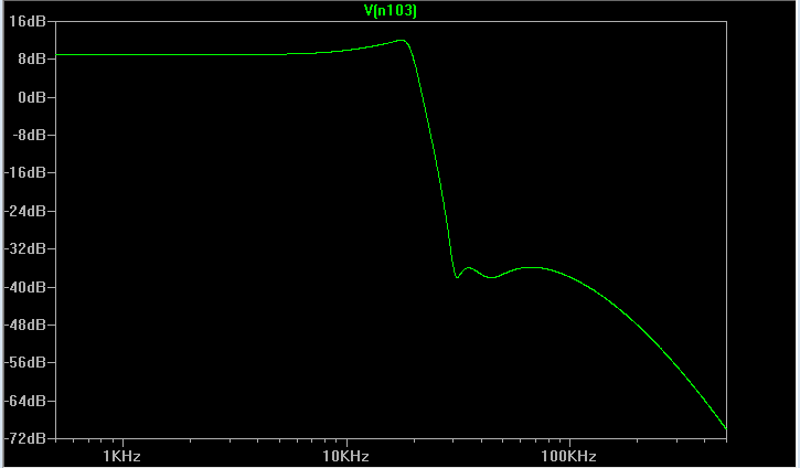

Here's what the filter looks like in LTSpice - you'll note there's almost 3dB lift at 18kHz to counteract what's commonly called the 'NOS droop'. Beyond 18kHz the response falls fairly steeply to a rejection of around -44dB above 30kHz. This doesn't eliminate all images from the DAC - to do that with NOS at the 16bit level would call for a filter more than twice as complex as this one.
The stop band attenuation at higher frequencies (>100kHz) is greatly helped by the series resistors (R9,10 etc) at the expense of reduced attenuation at the zeroes, a price well worth paying I feel.

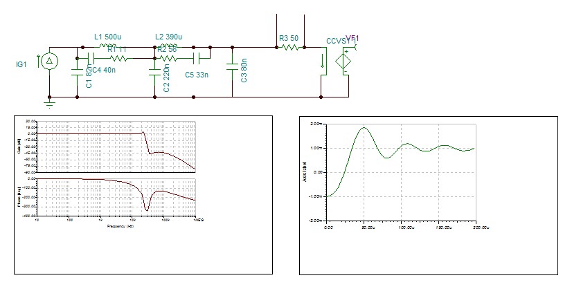

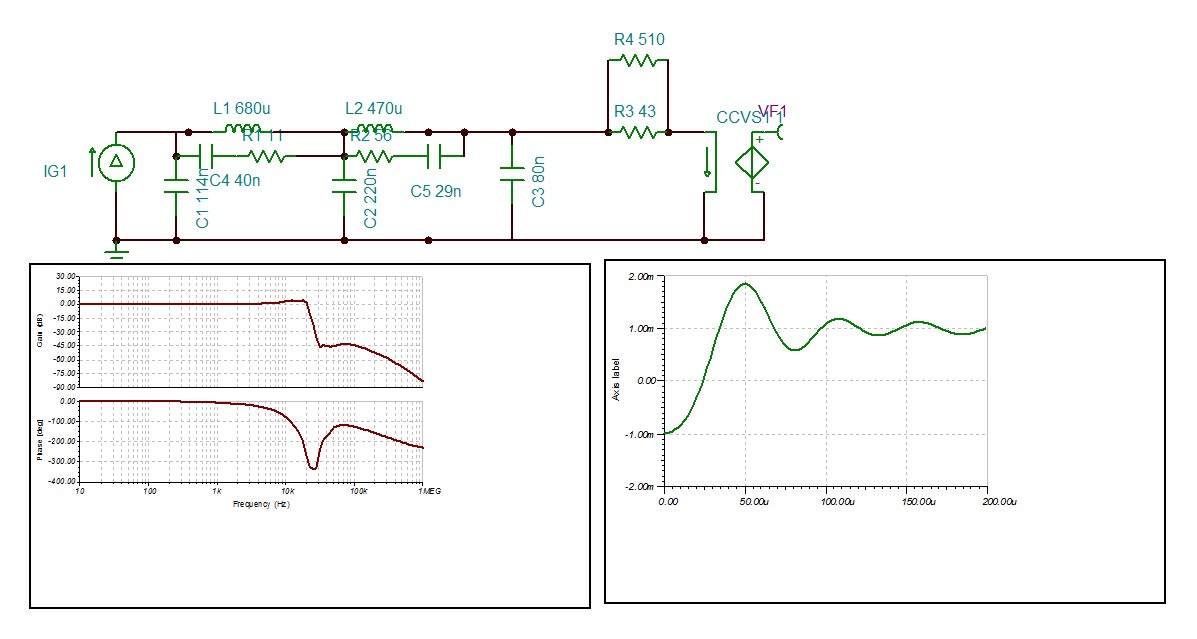

modification proposition
The filter has a resonant frequency of about 17khz , this is fundamental error . The frequency should be half of sampled frequency that is 22.4khz (24) for 48khz . I modified for you with the same damping factor but with flatter response up to 20khz . What is marvelous with Z filter as this how Dual (German brand) has baptized it, it's phase response . The filter has a constant delay of 19us . If you compare the phase shift with a delayed signal ,the phase error at 10khz is+1.4° from 1khz as references and -7.4°at 20Khz . In other words the phase shift throughout the whole spectrum is+/-4.5° only . Now after 30 years I finally understood why Dual non over sampled models as cd1045 had so high presence sound .

Looks like you increased the cut-off frequency (and consequently the stop-band start frequency) and got rid of the NOS boost. I can't see why this is going to be better though - you reckon the phase response is the most critical thing about a filter? Without the NOS boost you'd need to run the DAC oversampled to get a flat passband, maybe 4X OS?

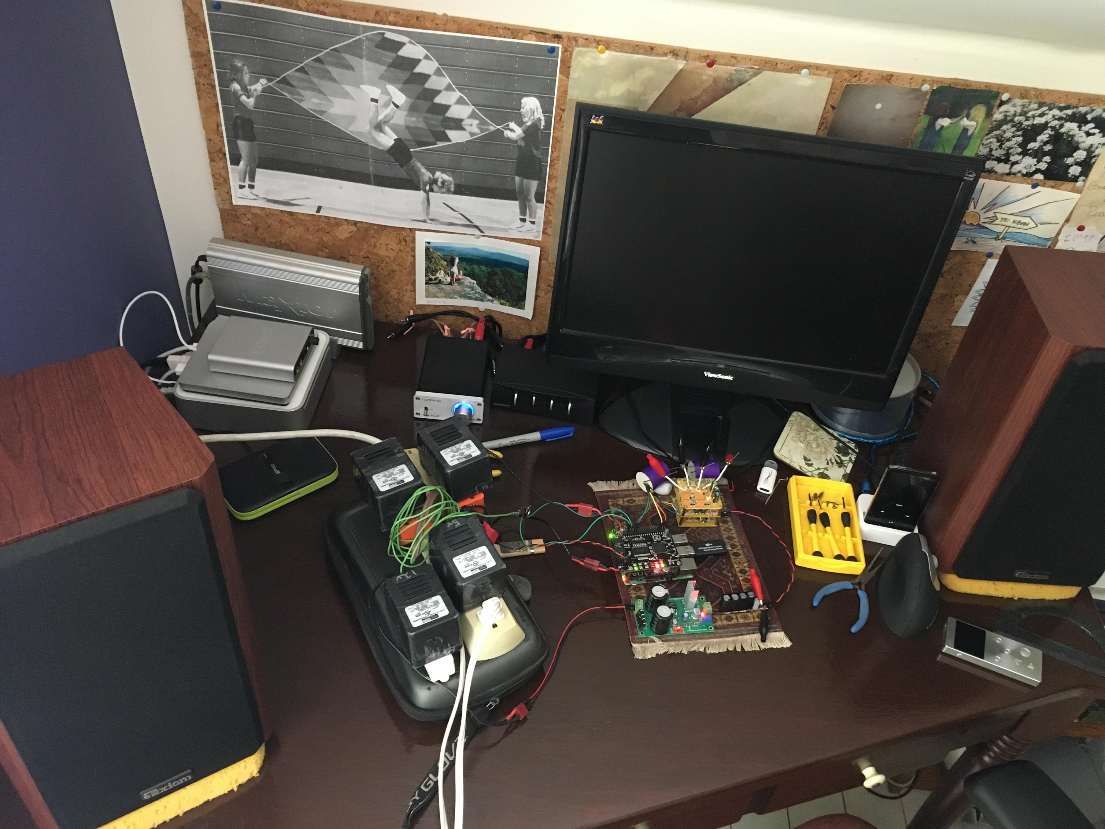

Here is a pic of my test setup. Source is Volumio on RPi stacked with an IanCanada IsolatorPi and Allo Kali. Each board is fed by its own modified, grounded 5V Jameco linear wall wart. LingDAC gets 8.1V from a similar Jameco 12V supply, stepped down through an eBay LT3042 module, followed by a CRCRCRC filter. I am using 6.8uF ClarityCaps CSA to couple LingDAC to my modified Topping Tp20 mk2 Tripath amp. Bookshelf speakers are Axiom M3.

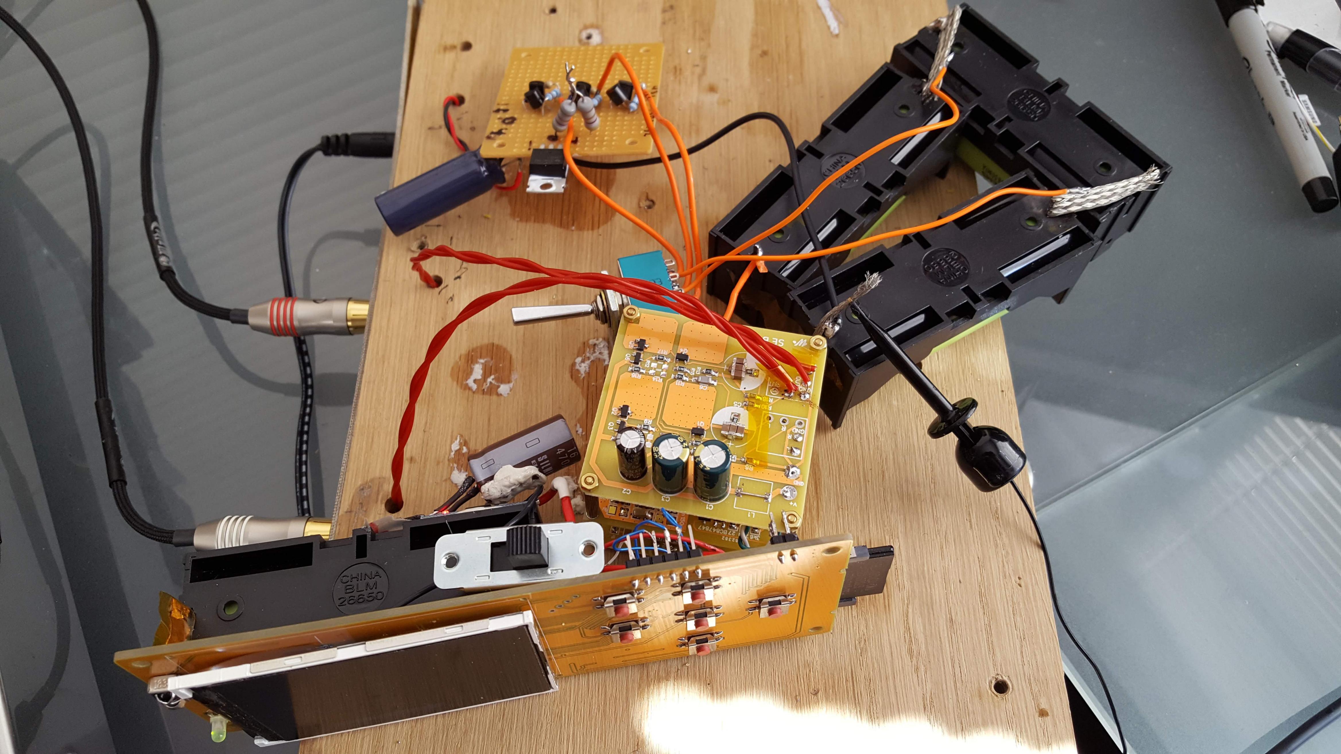

I removed the ceramic output caps and resistor, and replaced with 6.8uF films. See pic in post 50.
The big purple PP caps dwarf the board rather comically, and I will eventually just short the board terminals and wire the caps to RCA jacks when I case this thing up.
But if you want to keep with the compact theme, I also tried 6.8uF WIMA MKS, which fits directly on the board and is the largest value WIMA film cap available with 5mm lead spacing, I believe. These polyesters are slightly less transparent than PP but still a huge upgrade IMO.
