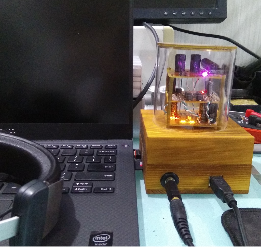

I've attached a picture of one of the early incarnations of lingDAC - its a USB-fed DAC-AMP driving low impedance headphones direct up to 100mW or so. Three of the PCBs (DAC, I/V-filter, SE buffer) are in the plexiglass tower. In the wooden base are a USB-I2S interface (not my design, sourced from Taobao) and a power supply.

thanks abraxalito,
i have also an 8xTDA1387 as replacement for a TDA1541aA in my Marantz CD583 in use. Worked without any modifications. These chips were also pulled and i got them for €6 (8Pieces).
Thnx for publishing the gerbers, when all debugging is done.
BR
Günni
