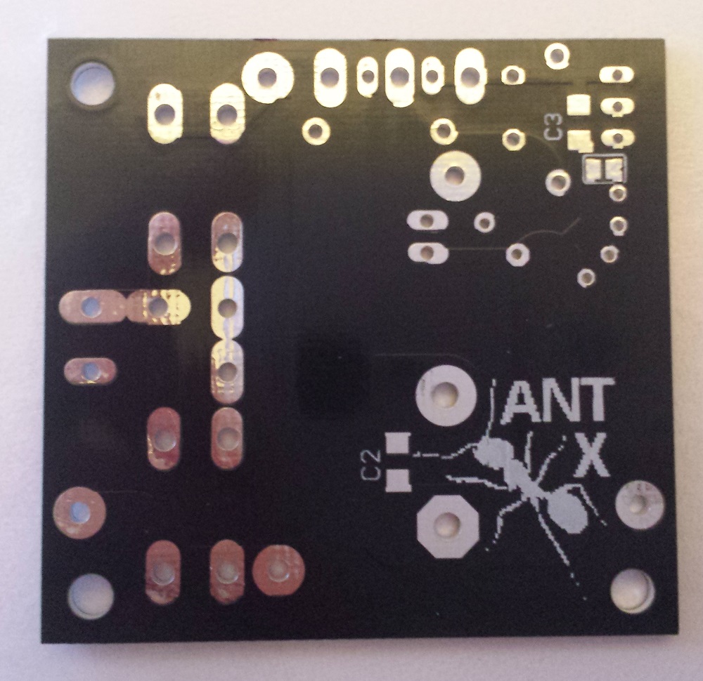

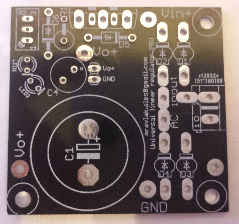

Got my PCBs from Dirtypcb yesterday, sweet boards!
However FYI but not that it matter, there was not any white rectangular area for notes on my boards.
I didn't notice this up until now. Will upload new gerbers when possible, currently I am getting error message form diyaudio when trying to upload zip files.

Can you by the look of my two pictures see if there is anything else out of order? I can most definitely live without the white filled area and do not see this as a problem (even thoe the idea is great :))
