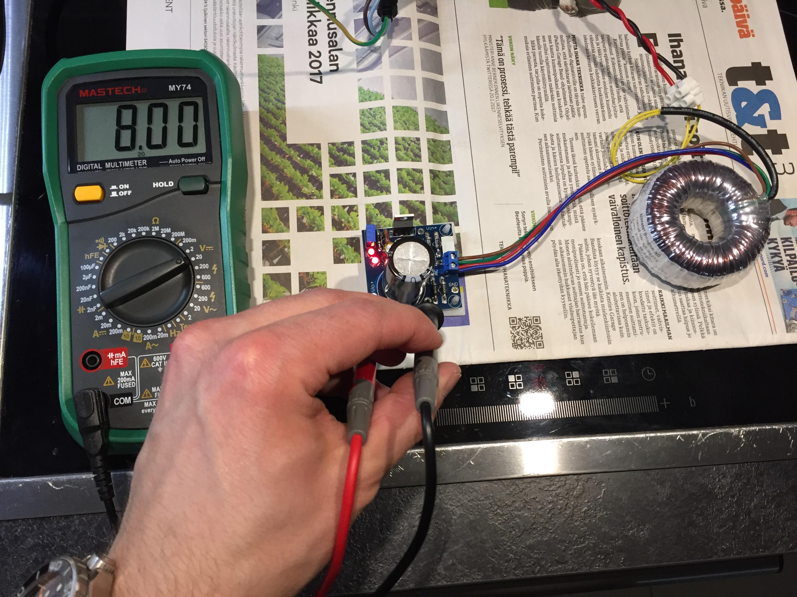

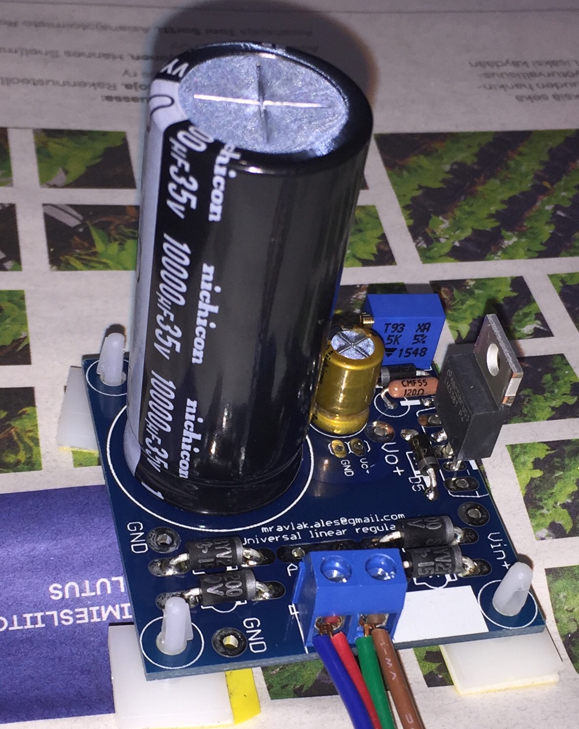

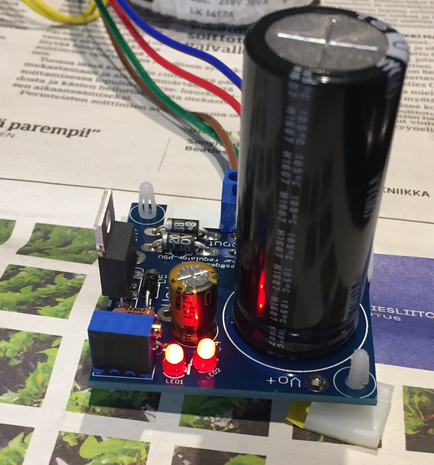

Here's a couple of shots from my setup. Obviously you need to use a sink for the LM regulator when loading it. In the first picture I have a 230/2x9 V trafo and the regulator is set to 8 VDC.

Hello Morde, thanks a lot for the pics. On my board, the silkscreen is missing for one GND (next to the screwhole). Since there are 3*Vo+/GND, is it possible to connect at least two devices simultaneously or is it preferred to use a second board? I was thinking about driving the analog part of the DAC with a single board and use another board for the Pi and a HDD. My toroid has two secondaries. Regards, ka phi
Just build a 12V / 5A power supply on Ales pcb ... and again it works flawless.

These boards are very inexpensive--I'll say that---but I have some serious gripes about them:
  • The "pads" for capacitor C3---across the adjustment resistor are far too small for a normal 10uF electrolytic cap, and there's VERY little room to mount such. Does it really need to be only able to use a surface-mount cap?
  • The LEDs are in a VERY strange place---why in the adjustment leg instead of across the output like normal?
  • The holes for the variable resistor are not drilled for a normal VR footprint
  • Capacitor C1 should be made to accomodate 35mm caps
  • It's like too much effort was made to make it SUPER small, when DIY projects shopuld be EASY to build instead
