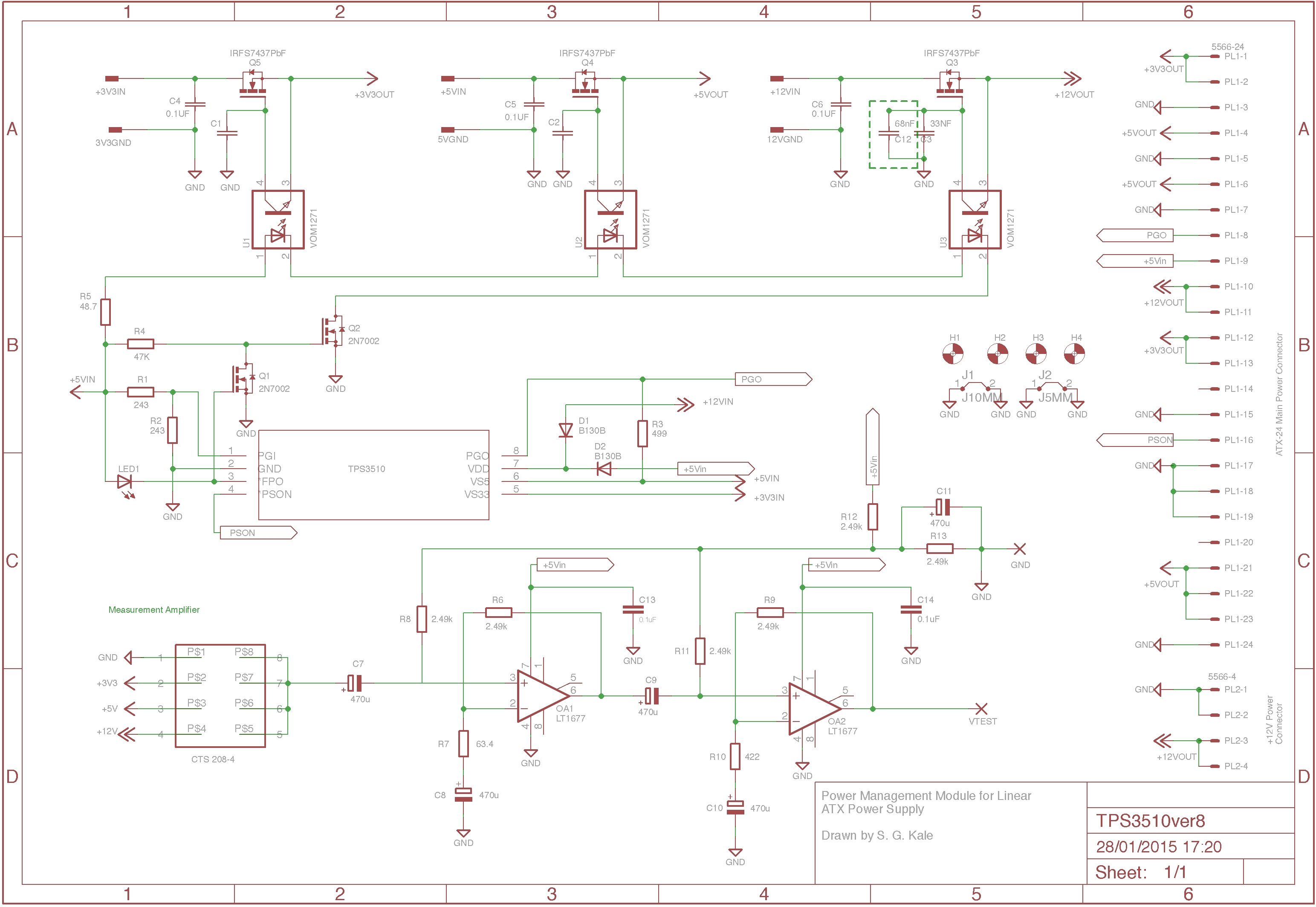

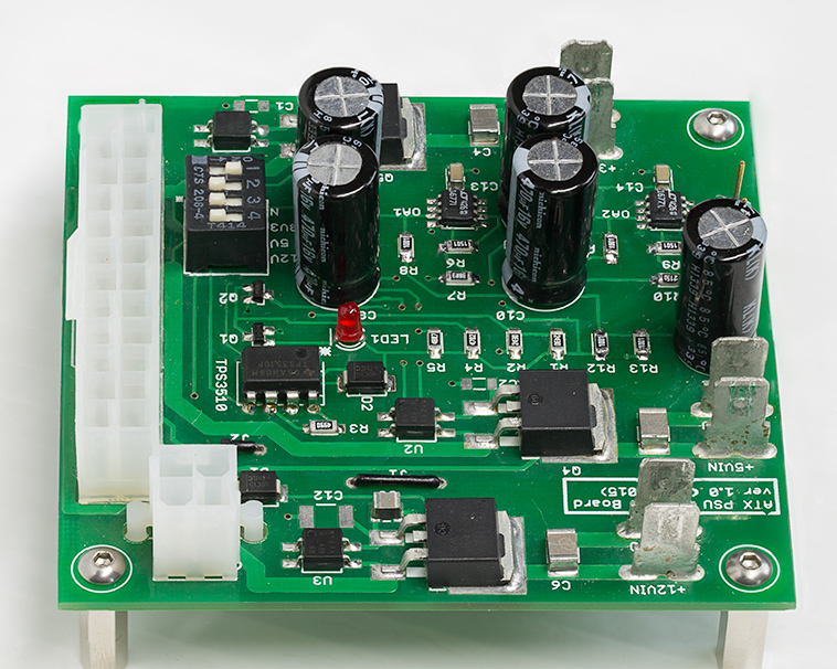

I finished my project in this regard. I built 3 'super regulator' power rails capable of 5A+. I also built an ATX power control board based on the TPS3510. This chip monitors the supplies and coordinates with the computer motherboard for PWR-ON sequencing etc. This board includes a pre-amplifier for measuring the quality of the supply rails. I attach the circuit for ATX PSU control and a pic of the completed board, plus a pic of the power rails on their heatsink.

Nice, that circuit is simpler than mine. In regards to using FET vs. relay to switch current: any big advantage? Assuming we want as low noise as possible (not that its needed for ATX but for the sake of discussion), which switch is best? Let's say we want to switch signal path, FET vs. relay? are the Omron quiet (electrically)?

I'm impressed, very nice project.

Very impressive work.

Hi. Thanks. I'm not planning to start a commercial production. I have a few spare boards for the ATX Power Control board and ver 1 of my inrush limiter which I can sell to you. For the reg rails I can post Gerber files for the board I made and you could order more boards. Not sure if that helps you at all.
