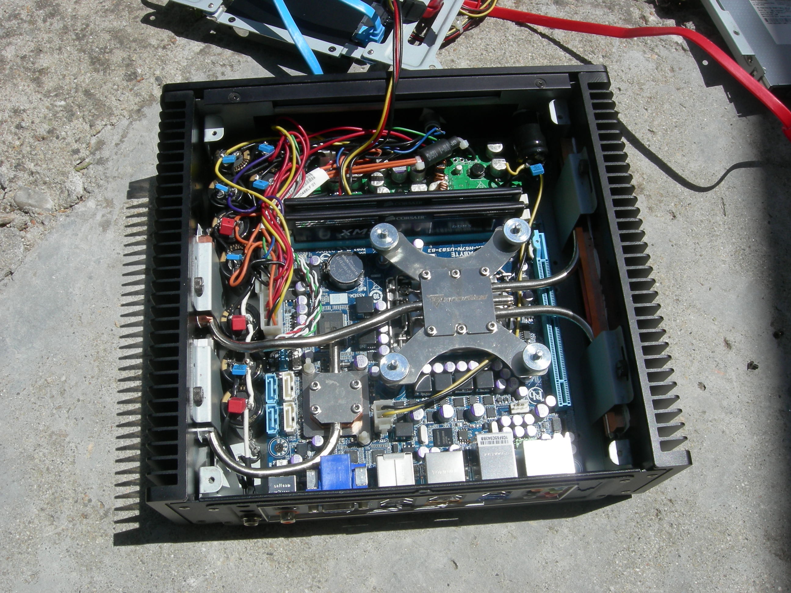

Ever thought of getting a bigger enclosure? ;-) How do you attach the caps? Looks like you simply stuck them to the enclosure with double-sided tape or something. I'm also intrigued as to what you've placed over each cap.

With ARM based systems the sizes are so small that the whole ARM linux system can be put on a tiny PCB inside the DAC.
The caps in the Intel system was attached with double sided tape, and the small blue polypropylene 10nF caps have a 630 volt rating and 2000 volt/us slew rate.

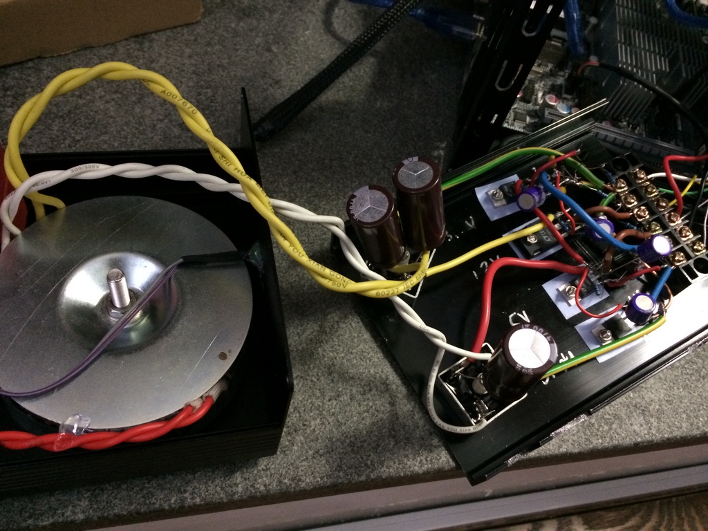

I agree with you especially the "galvanic isolation" paragraph. Lot of factors affects the sound from my experience, not just power supply, but also the motherboard, CPU, RAM, SSD, etc...

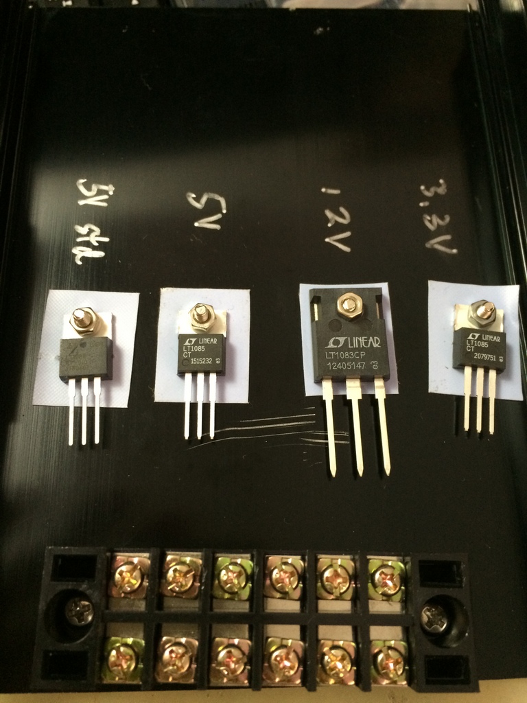

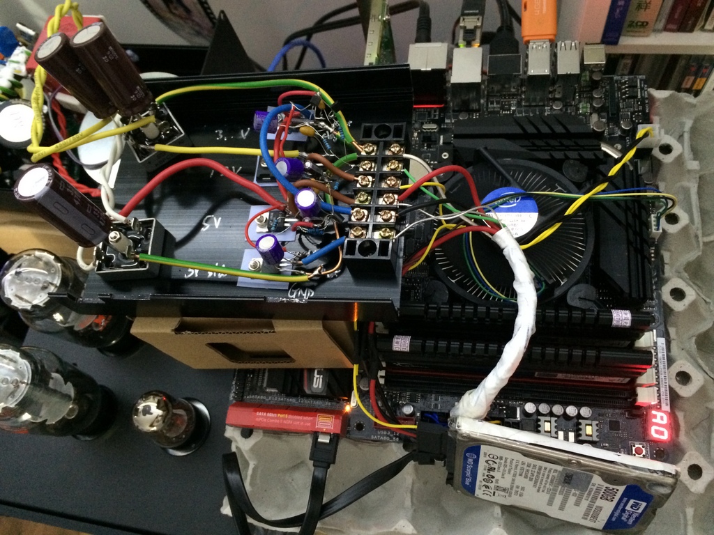

Back to the topic, I want say thank you here for your help and sharing of the linear power supply circuit. I just made one for my own and it works on my PC.
Next step is to mount it properly. I will post more photos when the final product is made.
- Digital Source
- Linear ATX power supply
