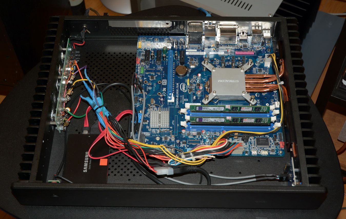

Thx. I have an ASRock Z87E-ITX mobo and am building a linear PSU. I'm hoping I can simply leave the -12V disconnected. I guess I could test with an extension between the ATX socket and the existing picoPSU, simply cutting the -12V supply and seeing if it will boot...
I finished my project in this regard. I built 3 'super regulator' power rails capable of 5A+. I also built an ATX power control board based on the TPS3510. This chip monitors the supplies and coordinates with the computer motherboard for PWR-ON sequencing etc. This board includes a pre-amplifier for measuring the quality of the supply rails. I attach the circuit for ATX PSU control and a pic of the completed board, plus a pic of the power rails on their heatsink.
Nice, that circuit is simpler than mine. In regards to using FET vs. relay to switch current: any big advantage? Assuming we want as low noise as possible (not that its needed for ATX but for the sake of discussion), which switch is best? Let's say we want to switch signal path, FET vs. relay? are the Omron quiet (electrically)?

I was way lazier, I found a motherboard that doesn't care about the power on sequencing. I made supplies for +5 and +3.3, and used an off the shelf for 12.
