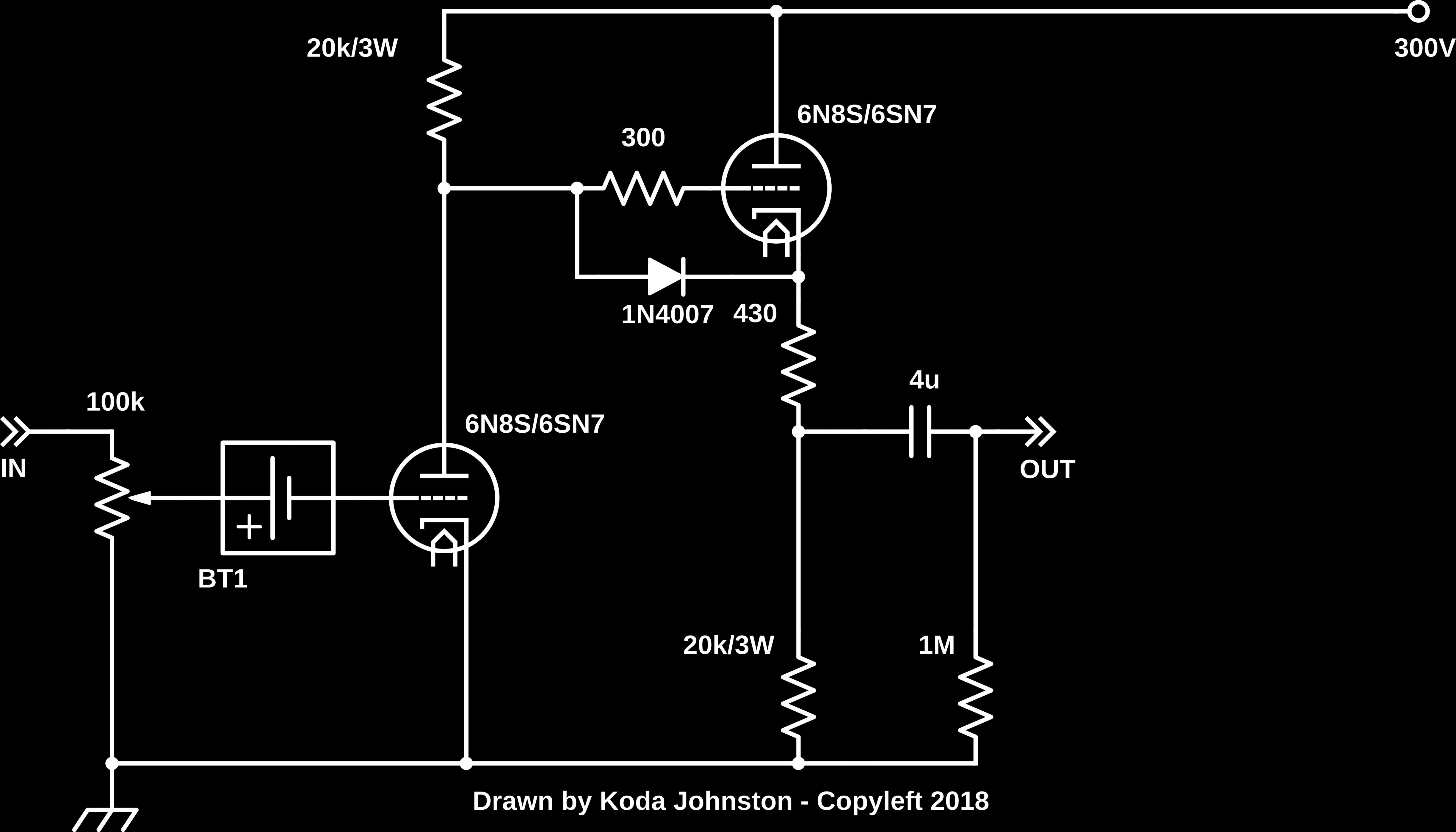

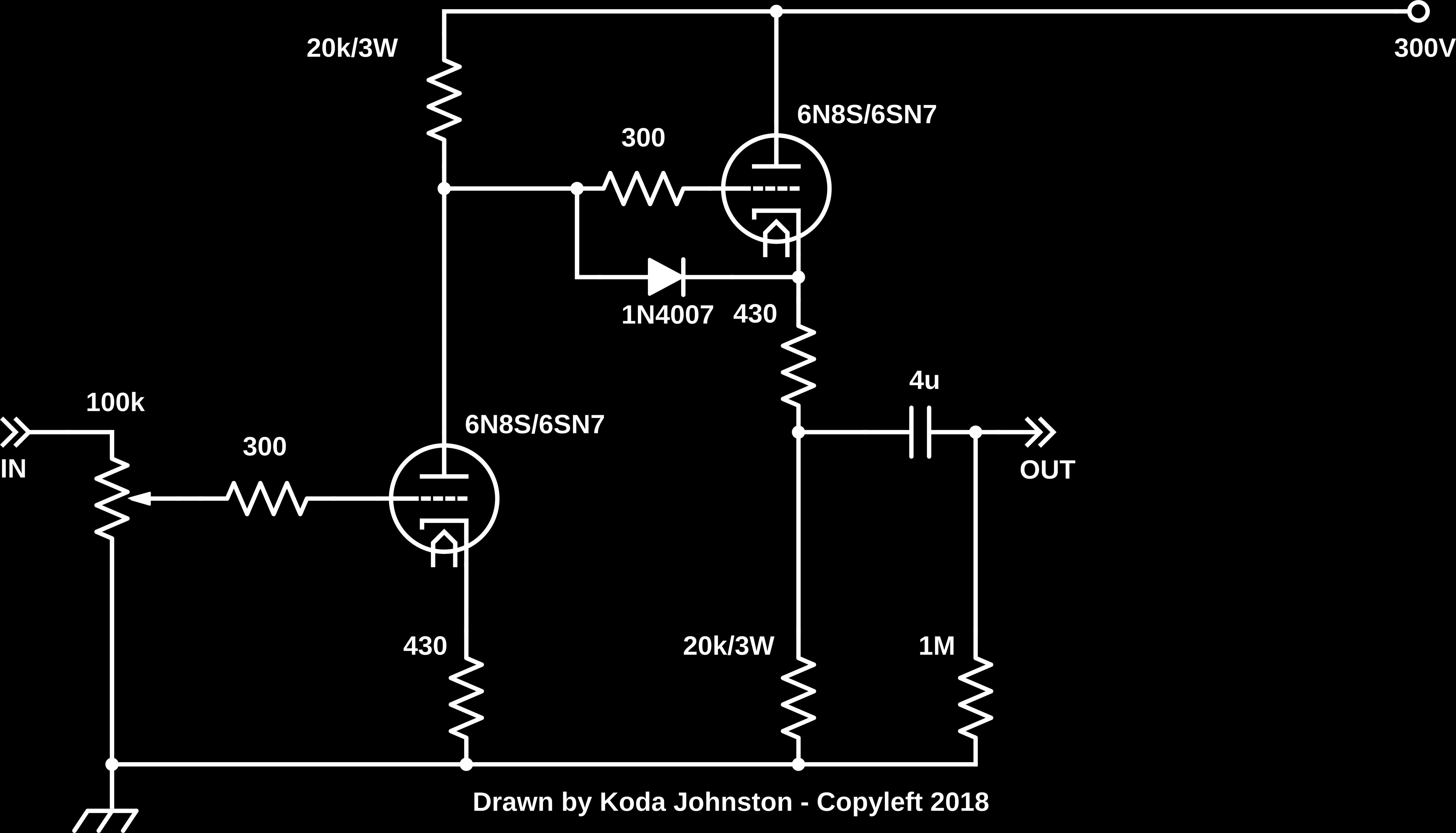

Why not go CCDA with 6CG7 or the like?
6CG7 will plug into this schematic without modifications.
Thanks Koda... CCDA? An acronym I've not come across. Nice simple circuit. BTW, like your tangential approach to amp building.
From a quick felt tip pen load line on a screenshot of 6CG7 (6SN7 in B9J )mutual characteristics graph, gain is approx 20. IP stage not de-coupled so THD low, gain low-er, biased at about -6v. OP Z of CF roughly >1k.
I'll knock it up on the bench tomorrow, Andy.
Edit, posted at same time as Jeff's post.... I did think about using a pentode as I have a good stash of NOS 6AU6's which I've used with a CCS anode load, triode strapped in an amp. Something to bear in mind, thanks.

CCDA == Constant Current Draw Amplifier. I found on the idea Tubecad years ago.
Here's the original article: CCDA: constant-current-draw amplifier
And thanks. I like to think outside of the box 🙂

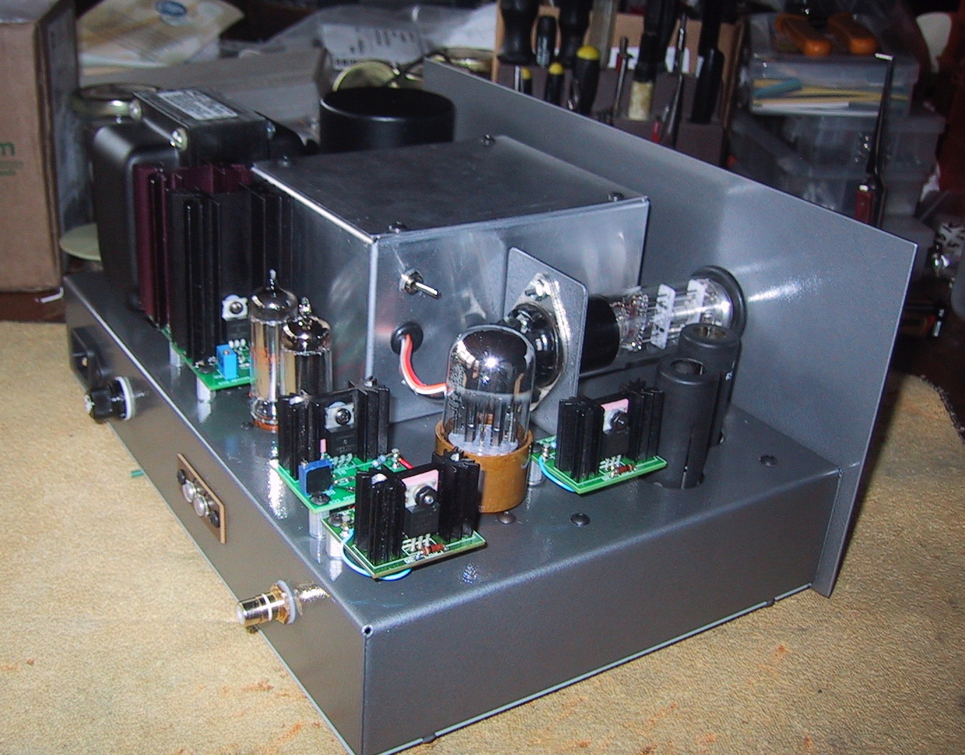

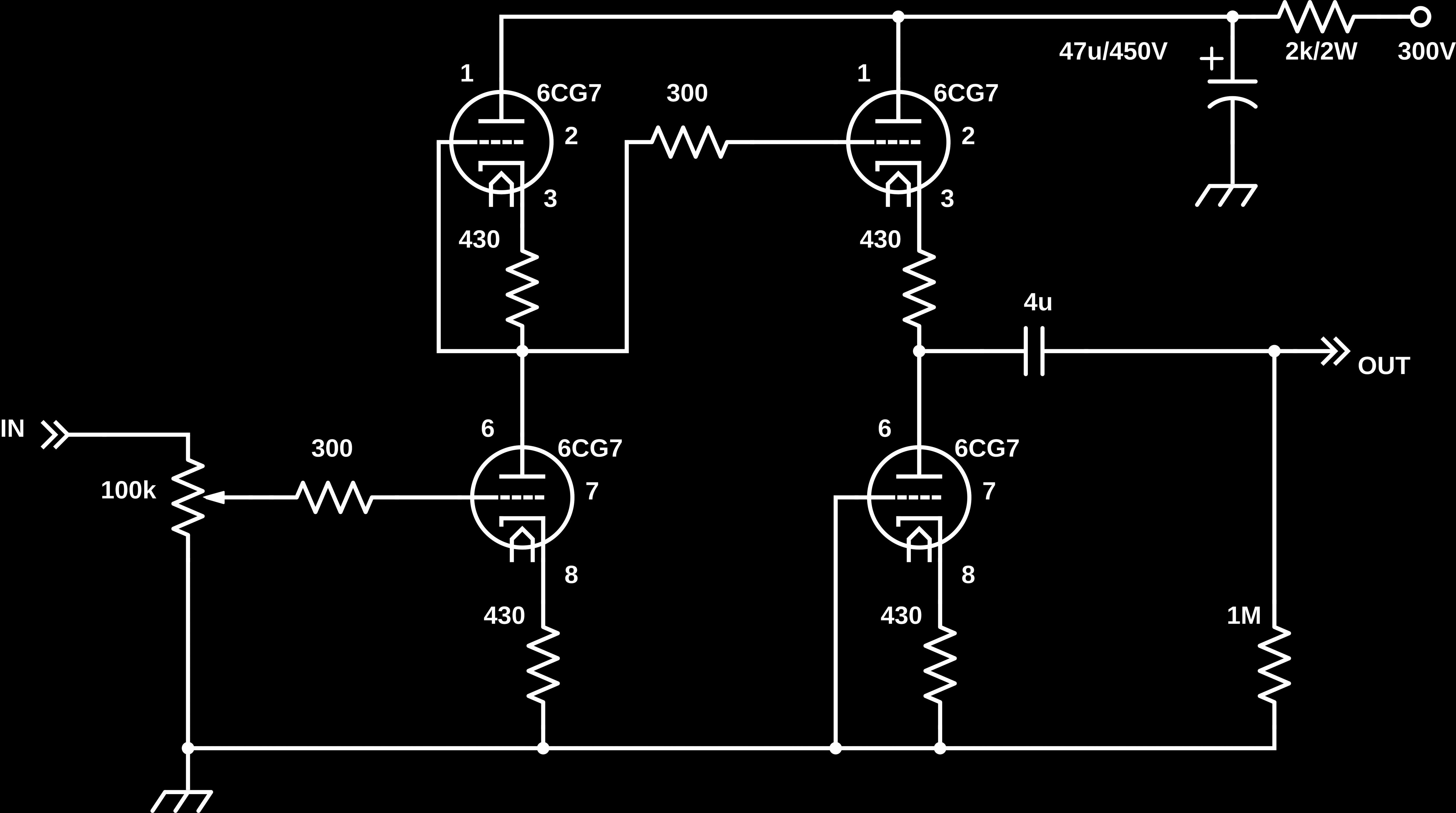

I've used the same circuit but with cascode MOSFET current sources in place of the load resistors for the 6SN7, 300V B+ and 2 red LEDs in series with the cathode to bias the voltage gain stage. Works well and the CCSs simplify the biasing.
I do the same but using triodes instead of MOSFETs. In the example I posted, you'd replace the 20k resistor with another 6CG7 like in this example. It uses twice the number of tubes, but moves most of the waste heat above the chassis allowing for a small, hole-less enclosure.

Nice, simple. Not exactly Aikido, but topologically real close. I've always kind of wondered what the gain of the left-triode-stack is, as a function of mu, say.
One of the things that I've also mused upon is that insofar as biasing goes, the lower, left triode looks ripe to have a 2-red-LED-in-series cathode bias instead of the 430 Ω resistor. The upper triode could be similarly endowed (for symmetry-of-diagram), but also one could just determine a suitable 'naked resistor' like the 430 Ω job, too.
Might even be 430 Ω.
Indeed … with as-shown 6CG7 (https://frank.pocnet.net/sheets/127/6/6CG7.pdf), it looks like a 3.5 V cathode LED bias would deliver about 10 mA at 150 V plate-to-cathode potential. E=IR, R = E/I = 3.5 ÷ 0.010 = 350 Ω. Or 470. Or whatever close. You seriously could probably use any resistor in the range of 270 to 680, and everything would work just fine.
But… the one thing that an LED-on-cathode bias scheme does is that it holds the cathode 'hard' at the 2⋅VF conduction level, regardless of signal excursions. A 'naked resistor' is substantially different, inducing an in-phase signal onto cathode, as a kind of negative feedback. Lower gain, of course. Higher linearity, of course. Probably more desired for a preamp, of course. Except if one needs a light show … of course.

A triode current source AC impedance, while better than a plain resistor, can't touch the 40M to 60M that a cascode MOSFET can achieve in the audio band. As to heat, the heat sink can be mounted on top of the chassis.

Yes, you're right. This is Aikido without the mojo. I'll call it Active CCDA. I don't need the effects of it since I use clean power in the first place by SMPS or brute force. You'll remember I commonly use a 3300uF cap in the final position of my power amplifiers, and a phono preamp will be 500uF or so.
From what I understand, the gain is 1/2*mu of the first tube. In this example, a gain of 10 with a bypassed cathode, probably about 8 without.
One day I'll eff with LEDs, but I'm more likely to use a battery inline with the grid. 😀
You are correct though, the unbypassed resistors reduce distortion at the cost of gain and higher Zout.
The nice thing about using a battery like this is it will never go dead (if it's carbon or another composition with a long shelf life) because there is no current drawn, it's a simple voltage source.
Yes, but couldn't you use pentodes to achieve the same result? Seems like a good use for those 6GH8A tubes we have lying around from the "color killer" circuits of old TVs 🙂 If you use depletion mode MOSFET or JFET they should drop in without much change other than the cathode resistor?
As for heat sinks on top, but then people would know you used sand? LMAO
