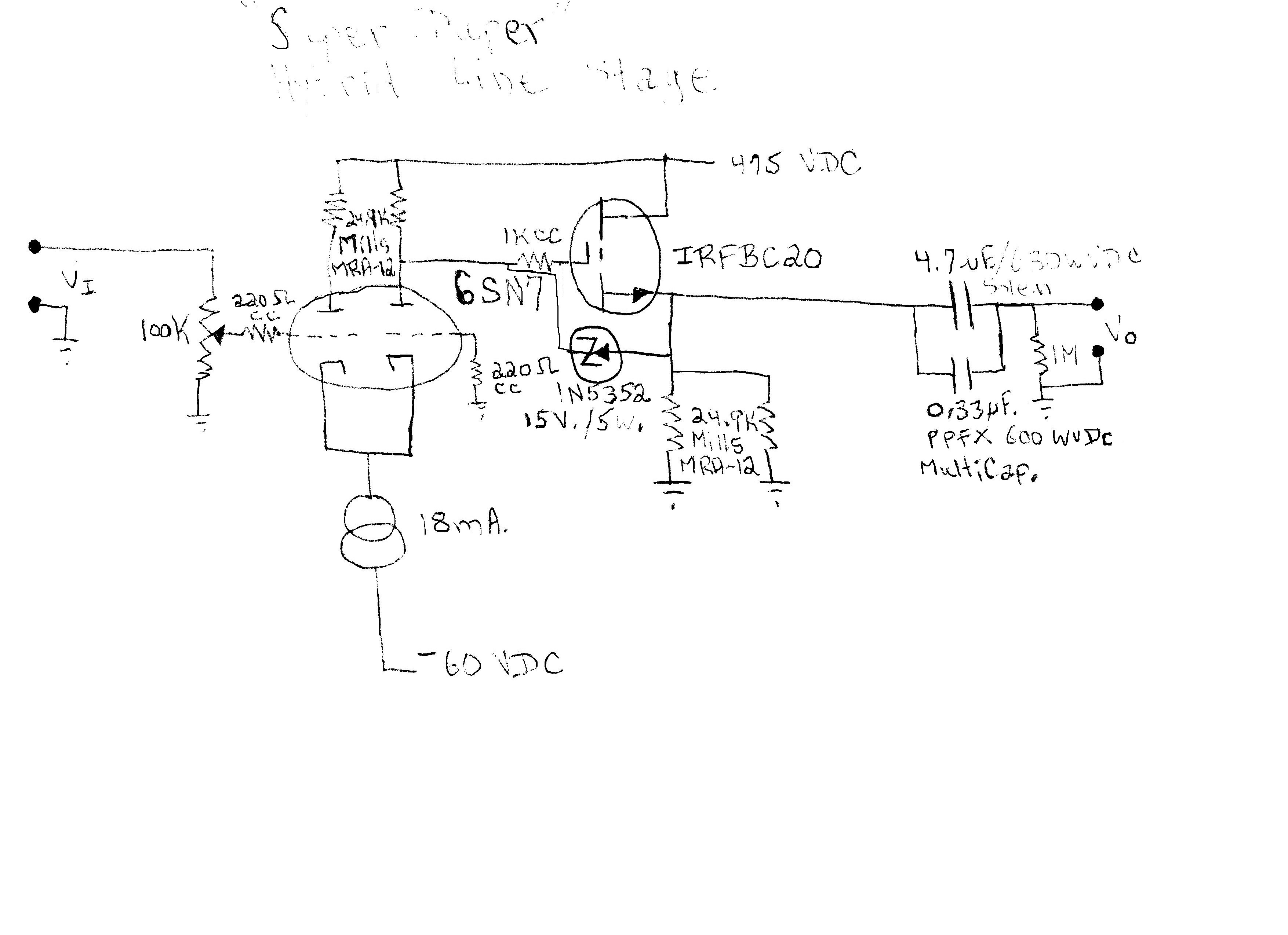

Going back to the OP's stated requirements of modest gain and substantial drive capability, I'm uploading a 6SN7/MOSFET hybrid. Because the differential gain block is driven at only 1 I/P, max. thoretical gain is 1/2 mu. Resistive loading reduces gain to < 1/2 mu. So, gain is < 10. The setup is non-inverting, extremely linear, and has gargantuan drive capability.
It should be noted that low O/P impedance, while necessary, is not sufficient. Current handling ability sufficient to charge and discharge interconnect cabling capacitance is necessary too. IMO, prefer 5687, ECC99, etc. over 6922, in the cathode follower role. A big, honking, MOSFET has even more "stones".

@ eli …
Yes, of course. That's one heck of a watt-burner, that. The 24.9 kΩ resistors are each conducting about 2.1 to 2.5 watts quiescent. Not much different when pre-amping the signal, of course. But it looks good. And the 'trivial thing' as long as burning watts is of no consequence, is to use an even lower source load resistance, by perhaps just paralleling even more of the 2.5 watt heaters. Go as low as you feel like warming the environment.
The MOSFET definitely has “the stones”. I've been avoiding referring to them tho', as this is the tube forum and as we don't have a steampunk hybrid forum under which such ideas really aught be held.
Still … good alternative.
Solid.
One could even get away with a bit of negative feedback to further tame distortion and over enthusiastic gain at one go. There's that nice right-side grid-to-ground on the dual triode which presents obvious opportunities.

FET transconductance increases, when drain current increases. As transconductance increases, voltage follower O/P impedance decreases. I wanted a less than 100 ohm O/P impedance and that means waste heat in the resistive load. Compromise will always be with us.
