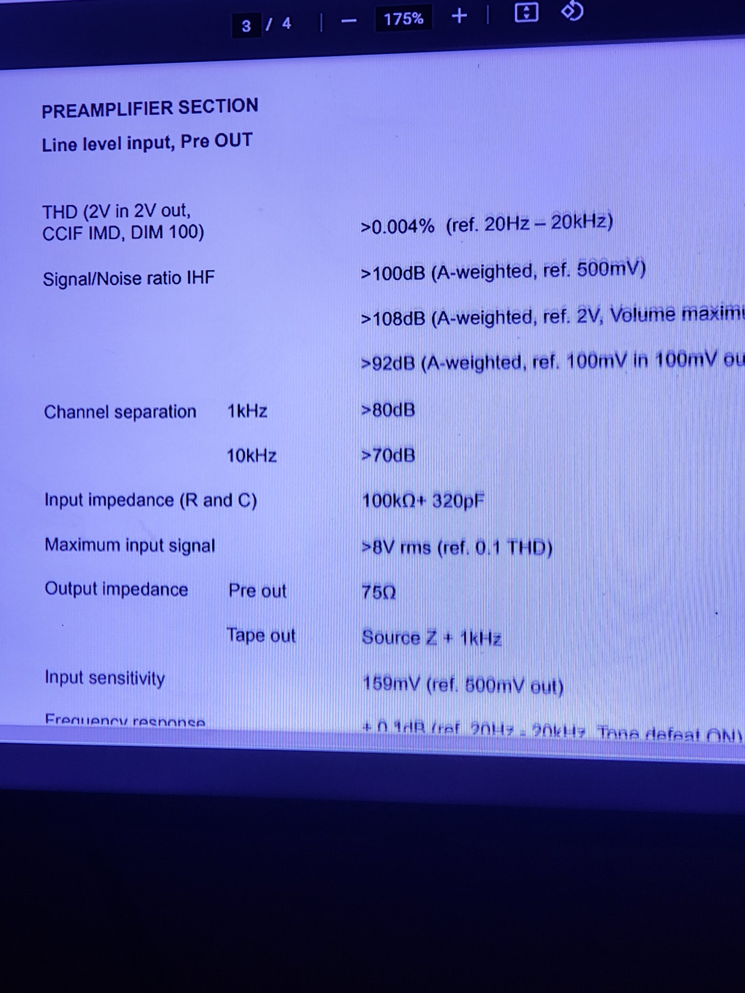

Why they don't note output voltages in plain easy to read print as others do still escapes me however.
But they DO, clearly.
The most mentioned value is 500mV
* first mentioned in S/N ratio
They also mention higher (2V) and lower (100mV) as reference, before somebody asks: "but what if ..... ?"
* they also mention maximum output signal: 8V RMS
Notice all these values "dance around" 500mV ... a few dB higher or lower.
* sensitivity spec is referred to 500mV output.
You cropped out part of that spec screen, not surprised if 500mV is also mentioned related to some other spec.
20230704_221650-jpg.1189543
So the answer to your question is: that Preamp is optimized for a 500mV output.
That said, it´s also silent enough to be used with down to 100mV signals, and powerful enough to put out some 2000mV output with negligible distortion.
They also warn you (indirectly) that it will clip if you surpass 8000mV output signal ... which is the Real World spec for normal OpAmps fed +/-15V rails, what I expect to find there (as in it being "Industry Sandard")
In a nutshell, I see that preamp spec set as properly written, following Industry Standards.
Nothing cheating or misleading.

"Source Z + 1kHz" is a really strange and I have never seen something like that. It must be a mistake. Whats "source" on an input? Whats "+ 1kHz"... really strange...
Otherwise specs seem to cover what you need. Max out, gain (159mV -> 500mV) and Input sensitivity and impedance.
