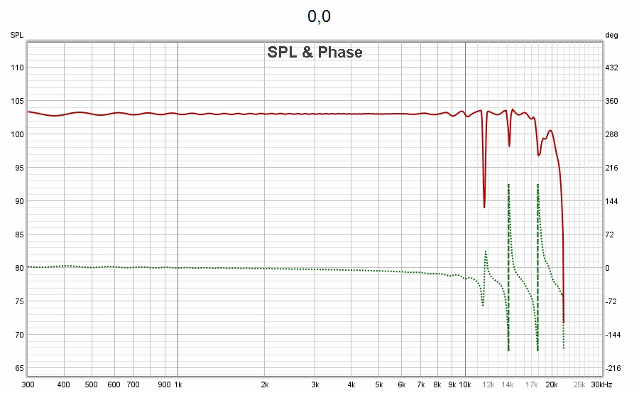

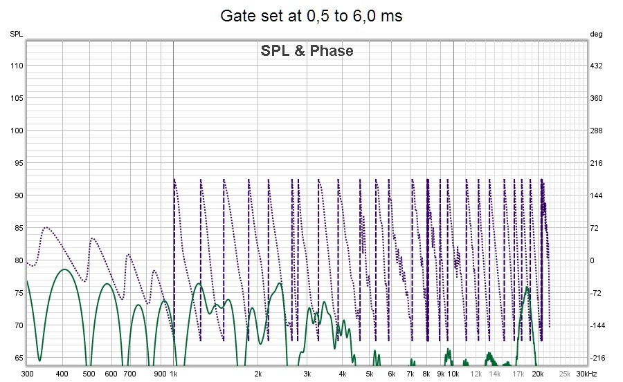

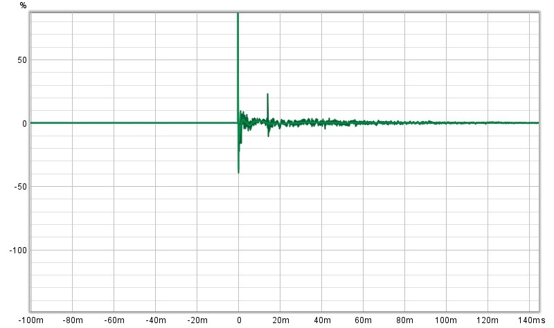

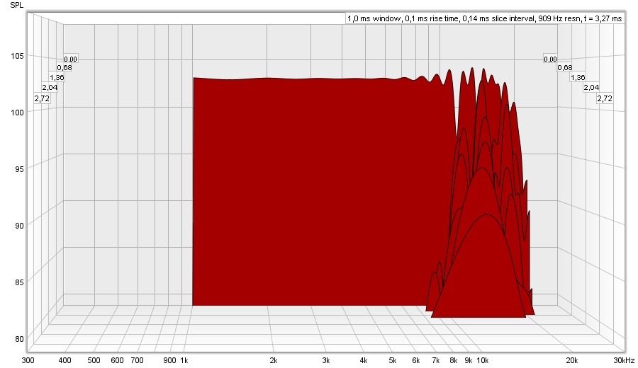

I figured I could just filter the IR from the simulation, as that wouldn't show any room related stuff. Now that I get what @mapirc is getting at...
I made a sequence of graphs, starting at 0,0 to 6,0 ms window, stepping in up in 0,5 ms steps:

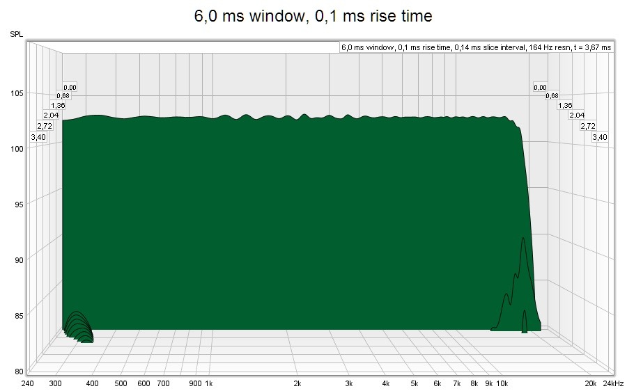

This is the simulated straight array, consisting of 25x TC9 FD18-08

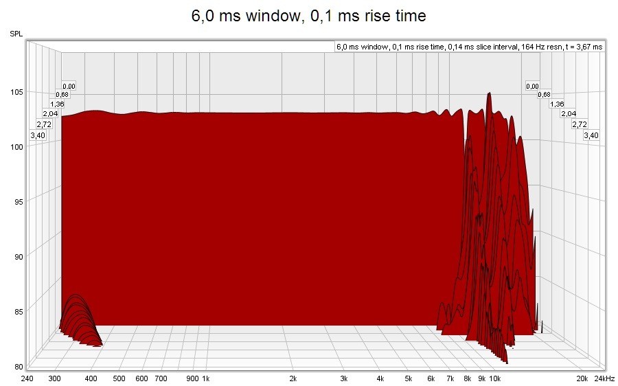

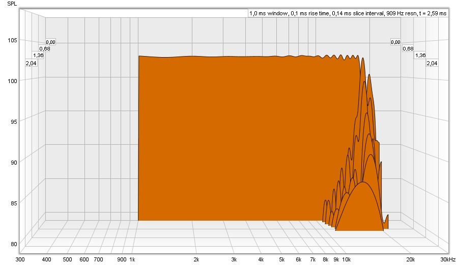

Looking at the waterfall graph of a 6,0 ms window with a rise time of 0,1ms:
Simulated straight array, waterfall plot covering 6 ms

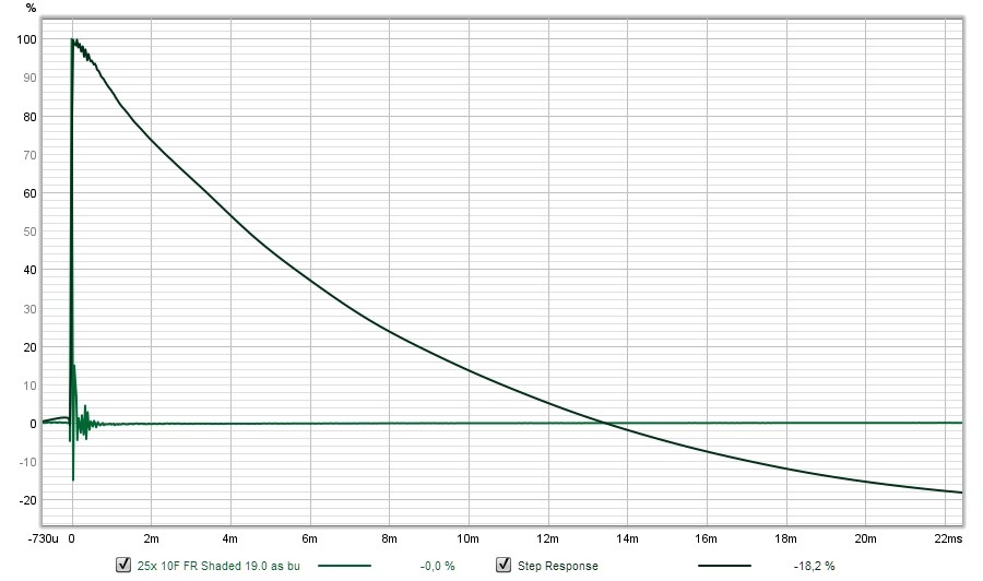

For my frequency shaded array, I see no point in doing the animation, see the 0,5 to 6,0 ms gated window:
Simulated straight frequency shaded array, gate 0,5 to 6 ms, 25x 10F 8414G10 (not that it matters in this simulation )
And the waterfall plot that belongs to it:
Simulated straight frequency shaded array, waterfall plot covering 6 ms
The shading does what it's supposed to do, clean up the top end. It's why I wanted to try and incorporate it. Well, this clean up and the fact that the shading reduces the level of energy it splashes to floor and ceiling.

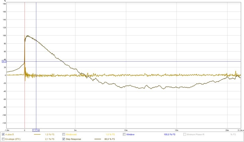

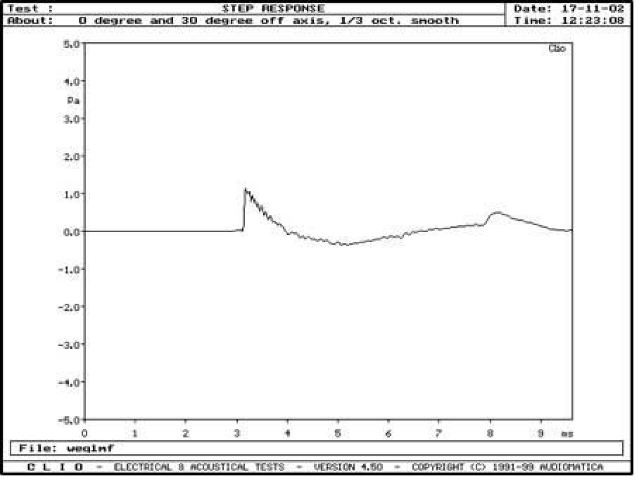

looking close to kuze array step response (32 x 2" tang bands)
https://projectgallery.parts-express.com/speaker-projects/kuze3201-line-array/
step response, sorry for the blur but trying to make it big enough to see

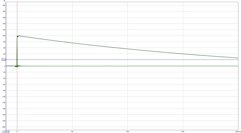

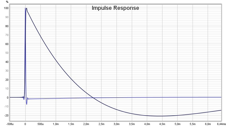

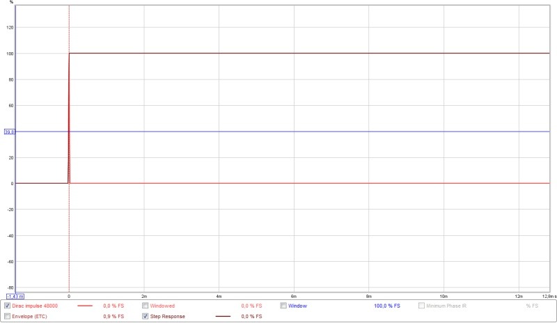

Well, an ideal STEP would look like a triangle, for a source that doesn't play from zero to infinity...
Like this STEP that I just created, with a second order crossover at 80 and 18000 Hz:
(the black line being the STEP response obviously)
The above should represent the ideal shape at this limited bandwidth. I've often seen that graph from kuze being shown, where people mistake that triangle to represent the separate drivers arriving. That isn't true. He is showing the STEP of a band limited output, his array. If it had more bottom end, it would fly for more seconds above the zero line.
Let's see, I probably have one, be it with a "shaped" frequency curve, so it will shape the STEP as well...
Showing the IR and step of the (then) unshaded array. Obviously the bandpass I used did not stop at 80 Hz, as it crosses zero after about 7 ms.
The shape of it is determined by my preferred in-room frequency curve.
An ideal Dirac pulse would look like this:
From zero to infinity, the STEP keeps that straight line.
A STEP and IR measurement of a DAC:
Obviously it isn't extending all the way to zero Hz .

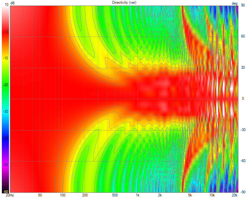

Yes it would, at enough distance. In my shaded array, I still have 5 drivers playing full range. The reason for me to want the tall array is to have enough SD area to also play low (with some authority) and avoid most floor and ceiling reflections. That's why I use frequency shading, meaning the bottom end is all 25 drivers playing.
These days the low end is done with subwoofers, but I ran the unshaded arrays full range for a long long while.

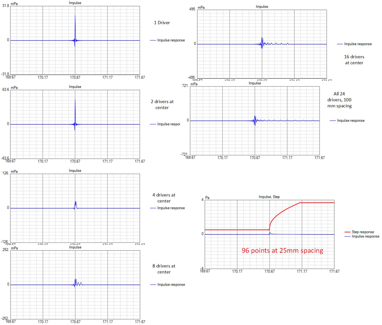

I was pretty sure the IRs wouldn't be smeared because I recall the derivation of the response of an infinite line array has an unsmeared impulse and I've done measurements of real arrays. When I dug out an old line array simulation of 24 drivers at 100 mm spacing and progressively unmuted drivers from the center outward, the smearing was obvious. Impulse height is reduced but it gets wider. even saw twin peaks. I don't understand that but I thought I should report it, given my earlier comment. These were point source drivers with no EQ spaced 100mm.
I looked at other sims, with eq, shaded and eqed, finer spacings, and saw a single impulse, albeit shorter and wider than a single driver. the example in the lower right of the attached isn't EQed or shaded but has very small point spacing.
All these simulations are of a finite array in free space so they don't approximate that infinite line source very well. A real floor to ceiling line array, extended by floor and ceiling reflections, and with directive drivers, doesn't either but it comes closer than these point source simulations.
The 2nd attachment is the IR of an array of 32 2.5" drivers that I actually built in a treated garage with 8' ceiling. It is unsmeared and shows the one prominent reflection I couldn't get rid of no matter how much fiberglass I put against the walls

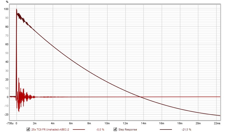

It left me wondering a bit too... for all I have done with these arrays, I always felt that they were acting as a minimum phase devise. So I investigated some more.
So I took the waterfall of the simulated unshaded straight array:
And started looking how it reacted to a bit of (quick) corrective EQ:
I didn't feel the need to do this to perfection, as it is a pointless exercise. One would never want to EQ-away combing, as I'm pretty convinced that's what I'm doing here. I could EQ it to perfection at a single point in space. Heck, I've tried that (as an exercise) in the past using an IR of a Stereo pair. But you wouldn't want to listen to it like that, as it would be bad when listening a few cm to the side of that EQ-ed (to perfection) point. But still, it is acting as a minimum phase device. This EQ work also cleans up the IR if done with care. (which I didn't do here, just quick and dirty)
I could have done an IR inversion, but manually EQ-ing in REW gave me time to think it over . Be warned: This isn't something you want to do! It will create horrible sounding results, with great looking IR and FR graphs. Only in one spot though, not what you'd want.
So in hindsight, I think it is the combing that is to blame here, for not following the "no smearing" behavior. And combing is related to the distance to the array + the center to center spacing of the drivers used, thus it makes sense that an array with smaller sources (like nc535's 2.5" drivers) suffers less from this phenomenon. Even more so if his listening/measuring distance was more than 3 meter. Heck, it's easy to EQ it away in that case, just not always wise to do so. That's why I have often used measurements made at several point close by the ideal sweet spot and averaged them, even though a single spot correction often did sound best.
