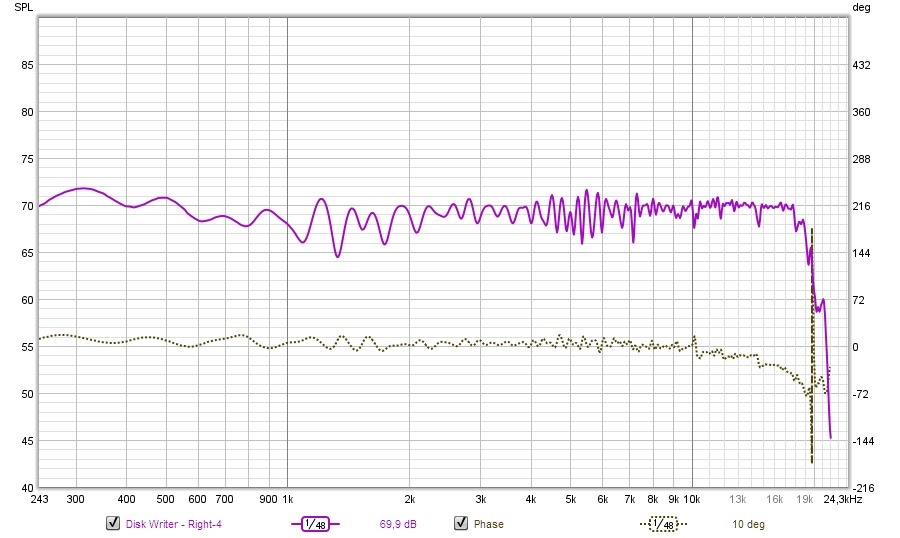

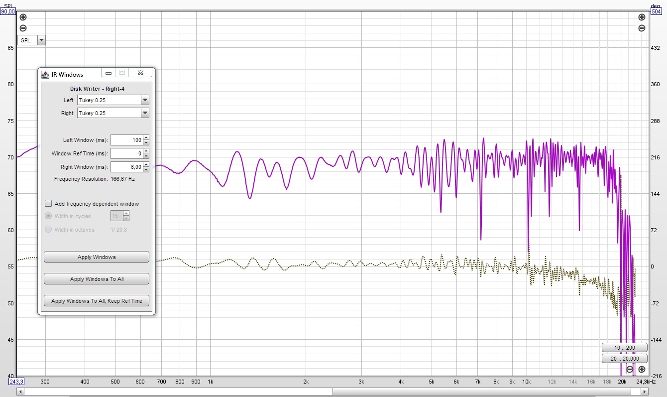

I guess that was one of my measured IR's. Let's see two gated graphs, no smoothing applied:
First up, 0.5 ms gate:
Next up, a 6.0 ms gate:
I think you need a new theory 😉. I don't see a huge difference here.... This is from my unshaded full range array.
My current shaded array will perform better on the top end, showing no combing. Does this answer your curiosity?
I wouldn't cal the IR poor, in fact, I'd call it pretty good. It corresponds well with the FR, as it's the same thing, just shown differently.

Here's that last graph smoothed 1/48:
